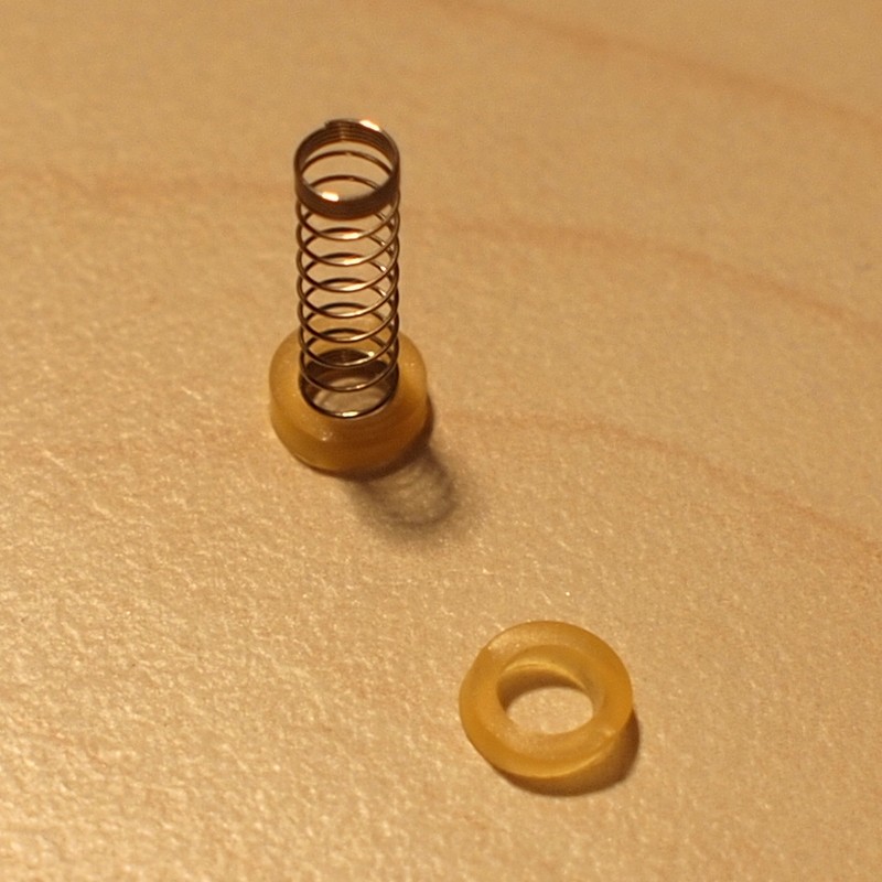

stracciatiera
18 Jan 2017, 16:40
seaworthy wrote: Guy in this video https://www.youtube.com/watch?v=1wlgvgu3Jnc says he's putting o-rings on his Matias clicky switches...
Anyone done this? Sure, I've seen dampeners on the side of the sliders but never an o-ring--where would an o-ring go on an Alps-style slider?
Old post, but still: He’s doing it wrong. I put little O-rings around the bottom ends of some Alps’ springs. That makes a difference, even though the modified switches are still not exactly silent. I never opended all switches to clean them. Maybe I will soon, I can take pictures and maybe even record the typing sound.
Hypersphere
18 Jan 2017, 17:25
I've done this in the past. I used small needle-nose pliers to stretch the O-ring and slip it over the slider. It doesn't work if you try to do this Cherry-style by putting the O-ring on the keycap stem. This procedure sort of works. I did not like the feel at all and started using it only to deaden the spacebar. Later, I abandoned this altogether. What I now do for the spacebar is replace the slider with one from a Matias Quiet switch and put thin polyurethane foam on the top plate where the spacebar stabilizer inserts hit the plate. This revised procedure works nicely. I do not recommend trying to put O-rings on Alps switches -- they mess up the feel and they tend to get out of position with use.

stracciatiera
20 Jan 2017, 23:02
Hypersphere wrote: I've done this in the past. I used small needle-nose pliers to stretch the O-ring and slip it over the slider. It doesn't work if you try to do this Cherry-style by putting the O-ring on the keycap stem. This procedure sort of works. I did not like the feel at all and started using it only to deaden the spacebar. Later, I abandoned this altogether. What I now do for the spacebar is replace the slider with one from a Matias Quiet switch and put thin polyurethane foam on the top plate where the spacebar stabilizer inserts hit the plate. This revised procedure works nicely. I do not recommend trying to put O-rings on Alps switches -- they mess up the feel and they tend to get out of position with use.
What I did is this:
They fit perfectly. They shorten the key travel a bit and dampen the bottoming out of the slider, which makes the keys a bit quieter. I did it, because the board I have has a rather loud case. It helps a bit and doesn’t mess up the feel. But I think, I’m going to remove the O-rings, because I have some *cough* AEKII, which are better, if you want silent keys.

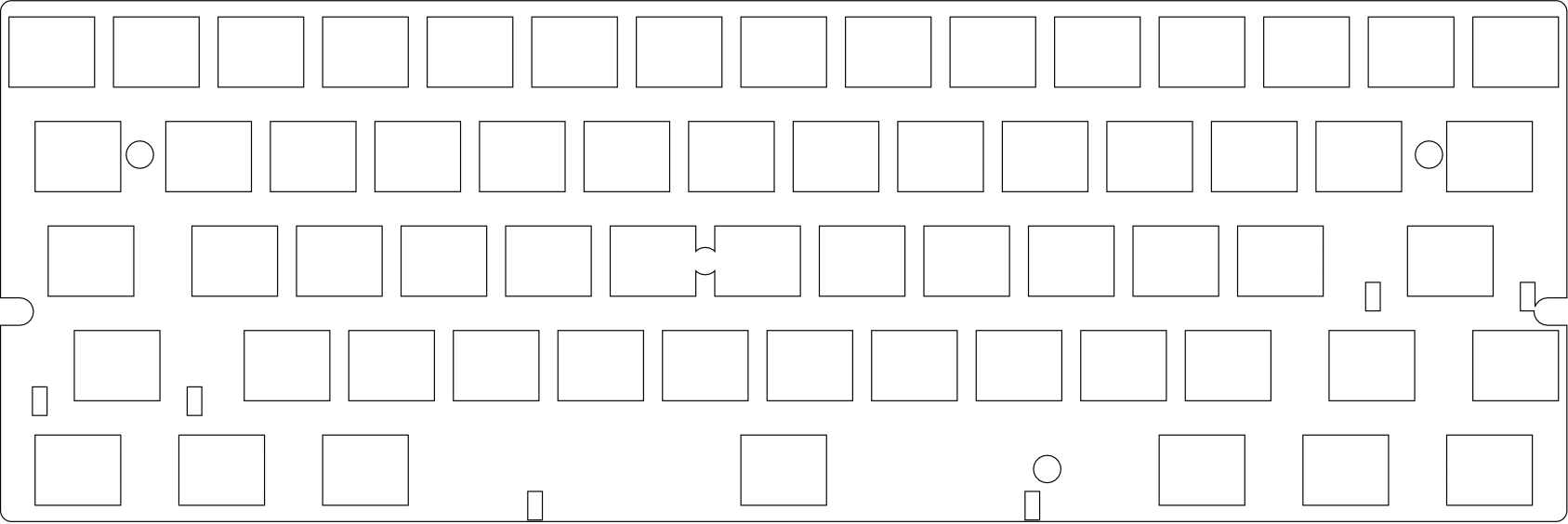

Khers
26 Jan 2017, 13:54
I have an Alps64-build on which I would ideally like to change the plate. I'm going for something based on an AEK/II, but with the added benefit of having certain elements of the HHKB-layout that I'm used to in it (namely the split backspace and right shift). Currently, I'm trying my hand at fixing the plate, but as I have virtually no experience on this, I got stuck. I used swillkb's web tool and came up with this:
HHKB-inspired AEK 60
While most of it seems to look about as intended, there are two obvious issues (there may be more, but I've yet to see them):
(1) There is no mounting point for the stabiliser pole hole (or whatever it is called).
(2) It seems the wire mounts for the spacebar stabiliser are closer to each other than on the actual AEK (this might be a non-issue).
Does anyone have enough experience with Swill's tool to know how to add the mounting point for the pole hole and to move the wire mounting points? Or maybe know whether the latter is a non-issue or not.
Hypersphere
26 Jan 2017, 18:01
@Khers: You might contact "emdude". He has a thread over on GH about custom keyboard plates.
I have a similar interest to yours. I would like to make a 60% board with the Alps64 PCB and a HHKB layout, but I am concerned about sourcing keycaps for it, especially the 6-unit spacebar. So, I am considering hybrid designs, such as a standard layout on the bottom row with a 6.25u spacebar and 1.25u mods, but with a split Backspace and split Right Shift.
OTOH, I might just go with a completely standard layout and use the RCtrl key as Fn as I have done on other standard layout boards remapped to a HHKB-like configuration.

Khers
26 Jan 2017, 19:37
@Hypersphere: Thanks for the info! Now that you mention it, I have a vague memory of seeing something like that, will look into it!
I happen to be one of the weirdos who enjoy the italicised legends on Apple keycaps, so I'll go for AEK2 for everything bar the escape and right shift (in the form of a command key, but still) which will be sourced from an M0116/8. Just have to source suck a keyset. :)
