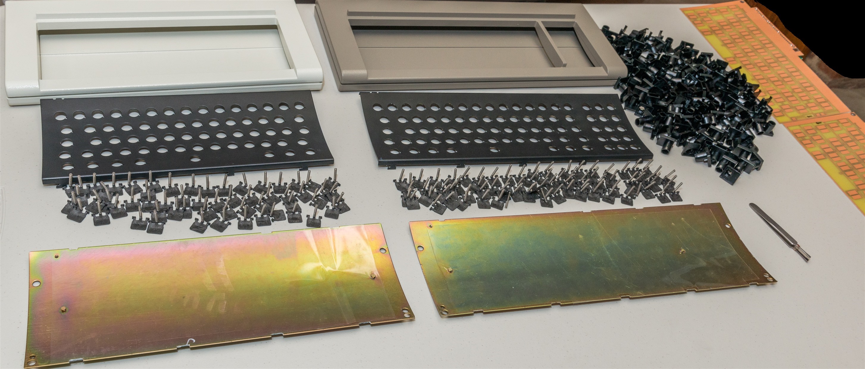

The bottom inner assembly is the gold colored part in the photo.

Ellipse wrote: The bottom inner assembly is the gold colored part in the photo.
Thanks. I somehow missed seeing this item on the Store site. I suppose the smaller version of the back inner assembly is not yet available (?).

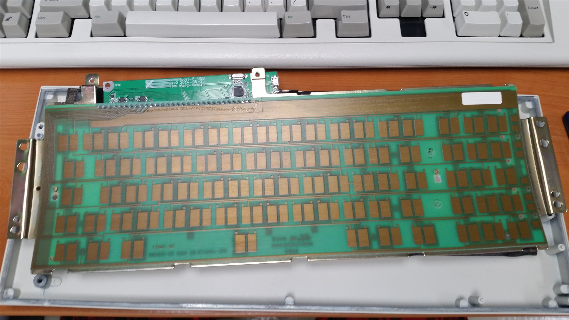

We are actually making the PCB more like the original 4704 design with this change. I had expected for the PCB to stick out the side like with an XT keyboard (for the production PCBs) but now we will be using the ribbon cable approach which moves the through holes to where they are on the original 4704. That way the controller can be tucked below the keyboard instead of requiring the larger area for the controller with the original case. As someone suggested to me, it also offers the benefit that you can replace the controller with a little through hole soldering in the future for another controller 10 or 20 years from now :)
Below is an original F77 PCB, compared to the prototype PCB whose through holes will be moved about 1 CM inwards like on the original:

Does this mean you will put the row and column traces on opposites of the PCB like the original, and get rid of the vias?

Nope - it just means I am moving the through holes at the top 1 CM inwards like the originals. That's the only change. The PCBs are 100% good the way they are (except that it sticks out of the side a little) so I don't want to make any other changes.
