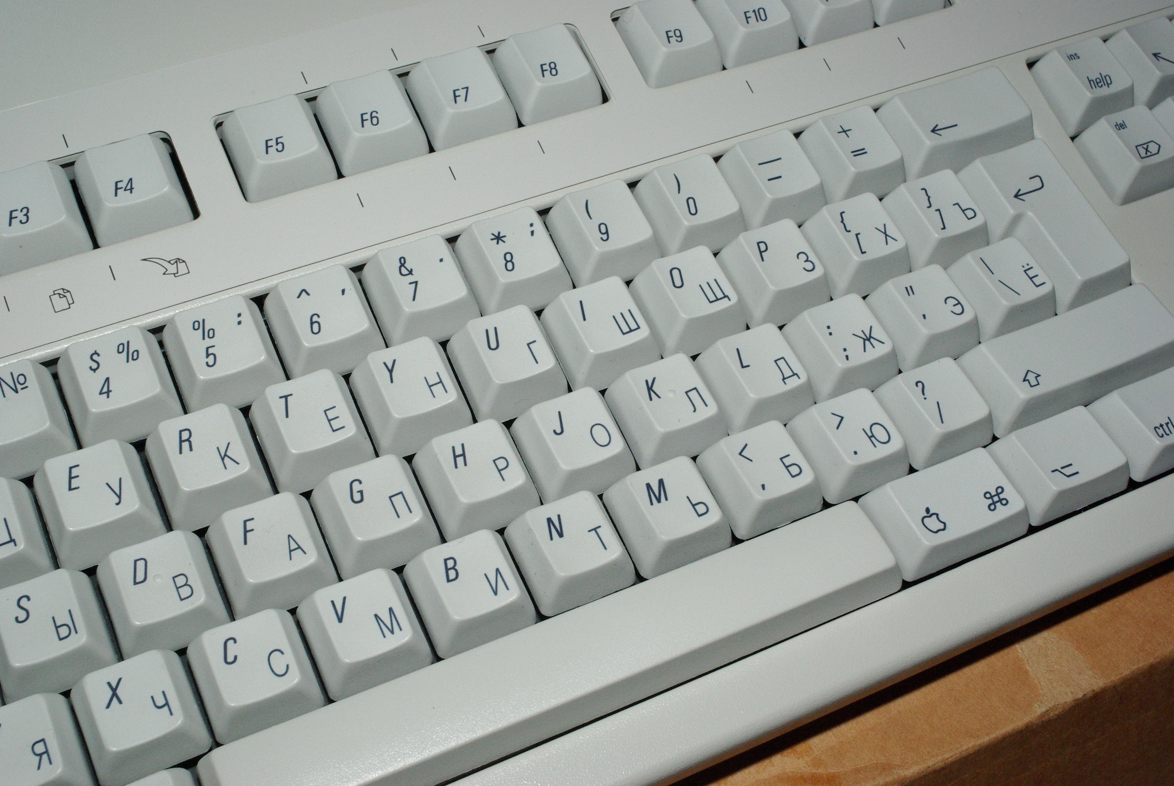

Posted: 07 Mar 2017, 05:26
by Mattr567
Now that's some clean Alps holy shit. Looks like this keyboard was never used. Feel's fantastic too.
