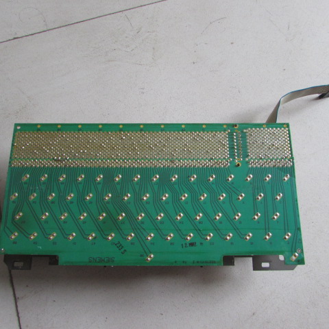

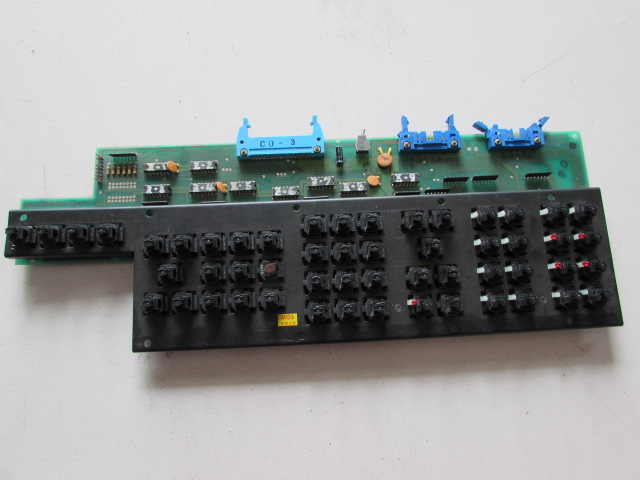

I received it today. But I have no time to clean and check whether it is. It's clicly and heavy like the Cherry black.
Here's the large picture for you to determine the switch. :cry:
Maybe 1week after,I have time to clean it.

@terrycherry: As the presence of the bell key (⍾) and the who-are-you key (✠) suggests, this must have been the keyboard of a teletypewriter. I'm certain, it's from a Siemens T1000, international or military variant, from the late 1970s or early 1980s. Compare with photos of the German variant.
Siemens used this type of switches also for their Transdata terminal keyboards of that period, see for instance https://geekhack.org/index.php?topic=54446
edit - or see seebart's
terrycherry
14 Sep 2015, 07:47
seebart, OleVoip: Thanks for this important information. It got her name "Siemens T1000"
I through that was Siemens when the another seller sell the same keyboard(but black slider version) with Siemens logo on PCB but without the true model and full case to prove it.
same switch with seebart and niubio.
I"ll received the black version of this switch two days later. Take time to clean it and make more details and photos for yours!
I think seebart's keyboard is the very first type with this switch, and mine have the PCB mount is the later type keyboard.
I noticed the swith is "Siemens vintage switch" with two variant(white or black slider)
Here's the Aroflex UA-8116(T-1000CA) details link which based on Siemens T1000 teleprinter
http://cryptomuseum.com/crypto/philips/ ... /index.htm
14 Sep 2015, 09:59
OleVoip that's the first time I see that GH link. Looking at the picture I'm now sure that mine is also a Siemens teletypewriter varaint. The shape of the case and the keycaps are identical. The TD 81610 is simply a larger model with more function keys on the left.

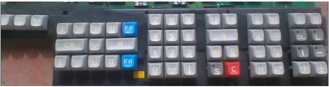

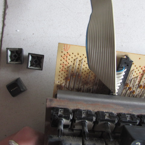

More like "identify the switch":
It's from an old (XT era) Siemens Nixdorf "portable" computer.
gogusrl
17 Sep 2015, 18:35
Lasered POM ? Got a pic of the full keyboard ?
terrycherry
18 Sep 2015, 22:10
ramnes: I never seen that mystery switch. Take more pic please! You should find OleVoip, he knows Siemens keyboard so much!
OleVoip
19 Sep 2015, 01:44
Haven't seen exactly that one, yet, but it seems to be a variant of those key modules of Siemens-Nixdorf's that have an integrated rubber dome; similar to this precursor depicted in a longitudinal cut,
but with a slider inside the modul and not (as foreseen but missing in the drawing) a slider integrated with the keycap.
The switch in the diagram is simply snapped onto the PCB. It would be interesting to know if that also holds for yours.

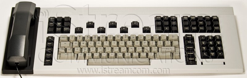

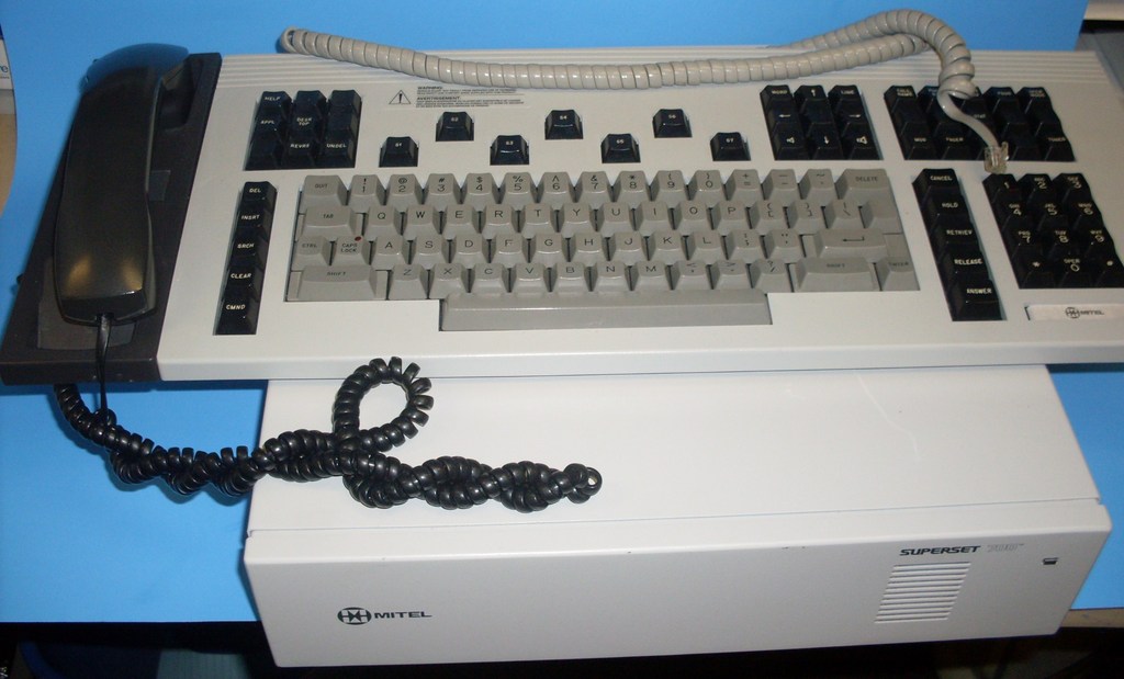

Which switch is the MITEL SUPERSET 700 Console Keyboard(MU190EA) from?
I just saw it at Hong Kong Housing Authority.

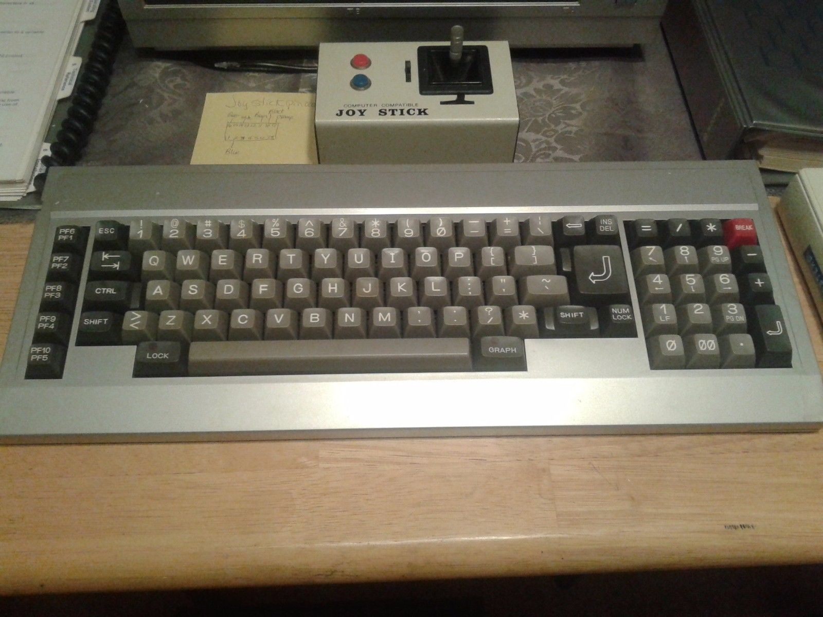

Hmm.. Apparently OleVolp thinks my ISO-eye is apparently adequate. Given the date these boards were made, it certainly precedes the later ISO standards, but does have those certain elements that are familiar to some people.
Other elements of this keyboard are just... Like nothing I've ever seen!
And I love it! :D
Crazy Canadian XXIV
01 Oct 2015, 11:53
Came across two of these on eBay before I signed up here (the other one had a German layout, and wound up selling for a measly 33 euros. What a steal!). All I know is that it's from a Sanyo MBC-555, aside from that it's a bit of a mystery. Anyone ever seen one before?
The keycap resemblance to round 5 is striking.
Sanyo MBC-555.JPG (210.58 KiB) Viewed 9970 times
