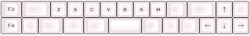

They're a cunning ploy to reduce wobble actually. The switch is centred right under the hat. You're encouraged to press it in just the right place, straight on top.
jacobolus
- Location: geekhack ergonomics subforum
- Favorite switch: Alps plate spring; clicky SMK
Hat keys are IMO idiotic, basically a way for keyboard makers to solve a technical problem in the cheapest possible way (that is, requiring no engineering effort or extra parts), while preserving their really bad legacy keyboard layout choices.
Basically, long keys need stabilizers, but for some designs of keyboards/switches, the stabilizers were badly engineered or skipped entirely, and as a result a long key would be non-functional. Turning the key into a hat key is functionally the same as replacing it with a smaller key, the only real difference being aesthetic (the unpressable stepped part of the hat key fills the available space).
The much better solution to non-functional unstabilized long keys is to change the layout to avoid a need for the long keys. There’s really no reason for any key to be wider or longer than 1.5 units, with the possible exception of the spacebar (a spacebar should be split and should still not be longer than about 2.5 units). Vendors were too cowardly to fix their broken layouts, and too cheap to include stabilizers, so instead we got ridiculous hat keys.

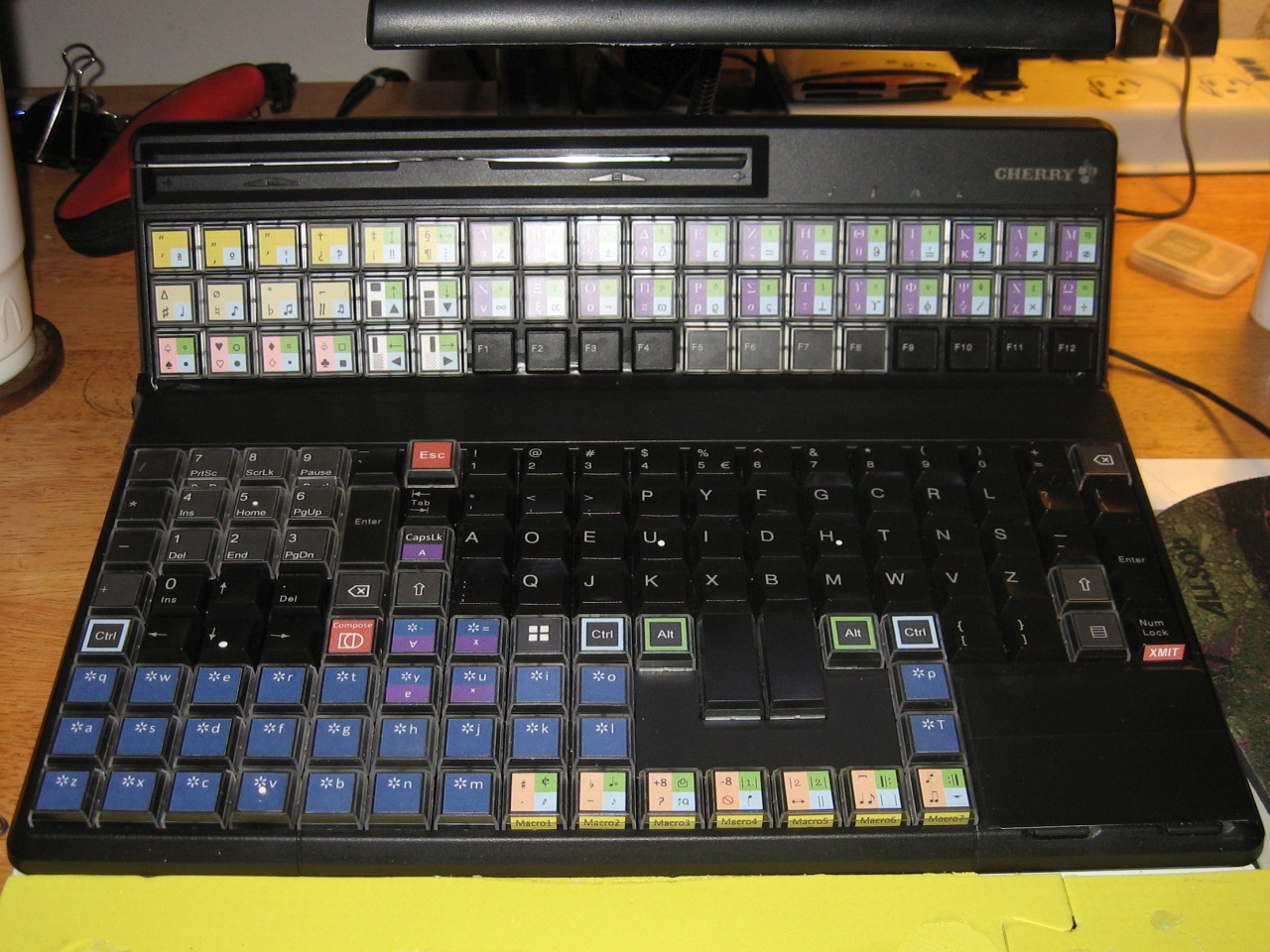

Your duplicate Backspace is at least a solved problem — reassign CapsLock to be your second Backspace, as the Colemak layout does, and assign the CapsLock function to some other key or combination of keys. Personally I've got my number and cursor pads to the left of the alphas, and I just included a Backspace among those, easily reachable by the left hand in either the normal or numeric situations. I also included a third Ctrl key to the left of the left arrow, to facilitate one-handed document navigation. Of necessity this is a duplicate of one of the two existing Ctrl keys, but that just means I can't use it as yet another modifier in combinations (not that I would want to, it's too far away from the alphas). I also have an Enter to the right of my left-handed number pad, easily reachable from the alpha area just like the Backspace is.
Escape I make more accessible by making it taller. It stands about 4 mm above all the other keys and can be located quite easily by feel. This is essential because it's not in the corner of anything. To do this I took a key and cut the stem out of it, leaving only the relegendable square top. Then I took a damaged key and trimmed it down enough to be inserted cleanly into the square top, and glued them together. Voilà, a taller key.
For keyboards that have all the F keys in a continuous line without gutters, having F5-F8 stand taller than F1-F4 and F9-F12 would also be a pretty simple way to make them easier to discern without changing the layout. Perhaps they can be the same as Escape.
- battleship.jpg (294.87 KiB) Viewed 11053 times

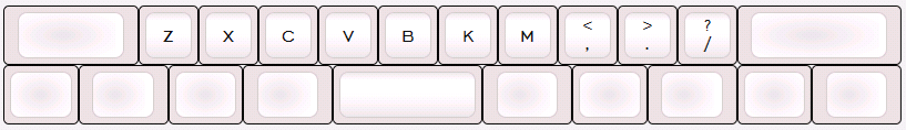

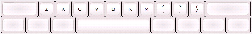

Without stepped keys, there is exactly one reasonable configuration where the bottom row mods are all the same size and the space bar is centered:
Many keyboards have different sized modifier keys or the space bar is off-center slightly, or both; which is fine I guess, but we can do better:
This arrangement also visually separates the modifier keys from the normal keys not only by size, but spacing, which I think is an underused design element. Of course you could just use 1.25U modifiers spaced out like that, but then the top of the case would have to have little prongs to fill the space and it would be ugly.
Here is a variation:
Having stepped and hat keys in the design palette gives you options when you are working on weird layouts, for example with the arrow keys integrated into the right hand side of a 60% board, how do you visually separate the arrow keys from the right hand modifiers? Here's one way:
Mind you, these are very narrow hats we're talking about here, the "brim" is only 0.125U on each of these.

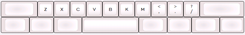

Having the space bar in the middle does not work properly. The Sholes' typewriter staggering is not symmetric for both hands, and people don't press the space bar in the middle unless they learned to type on Japanese keyboards: they press it either with the left or the right thumb - on the left or the right side, I.e. below C,V or below N,M.
- bottomrows.jpg (33.13 KiB) Viewed 10976 times
- Muirium
- µ
- DT Pro Member: µ
Aye. I can vouch for this. My spacebar shine says NM = right thumber. And in fact I'd rather put backspace on the left side of a split spacebar than out on a pinkie.

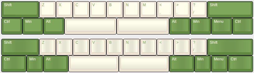

This is such a silly nonsensical constraint to apply to designs. Here, have some better symmetry and more usable modifier positions:
(Though the right shift is still a key too far away. Better would be to add a column between hands, and move the slash key elsewhere on the keyboard.)

This is why I pull Ctrl in to be next to Alt, with the Win or Menu key outside that (I see no reason for two Win keys). Between this relocation and the fact that the space area is only 2U wide, Ctrl is accessible to either a thumb tuck or a curled middle finger. Alt and AltGr are almost always best done with the thumb.
My basic layout doesn't have a row below the mods. The only keys extending down into that area are the spacebars. My personal, extended layout does have keys in not only that row, but two rows below it as well. My wrist pad has to be high enough to keep my palms clear of all those extra keys. It doesn't hurt that I don't actually use Ctrl all that much, because of the twenty-nine one-touch Control-enabled keys.
- Location: Stockholm, Sweden
- DT Pro Member: 0011
It is not that much of an improvement, to be honest.. Win keys are an abomination and the Sholes and Glidden typewriter layout was never symmetric to begin with.
Merge the left Alt and Win keys, lengthen the right space bar to the right and then merge the right Alt and Win keys into one Alt key - that way, the keys fall into their conventional places.
Having 1u Control keys in regular concave profile in front of the space bar would be uncomfortable. The µTron has its thumbkeys sloping diagonally and also being farther away - actually emulating the fan arrangement of earlier Tron keyboards while forcing them into a row layout.
If there should be keys in front of a Space Bar and not sloping diagonally, they should be like on the NeXT and UHK keyboards: flat or convex and lower profile.

Okay fine... better would be something with two split hands, more space between finger and thumb keys, and not arranged in a rectangular grid-like pattern.
But while we’re leaving those as constraints, this works pretty well, in my tests on little prototypes.
Also, if you like, ignore the key labels. Use those “win” keys for some kind of function layers, move shift to be directly to the sides of the pinkies and put a few symbol keys to be where the shifts currently are, etc.
Making the bottom row symmetric relative to the “home row” and concentrating it toward the center of the keyboard is a very significant improvement over the brain-dead bottom row on a standard keyboard.
I’ve posted this in other threads before, but this layout actually works surprisingly well considering how close it is to the standard layout. It includes all but the three useless top right keys from a standard TKL keyboard and it can be learned effectively in a matter of hours/days:
Additionally, it’s better centered and noticeably more compact, bringing the mouse in closer.
For me personally, a more radical keyboard is better, but I suspect the majority of people would be able to use this design more effectively than the standard layout and with very little transition period.
Who said anything about concave? I’d make them flat or convex, and enough lower than the spacebar keycap top that the spacebar can be fully depressed with a thumb without bumping into them. With that said, with concave shape these still work fine in practice.Having 1u Control keys in regular concave profile in front of the space bar would be uncomfortable.
