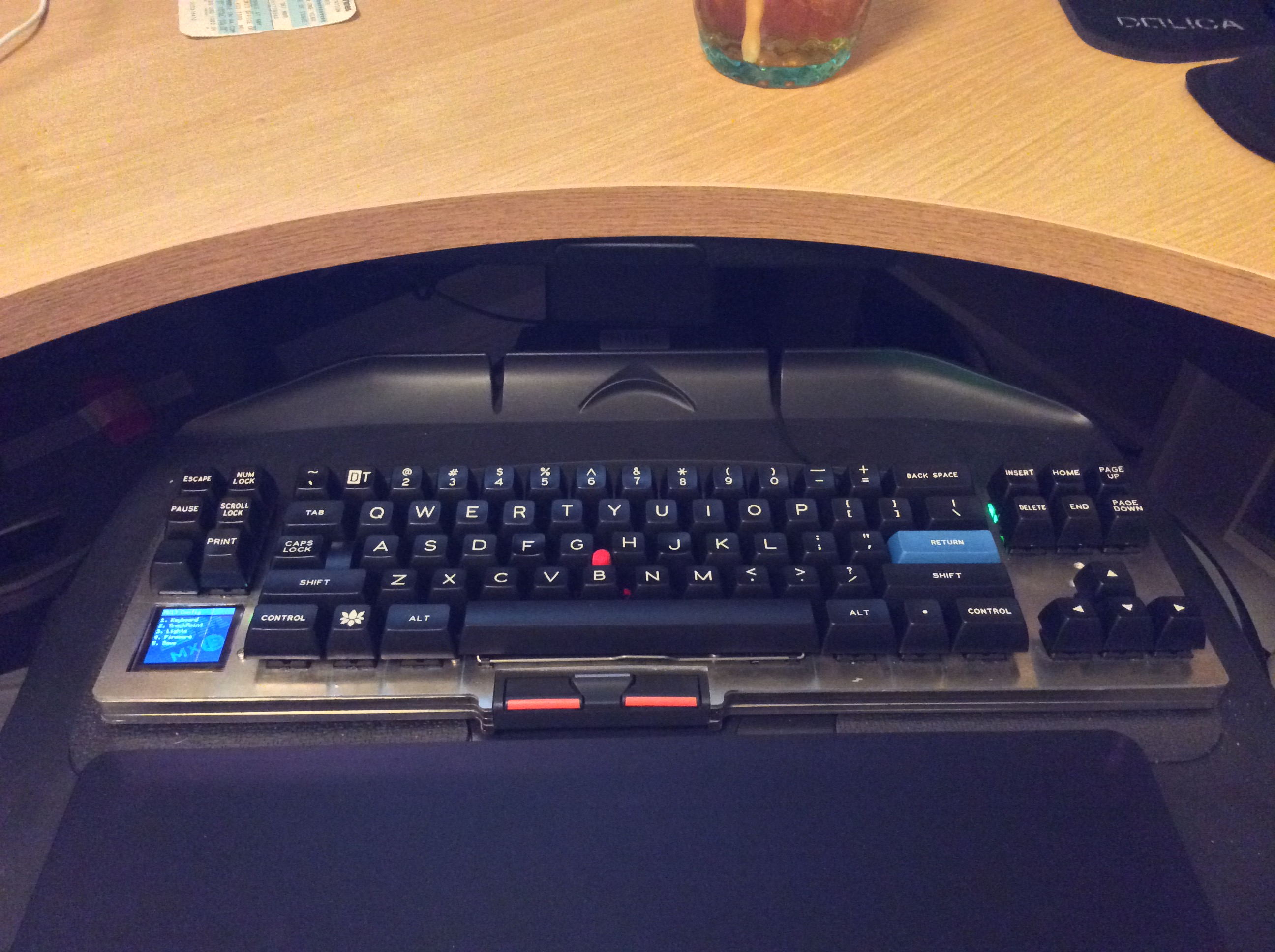

mtl
31 Jul 2015, 04:27
Round 5 IBM style :-)
[ XMIT ]
31 Jul 2015, 04:53
What is this board with a trackpoint? It looks delightful.
mtl
31 Jul 2015, 05:09
Thank you. It's a custom board built a while back as part of a group buy run by matt3o. :-)

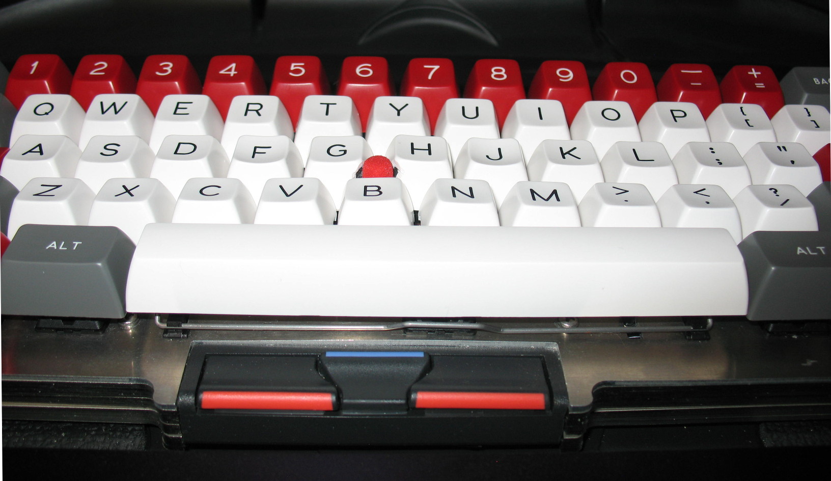

mtl

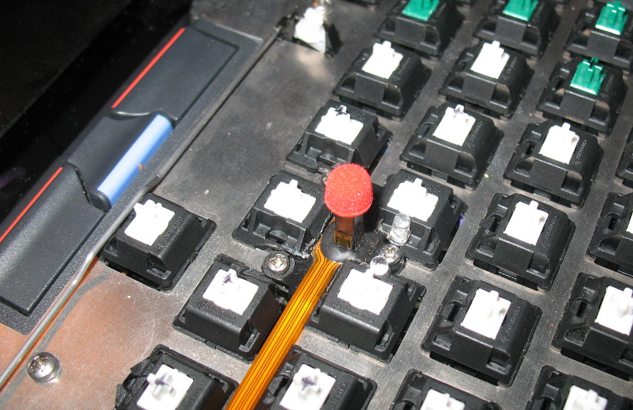

31 Jul 2015, 19:05
Muirium wrote: How much work was that TrackPoint with SA?
It's pretty easy.. just a few minutes with the dremel. The G and H key skirts need the corners shaved down, which is the most destructive part. So it's good to have the GHB kit in case I want a set for use on a non-TrackPoint board or resell them. All of the G/H/V/B/N keys need some notches made to the bottom of the skirts to clear the TrackPoint screws. These are less invasive changes.
I'll try to post pics when I do the white alphas, which should be easier to see than it is on the blacks.
So far I've only used SA caps on it. Using lower profile caps may not work so well, since the TP was mounted with the height of SA caps in mind.

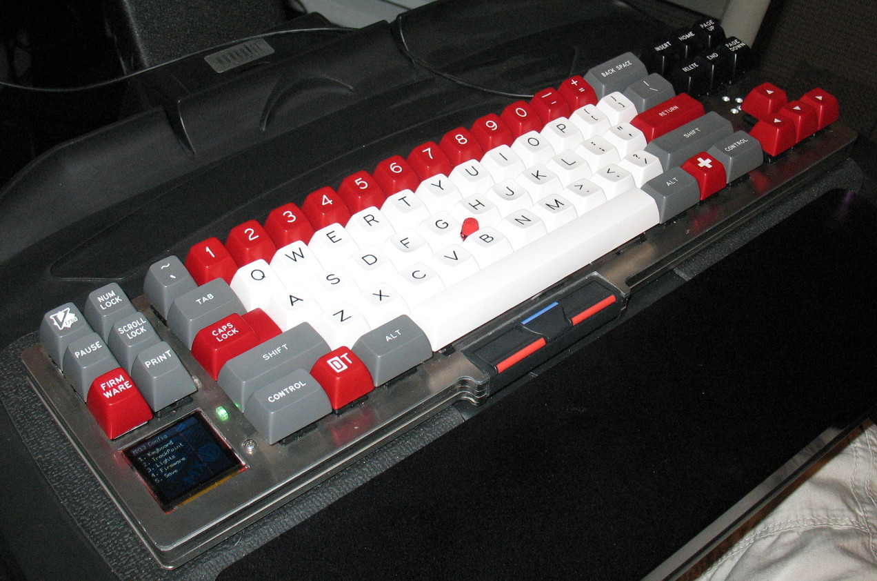

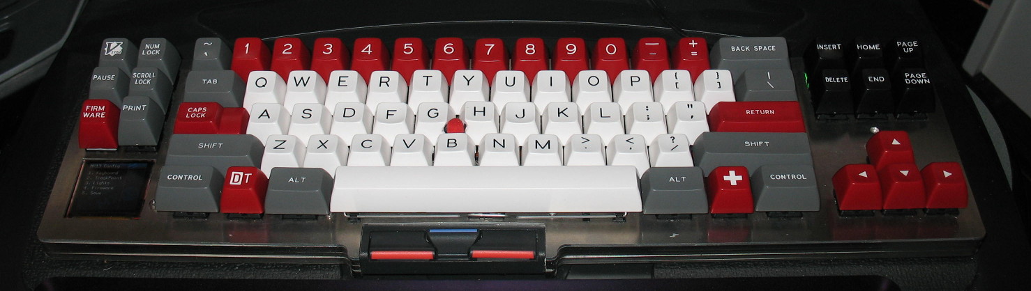

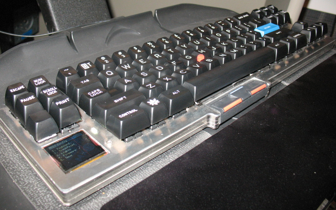

mtl
01 Aug 2015, 04:12
Another pic of the IBM theme:
Honey theme:

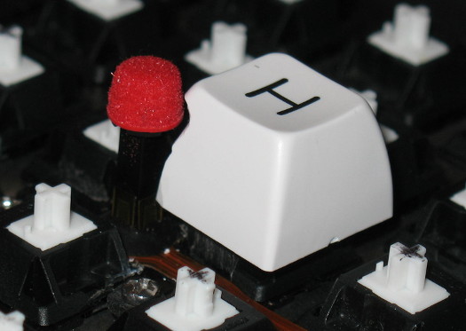

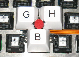

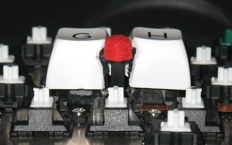

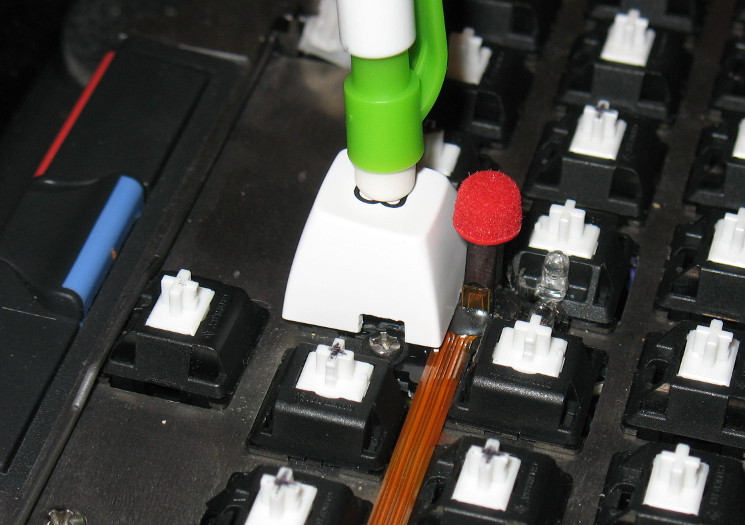

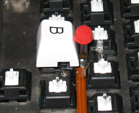

01 Aug 2015, 04:20
The TrackPoint has screws that interfere with the key skirts on the downstroke..
The G, H, V, B, and N keys all need notches cut in them to clear the screws. Here's the B key in the up position:
And down:
The G and H keys also need the corners chopped off to clear the TrackPoint itself. Here's the H key:
As you can see, the 1st shot color shows through. It's not bad with the black keys, since it's easy to use a black sharpie to hide the white legend color. On the white keys, you can see a little black:
The final result:

mtl wrote: The G and H keys also need the corners chopped off to clear the TrackPoint itself. Here's the H key:
Looks brutal, but so worth it. Thanks for sharing the process, I like how Round 5 has got you posting more pics of your extraordinary custom. You must be very proud. (Thanks to Mu too for asking about it.)

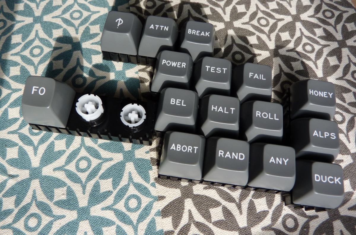

facetsesame
Mad Dasher
01 Aug 2015, 11:45

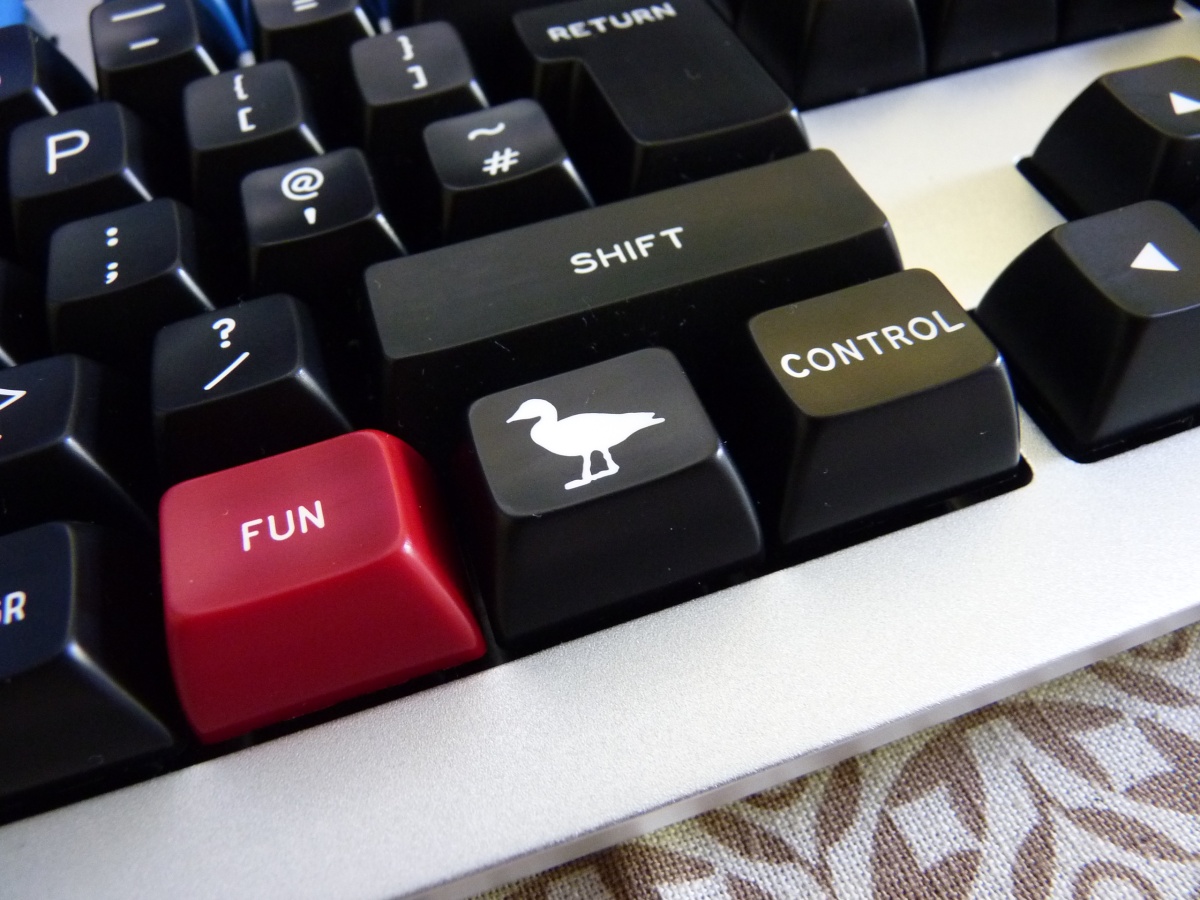

The notorious FUNCTION2.
01 Aug 2015, 13:05
facetsesame wrote: The notorious FUNCTION2.
An eternally spinning loader for a picture that doesn't exist of Round 5's most exotic kit of all. I see what you did there!
facetsesame
Mad Dasher
01 Aug 2015, 14:55
And yet I can see it, even in your post.
On a strange level, it does seem right that the image should exist only in my own local cache imagination.
Still on a weird level, it seems plausible that my sub-concious would see that the attachment deleted, never to return.
Forget it, I'll just re-upload it, hopefully properly this time. What's the worst that could happen?
01 Aug 2015, 15:19
Ah, now I see it. ABORT ANY ALPS indeed!
(Dullard technical note: Guess it was just local caching in your browser. I see the new attachment 22789 just fine now, in all the places it appears. The original 22788, quoted by my earlier post, is still missing.)
What are those MX mounts you have these displayed on? They look vaguely like delayed click Futabas! Click.

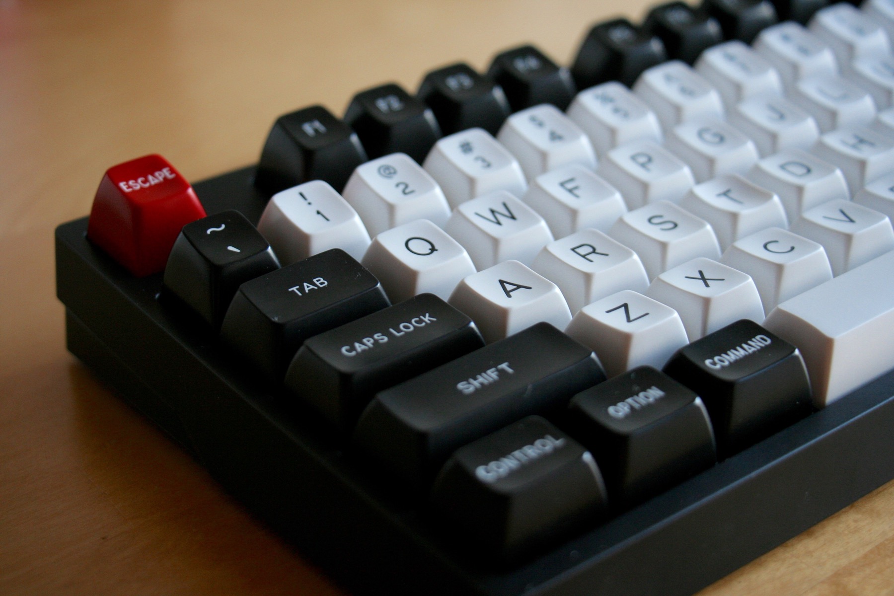

Supergeek
01 Aug 2015, 17:31

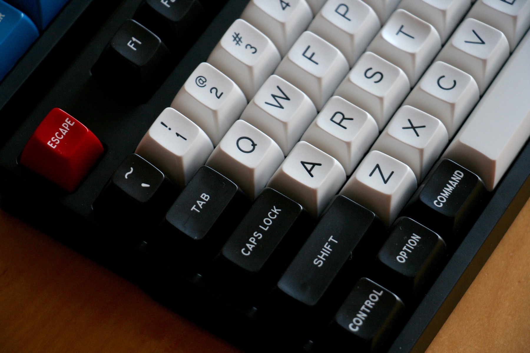

This is what I have now:
I have on order the rest of the blue to replace all the gray, and a set of red alphas, which will give me two complete sets. I use three workstations on a regular basis, and I love the SA so much I realize I must have them on my other boards. I think the red and gray will look amazing together. Sort of like this, but with gray instead of black:
01 Aug 2015, 17:37
The inverse of this:
http://deskthority.net/post242148.html#p242148

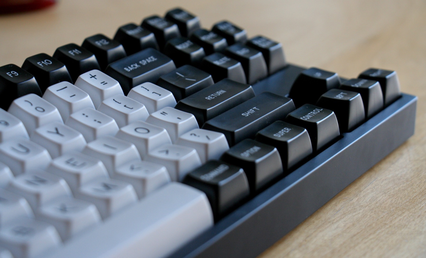

As far as I can tell, literally every combination in Round 5 looks good.
Supergeek
01 Aug 2015, 18:29
Muirium wrote: The inverse of this:
Yes, exactly.
Most of the photographs don't do the red justice. It's more like blood red than fire engine red.
Muirium wrote: As far as I can tell, literally every combination in Round 5 looks good.
Yeah, I wish I could justify spending the money to get every combination...

Supergeek wrote: This is what I have now:
Blue and white! Very nice indeed, I hadn't put them together before somehow. Likewise the red and grey. Looking forward to seeing these!
