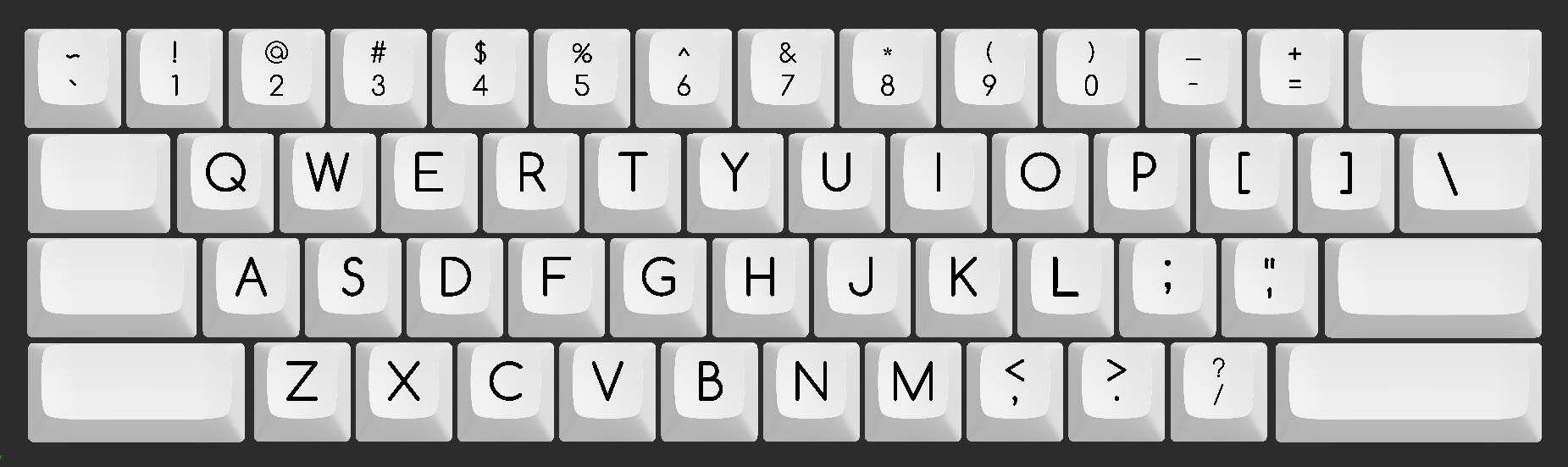

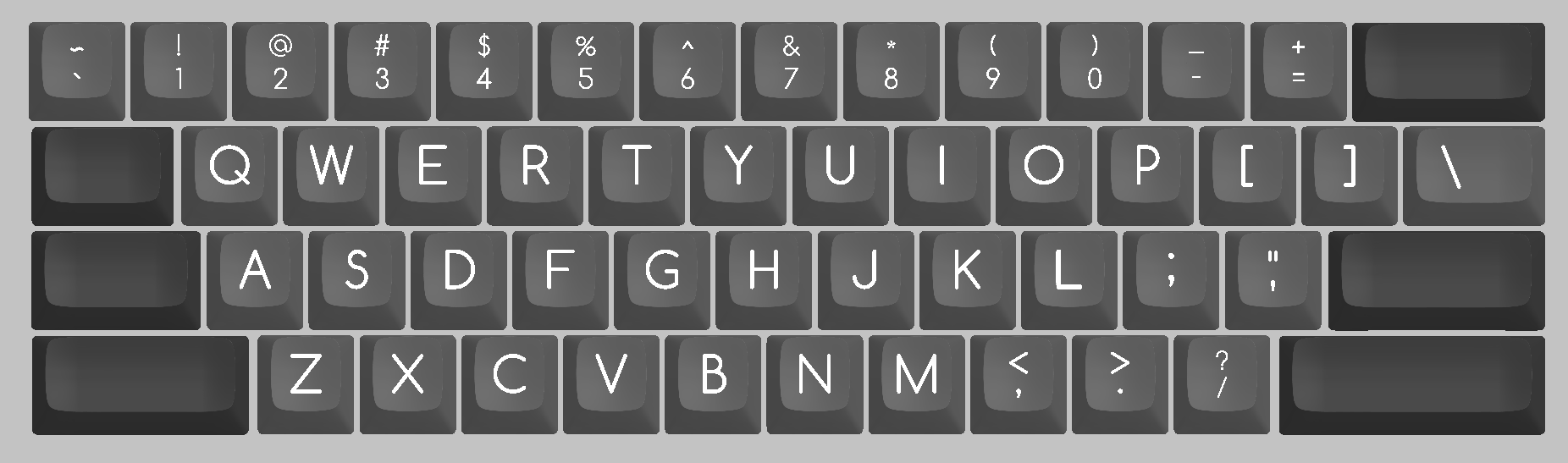

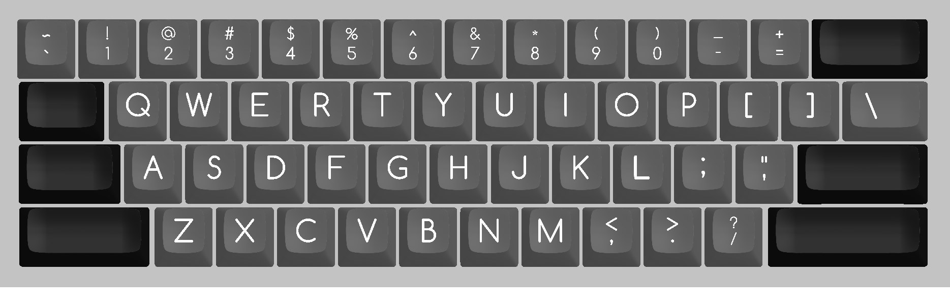

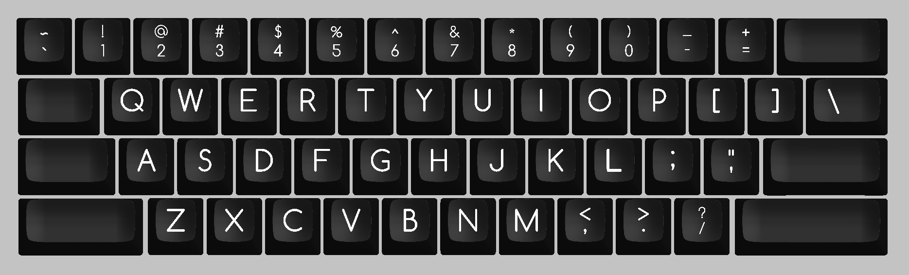

How's this for starters...
- blk_wht_legend_sample.PNG (170.74 KiB) Viewed 8082 times
- wht_blk_legend_sample.PNG (159.35 KiB) Viewed 8082 times
- wht_gry_legend_sample.PNG (153.67 KiB) Viewed 8082 times

what kind of home row indicators will be there if any? Deep dish, like on beamspring, or some bump as on model M?

I hadn't really given a whole lot of thought to home row indicators, They would have to be a bump or bar, There is not enough clearance for deep dish keys in the current configuration. I'm open to opinions on the subject. I don't touch type so I don't have a preference myself.
The current tooling scheme would allow for any of the 1u legends to be indicator keys for custom layouts of desired if they are done with a bump

It just occurred to me that I never commented on the proposed colorways. I love it! Especially if we can mix and match those together--white on gray alphas and black mods would be awesome.
Dumb question: Does this mean that the mods would only be available as blanks for the first run(s), or just that you haven't decided on legends for those yet? In principle I'm okay with either--as long as we can buy just a set of mods with legends in a later round.

Those colorways were not meant to be proposals and I would suspect mixing them up would be expected. I was really looking for feedback on the font mostly.Techno Trousers wrote: It just occurred to me that I never commented on the proposed colorways. I love it! Especially if we can mix and match those together--white on gray alphas and black mods would be awesome.
Legends for mods have not been selected by any means. I would like some more discussion on those as well. Blanks would of course be an option.

I like the fonts and sizing, but I'd be the first to admit that I'm not as picky about those as others are. I hope lot_lizard will weigh in here when he gets back from all of his business travel. He really has a lot of knowledge about the historical fonts.

Not a fan of the font. Wouldn't you want to go something a bit closer to the original?

I am not against historical fonts but I generally find something that could be done better in any of them, including the one presented. That said I do like it. I'm curious if if it's close enough to a classic font and if it has the "right" feel. It can of course be altered or scrapped if needed.
One thing that is important to me is whether or not I can get specific permission to use any given font, There are no issues with this one.

Original what, M, F, Beamspring, something else?
I could conceivably use any of those as inspiration for creating a font for this project but would definitely need some insight from people on what they love and or hate about original IBM fonts and WHY so the spirit of the work doesn't get lost in any new work.

Original Beamspring/Selectric font. If you're going for the shape, the whole nine yards I think works best.
Just a whole cohesive throwback to the originals.
