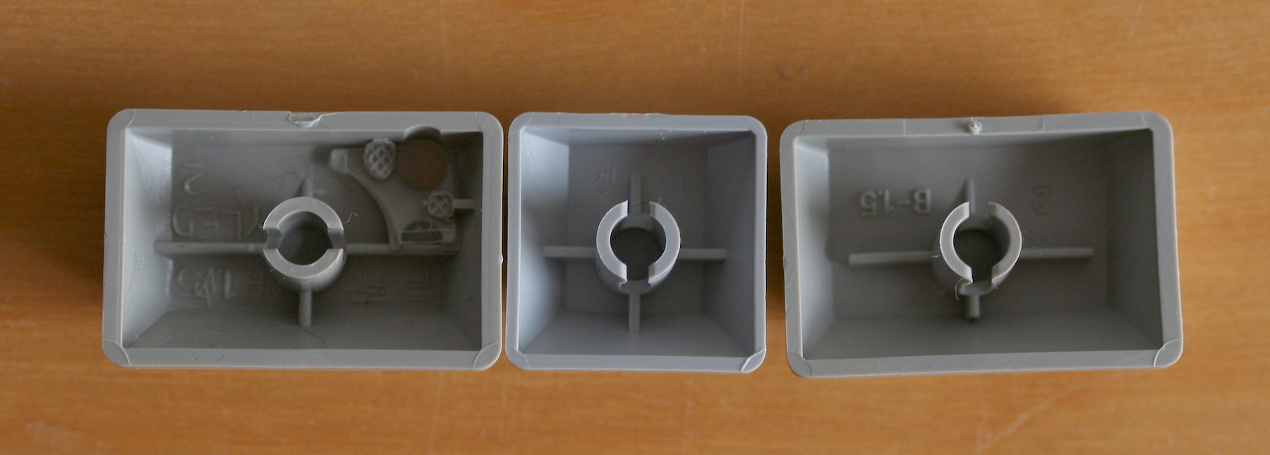

Oh for the love of duck…
Left Control — HHKB Alt / Option — Right Control
I'm glad you spotted that 90º rotated mount, because this is just the kind of thing I don't. (If it looks symmetrical, I don't notice.)
We're going to need a whole extra Control key just to suit the TKLs, aren't we?
Anyway, I'll spin that slider 180º when I've next got the Realforce open. But not 90º!

@Muirium: You will need to look at the slider from the back, which, unfortunately, means that you will need to open it up again. I think you will need to rotate the slider to its correct orientation.
Pop the cap off the Right Ctrl and you will see that the slider has a different design from that of the Left Ctrl, and the inside ridges are horizontal on the Right and vertical on the Left.

Muirium wrote: We're going to need a whole extra Control key just to suit the TKLs, aren't we?
Yes :)
The keycap sets that Topre produce contain a single windowed 'Control' key with the horizontal mount stem. It also contains the normal vertical one for standard Realforce. I am pretty sure that this horizontal mount 'Control' is unique to the *87*, and not the other TKL Realforce boards (86, 88, 89, 91).

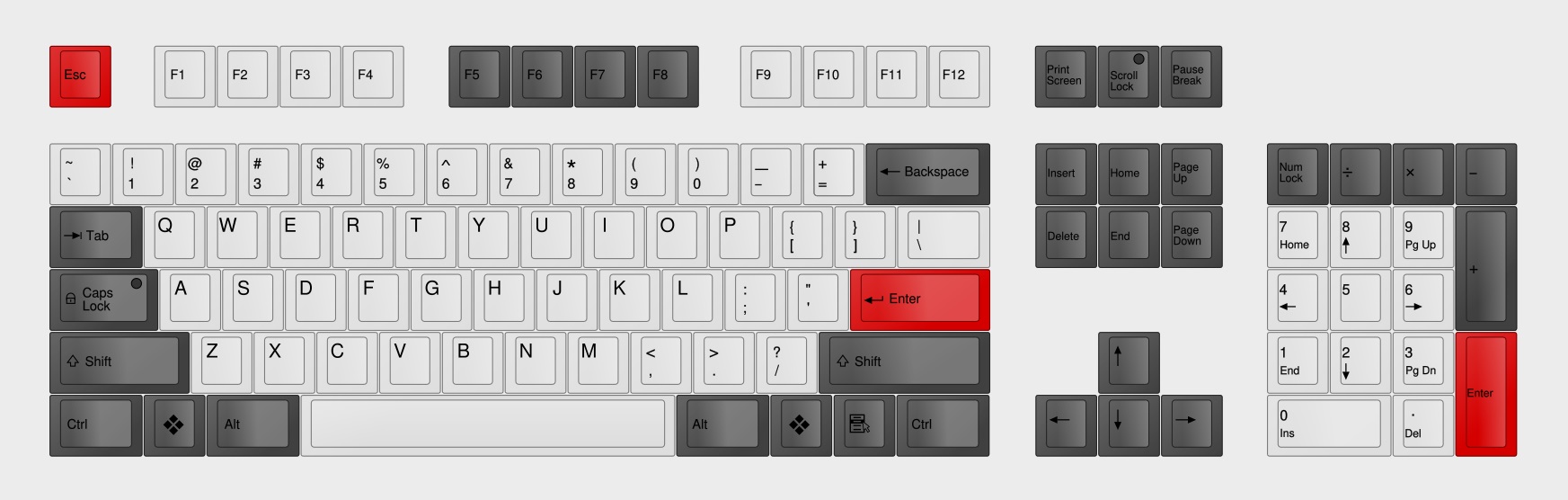

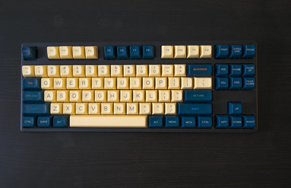

I rather like the design of the Penumbra set:
Among the designs that matt3o has shown us thus far, I am not highly enthusiastic about any of them, but the one I like the most is the following:
The second one above might be improved by using a lighter background for the mods so that the legends would be clearly legible. Otherwise, I would prefer blanks.
Will there be an option to have the Backtick/Tilde and the Backslash/Pipe caps the same color as the mods in order to provide more color symmetry on the board?
