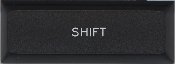

Here is a scan of the new 2.75u SHIFT key based on my legend vectors that just arrived from SP:
DSA Dolch 2.75u SHIFT key with custom legend
Comparing with my various measurements, I would say that the gap there is slightly larger than the 0.0075" gap in my "25% gap" vector file, but is less than 0.0135" which was what I was calling a 50% gap. I'd estimate it is somewhere around 0.009" or 0.010". Maybe we call it a 33% gap.
Oh, and none of the 25 keycaps I received have any apparent manufacturing flaws, and they all appear consistent with each other.

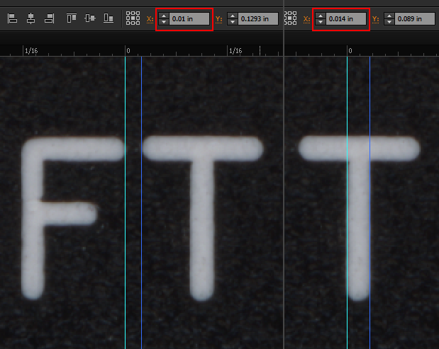

And here are some measurements:
The gap between the F and T is 0.010". The line thickness is 0.014 which is basically 1pt. If I were to do this again, I would increase the line thickness by 15% to 0.016" (or 1.15pt).
The line strokes on these keycaps are a little thinner than the original Dolch legend, but that's because I sent SP a vector file with a 1pt stroke weight on the center lines. I wasn't sure which was more accurate, 1pt or 1.1pt, and the 0.1pt difference seemed to me within the margin of error of my scanning and tracing methods. So I erred on the side of thinner (images of those early attempts at the hashbang somewhat fresh in my mind) and I went with 1pt center lines, but based on these samples, I feel 1.15pt would match the original Gorton Modified font thickness better.
