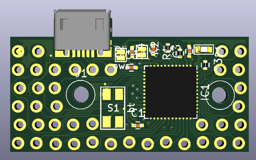

06 May 2016, 16:57
Ah we, what's done is done,
Ignore the slightly different 3d shapes, this was the best I could find.
- All 34 I/O pins still available
- Implemented the new power circuitry
- Normal pin header for Reset
- M2 screws with clearance for 4mm diameter head
- Pins on the left most are GND, 3.3V, VBUS, PWR_IN, TX, RX
- Dimensions - 32.9 x 15.9 (+2.6)mm
-[°_°]-
06 May 2016, 17:06
this is fantastic!
doesn't the reset button come a little on the way?
also wouldn't the alternate pads be a problem in case one would use headers or a breakboard?
PS: are you on github?
flabbergast
06 May 2016, 17:43
Awesome! (I think the button render is not the right one - Mohit said 'best he could find' :)
Staggered headers - the point of these is that when you insert a standard row of pins, they insert without problems, but 'tightly', i.e. they will be making contact with the sides of the holes. So it's possible to use this 'solderless' for testing, by just inserting standard headers.
I know it doesn't look pretty (especially because we have more that one row of pads). If you guys really don't like this, I won't complain too much about converting to the standard ones. {BTW mchck did get one 'bad review' of the sorts "these guys could not even line up the pads properly"}
mohitgarg
06 May 2016, 17:51
That's an oversized switch, don't have the 3D model for the exact one (I've thus removed it in the render below to prevent confusion.

mohitgarg
06 May 2016, 19:14
One problem I see with our current board is that I tried to see how to place this around a switch and it seems impossible. There are too many pins in a small area.

mohitgarg
06 May 2016, 19:31
Screw holes won't be needed if mounting to a PCB any way, but the issue with the position of the pads is still there.
@matteo, we are assuming the primary use to be hardwired? If not, the current pad positions clash with the pads of the mx/alps switches when placed under a switch
-[°_°]-
06 May 2016, 19:39
scenario 1: hand-wired
you can put the board wherever you want based on case type mostly. best spot is still under the spacebar but you can also use the onboard port if you have room on the upper part of the case
scenario 2: pcb mounted
you cannot use the onboard port. this is the same as any other board of this kind. there's simply not enough space on the PCB. you have to put the board anywhere on the PCB where you have enough room and route an extension to the USB. If I read your schema right, this might be a bit complicated since we don't have a +5 pad and you'd have to add a small patch cable.
hope I'm not missing something obvious here.

mohitgarg
06 May 2016, 20:06
Both the scenarios can be catered to fine with the current design.
-[°_°]-
06 May 2016, 20:08
now that I think of it, I'm not sure we can use through hole USB port if we want the board to be positioned flush on another PCB
flabbergast
06 May 2016, 20:11
If I read this right, Mohit is concerned that this can't be mounted on a PCB directly underneath a switch, like the Teensy or his original design could. This is a valid point; I thought that it's supposed to be mounted primarily underneath a spacebar.
I think if we want to make it mountable directly underneath a switch, a 'taller' board is much better (i.e. pretty much Teensy 2.0 dimensions).
