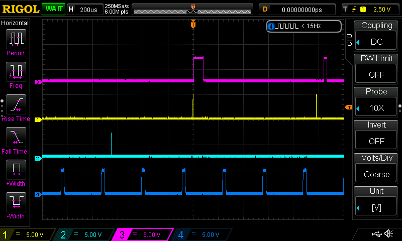

So. I've added the expansion header to the project (it was laid out from the start, I just didn't have any use for it till now), and sprinkled the logic with GPIO driving commands. Here's what I discovered.
1. Things work as expected. It is still possible to press 2 keys at the same time (left key always wins in this case), but it's damn hard now.

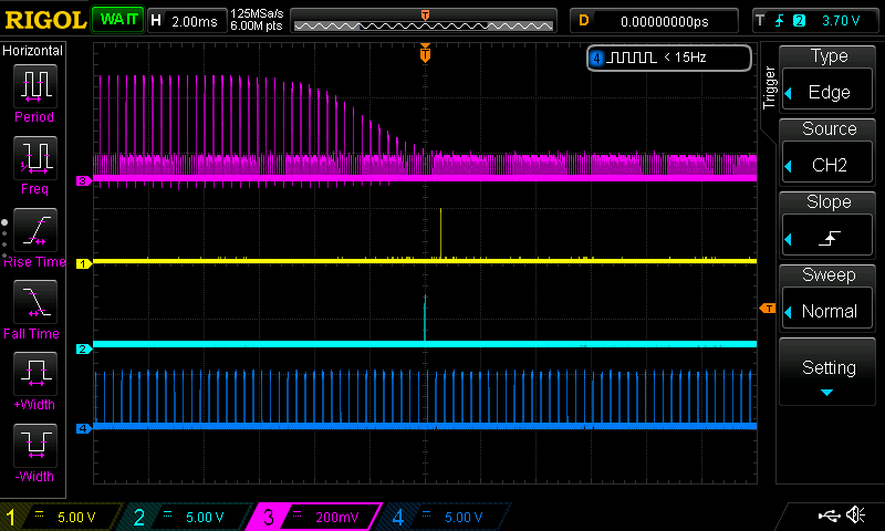

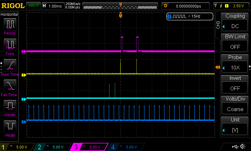

Ch2 is "scancode added to scancode buffer", Ch1 is "scancode processed, resulting keycode put to keycode buffer", Ch3 is "keyboard report updated and dispatched over USB", Ch4 is a row line to show scan pulses.
Closer look. Some jitter is visible between key processing and shipping the report.

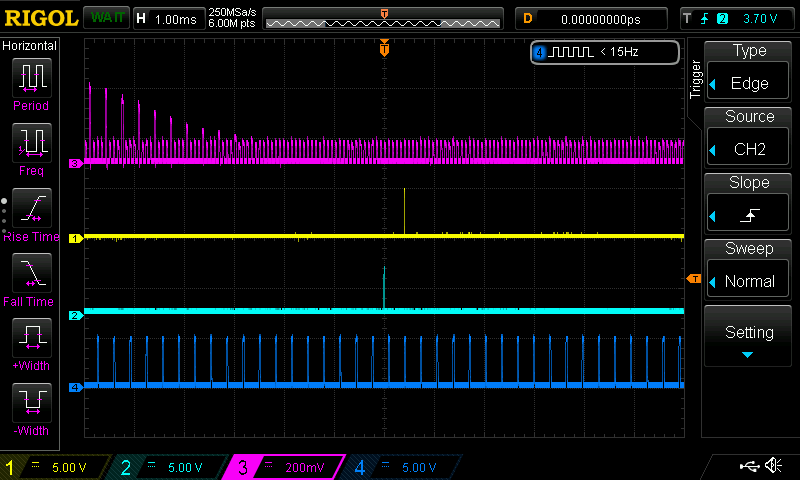

That's how things look at the sensor with no noise filtering. Here and below Ch3 is a sense line.
Lightning-fast, but should you catch a noise spike at the right moment, you'll have a spurious keypress.

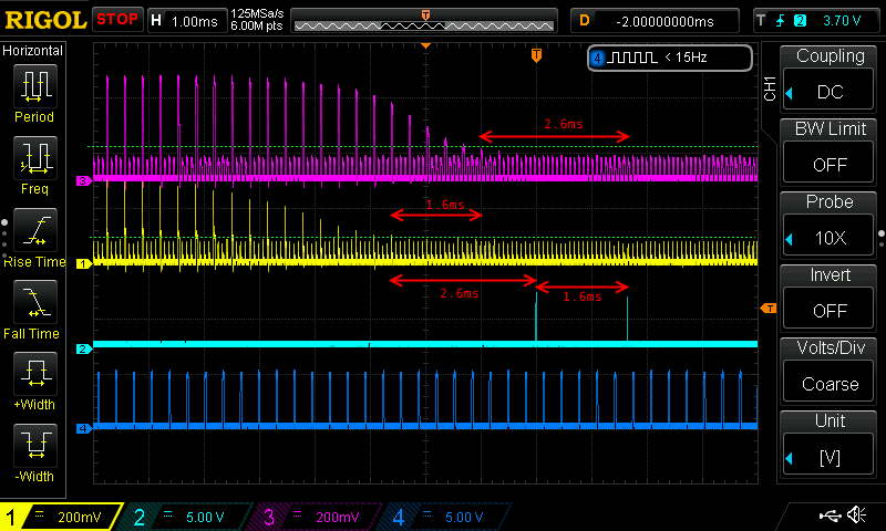

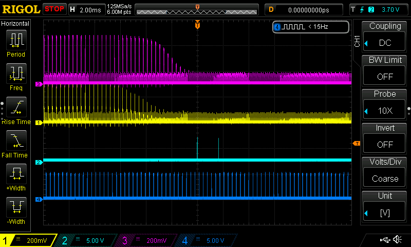

Now adding IIR 3/4 filter (Supposed to be "result is 3/4 of the old value and 1/4 of the new" - but implemented as "result is 3/4 of old value + new". The reason is when your input signal is less than 4 - it becomes zero when you use bit shifts to divide.)
2.5ms delay. "Wait, but that's 9 samples, not 4!" - you'll say. That's why it's called _infinite_ impulse response! Yes, I kind of expected 4. But because only readings under that dashed green line count, and the threshold (for the filtered value) is that same line. You can reduce delay by shifting threshold higher - at noise immunity's detriment.

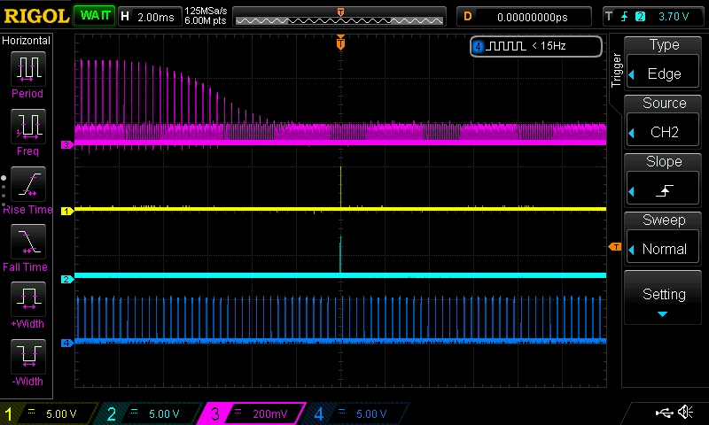

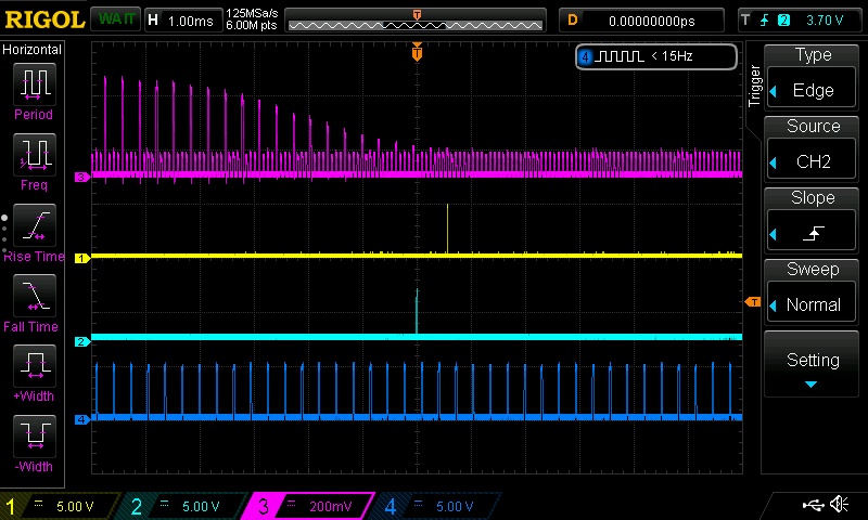

Now for the interesting part.
Ch1 is an adjacent column now.
Sorry, no pictures with same-millisecond keypresses . Because of beam springs' nature, to get picture readable I had to hold six keys (two columns, 3 rows) and then tap two others. Since I only have two hands, I had to resort to single trigger mode on the scope and rearm it manually after every attempt. It's tiresome :)
