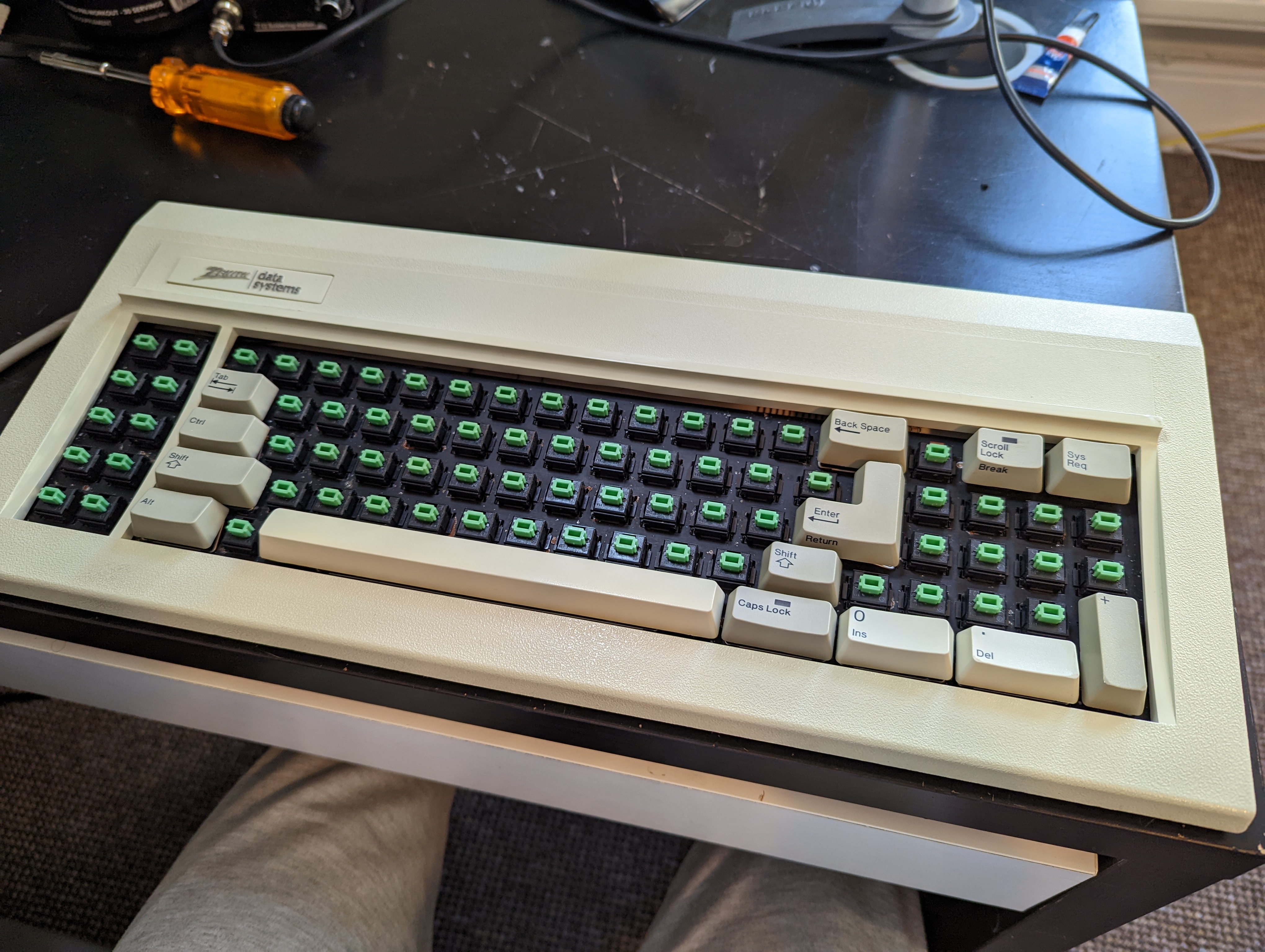

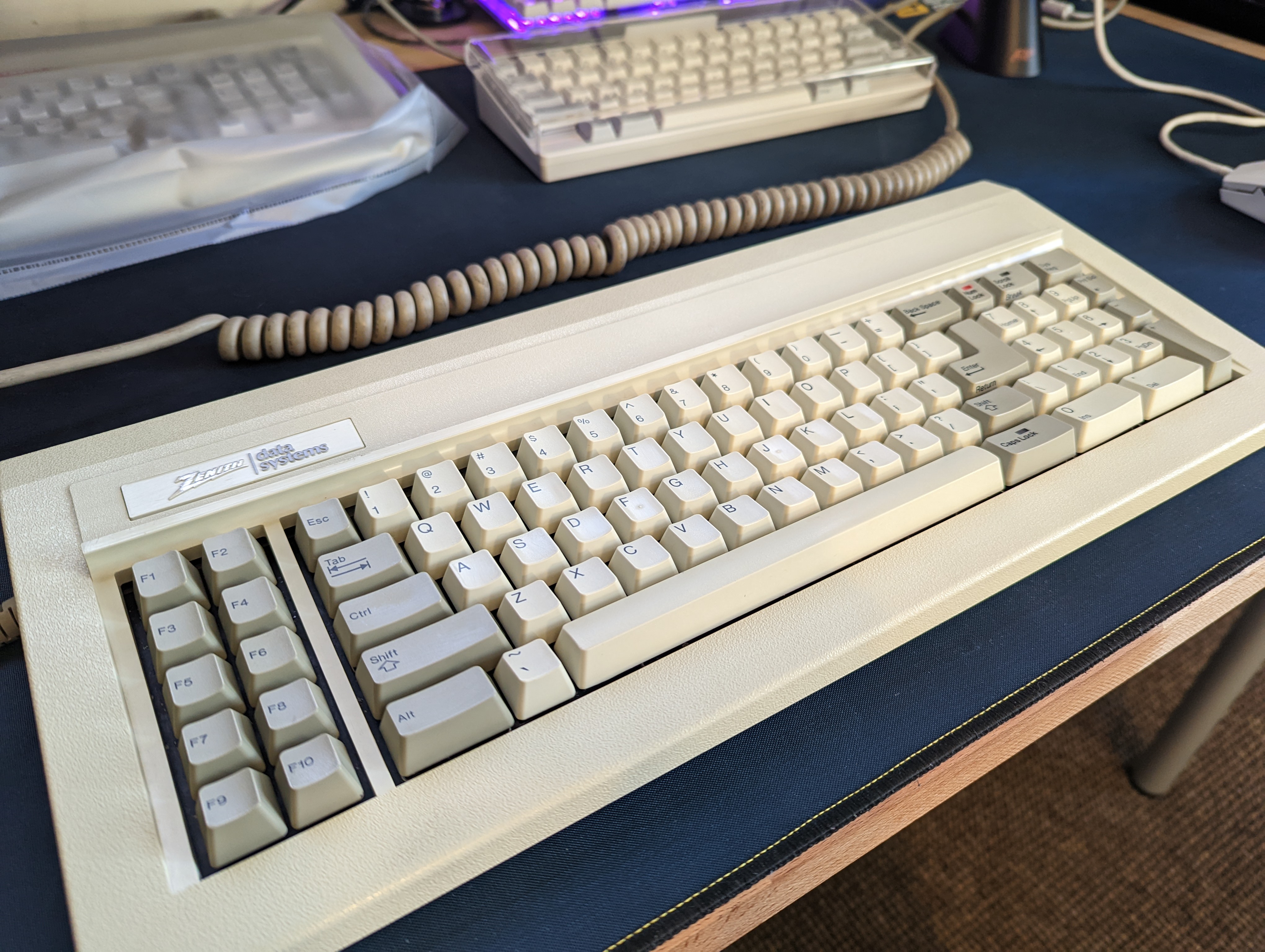

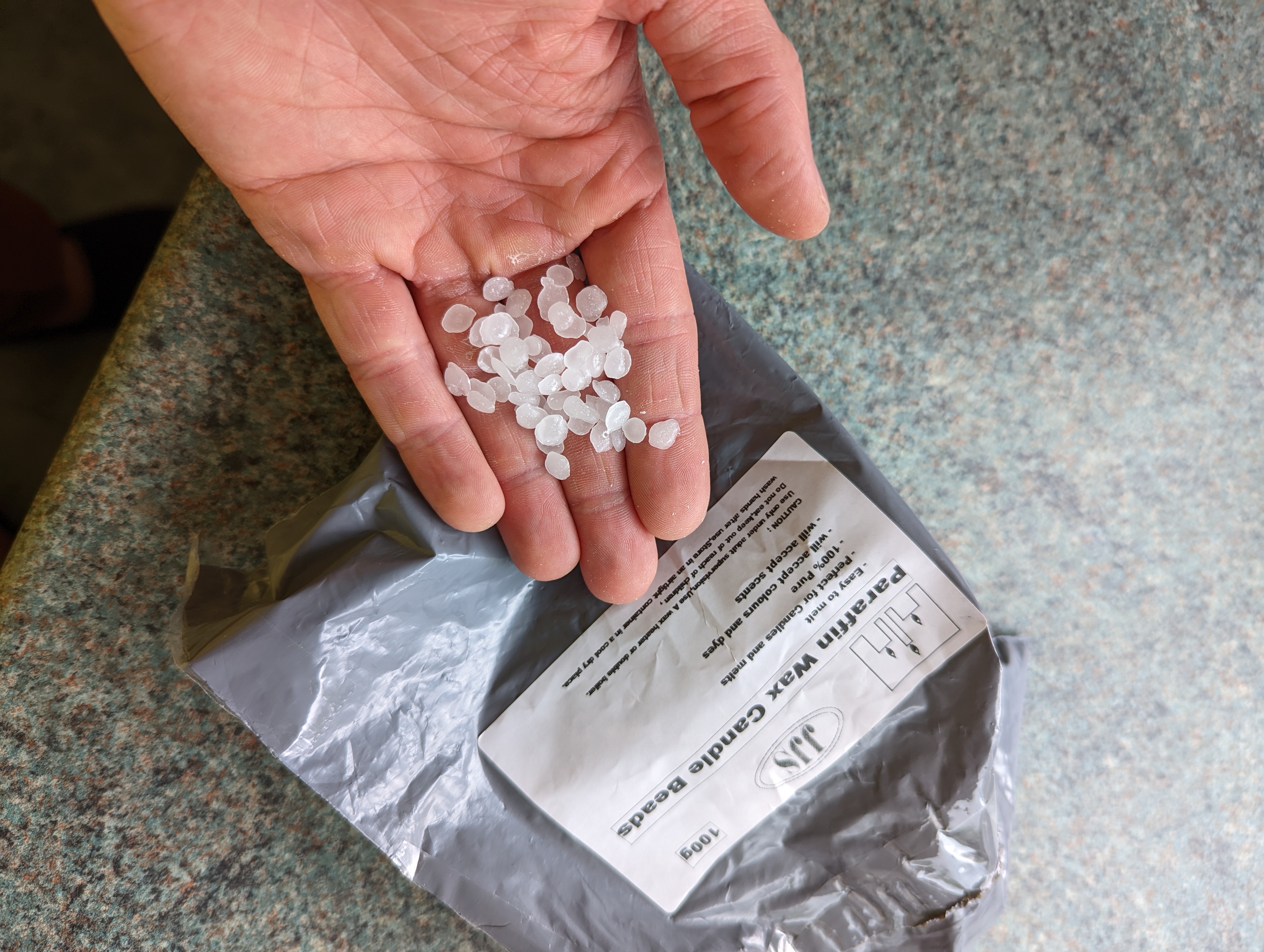

O.K., so the first thing to note about this mod is that it doesn't appear to be particularly time consuming/labour intensive. When compared to your typical MX lube job anyway. What does get you is having to dry out the insides of the sliders. On balance, I'd say it is still quicker than standard lubrication methods. But what about the feel!? Well, I have a few NOS Alps on hand, and also left a few of these used Greens stock for comparison (and because it was too challenging to remove the LED associated switches). I can say that the switches do feel the same as the uncleaned/unwaxed Greens. Both the cleaned/waxed and the uncleaned/unwaxed feel somewhat less smooth than the loose NOS Alps I have to hand. However, from past experience with lubing Alps and Topre, I have found lubricated switches can take a week to bed in. I remember this particularly with my BFK. A lot of effort when in to cleaning and lubing that and I was quite underwhelmed when I put it back on my desk; though, after a week of use, it was silky smooth - a large improvement. I have read that the Alps wax mod will take a similar amount of time to settle so I'm not going to pass judgement yet. At the very least, the switches don't feel any worse than they did.

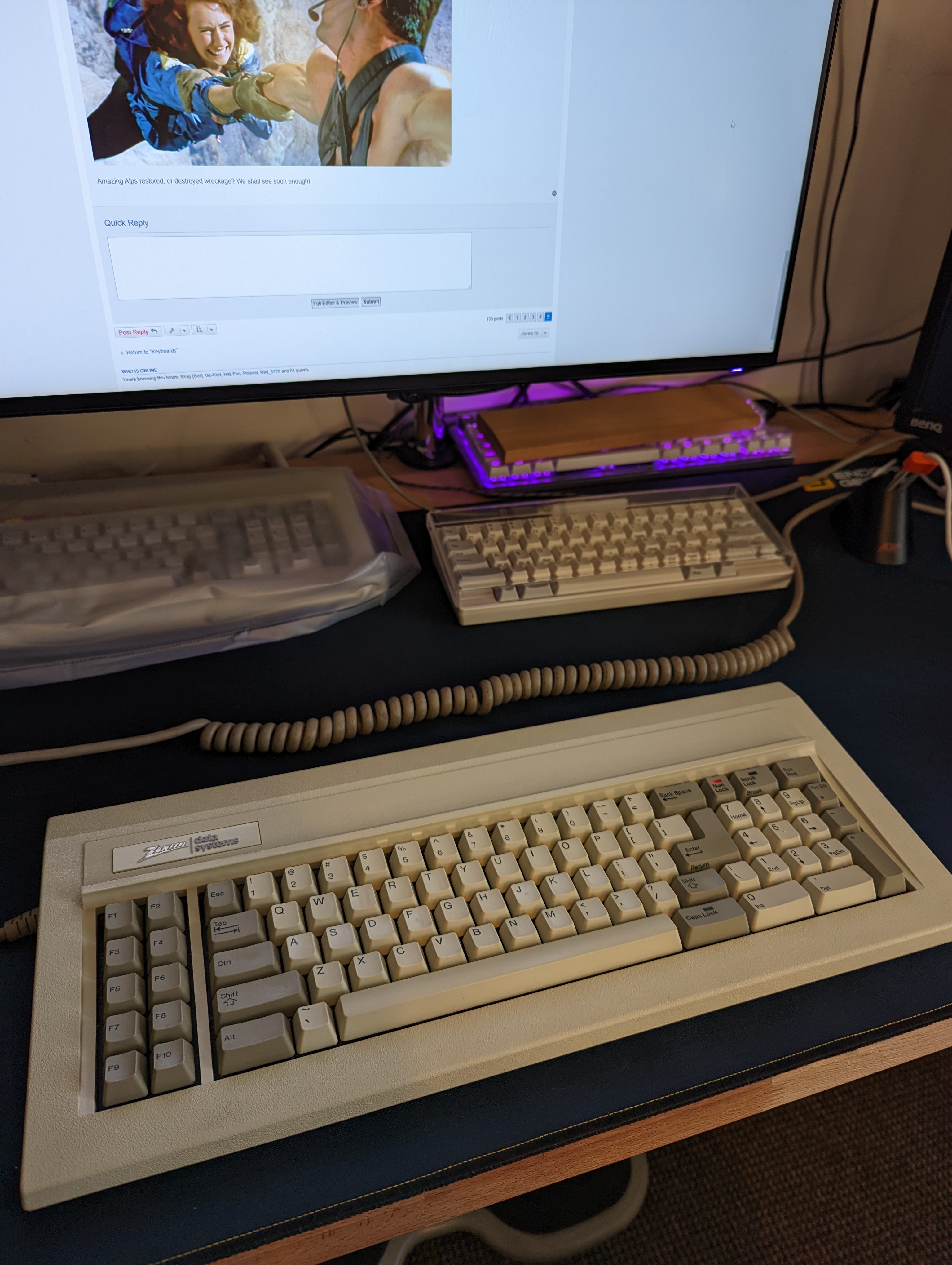

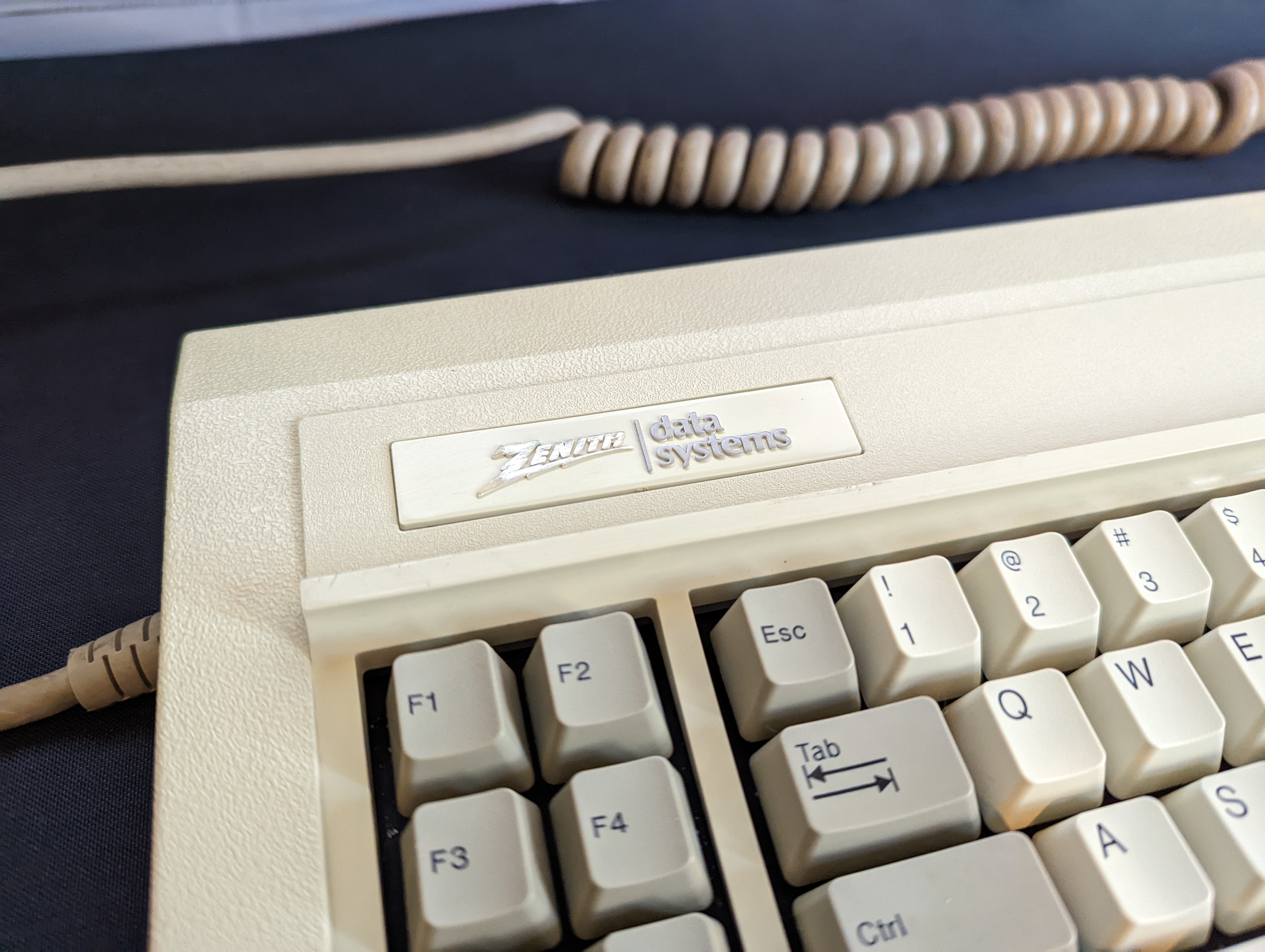

Oh, and, it's alive!!! My Z-150 is finally ready to do some work. I think I've had this board for about a year and this is the first time I've had the pleasure. I'd try and find out how to turn the beeper off but I'm enjoying it too much. This is my first time with linear Alps, outside of linearised Bamboo Blacks anyway. I like 'em. Nicely weighted, and the slight tactility near the end of the travel entertains even someone tactile gang like myself. I'd be impressed by this board's build quality but I've had an F XT on my desk for some weeks now. It's good-looks however? Absolutely. I do not prefer this board's timbre over the ping of an F like I thought I would though. Fs have thock to go with the ping! I like the layout. Having NUM0 swung out to the left there is particularly comfortable. I never thought I'd appreciate having lock lights until daily driving an F XT. This Z-150 could take prime position over the IBM for that alone if I'm honest.
So, wax mod, we shall see. Z-150 though? Winner.
23 Apr 2022, 21:14
Looking fine! How did you fix the Model F AT inflicted numpad damage? Wasn’t there a broken switch?

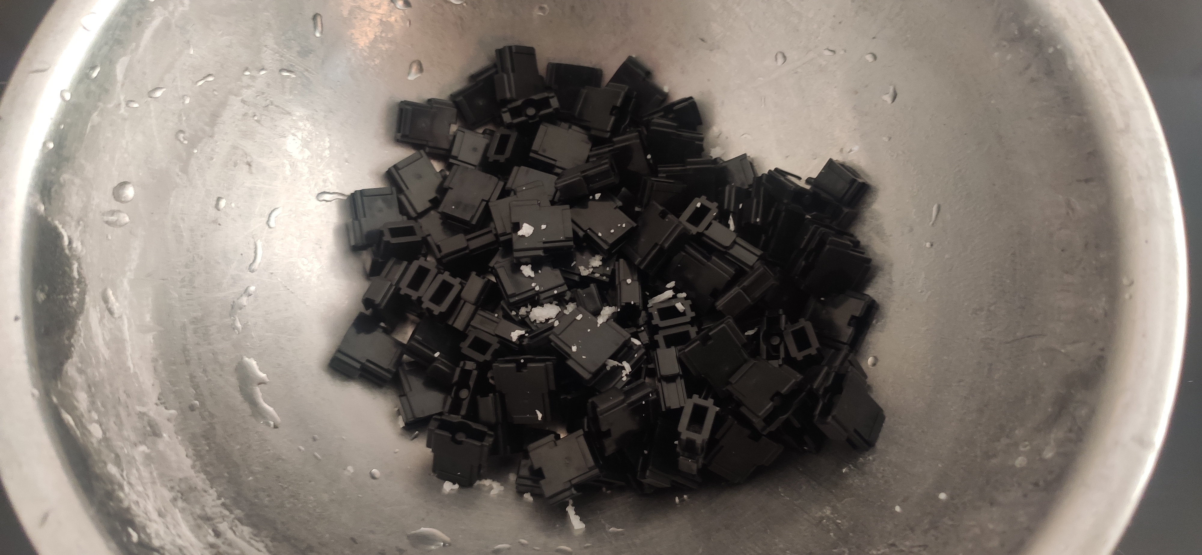

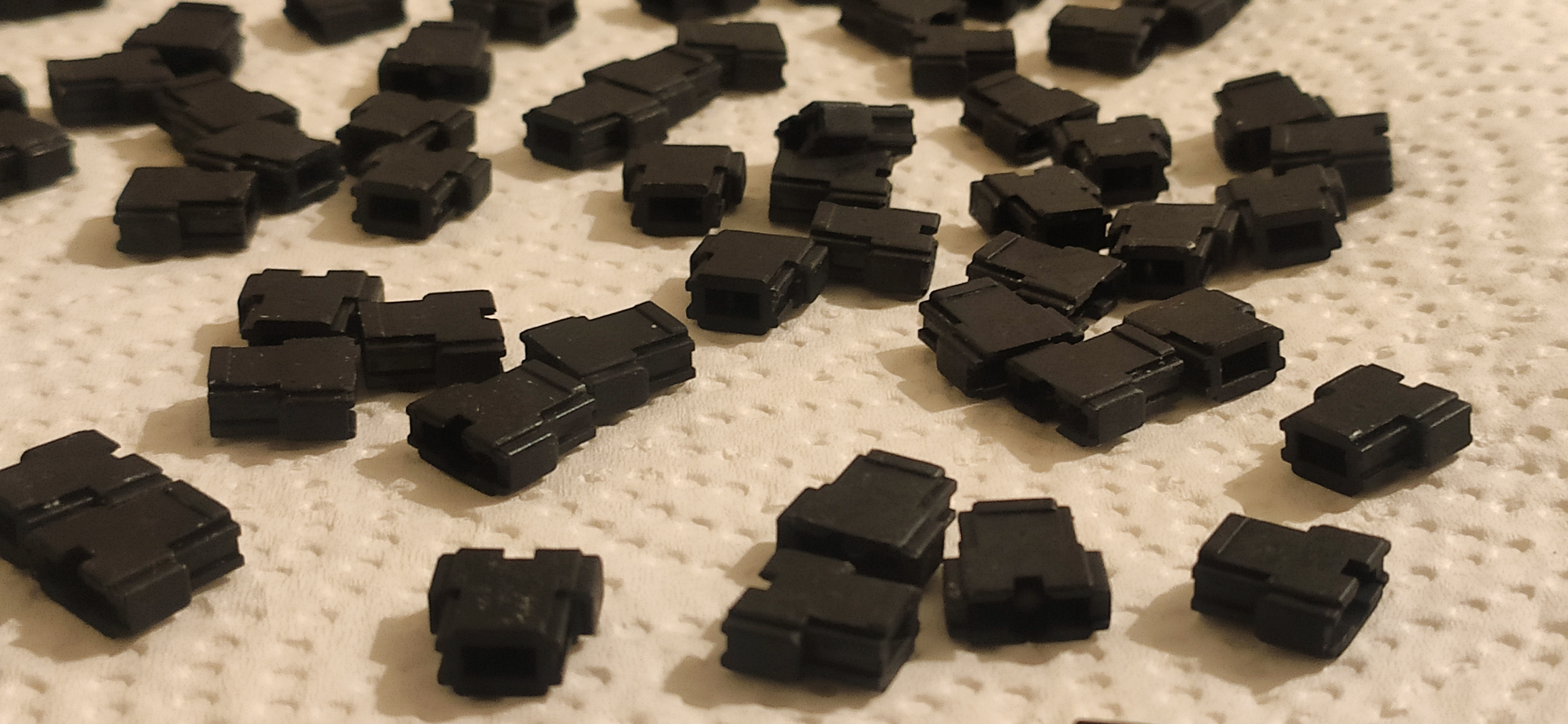

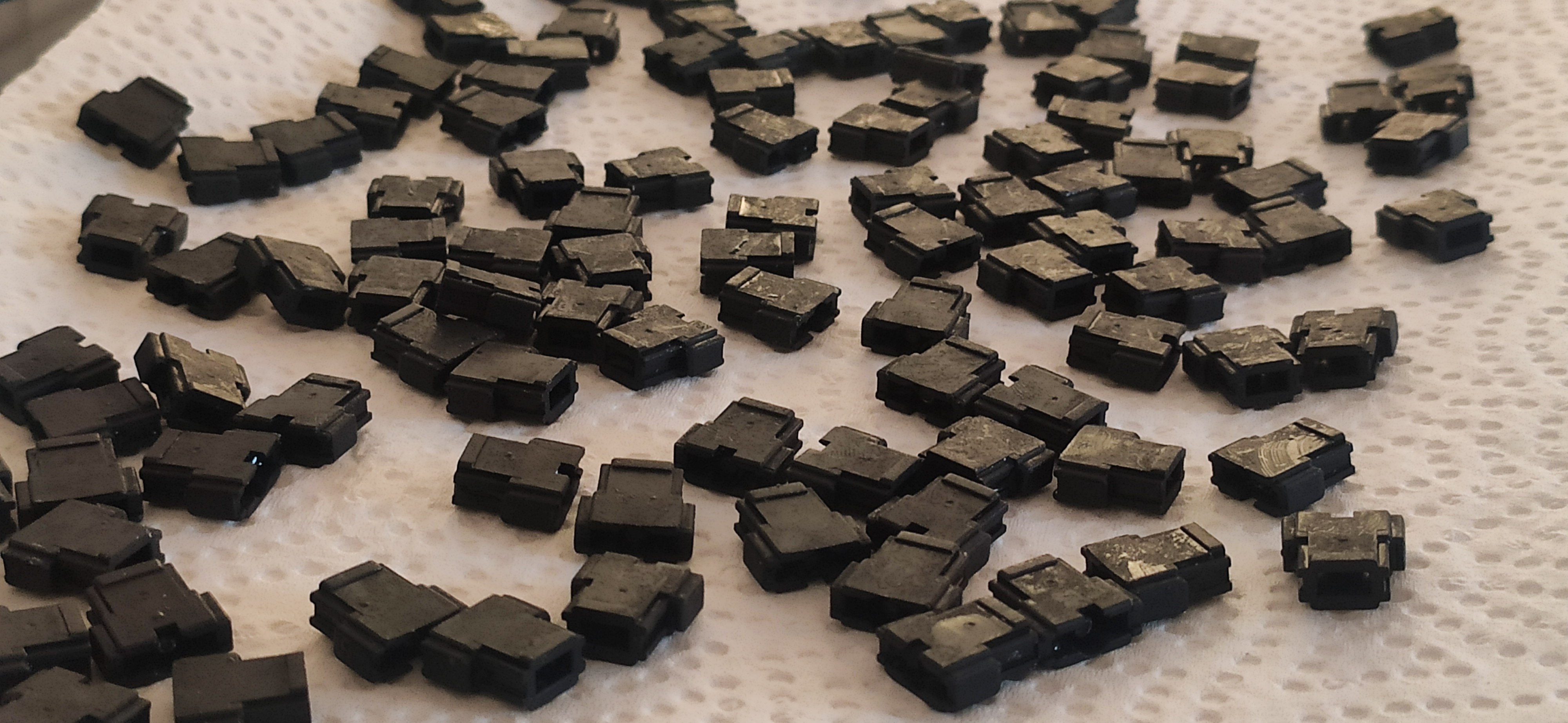

my latest result, from very scratchy to perfectly consistent.
note the really tiny amount, you only want to get a very thin layer.
some small shavings between slider and top housings are normal, you can brush them off or vacuum if you fear they might get in the way.

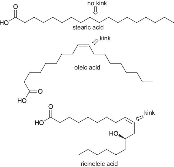

I'm by no means a chemist but I remember learning about the cure profiles of friction materials and how it effected the formation of various surface molecules. They all behave differently, some tougher, some smoother, etc. It's a balance to get them correct for the application.
Chemical-structures-of-stearic-acid-oleic-acid-and-ricinoleic-acid-The-kink-in-the.png
Chemical-structures-of-stearic-acid-oleic-acid-and-ricinoleic-acid-The-kink-in-the.png (11.32 KiB) Viewed 11015 times
I don't think there's any chemical reactions happening here that are comparable but I'd be curious how much the application method depends on temp, etc.
Is boiling the same as just physically rubbing wax onto the surface? Is there some molecular binding going on at high temp with highly diluted wax? Someone smarter than me probably knows.

doomsday_device
07 Jun 2022, 22:05
Shorle wrote: 03 Jun 2022, 08:51 Did you also shake the sliders in a closed jar with the hot water and paraffin or just stir?
Your end result sounds great, gj!
sorry for the late response - i just pour boiling water over that bowl (as pictured), stirr for some time (maybe 30 seconds), stirr while draining, put sliders on paper towel, seperate them quickly and then change paper towel for a dry one again. the whole procedure takes like 1-2 minutes
never boiled them actively, dont think it makes a huge difference
i also ultrasonic and boil all plastics without wax atleast one time before that.

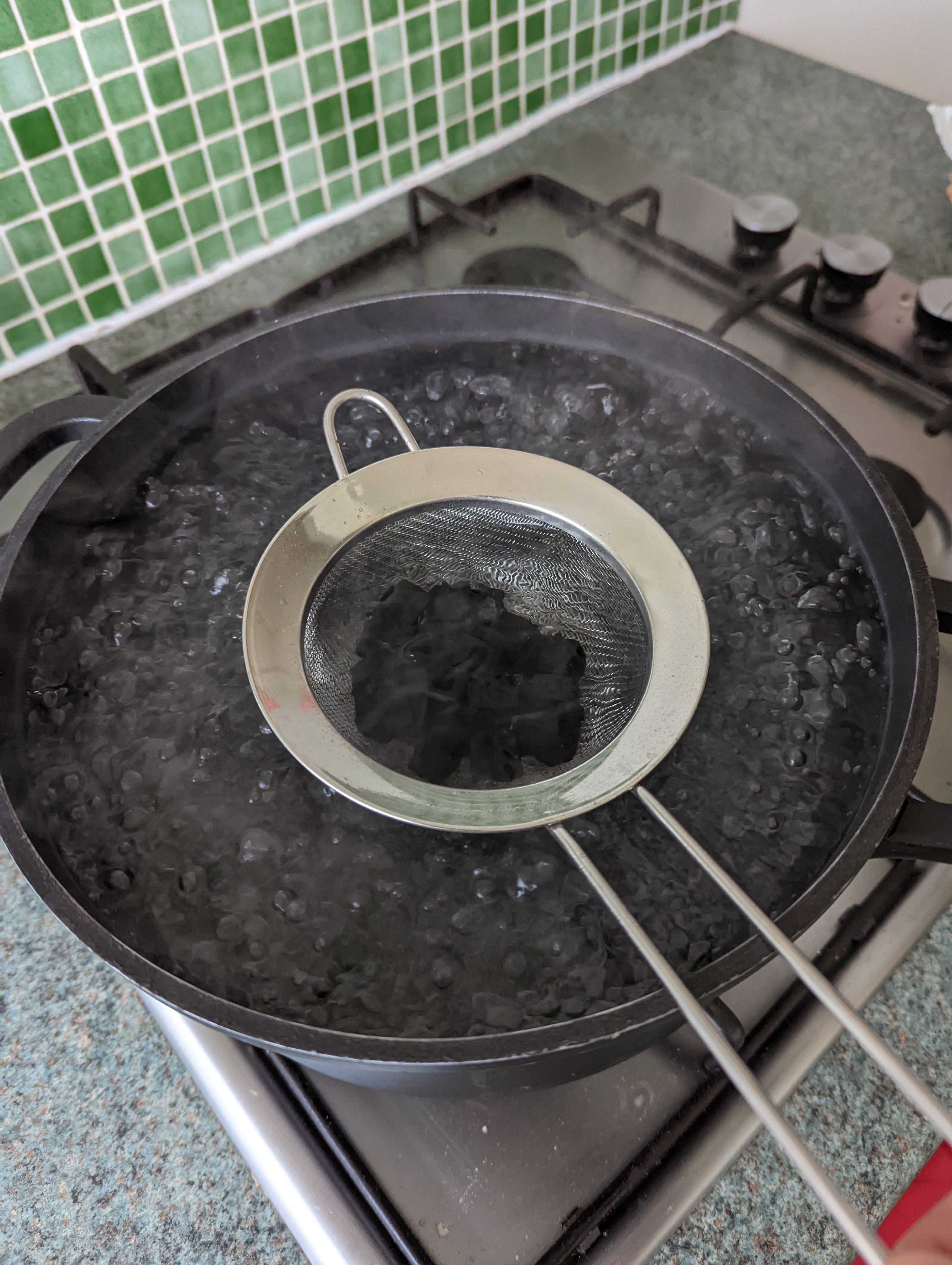

So, I tried the wax mod last night, following the instructions from Kuritakey. (waning: turn your volume down) and using the "block of wax" mentioned in Jezzuz's video. I wanted to get the Sasol 5203 wax, which appears to be the most recommended one, but I can't find a US distributor.
I did make a couple changes.
Process:
* I ultrasoniced the top housings and sliders (separately) using 50C to 60C water and fizzy denture cleaner tablets. Jezzus's video just uses warm soapy water. I think cleaning is kind of an obvious step, anyway.
* Heat a pot of water to a rolling boil. Toss in top housings and sliders (separately). Boil for 2 min. Drain. I used maybe 5-6 cups of water. The 2 min number is just so I can be consistent in what I'm doing. The above videos don't mention an exact time.
* I then heated a completely separate Pyrex graduated container to 4 cups and boiled. After boiling went down, I put 20 or so sliders in a nylon sieve, dunked them in water, then put in about 1/2 teaspoon (like, a real spoon, not a measuring spoon) of wax. Not a chunk, but shaved.
* Stirred until wax was melted.
* Let sliders sit for 2 minutes, stirring occasionally.
* Pulled out the sieve and put the sliders out to dry.
I did 300ish. Blues from a Leading Edge DC-2014, 102 random blues I'm going to put in a OmniKey chassis, and 101 from an old logo Dell with salmons. I reassembled three switches from each and I also have a handful of blues that were lubed with the ceramic wax lube I've been using.

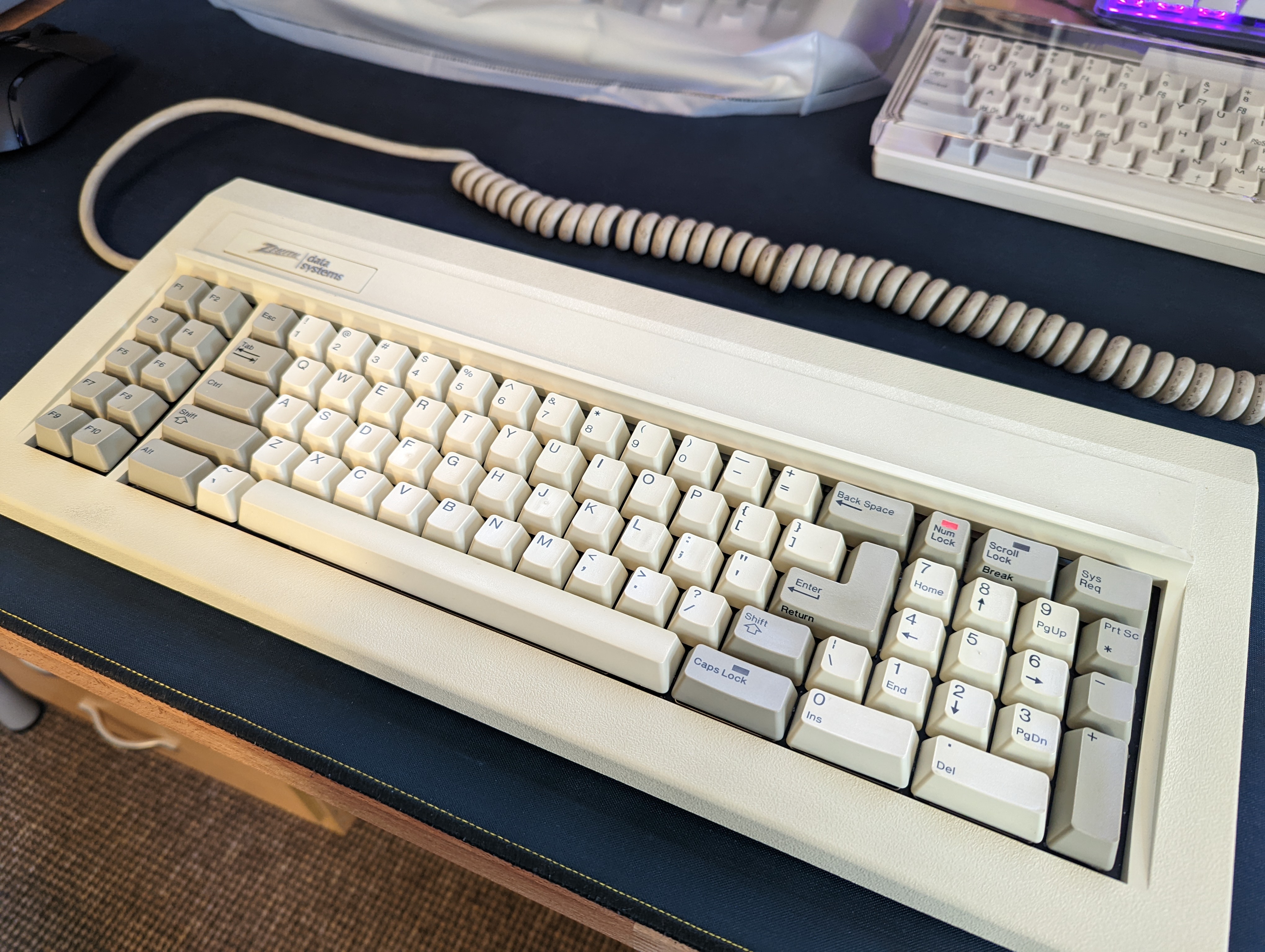

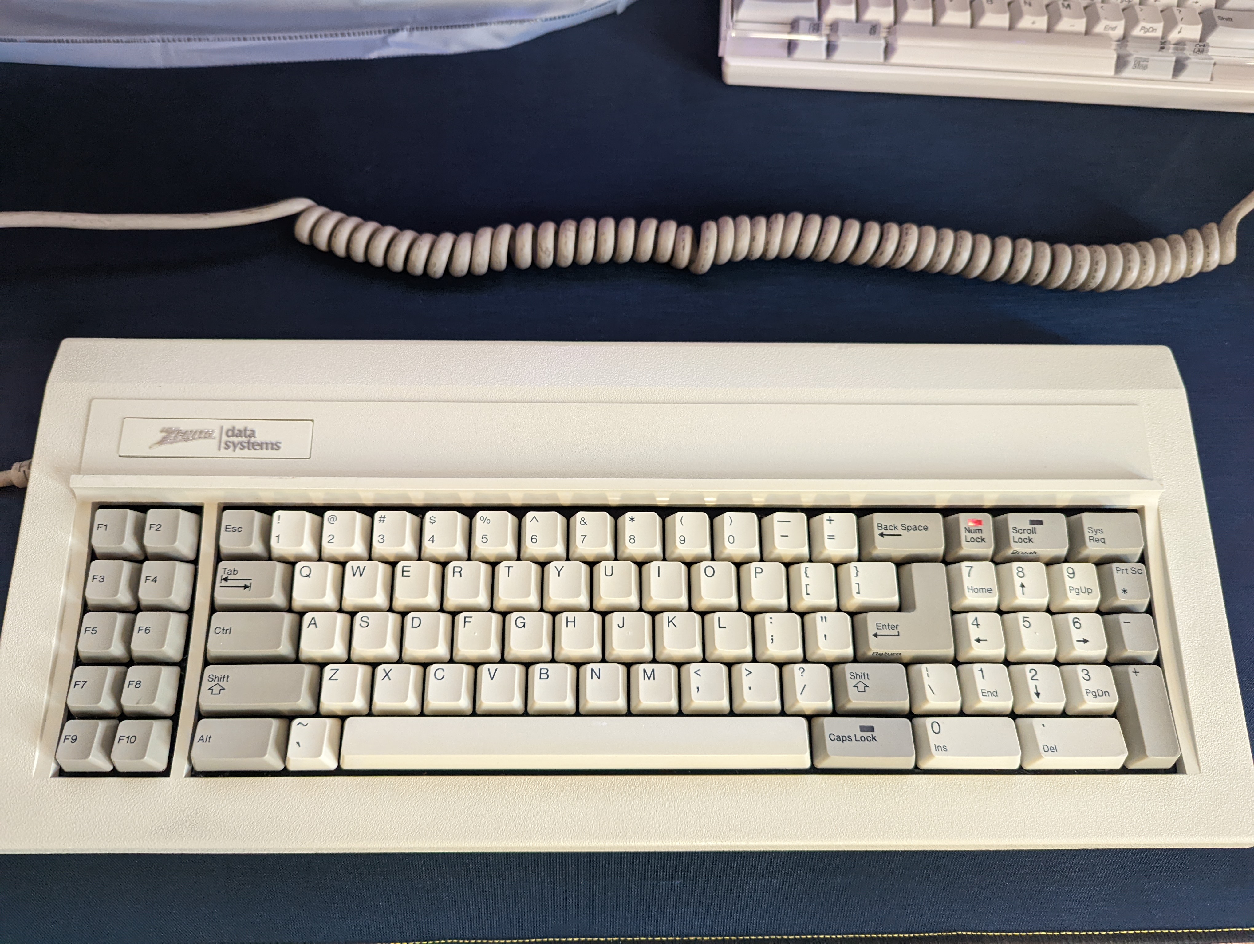

Here's another result.
* Apple Extended Keyboard. Orange Alps. Ultrasoniced top housing and sliders. Boiled top housings. Used ceramic wax lube on upper housing. Paper mod. Absolutely fantastic.
* Apple Extended Keyboard II. Cream damped Alps. Ultrasoniced top housing and sliders. Boiled top housings. Used ceramic wax lube on upper housing. Paper mod. Absolutely fantastic.
* Dell AT101 old-logo. Salmon (pink) Alps. Ultrasoniced top housing and sliders. Full wax/boil mod. Paper mod. Absolutely fantastic.
I've completed reassembling my Leading Edge (blue Alps) and it's really nice.
And another verdict: if you're talking tactile Alps, do a paper mod. May as well do wax/boil. Doesn't take that long to do, if you have the keyboard apart, anyway.
