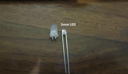

how many ohm/watt resistors for LED? :) i will add 3LED for caps and 2 modes

any LED will do. the rule is the lower the LED the higher the resistor.

matt3o wrote:any LED will do. the rule is the lower the LED the higher the resistor.
i don't know the size,i remmeber it really fit with 5mm hole,i get from my old RD keyboard bigger than of LED on mecha keyboard.
EDIT:I find arround 10mm so how many ohm for resistor?
-[°_°]-
07 Feb 2014, 14:21
10mm?! that's not an LED it's a lamp! :D

this pic more details :)

07 Feb 2014, 15:19
The one on the left looks like an ordinary 5 mm LED to me. The one on the right is the odd one.

07 Feb 2014, 15:32
the one on the right is 3mm, not 5mm (why odd?)

07 Feb 2014, 15:41
i'm confused :oops: i have one more is 3mm fit for LED MX and in images(5mm) not fit because there is like a circle on the side
how to resistor?

07 Feb 2014, 15:59
you need 3mm T1 LED. The voltage will likely be around 3v but you also need to know the amperage (usually 3.4V, 20mA). Just find an online resistor calculator and check what resistor you need. Probably something around 82ohm
PS: when in doubt, take a slightly bigger resistor

08 Feb 2014, 03:06
Yes it's 3mm. If you want to reuse some 5mm, you have to sand it to fit in the MX slot witch is not the best solution. As Matteo said, If you have a calculation witch gives you an inbetween value, the rule is always take an higher resistor value (for example, if it's 82ohms take a 100 instead of choosing a 50ohms) The brightness will be lower (a bit) but the led must live longer than at its best ohm value : the calculation gives you a minimum resistor value to not burn the led ;) .
