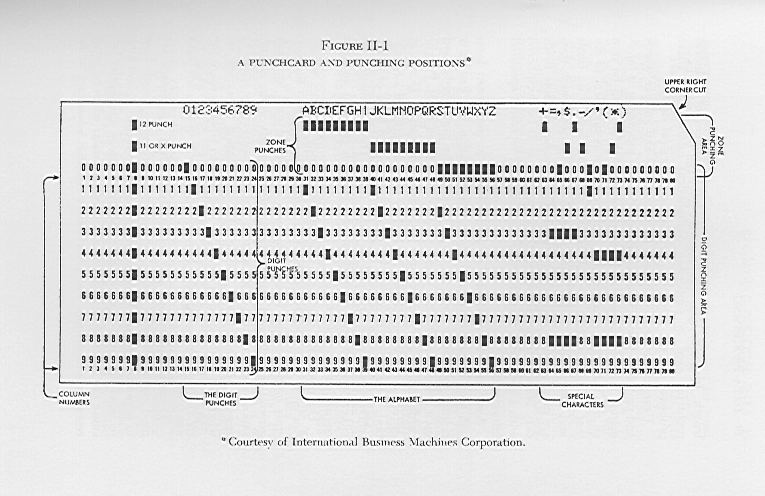

Oh, hang on, it appears that my naïve assumption about binary character encoding on 80 column punch cards is probably very mistaken:
So much waste!

tigpha wrote: 27 Aug 2019, 21:37 Oh, hang on, it appears that my naïve assumption about binary character encoding on 80 column punch cards is probably very mistaken:
So much waste!
Cards were processed electromechanically for decades before computers existed. Machines worked row-by-row, top-to-bottom, not by column/character. The simplest adding machine simply has a counting wheel for each column, and advances the wheel one step for each row until a hole turns it off.
