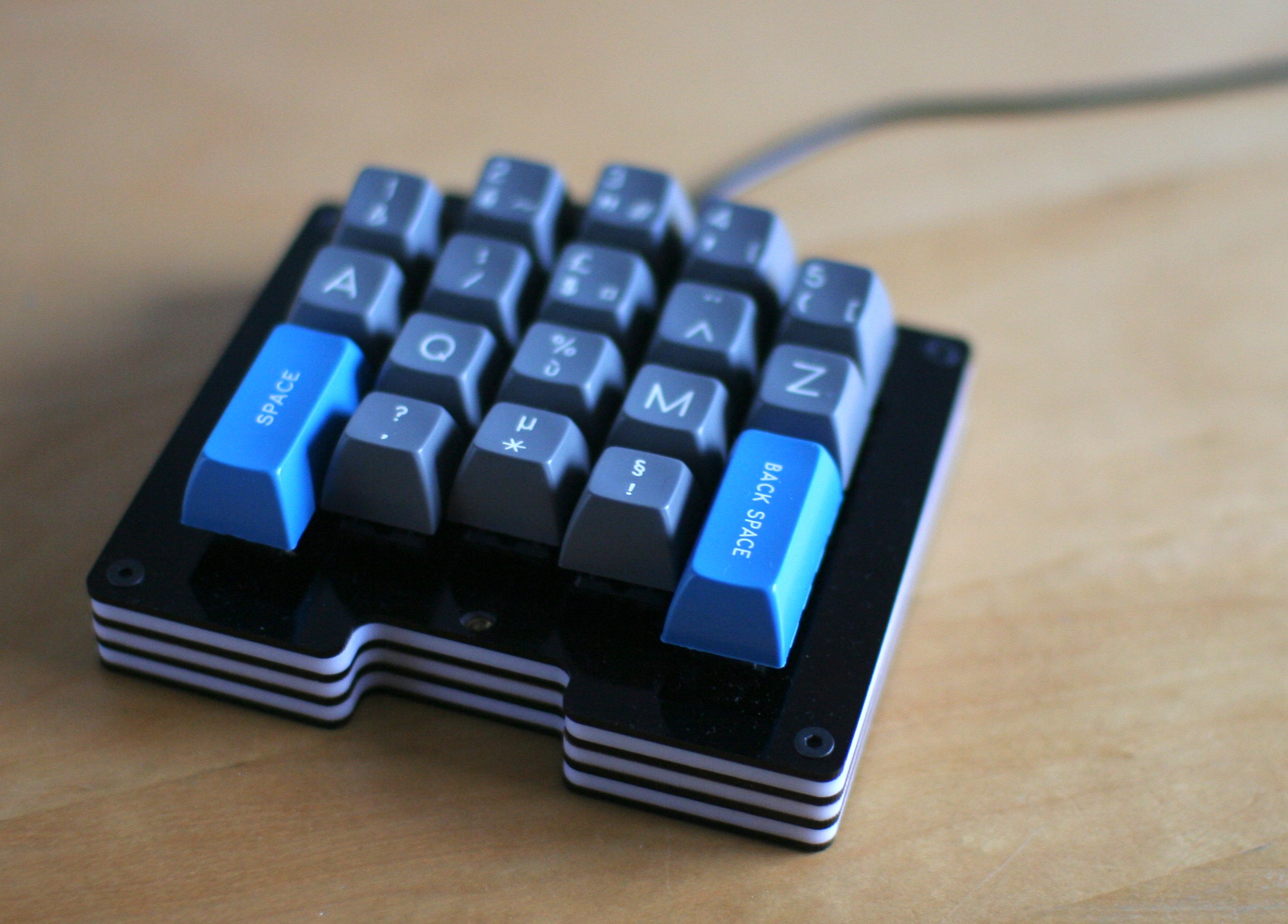

01 Apr 2014, 19:17
Mohitgarg's OneHand case is very smart indeed! I received and built mine a few days ago, but the sun's missing in action over Edinburgh again, so this is the best shot I can post:
He sent me everything required to construct it: brass standoffs, bolts and even the Allen key! The black and white stripes were my idea and I think they've turned out nicely in acrylic. Thanks man!
Next up I need to fix some of my dodgy soldering to recover a couple of missing keys, and then I can learn how to use this wee beast! The feel is already good, nice and linear with MX blacks.

Muirium wrote:Mohitgarg's OneHand case is very smart indeed! I received and built mine a few days ago, but the sun's missing in action over Edinburgh again, so this is the best shot I can post:

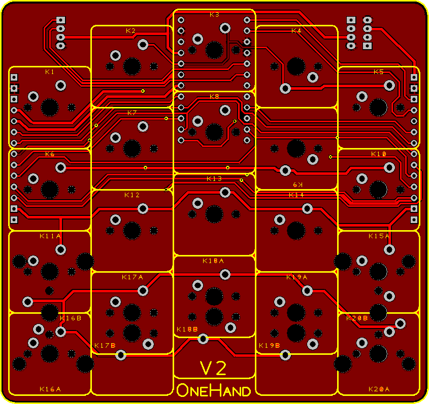

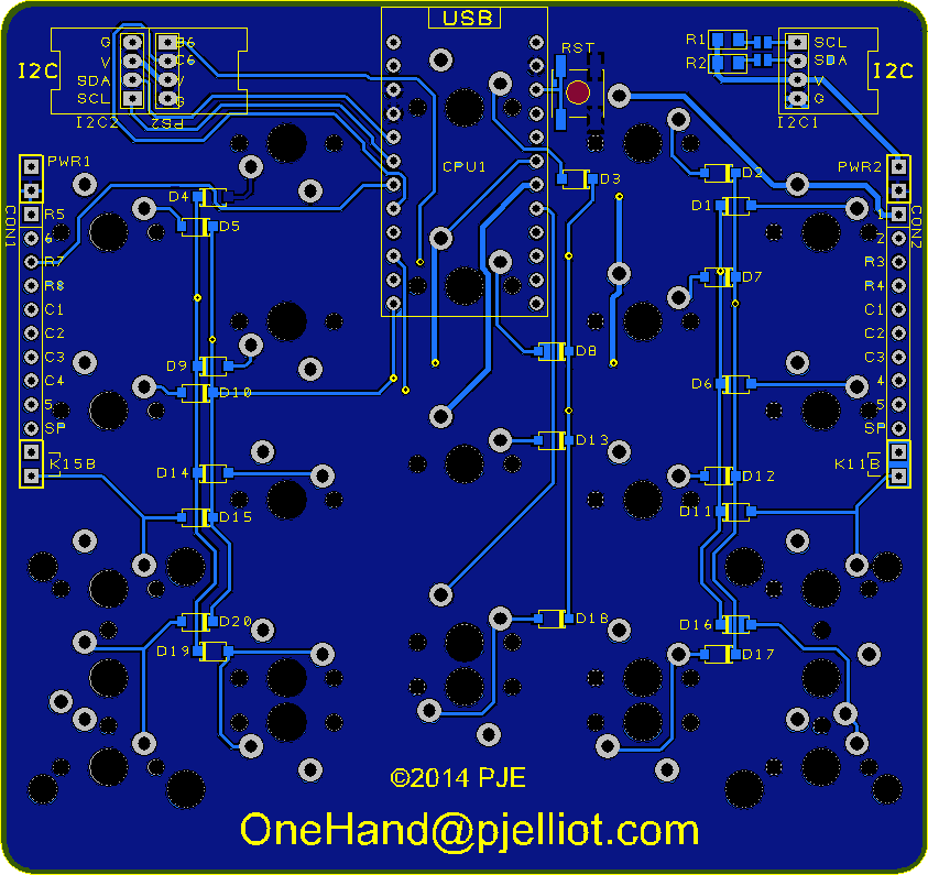

I've been working away on the V2 PCB for my OneHand/TwoHand keyboard. The functions provided by the PCB are:
  • Reverse mount ProMicro CPU module - $5 from eBay.
  • 5x4 Matrix keyboard with options for 2x keys (as before), option to use 1.5x keys for three keys on bottom row.
  • Connection to allow additional key to be added externally if 2x key is used.
  • Expansion header to allow a second OneHand PCB (without CPU) to be scanned by the first unit - The signals for the on-board keys are also taken to a header on the opposite side.
  • Two I2C sockets to allow units with CPU modules to communicate over off-the-shelf Grove cables.
  • PS/2 connection using Grove connector, to allow communication with keyboard or touchpad.
I've finished the layout of the PCB, and I'm now checking for silly mistakes...
I'm using a rectangular PCB layout due to the position of the I2C and PS/2 sockets on the back of the PCB, as well as allowing the larger keys at the bottom.
I also just received my three $3 PS/2 touchpads (eBay - salvaged from laptops) in the post this afternoon. I'm going to experiment with interfacing them to the ProMicro CPU - they only need the PS/2 standard 5V, 0V, Data and Clock connections. Once I've managed to get it working I'm going to draw up a version of the OneHand without the keys, with a wedge shape to hold the CPU, Two thumb keys, touchpad and have the I/O headers to scan two headless OneHand modules thus a 3 PCB system would allow a split staggered 40% keyboard with touchpad!
Now where's my soldering iron...

I will be buying a batch of the V2 boards in the next week or so. They are quick to produce, but as I'm from Yorkshire a place where people have deep pockets, but short arms, I'm going for the free shipping option which takes quite some time!
I'm going to make a V2 OneHand, a TwoHand using two PCBS, and a TwoHand+ with 3 three PCBs (using the same board as the center board). I may order 20pcb's this time to make more available to the community. The V2 design will also have the benefit of being able to use more of the off-the-shelf firmware available due to it's matrix format.
I just noticed I've left off the mounting holes!, which are going to be more difficult to located due to the additional wiring. Once I've added them I'm going to print some large scale prints to manually check - it's passed the PCB build/connection checks.
