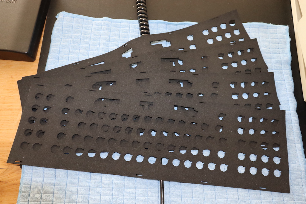

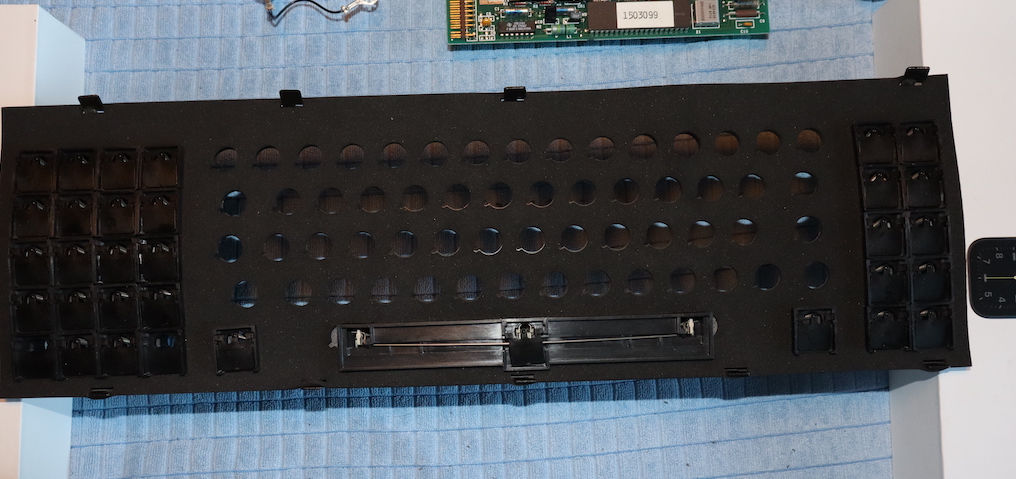

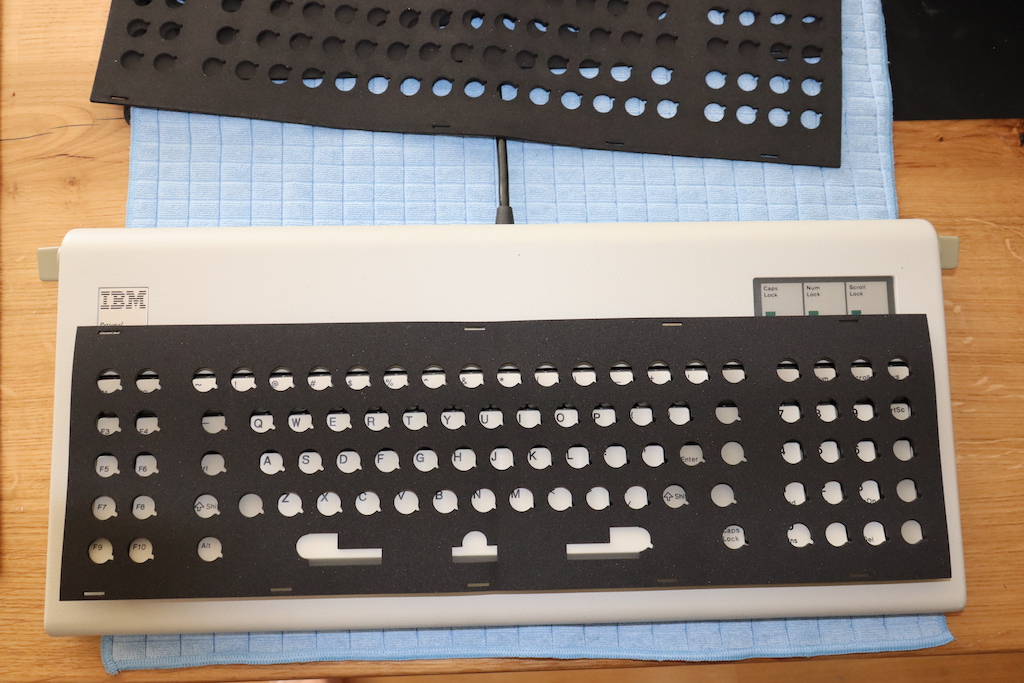

I have received the first few mats for the Model F AT and I must say - neoprene and cutout looks good. Once I have time to get my Model F AT taken apart, I will let this forum know how it went.
Update: Got them from https://snijlab.nl/en/ for a very good price
The size as Unit is correct - sadly all of the companies here expect 1 unit = 1mm
Update:
Fits like a glove and the material is spot on (2mm neoprene). My F AT should be good for 25+ years now.

For all my IBM Model F restorations (XT, AT, F122) I use 3mm neoprene foam with great results. Yes it is harder to compress the plates but totally worth it as it feels even all over and not hollow in the middle rows.

Did you get the foam laser cut or manually? Do you have dxf files available for each?

I cut all the foam manually and used a leather hole punch to make all the holes for the barrels.
