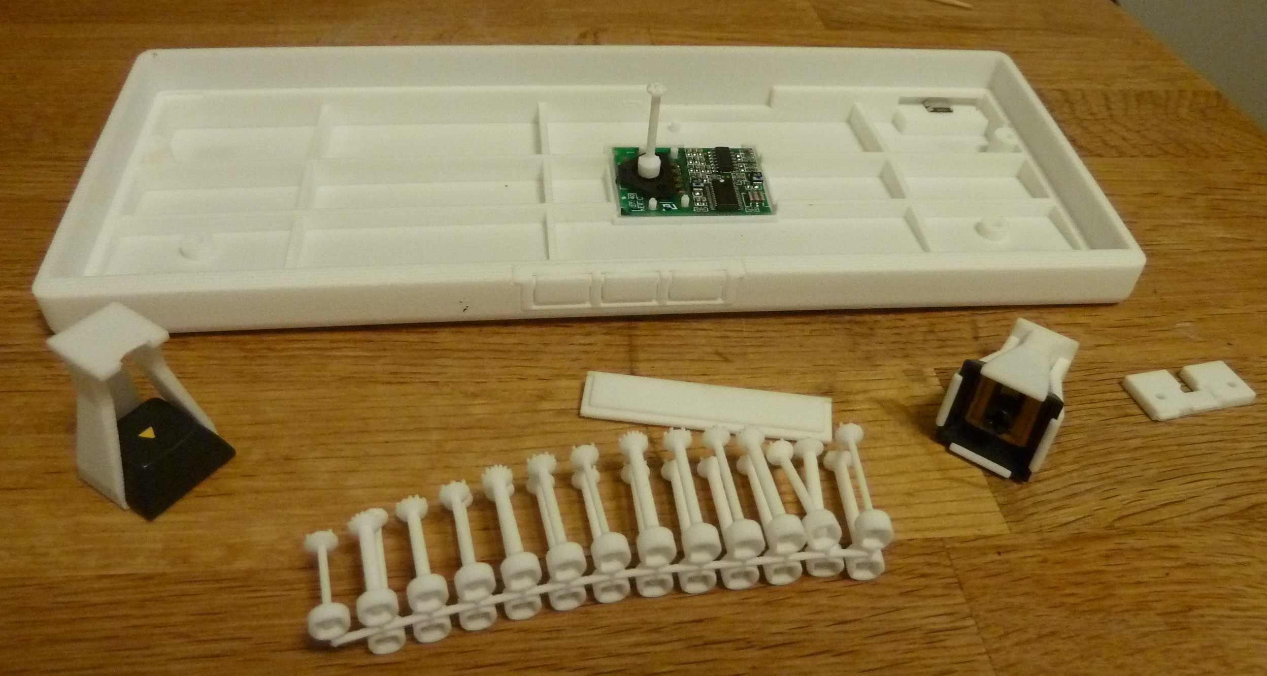

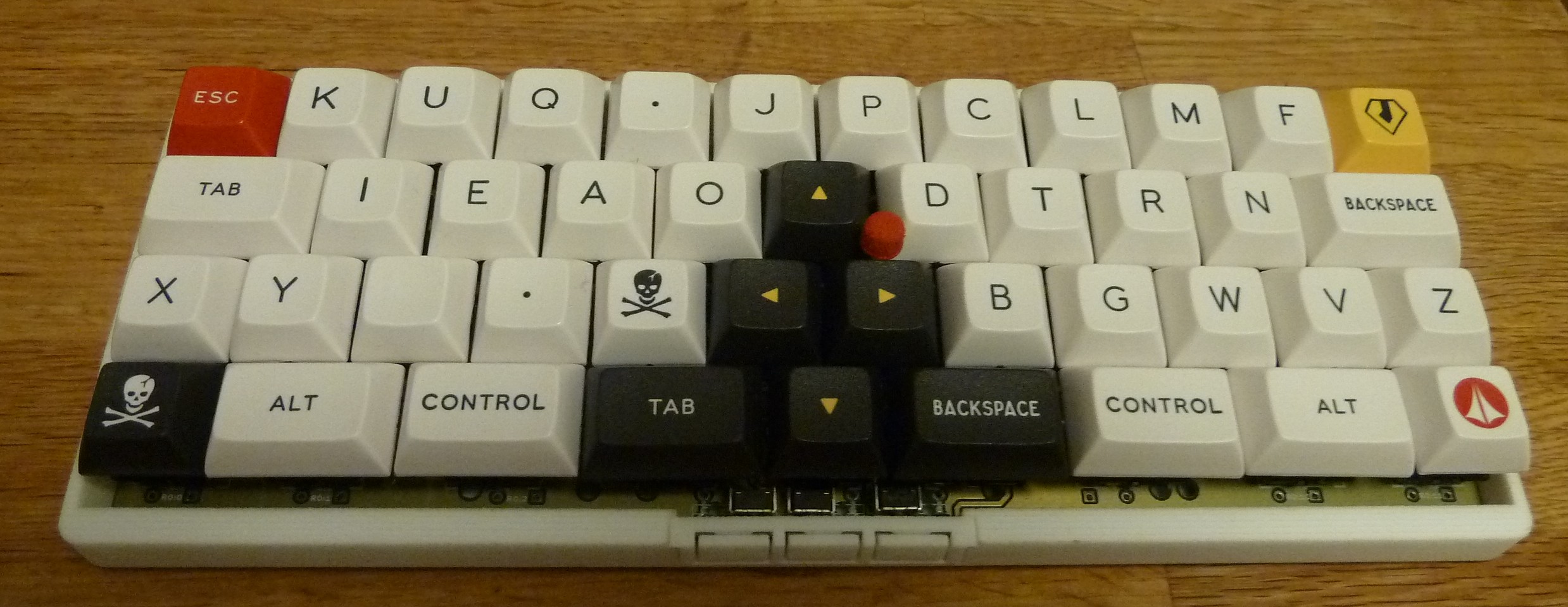

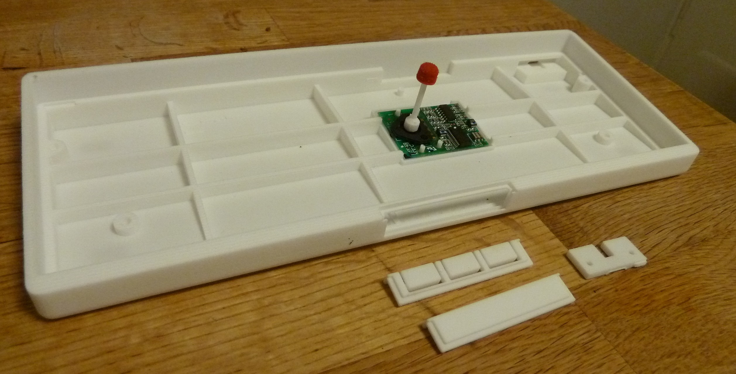

Here is the latest case design:
No, I will not dremel precious caps for just this picture
Credit where credit is due
  • *Can now easily accomodate different front button orientations via separate adapter parts
    *Micro usb fits perfectly
    *Trackpoint fits, adaptors work
    *More rigid design
    *Logo :D
Todo:
  • * Smaller support structures to clears solder points more easily
    * Trackpoint isolation and retention plate
    * Little higher to clear teensy and front buttons
    * Options to cover sides for other layouts
    * Front cover closer to switches
    * Also make USB outlet optional: Micro/Mini/Cable
    * Minor adjustments to
Stay tuned for the final revision, ETA 4 weeks from now :(
Tight, but it should work with either this adaptor or a needle in between
Exchangable parts and open case
same
same

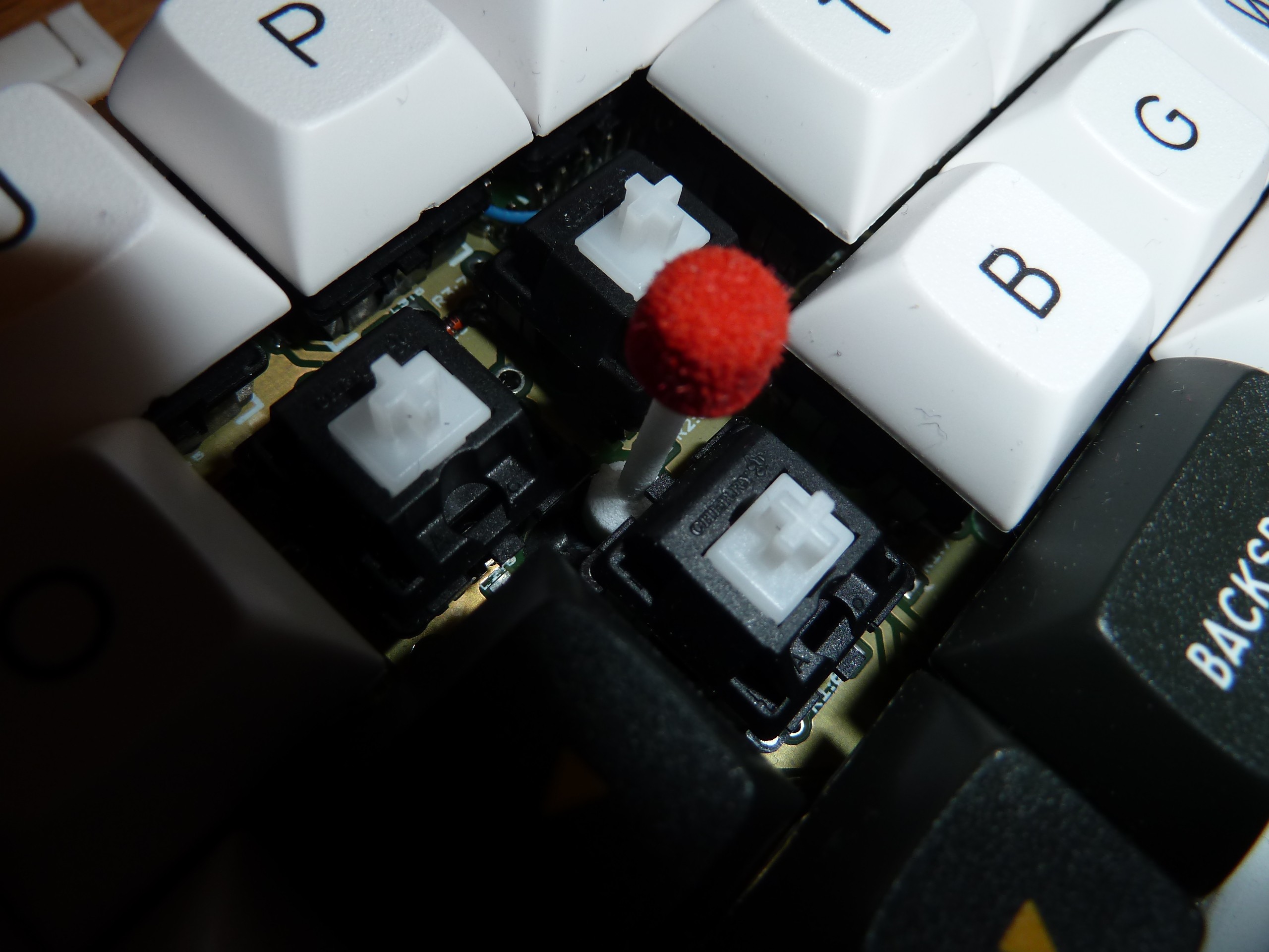

Ooh, that Trackpoint. The stems are very interesting. Is that from a small IBM scissor switch keyboard or a separate invention? If so, could you please tell me where to print some of those stems?
suka
frobiac
17 Jan 2015, 00:35
scottc wrote: Ooh, that Trackpoint. The stems are very interesting. Is that from a small IBM scissor switch keyboard or a separate invention? If so, could you please tell me where to print some of those stems?
The stems were also designed by me and printed on an industrial 3D printer. I'll gladly make the designs available when I have decided on sensible values for length and diameter, and whether an inserted steel pin is beneficial or not. But they basically are enhanced versions of the simple adaptor I built for my RedTilt board to clear the vertical space.
17 Jan 2015, 12:05
Very cool. Thank you. I've been limiting myself to trackpoints from the IBM Space Saver keyboard, whose trackpoint is long enough to be used in a Cherry MX board but a lot older and less featureful than newer models.

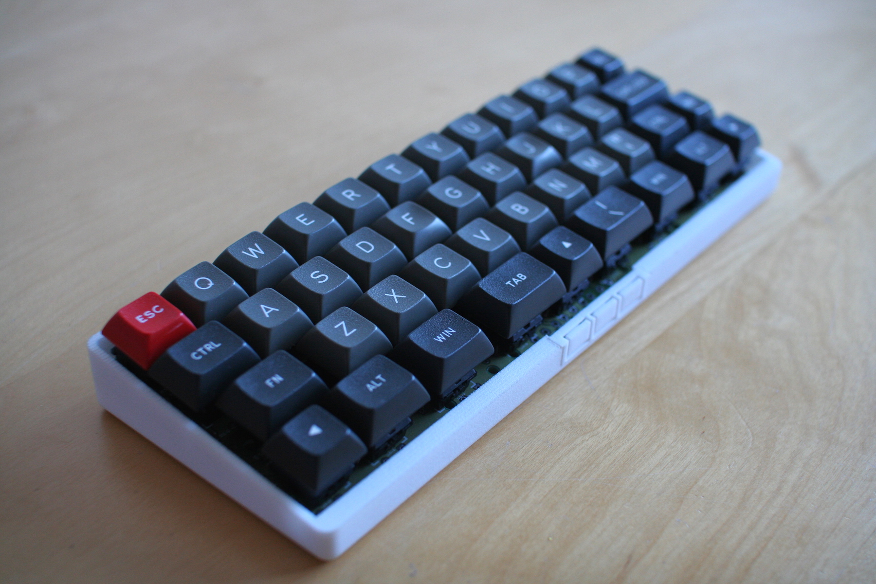

26 Jan 2015, 18:38
Oh, now what have we here?
Thanks for the case, Suka! Now I need to figure out how to install the micro USB socket…

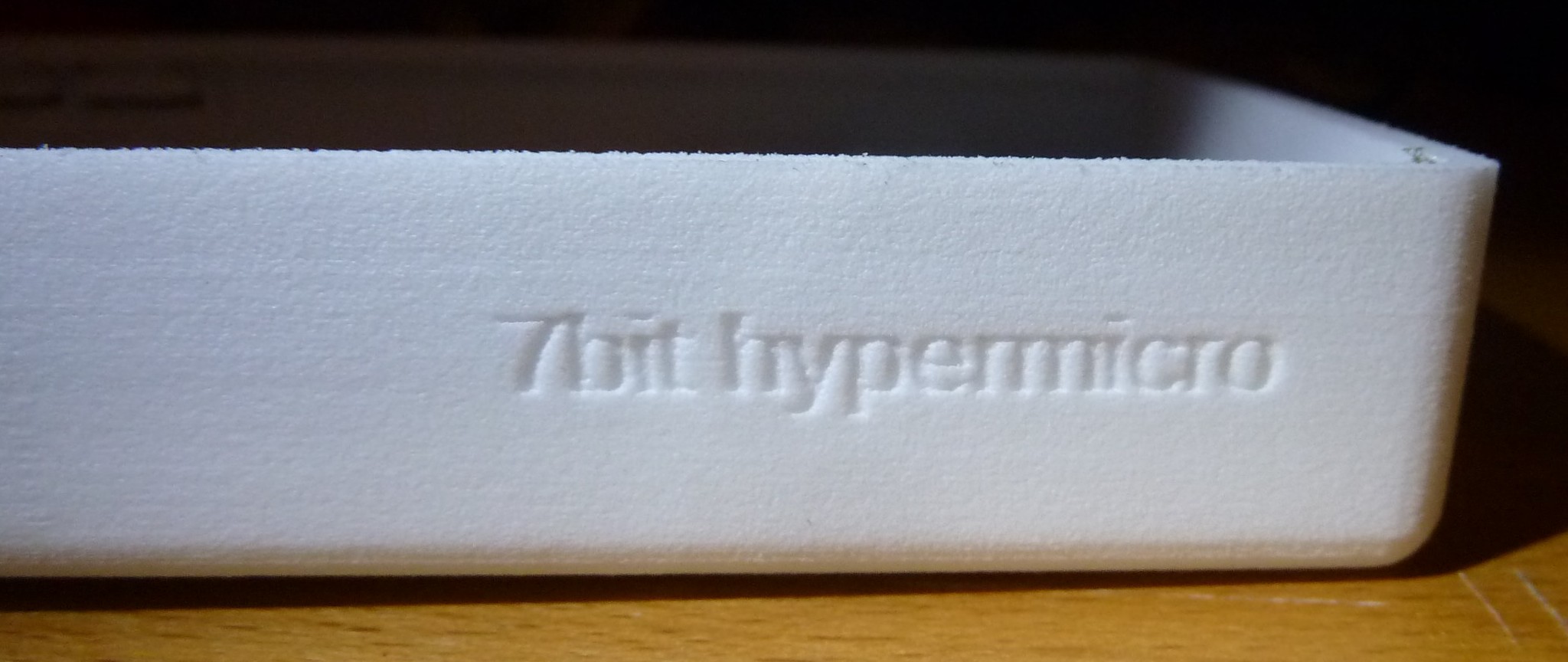

Suka did a great job. This is his prototype case, and there will be more when he's back from vacation.
There's removable tabs on the front, for the HyperMicro's 3 optional mouse buttons, and an elegant little micro USB port cutout on the back right corner for a user installed socket. That's the bit I need to source to complete my board. He even put a nice credit to 7bit on the back, engraved into the body, but it's soooooo dark here I couldn't get a decent picture of it. Where'd I put my damn flash…
