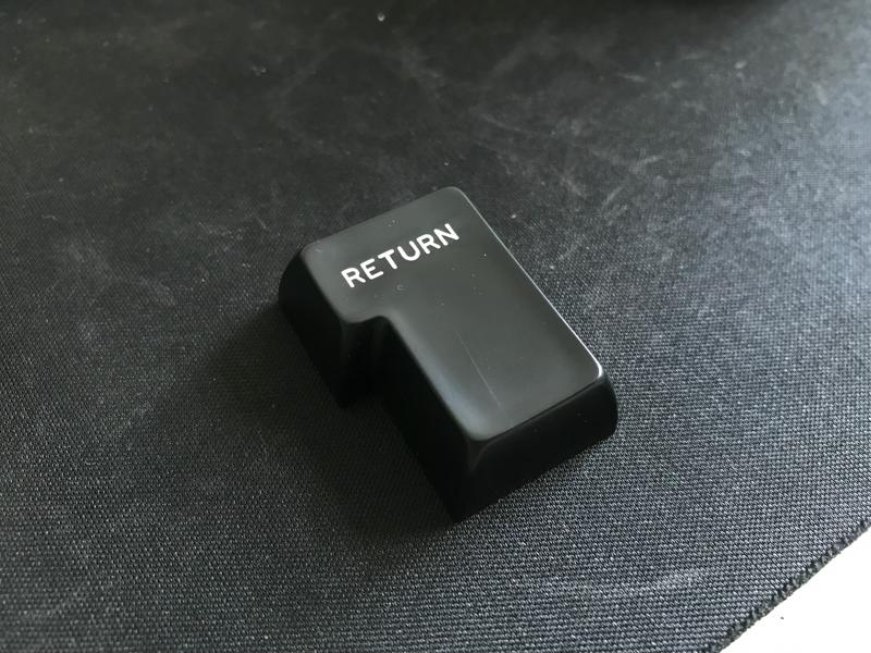

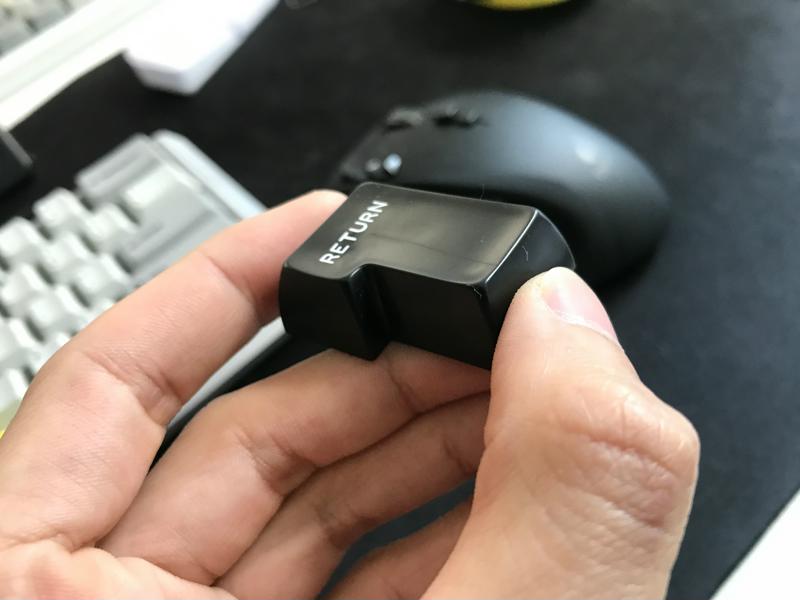

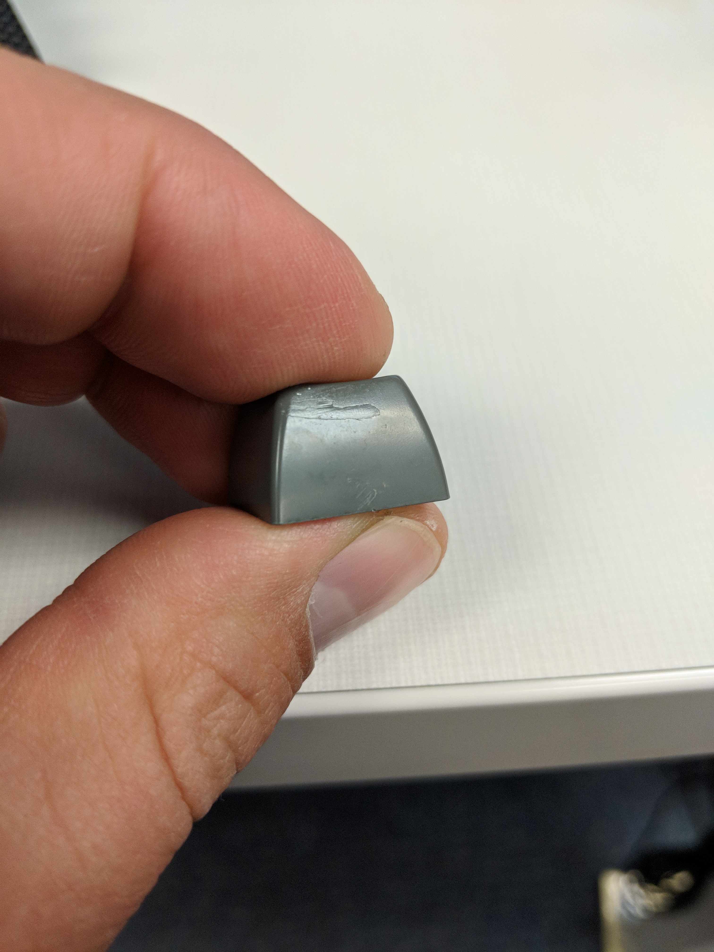

received everything but the iso enter have a big scratch on it
I know SP SA always have some minor blemish, but does it look right to you guy?

I think that's a flow mark rather than a scratch. It happens when plastic has started to cool down before filling out the entire mold, so it doesn't 'weld' together seamlessly.

SP had the same problem with their recent run of Nuclear Data, but it affected all the alphas, not just ISO Return. I don't know if their molds are getting worn out, they got a bad batch of plastic from their supplier, or they are just rushing to get keycaps out the door, but I think they need to figure this out quickly before it affects any other sets.

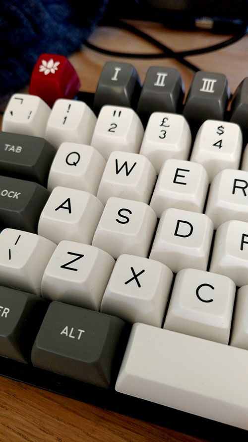

im very pleased with the quality but i've nothing else to compare with.
only thing i've noticed is that i'm unsure if my 'S' is the wrong way up! it could be the typeface, i won't grumble though! they're so awesome.
- S.jpg (66.13 KiB) Viewed 12379 times

Your s is indeed upside downlukenukum wrote:im very pleased with the quality but i've nothing else to compare with.

lukenukem: You installed it with the sprue facing "up," which should be correct. I did the same thing, because I don't want to see that nasty sprue.

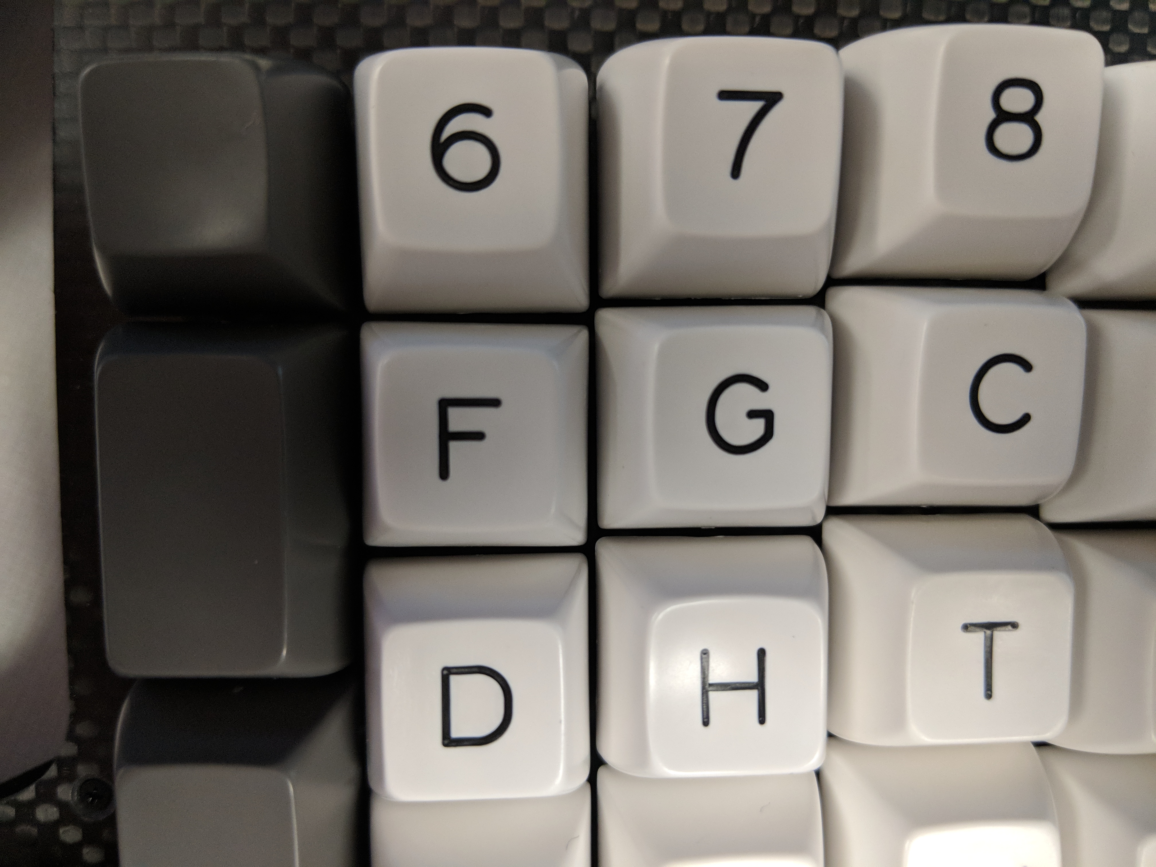

Here are some pics, as promised.
- My Dvorak F key is twisted (can verify the stem/switch are straight, as this does not look twisted on any other capset)
- twistedF.jpg (3.04 MiB) Viewed 12588 times

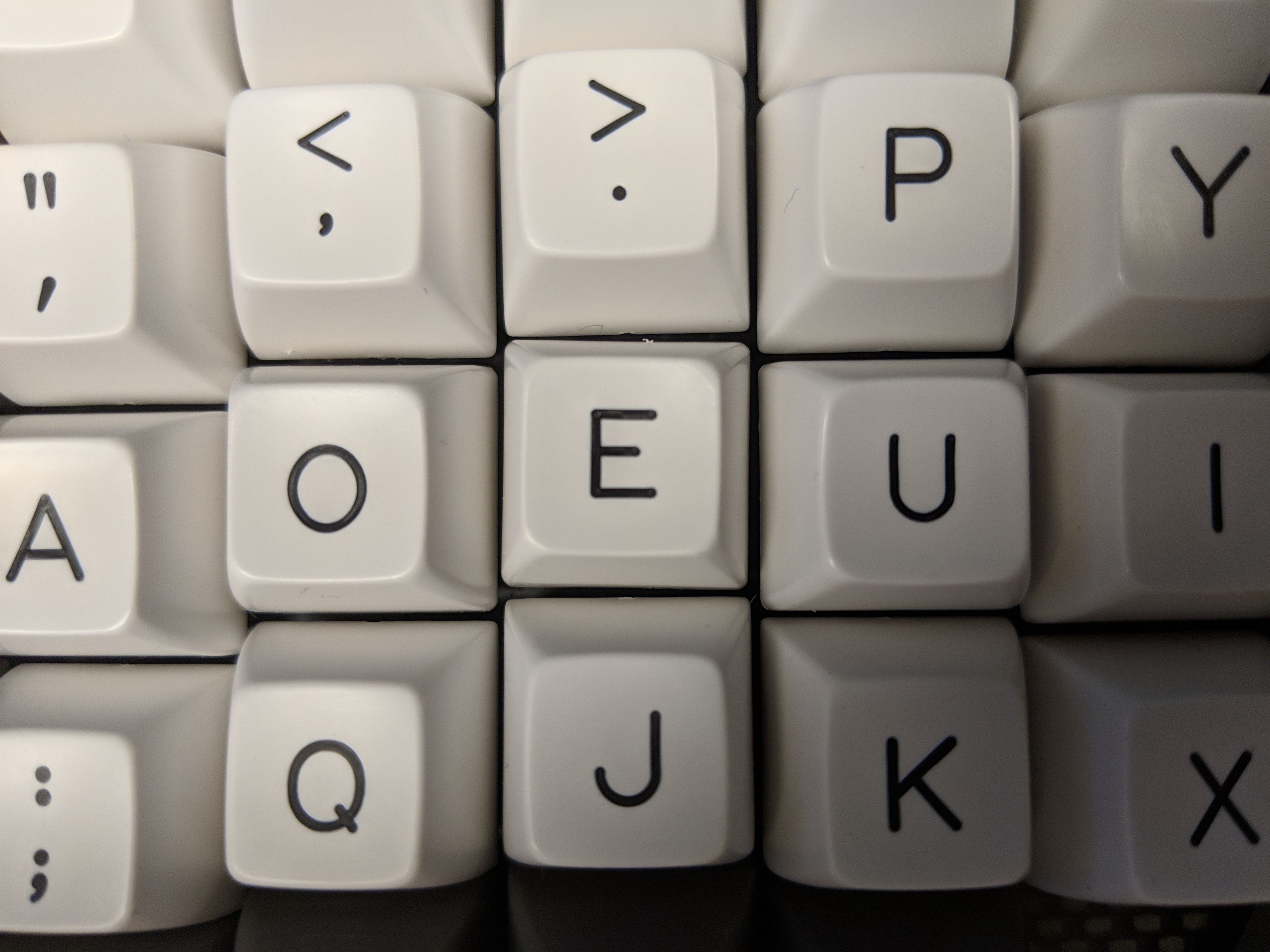

- My Dvorak E key is twisted (can verify the stem/switch are straight, as this does not look twisted on any other capset)
- twistedE.jpg (2.9 MiB) Viewed 12588 times

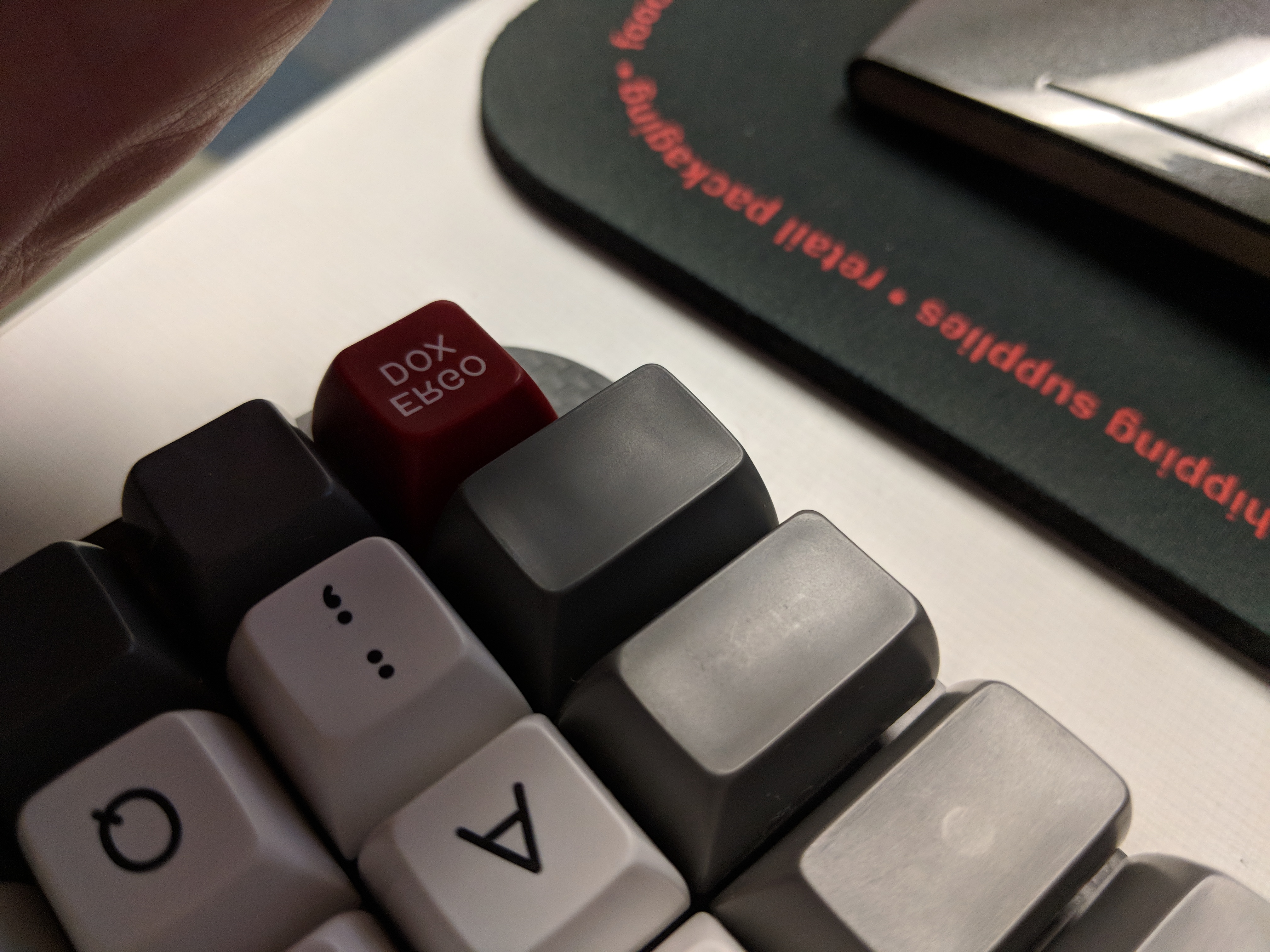

- Not sure what this says, but it's clearly not a blank cap.
- ghostText.jpg (2.98 MiB) Viewed 12588 times

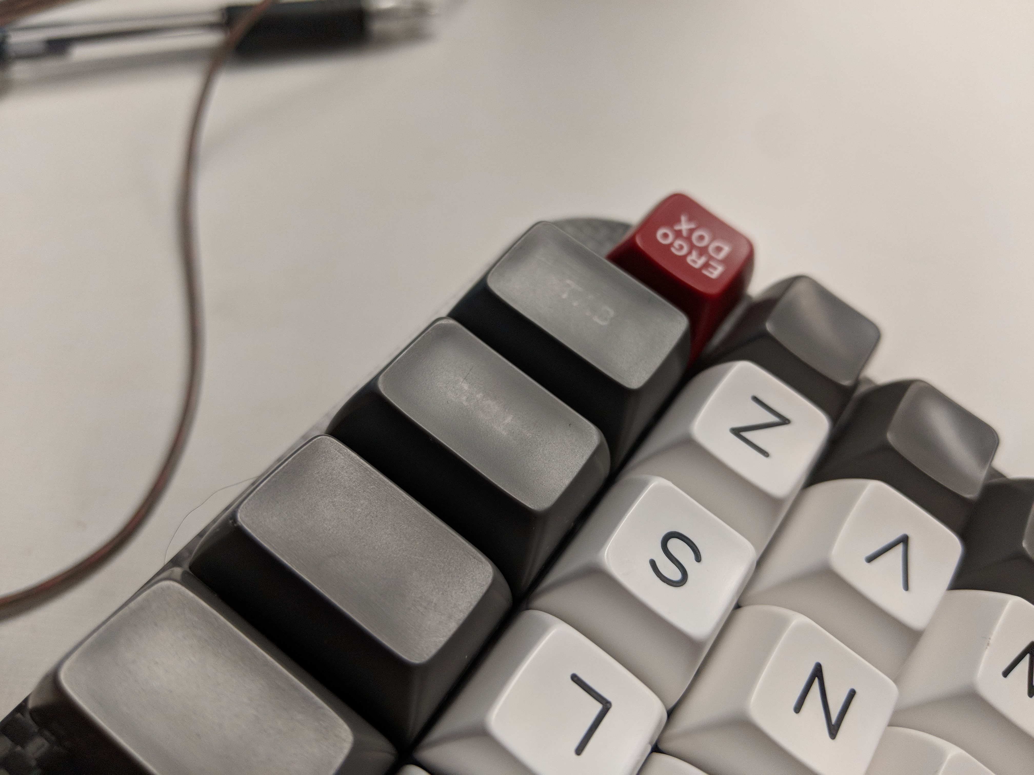

- Here you can see two keys with ghosted text - one is clearly TAB, but I can't read the other one well.
- ghostTAB.jpg (2.87 MiB) Viewed 12588 times

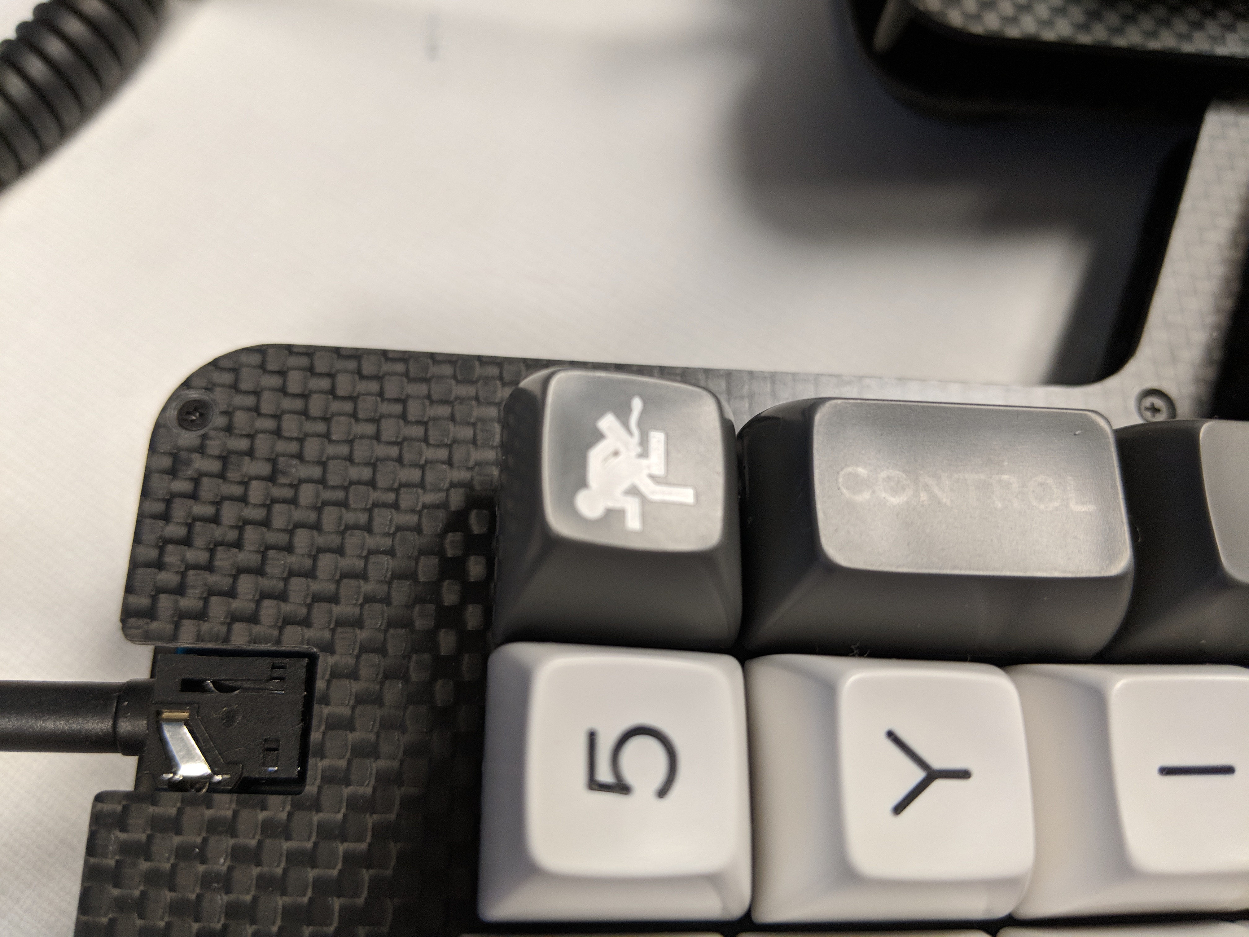

- This is the clearest ghost text. It's almost like they double-shot it with the same color.
- ghostCONTROL.jpg (3.08 MiB) Viewed 12588 times

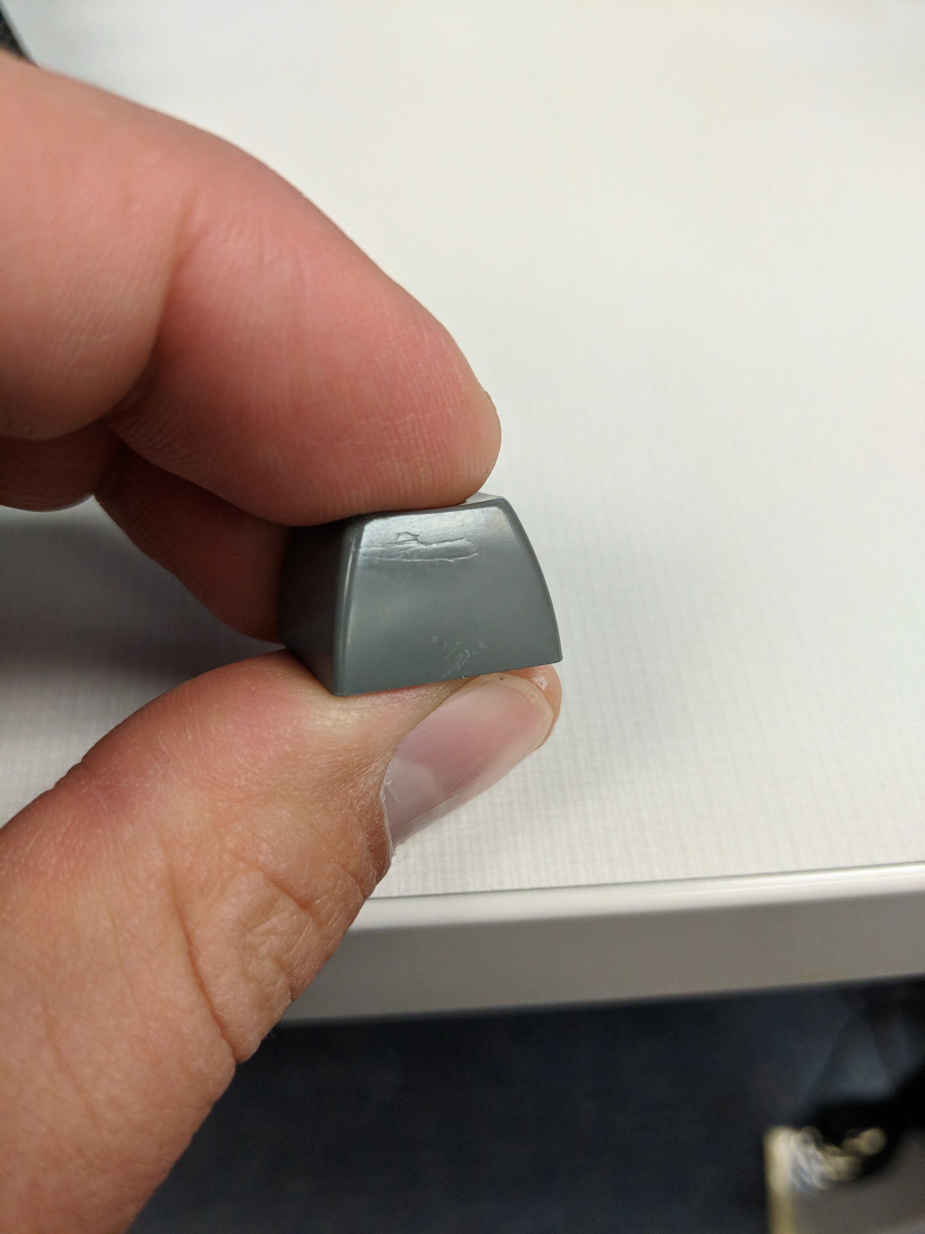

- Here are a couple shots of the "bubble" I mentioned earlier - this is typical of this issue. (I had these on my DangerZone caps, too)
- bubble2.jpg (2.82 MiB) Viewed 12588 times
- It's not a huge deal on a R3 blank key, because you can turn it such that you don't see it all the time, but it's still frustrating.
- bubble1.jpg (2.96 MiB) Viewed 12588 times

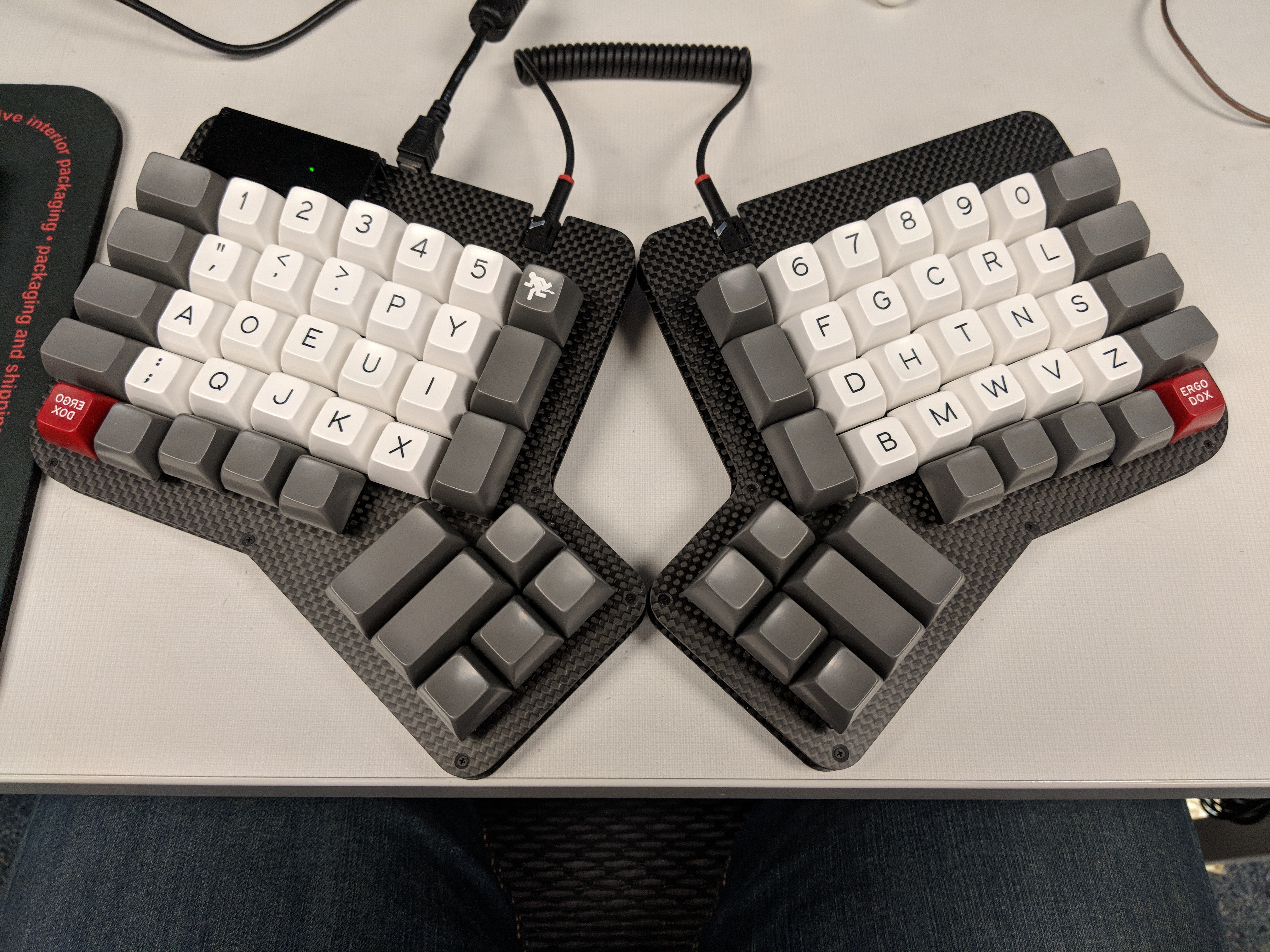

They do look good on my ErgoDone
- The overall effect is good.
- ergoDone.jpg (3.57 MiB) Viewed 12472 times

Nice boards. You need to post this on 'The Cappening' thread.
