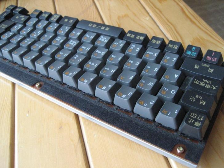

Could that memb be a coincidence or i have no luck?
Yes,it's 100% rubber dome. I have collected lots of NMB Hi-tek details and keyboard for half year, never seen this FCCID "AQ6MEMB-74004" have the space invader version. The seller knows that's the rubber dome,so he did't tell you the correct FCCID to you.

Which that Sharp teletypewriter switch is?
And I found another different unknown switch that Sharp teletypewriter has.
http://writelephant.com/2014/07/19/the- ... r-schmuck/

Identified myself.

It's alps mount, slider over domes as you might've guessed already.
terrycherry
15 Oct 2015, 19:14
guk wrote: It's alps mount, slider over domes as you might've guessed already.
Thanks for id it. I never seen this switch over dome before. Did you have any keyboard photo or site with that switch?

Sent you a picture, it's an early sord switch by Alps which was used for e.g. typewriters.

I can't find any information on DT wiki, you should put some details if necessary. ;)

usually, if a keyboard has Alps mount but the switch doesn't look like an Alps one it means slider over rubber dome
15 Oct 2015, 21:41
usually slider over domes are not 1/2 bad, not something to lust over but passable. Something does not have to be true mechanical to be good , look at Trope.
