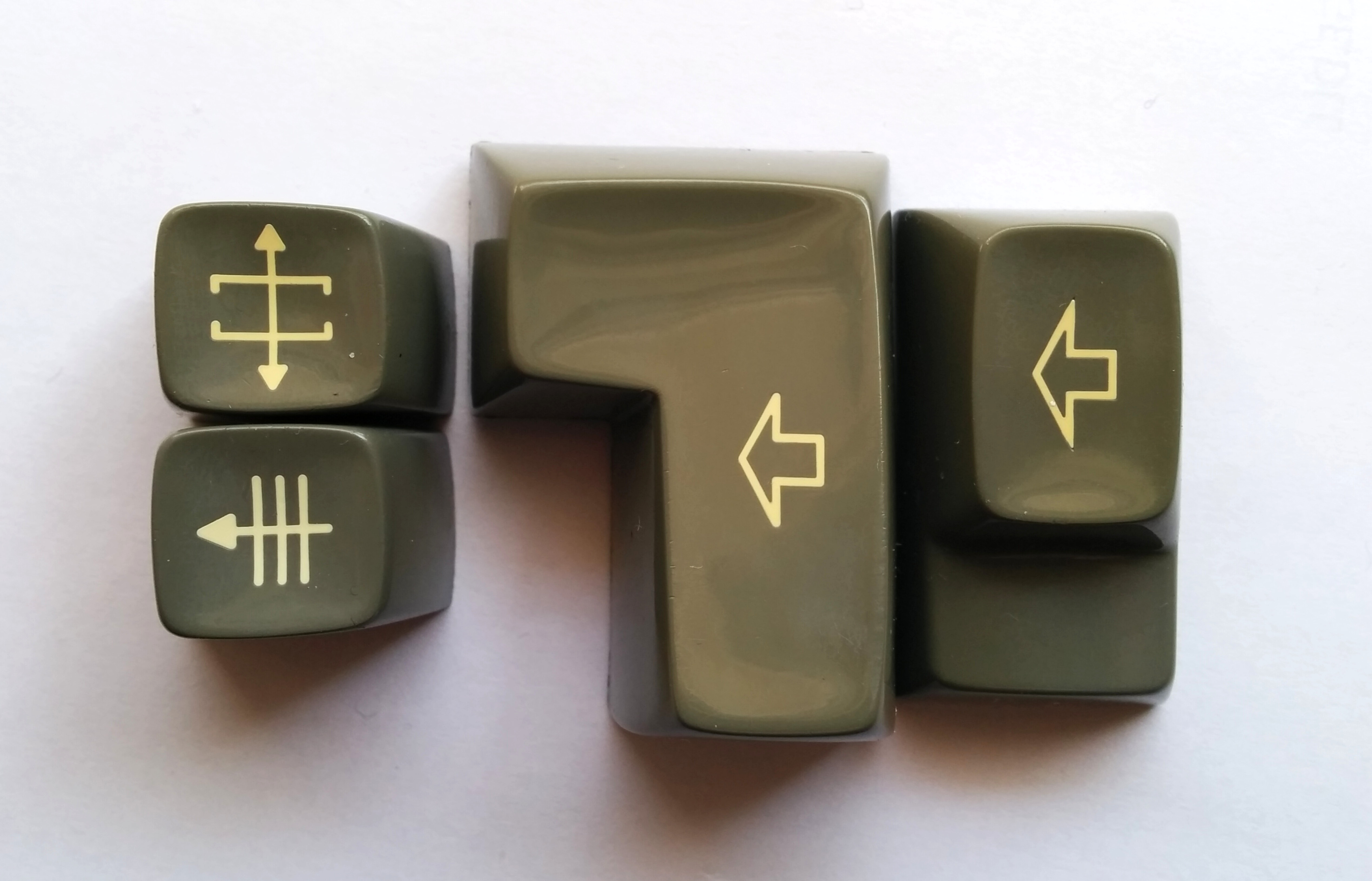

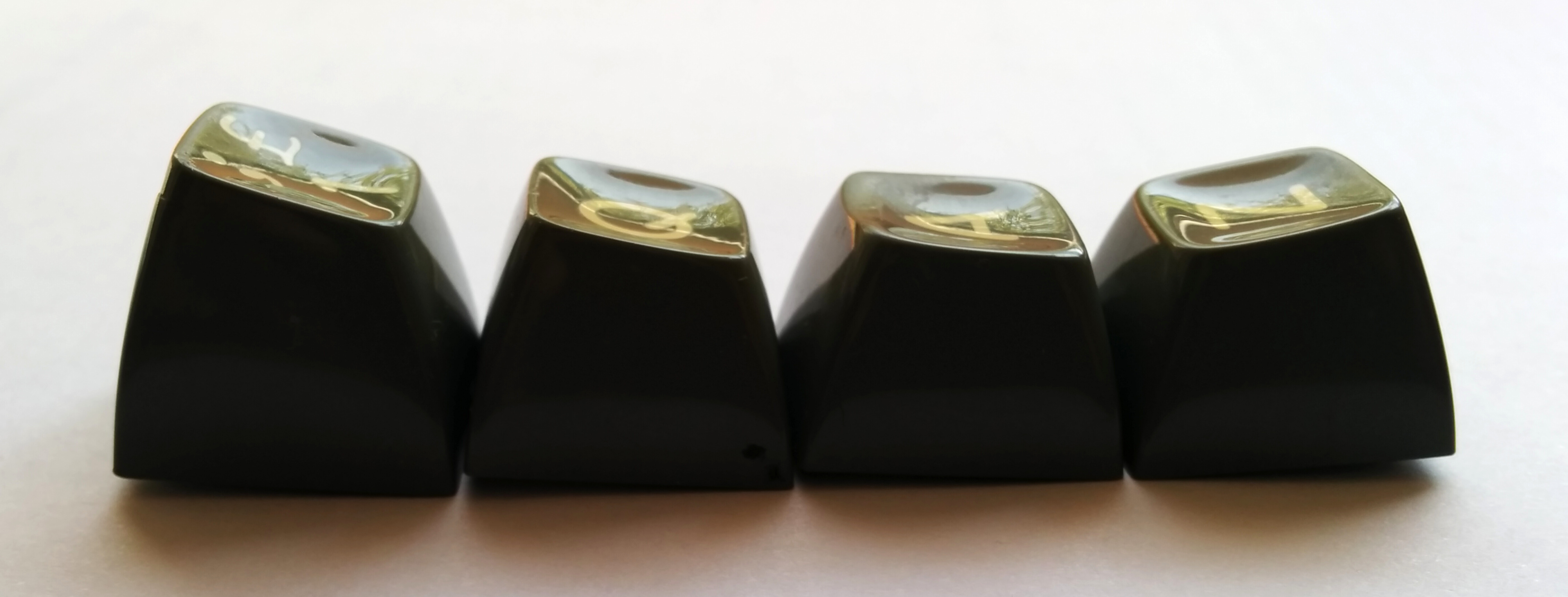

12 May 2016, 15:13
:mrgreen:
The colour scheme of the originals :
And also something beige 8-)

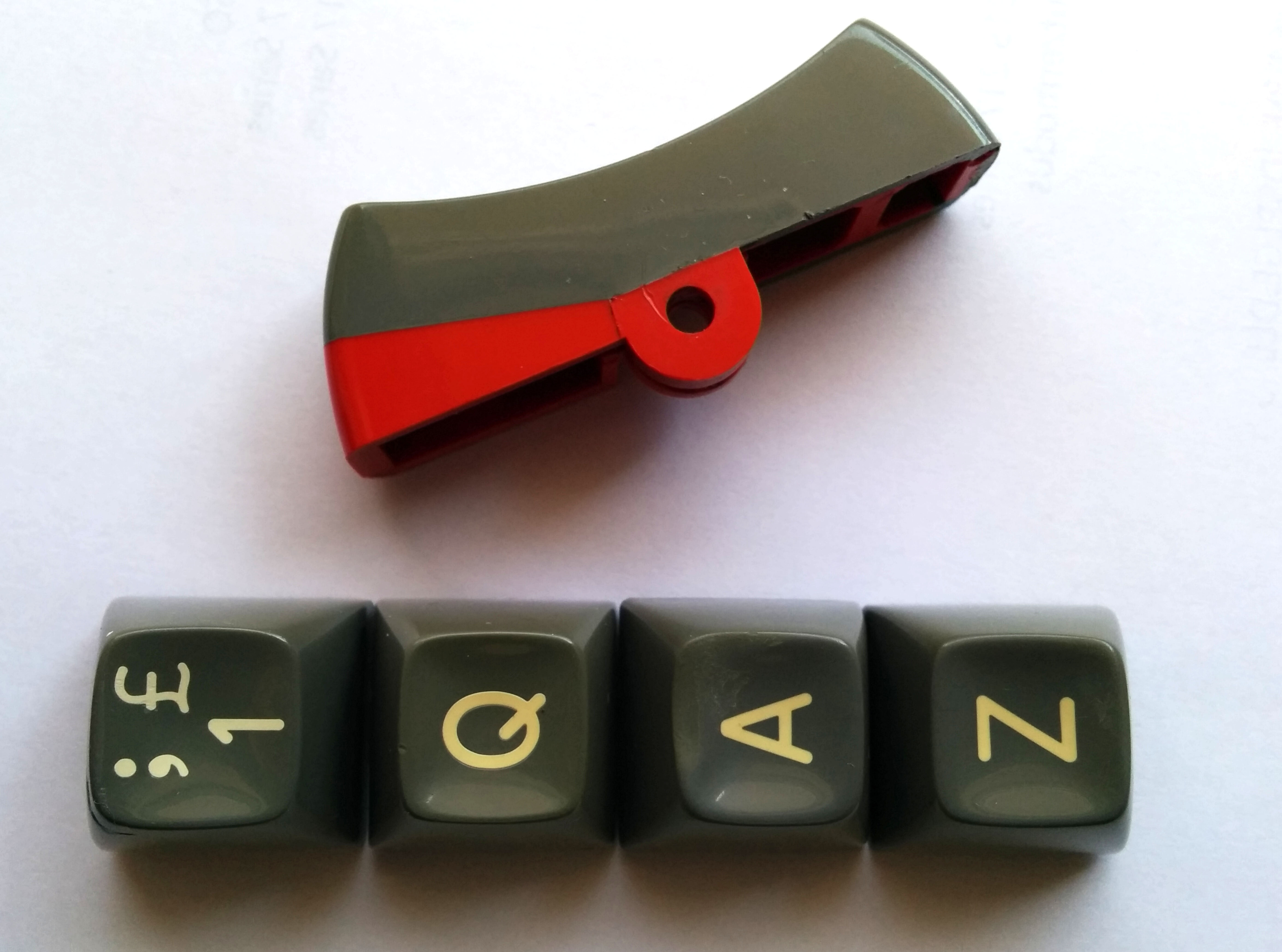

12 May 2016, 15:14
Just for good measure I'll throw in some IBM Selectric keycaps I picked up recently:

12 May 2016, 15:29
snuci wrote: I am curious, which key caps did you choose to base these new key caps from?
3278 beam spring :)
