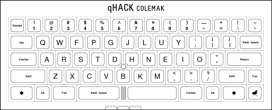

How about combining the revers staggering board with the trackpoint board. Than we can put the trackpoint in the gap between G and H and won't have to use special key caps. This might make everyone happy or maybe no one :)
fossala
Elite +1
04 Nov 2012, 19:32
tlt wrote:How about combining the revers staggering board with the trackpoint board. Than we can put the trackpoint in the gap between G and H and won't have to use special key caps. This might make everyone happy or maybe no one :)
Would make me happy.

04 Nov 2012, 21:52

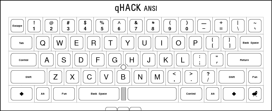

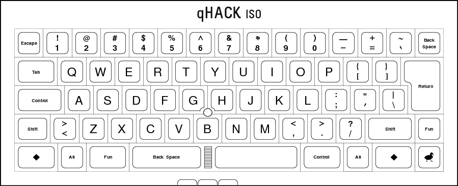

For completeness the qwerty ansi and iso versions.
04 Nov 2012, 22:05
mSSM wrote:miniguru ...
It's the HHKB + miniguru + IBM Erase-Eaze. I added the scroll wheel and Duck key. Although the Duck key doesn't count because the actual scan code is up to the user (like Windows context menu key or something).
It's like an Apple product, it combines theses features into a neat single package... and BAM...revolutionary!

04 Nov 2012, 23:35
If you make this happen, I might get two of those...
Why don't you contact lowpoly asking him about the supply for the trackpoint at least? In case he still is alive that is... I believe he is running around at geekhack occassionally.
04 Nov 2012, 23:45
I remember he elaborated in his miniguru thread about finding the right trackpoint supplier. Should be somewhere in there. Should be a good one. The early IBM Model M13 versions are very good, I didn't like trackpoints before I used that one. You won't use it for photoshop or gaming, but when you're working on the keyboard and just need to hit a button or menu, it's perfect and keeps your hands on the keyboard.
An additional problem which keeps this pipe dream from becoming reality would be the custom space/back space bar sizes. Small right shift and g/h might also be difficult to obtain.

05 Nov 2012, 09:22
webwit wrote:...
Hmm, maybe we should take this from 7bit's thread and move into a qHACK thread?
U crazy??? :mad:
webwit wrote:An additional problem which keeps this pipe dream from becoming reality would be the custom space/back space bar sizes. Small right shift and g/h might also be difficult to obtain.
No problem with the 2.5 and 3 units keys. They exist both for DCS and SA family from SP.
Cutting G and H should be doable.
Trackpoint could be added in the way CeeSA did it on the Tipro.
The mousebuttons need to go on their own PCB, because there is no space below the bottom row. The qHACK requires a special case.
One option would be to use some of the bottom row keys as mousebuttons.
The scroll-wheel is another problem ...
RollermouseFree.
If we just take the wheel unit witout its PCB it should be no problem.

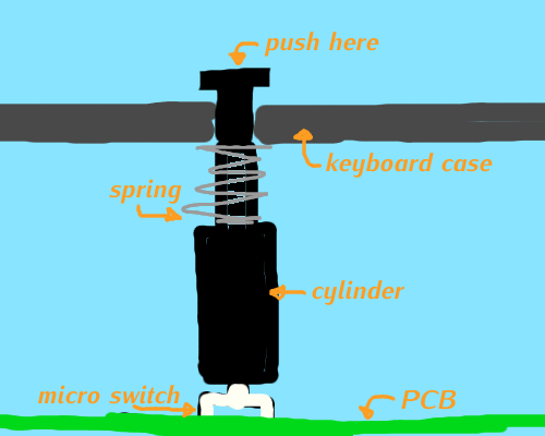

Idea for the mouse buttons:
Dedicated PCB for the qHACK with space in the bottom row for the mouse buttons.
3 holes in the case with 3 cylinders over the 3 microswitches.
