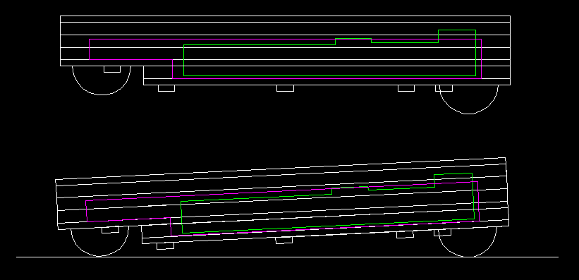

Plaintext based diagrams! All right. Side views of what I was thinking. They are both like this along their entire width, with the back of keyboard to the left:
Stepped Body
Where the base is stepped into two different sections, joined by more side layers and appropriate standoffs.
or
Added Box
Where a second box is added on the underside, with minimal changes to the previous design. Just some holes to allow internal cable routing.
I've been thinking about something like this for my own Bluetooth compatible design, where the back edge would have a hole in the metal for a plastic radio window. This is the most artful way I've come up with to make enough space for the battery and additional components for Bluetooth. Plus a USB hub if I can!
mtl
22 Jul 2013, 07:00
Here's how it looks from the side with a 3 mm basement layer:
The purple box is about the absolute maximum internal space, if you hacked at the key switches and there were no wires/diodes to speak of. The green box is the maximum space required for the controller. I'm on the road now and don't have precise measuements for it. The parts overlapping in the picture are the grey ribbon sockets, which can be removed from the board.
I think it works out well, and gives some more breathing space for the Teensy and other internal components. :-D I had to get creative with the screw holes to get it to work.

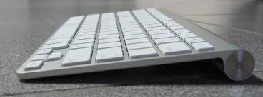

22 Jul 2013, 13:44
Looking good. The incline seems a bit shallow, though. I use my keyboards almost flat and that looks shallower an angle than even Apple's current keyboard:
If you've got a keyboard you're already comfortable with as a model, you could try some measurements. Or of course you're already well ahead of me and this is what you're going for!
mtl
23 Jul 2013, 03:41
Yeah it's at a 3 degree angle in that picture. My keyboard tray does up to -10 or -15 degree negative angles and was hoping to keep this keyboard flat to use it like that. But the tray is still new and I don't know yet what angle I prefer. Also SA keycaps tend to have a more dramatic rise in higher rows which adds to the effective angle.

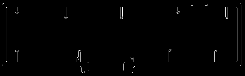

23 Jul 2013, 09:01
my only concern is about those little insets for the screw holes in the upper part. I have no idea how they are going to work. Anyway I'm probably going to have my layout cut this week so I'm gonna guinea pig it for you :)
23 Jul 2013, 11:04
Thanks Matt! Those do look quite the critical point of failure if done wrong. The sections where there's blank space (like under the spacebar, or around it on HHFox) are fine, but squeezing in between the mass of keys in the top rows is quite the challenge.

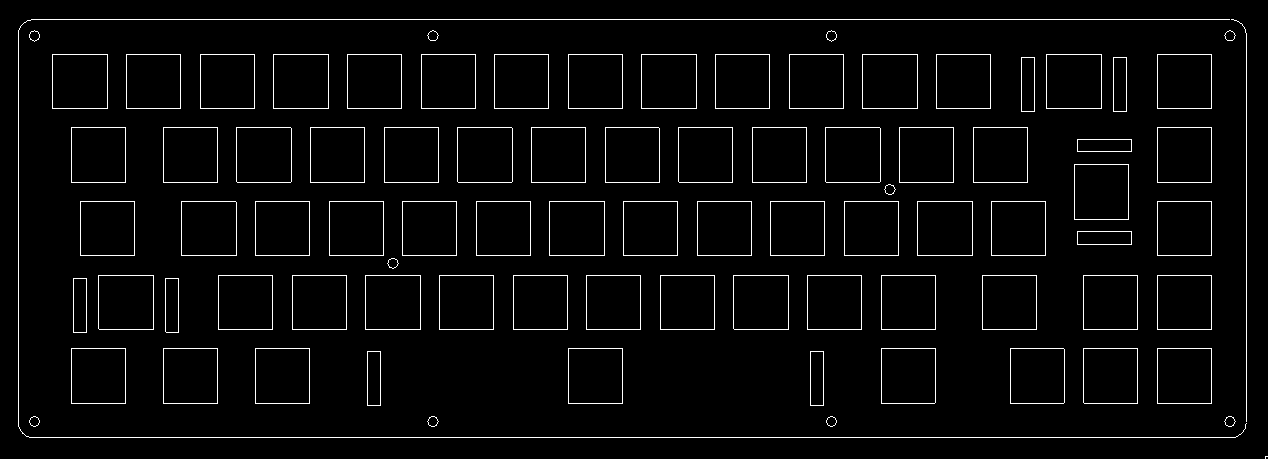

26 Jul 2013, 12:05
Broadmonkey's updated board
please double-check!

26 Jul 2013, 17:24
kps wrote:Any tips on using DraftSight for this purpose? Specifically moving/copying groups of key holes on the appropriate ⅛u grid.
Use array command to build your initial 15x5 (or whatever grid), then start to move holes around.
I use the following formula to space slots. Please note that I use 19mm spacing instead of 19.05mm as suggested.
((19×k1u−14)+(19×k2u−14))÷2
Replace k1u with the units of the first key and k2u with the units of the second.
Eg:
((19×1.5−14)+(19×2−14))÷2 = 19.25
19.25mm is the distance between a 1.5u and a 2u key (side to side, not centers). I don't know if this is the best (or even correct) way but it worked for me so far.
kps wrote:Is the cost primarily metal plus laser time (roughly, cut length), or are there other factors to be aware of?
yes the cost is metal + cut length. I'm not aware of any additional cost, apart from shipping. As a rule of thumb don't create holes smaller than the sheet thickness.
