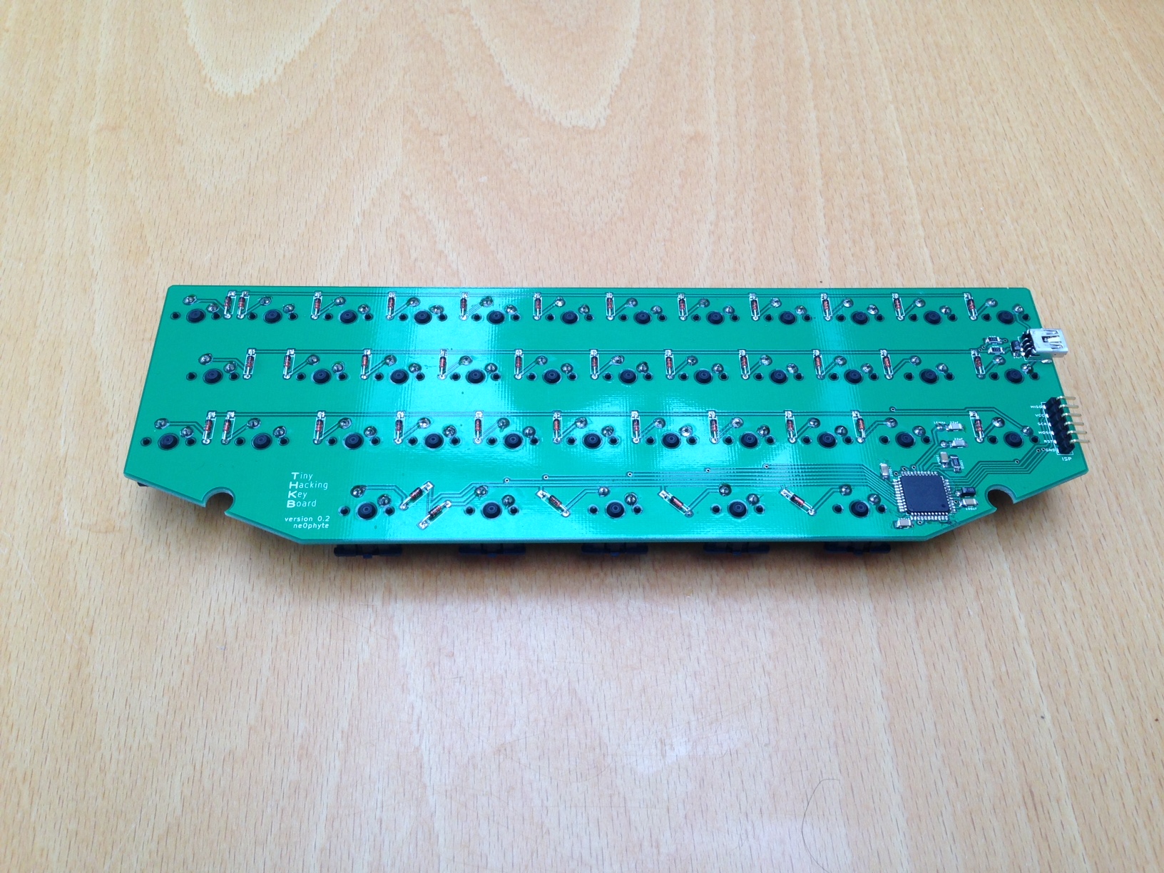

Just out of interest, is it obvious which way round the diodes go? I'm a bit of an electronics noob, and I don't want to have to desolder and resolder all of them if I get it wrong!
- Muirium
- µ
- DT Pro Member: µ
If this picture shows the PCBs diode side up (which I think it does) then those rectangles look like a good sign for "insert diode here", and each of them has a stripe at one end. Just like you'll find on your diodes.
- RoastPotatoes
- Location: United Kingdom
- Main keyboard: HHKB
- Main mouse: PC-TRAC Deluxe +
ne0phyte did a good job with this. There is a mark for where you need the diodes to go and they have the line on them facing the direction you need them to go.
- ne0phyte
- Toast.
- Main keyboard: HHKB Pro 2
- Main mouse: Mionix Avior 7000
- Favorite switch: Topre 45g, MX Blue
- DT Pro Member: 0003
You guys are too fast for me. Yes, there is a black line on the diode that you just line up with the line on the PCB.
EDIT: That reminds me, I have to change the size of the diode footprint. The pad distance can be a lot smaller for those tiny diodes.

I am missing the 2 22Ohm resistors what supposed to go next to the mini USB on the PCB. I have to go to my local electronics shop tomorrow morning
PCB looks great.
I did all the SMD first, now the diodes and the switches.

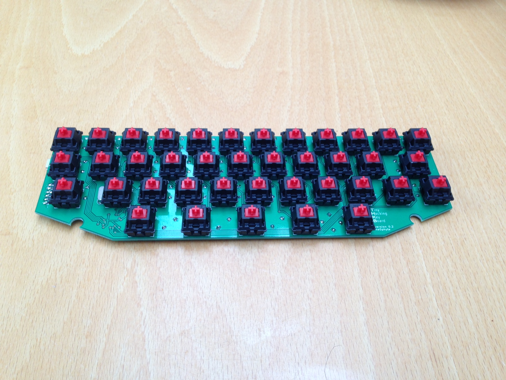

Did all the soldering. Not a pro with the SMD stuff but slowly learning. I think all parts are fine now.
If I plug the USB cable in on my windows machine I see a ATm32U4DFU in my Other devices present so there is some communication
Now I wait for the ordered USB programmer, should come on Wednesday or Thursday
- Soldering done
- IMG_1802.JPG (712.51 KiB) Viewed 11025 times
- THKB with some MX Reds
- IMG_1801.JPG (643.97 KiB) Viewed 11025 times

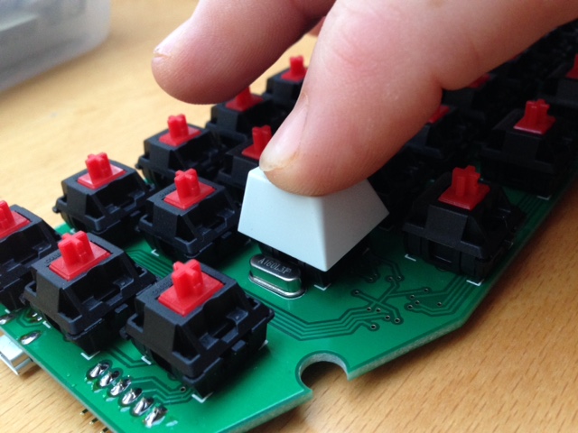

malcomkern
- Location: Haarlem, The Netherlands
- Main keyboard: IBM
- Favorite switch: Bucklingspring
Yes it is. Key fits easy, never goes down all the way to the crystal. See photo.
