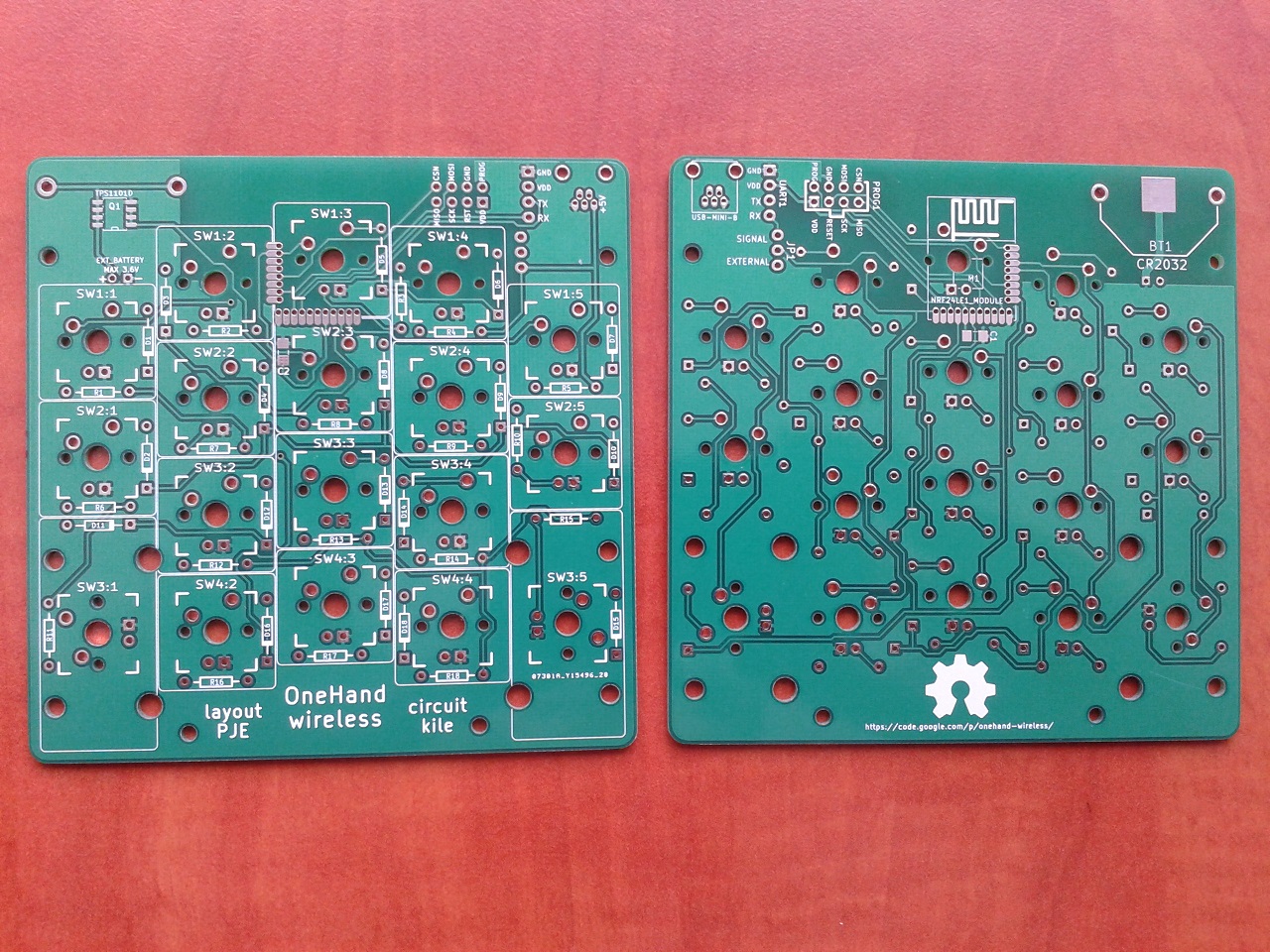

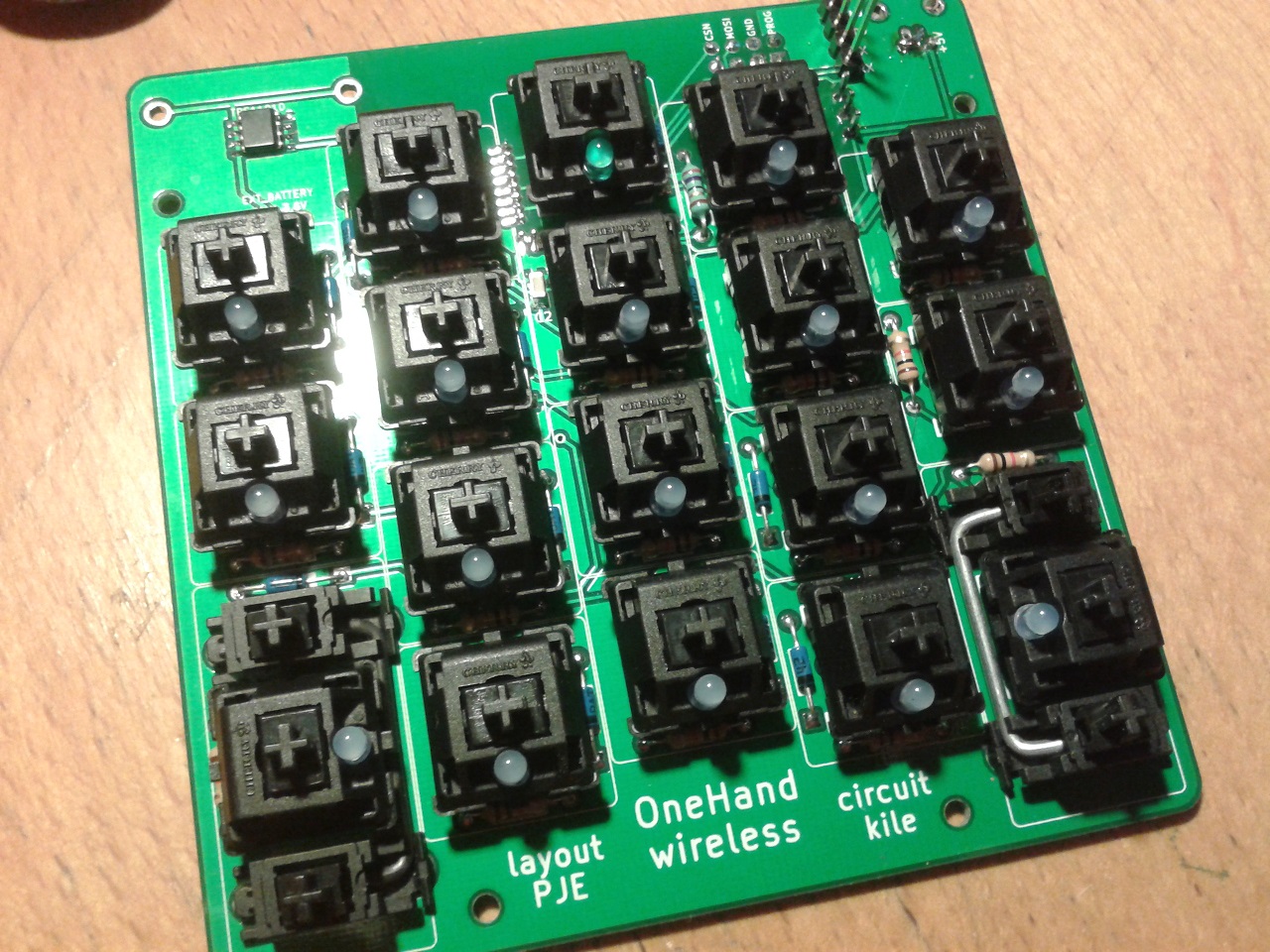

Look what Santa just brought! :D
onehand wireless PCBs
I didn't expect these for another 10 days at least. By a stroke of luck, the family is out of town for the weekend, so I will have two whole days to play with my precious creation.
I pledged for one of these https://www.kickstarter.com/projects/ee ... nt-adapter and I'm still waiting for it - it should arrive any day now. That thing will help a lot with tweaking the current consumption and prolonging battery life.

kile wrote:Look what Santa just brought! :D
Looking good!
I'm excited to see how the wireless system works out. I decided against wireless, and LEDs for V2 of my design. I'm thinking of a V3 with embedded CPU as it would give me an excuse to buy a reflow oven :)

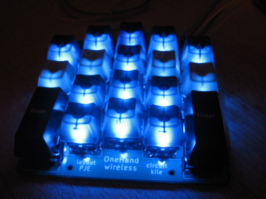

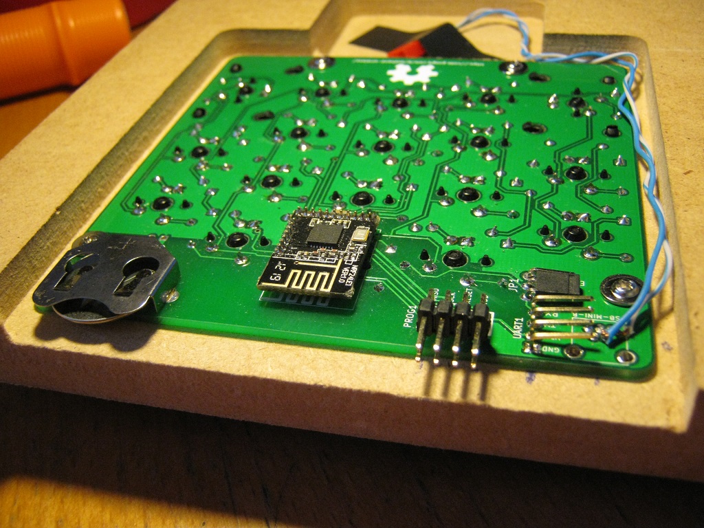

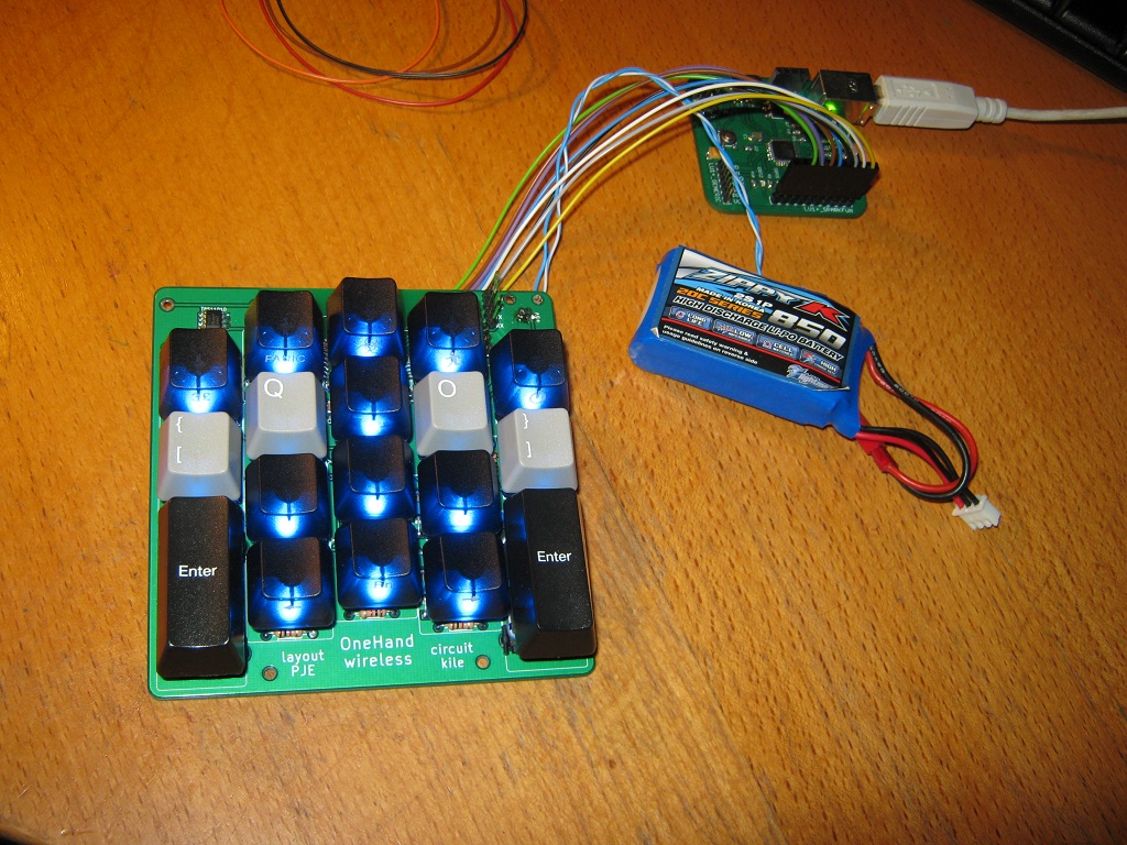

And it's working! :) I made "only" one mistake on the PCB design - I reversed the LED USB plug. It should actually be soldered to the top of the PCB to work properly, but I wanted it on the bottom. No biggie, since I only use the LEDs for laughs anyway. I soldered a JST connector to power the LEDs from an external battery just to see what it looks like with all the LEDs on.
So, everything works - the matrix, the UART debug output and the most important thing - the radio. But, nothing works as it should :) I am not putting the MCU into sleep mode at all yet, so it draws a lot of power. Which is why I didn't solder the CR2032 battery connector yet. I am powering the circuit from the programmer connector and reading the matrix in an infinite loop, just like you would on a wired keyboard. I'll work on this during the weekend.
Most of the caps are leftovers from the max keyboards translucent set I bought for my beloved 7G. The rest I took from my old 6Gs. I'll probably get a full blank set for this board from WASD or some other place. Any suggestions?
PCB with blacks
PCB with blacks
board bottom
board bottom
board connected to the programmer and the battery which powers the LEDs
vegas mode
vegas mode
If anyone likes adventure, I can send PCBs and help people with the assembly and programming. You will need a dedicated MCU programmer, though, because these chips do not have bootloaders which is probably their biggest drawback.

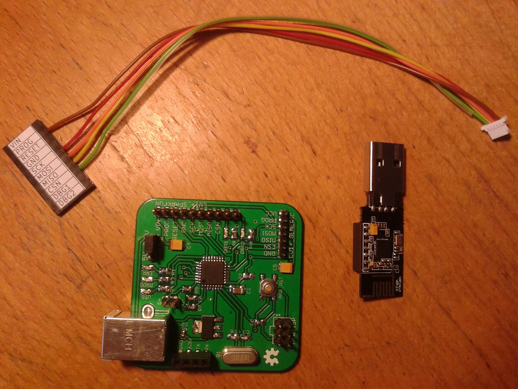

The reverse-proof programming connector is only reverse-proof on the controller side, and the programmer side has a sticker with names of the pins which helps plugging it in correctly. I will post pictures of these in a few days because I don't have these connectors yet.
You will also need the controller module (nRF24LE1), and a USB dongle (nRF24LU1+), and you can get these on ebay. I don't want to include these because I don't have enough of them and you can't really save in shipping. I have three extra nRF24LE1 controllers which I can sell but only if you want me to solder it in too.
Controller: http://www.ebay.com/itm/NRF24LE1-NRF24L ... fresh=true

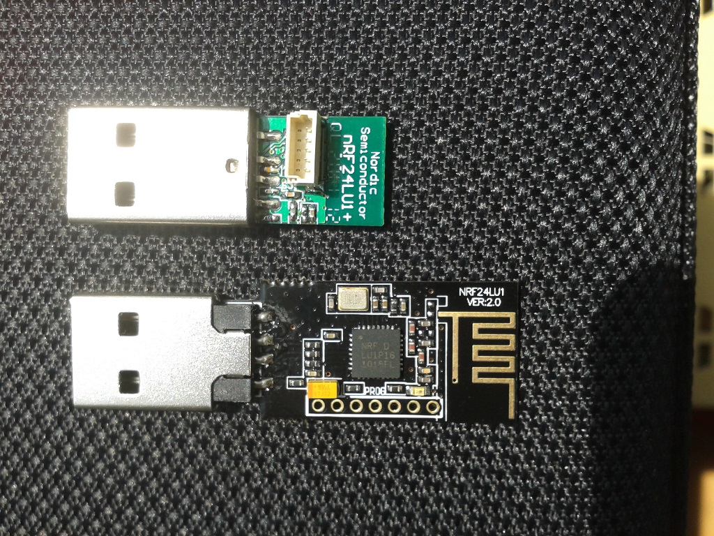

The USB dongle comes in three variants. The first one is the cheapest ($10 shipped) and smallest (link). But there's a catch - it needs a programming cable which is a total bitch to make. To make it properly, you would need a crimping tool which I don't have and they are ridiculously expensive. So I have to improvise - I made these with some small pliers. I timed myself last night and it took an hour of frustration, swearing and sweating. Assembling the programmer takes less time and is a walk in the park compared to this. Which is why it costs as much as it does. The parts for the this cable are cheap (less than 1 EUR) and I will send them if you want to try your luck and assemble it yourself. But I don't recommend that.
The second dongle option is $20 shipped (link), it's larger and has a tiny red LED on it which the firmware running on the dongle can use. Currently my firmware makes the LED blink when it receives data from the controller. It does not need a programming cable because it can be plugged directly into the programmer if you solder a header on it. The header will be included in the package.
Size comparison:
USB dongles size comparison

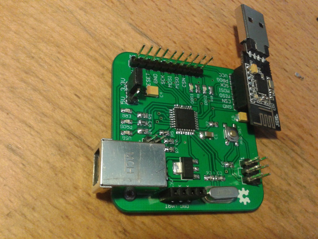

Dongle 2 with the programmer and the cable from hell:
dongle 2 and pain-in-the-ass programming cable
Dongle 2 plugged in:
dongle 2 plugged in the programmer

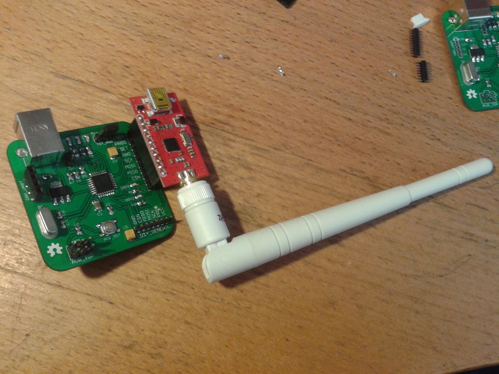

The third option is sold by SparkFun here. It's $36 + shipping and you need a 2.4GHz duck antenna for it as well which is not included. It can also be directly plugged into the programmer. This is the best option if you want to develop firmware. It has two extra pins which are brought out to the connector and further connected to two LEDs on the programmer, so you can turn them on or off from the dongle. Very useful for debugging! These are marked DBG1 and DBG2 on the connectors and the programmer PCB.
SparkFun dongle:
SparkFun dongle with antenna

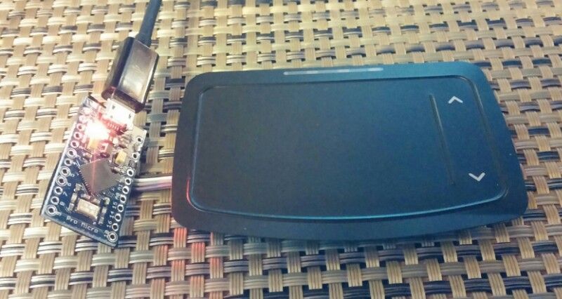

I've been playing with my V2 layout, and have come to the conclusion that it's good enough! The PCB allows a ProMicro to be mounted on the rear in the same way as before, but a second PCB without the CPU can be linked for a TwoHand layout. Also I've included two I2C connectors to allow daisy chaining of the boards with CPUs, and finally I've added the PS/2 interface, which uses the serial TX/RX pins for added flexibility.
Before I pulled the trigger on the PCBs I did a basic test on the PS/2 touchpad interface, using a cheap ($3) surplus Synaptics touchpad from a laptop wired to the TX, RX, 5V & 0V pins of the $5 ProMicro.
I've used the various PS/2 Arduino resources on the web to write an interrupt driven touchpad interface. It generates x and y positions as well as the virtual button press signals from the PS/2 stream. Using the interrupt driver for the receive should allow it to run in the background without interfering with the keyboard scanning too much. I now have to decide how I'm going to use the pad - mouse replacement, or cursor control... For some reason the side scroll bar is not working - probably a configuration issue, but I'll keep working on it!
Now that I'm reasonably happy with the next iteration I'll probably be ordering the PCBs this week.

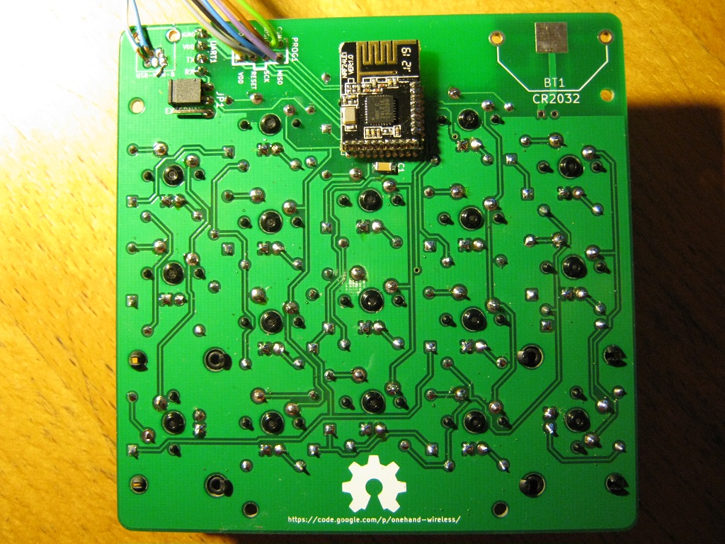

The firmware for the OneHand Wireless has changed a lot. I've added most of the things from my 7G wireless project: the menu system, a clock which shows the time since power-on, RF packet statistics and battery voltage monitoring. Actually, it's not really monitoring, but it shows the current voltage of the power supply in the menu. So, for instance pressing Func+Esc (if those are bound to a key) will send this to the host PC:
OneHand wireless
firmware build Apr 15 2014  19:23:50
battery voltage: 2.76V
RF packet stats (total/retransmit/lost): 213/39/0
keyboard's been on for 34 minutes 44 seconds
So, depending on the type of battery you have, you can guesstimate how much power you still have in them.
The menu is not really a menu yet, because there are no options to select, but that will change. For instance, it can be used to switch layouts.
The clock has a 2 second resolution. It's not terribly accurate (about 1%), but it's more than good enough.
And I've added sleep modes as I've planned. I still don't know if they work as I want them to, because just like with the 7G I can not directly measure the power consumption of the circuit. I just put the MCU to the required sleep mode, and the thing wakes up after the given sleep period. I really can't wait to get my hands on the uCurrent. That will change things a lot and make everything easier and more accurate in estimating battery life.

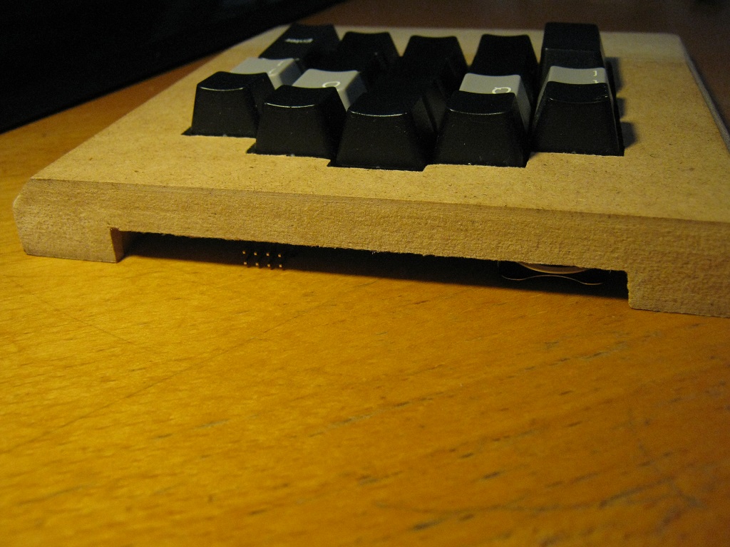

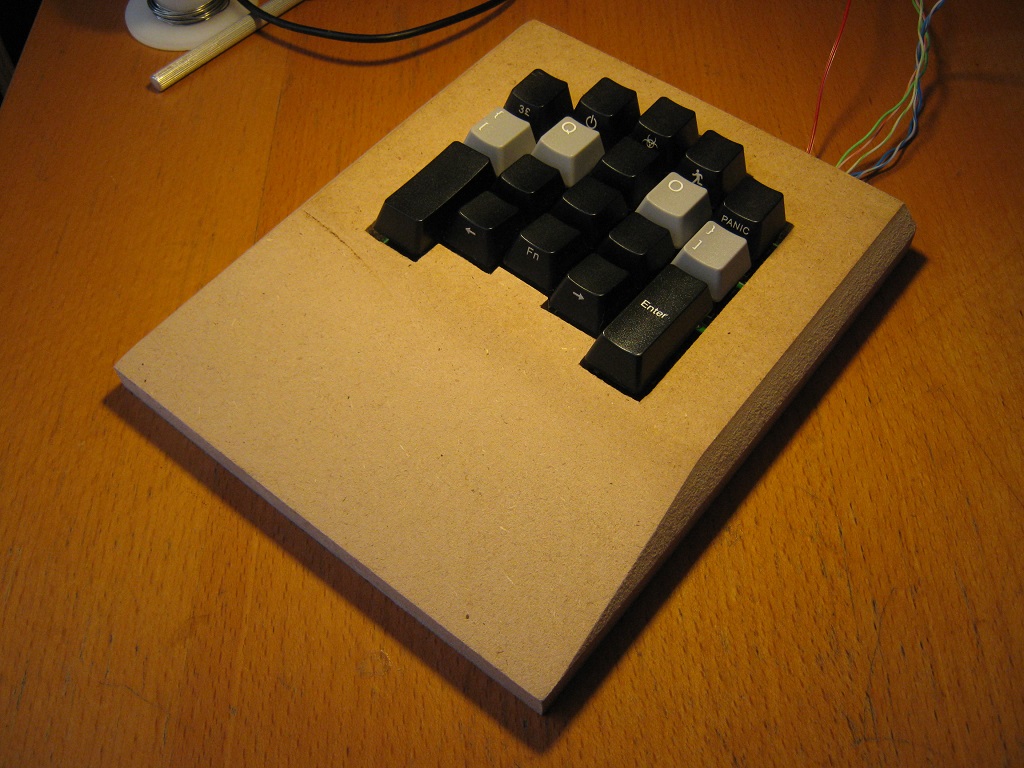

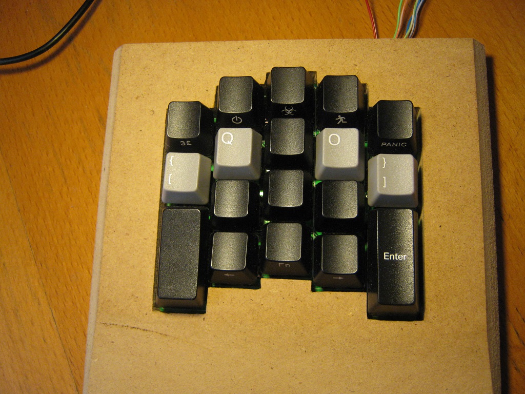

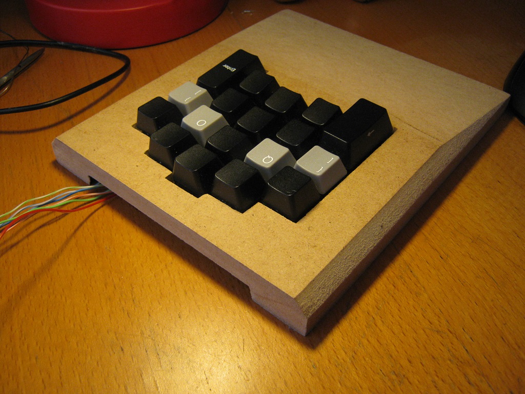

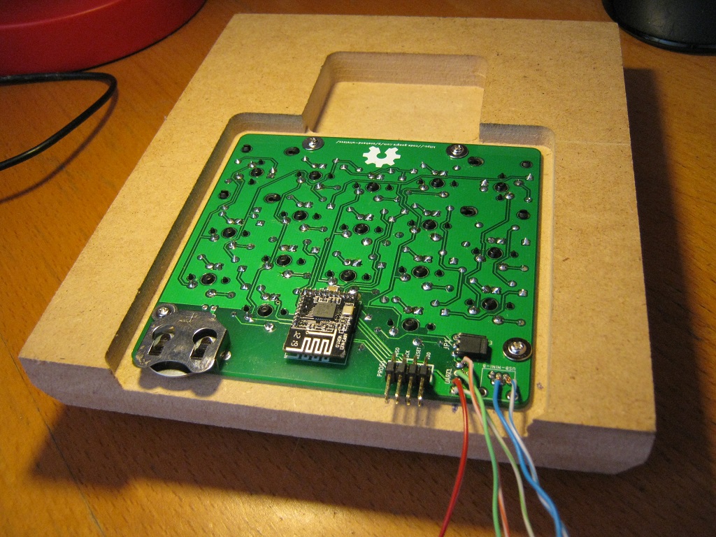

I had a prototype case made. I'm really happy with how it turned out. It's MDF and not real wood, but it's good enough for a prototype. I messed up a few spots for about 1mm, but overall - YESSSS!!! :D
view 1
view 1
bottom view
bottom view
front view
front view
top view
top view
01 May 2014, 13:04
Rather smart. But you're going to want to so something about those loose wires, Mr. 2.4 GHz!

kile
01 May 2014, 14:28
Muirium wrote:Rather smart. But you're going to want to so something about those loose wires, Mr. 2.4 GHz!
Yeah, I know. A wireless keyboard with wires sticking out of it :roll:
Anyway:
look ma, no wires!
look ma, no wires!
look ma, no wires! (part II)
Happy now? :D
The white/blue wire will have to stay. That's the LED power cable, and I don't want to remove it yet.
And the serial debug connection has been replaced with a pin header, so I can now plug it in/out as required.
matt3o wrote:I just wanted to chime in to say that I'm enviously following this thread and you gave me some very interesting ideas for my future builds.
Well, thank you from my part. But as I said before, this is really not as complicated or hard as it may look. And I am more than happy to share any and all knowledge I might have on these things. All that's required is an honest will to learn. Coming up with projects that allow me to learn about electronics is my main motivation for doing this. I don't really need this keyboard that much, you know :)

kile
02 May 2014, 19:16
PJE wrote:How's the wireless data transmission working out? Any data on battery life yet?
Wireless transmission's been working good for a while. I don't do frequency hopping or anything fancy like that. I just set it to a channel away from the WiFi range, and it seems to work just fine.
I still didn't receive the uCurrent, so I can't measure the current draw. But I've had an almost drained CR2016 in it (it's already been almost drained when I put it in) for a few days, and it's been working fine. The current voltage hovers around 2.4V, so it should die any minute now.
kile
11 May 2014, 19:01
I've received the μCurrent and did the power optimizations I planned to do. So, now the MCU really draws about 4μA in sleep mode just like the datasheet claims. (technically, this sleep mode is called Register retention mode in the datasheet), I'm glad I actually waited for the μCurrent. When I first measured the sleep current it was around 45μA, and it turned out that I configured something incorrectly, so we're Ok now.
Still to do:
- some kind of intelligent handling of the one LED that the MCU can control
- layers
