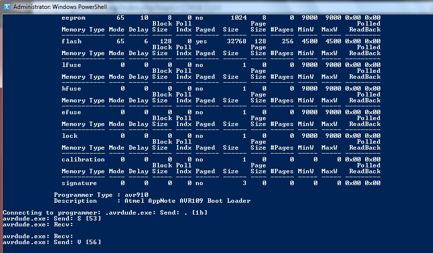

I am trying to flash it by putting in the command:
& 'C:\WinAVR-20100110\bin\avrdude.exe' -C 'C:\WinAVR-20100110\bin\avrdude.conf' -vvvv -p atmega32u4 -c avr109 -P com5 -b57600 -D -V -U flash:w:"C:\Users\A\Desktop\Soarer_Converter_v1.12_update\Soarer_at2usb_v1.12_atmega32u4.hex":i
But it gets stuck here, please help
I don't understand what those last lines mean...
It's running on Win7 32bit, serial port is COM5, and I've everything soldered already (not sure if this will effect the process)
