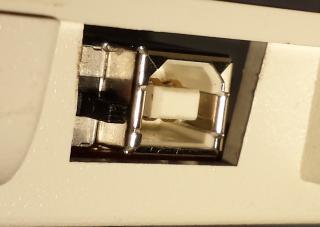

Thanks for the encouragement everyone! I was getting a little bummed out about the Micro B. The only issue I was having with using USB-B on bluetooth applications was the power switch... but then I stepped away and got to thinking about some clever mounting techniques I've seen in vintage electronics. Solder the switch case to the USB connector! Plenty of space and it's a perfect fit.
Ideally it should be moved out about 2mm, but at the moment it's pretty easy to actuate.
