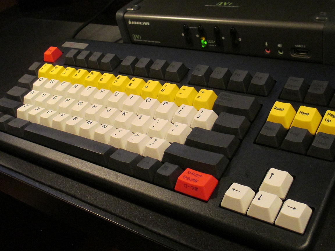

Regarding Silencing Rings, yesterday and today I installed them in two RF boards: a RF87UB-EK45 and a RF87UB55. I am very pleased with the results on both boards. Between the two, I prefer the sound and feel of the 55g version.
I've also decorated the 55g in a "pseudo skull squadron" scheme:
This mix of colors is similar to one of matt30's designs for the Topre keycap set. I really like this board; it is currently my favorite TKL. If it were 60% with a HHKB layout, I think I might like it even more than my silenced HHKB Pro 2.
Overall, I now prefer silenced Topre over stock Topre.

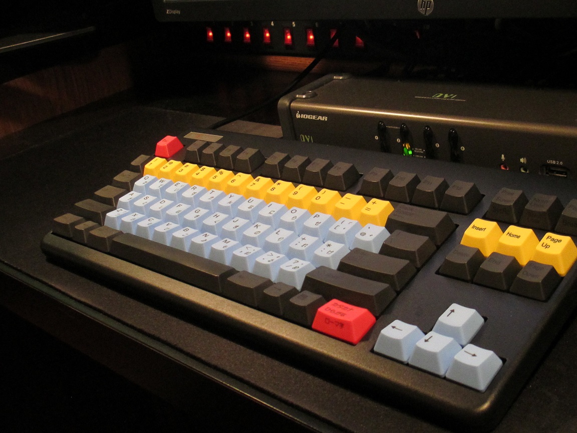

Per request, here is a pic of my "pseudo skull squadron" with blue alphas from a set for a Japanese 108 RF board:
I like a sky blue background on alpha keys to provide a softer contrast than one gets with white alphas. I also like the arrow keys to match the alphas on a TKL board.
