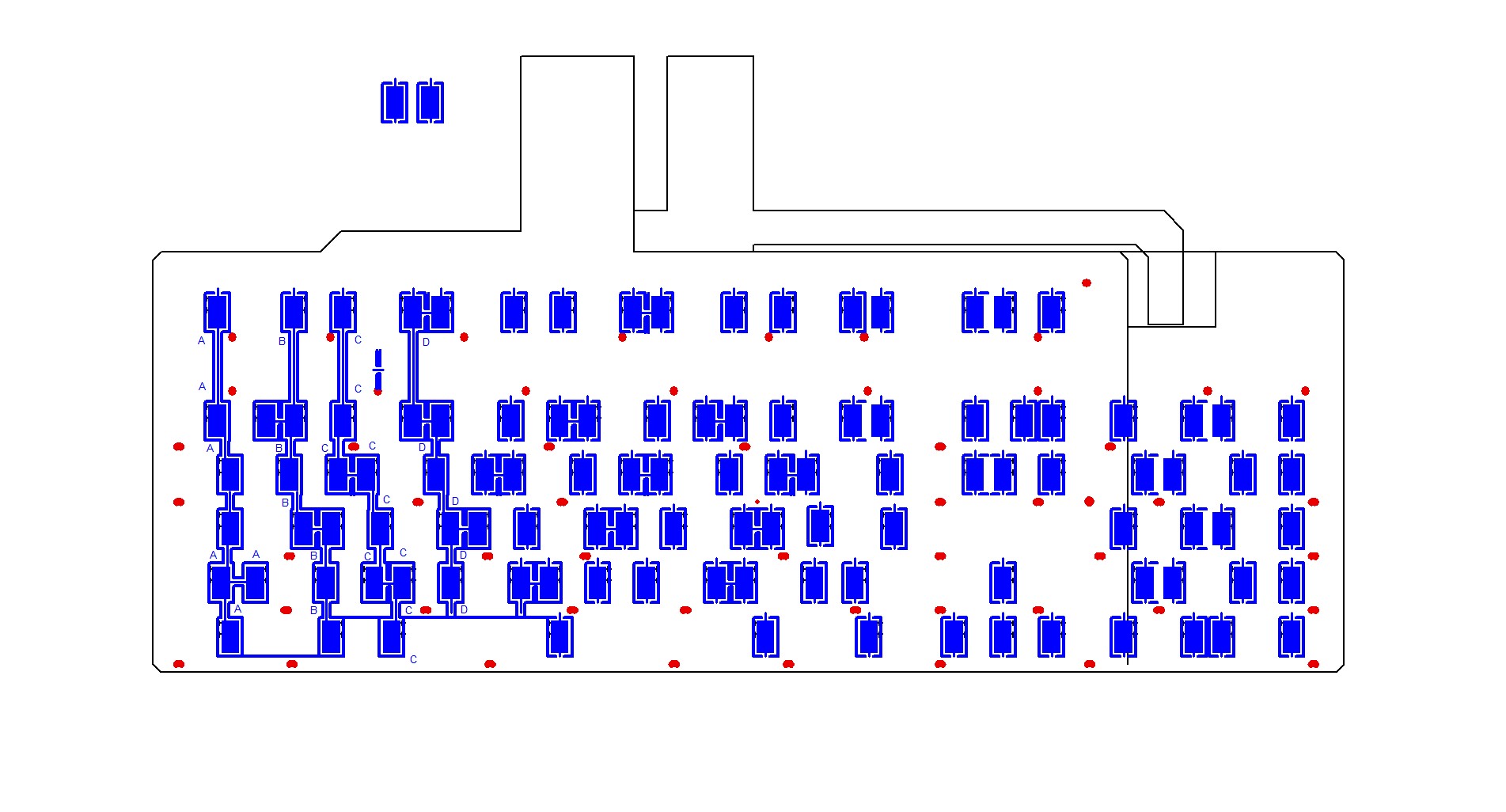

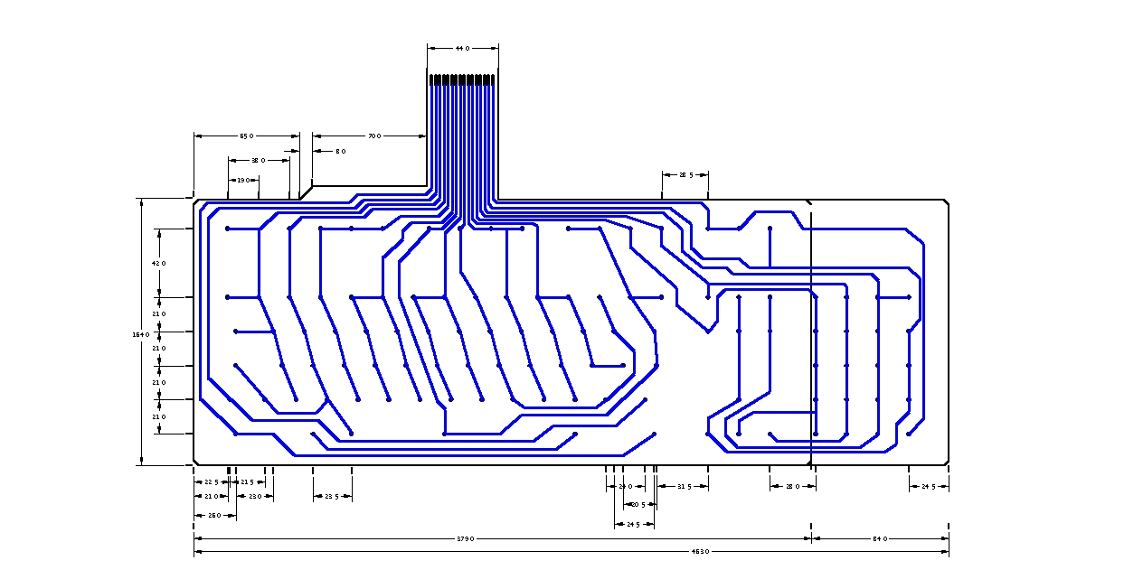

some progress today:
I decided to start again modeling the PCB
The previous work was somehow chaotic. I decided to start again, this time with the membrane, to then continue with the PCB.
This is the version 0.1
FSSK v0.1.jpg (86.03 KiB) Viewed 6751 times
From the picture you can see that the membranes of the Model M Extended and the SSK have the same layout. Thus, I have decided to model a PCB for both keyboards. We will have the FSSK and the FEXM (F Model M).
The latest name reminds me to what happened to the "Mouseless commander", when mouse control was added :-)
Feel free to propose a different name
Next is to add the holes
idollar
i$
21 Dec 2015, 10:30

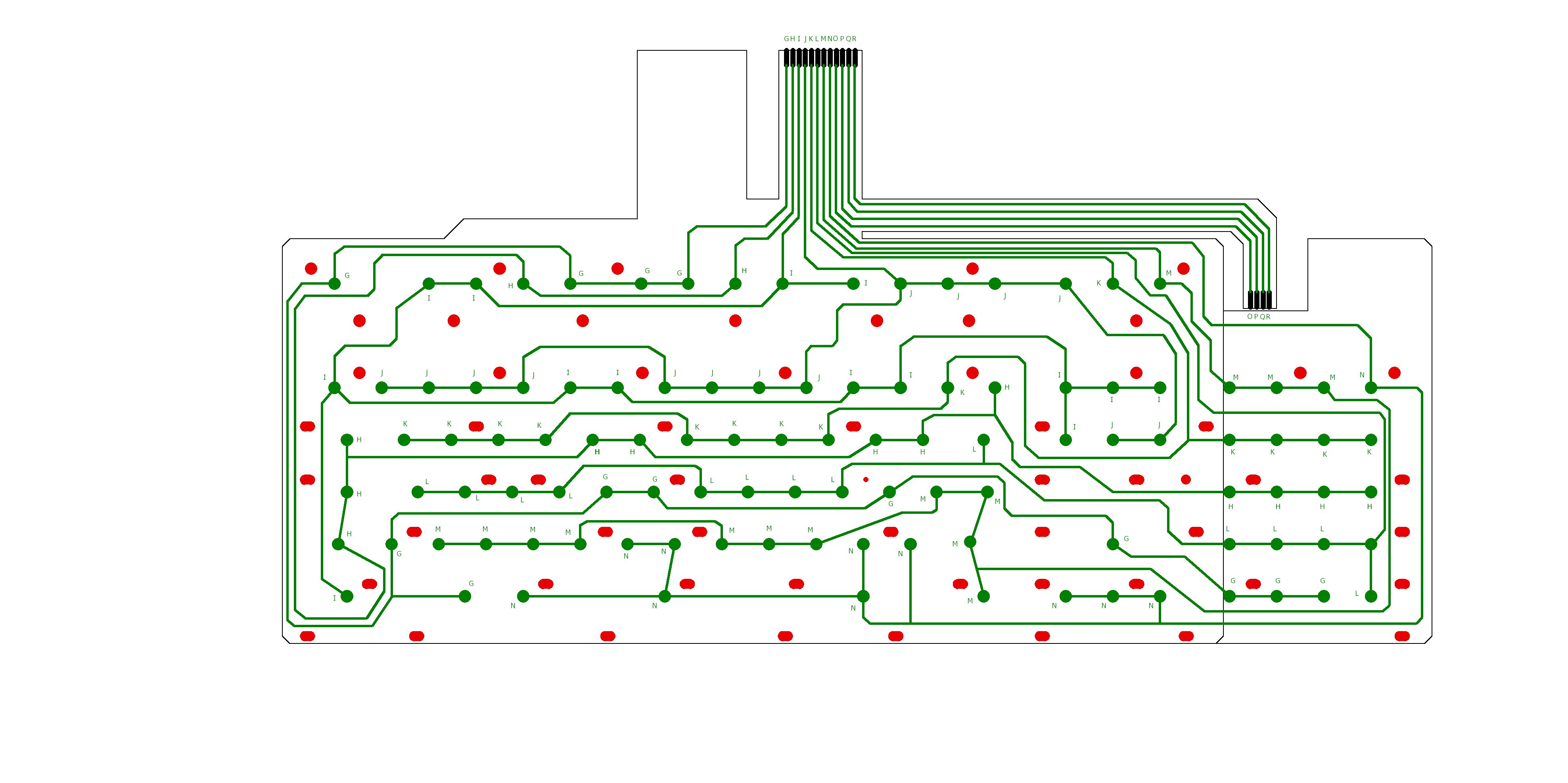

And here is the version 0.2
I have added layers and the bottom routes
I just realised that I will need to modify it. I have not added the holes for the screws. This is the next step
FSSK v0.2.jpg (221.48 KiB) Viewed 6726 times

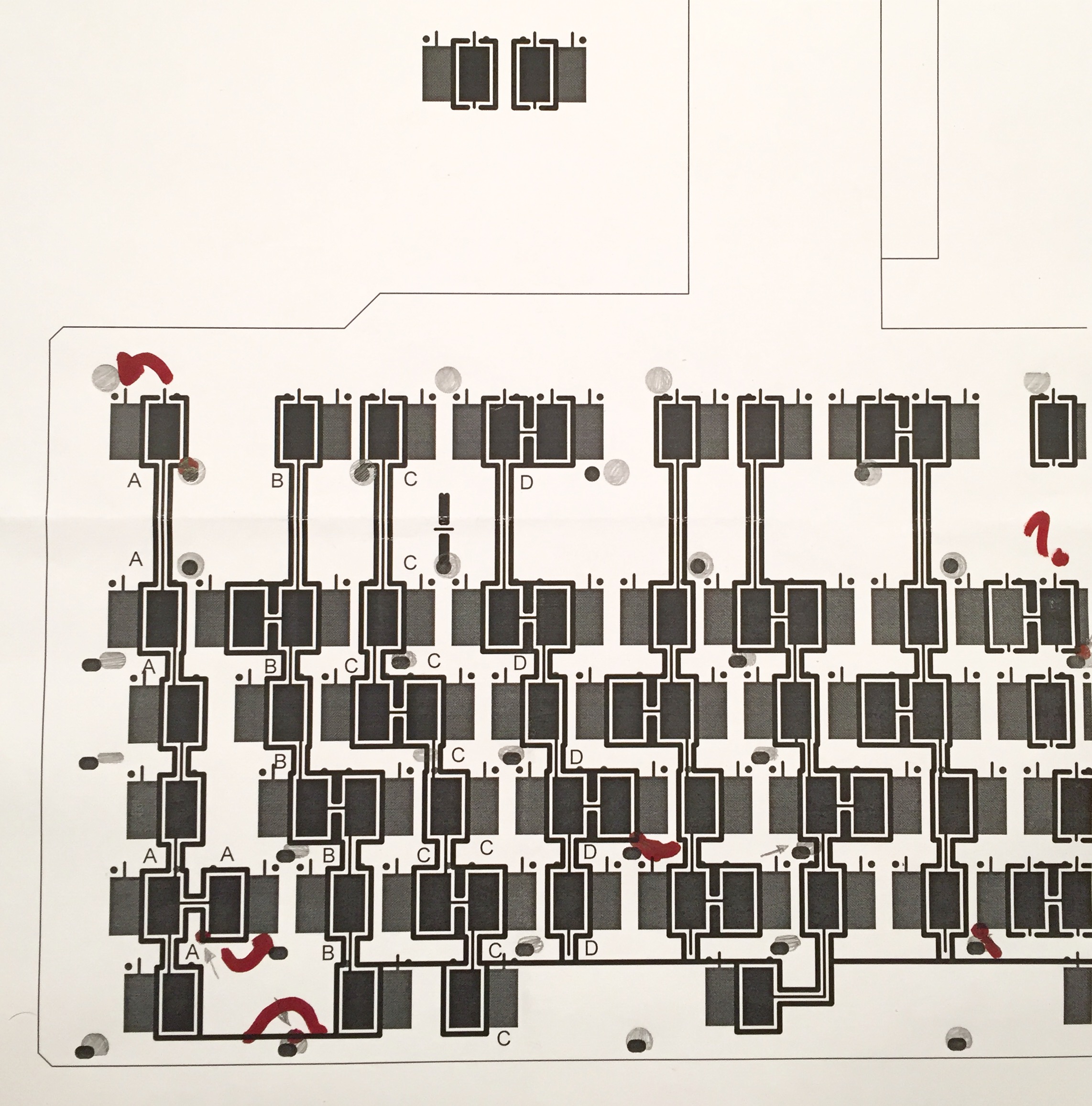

neverused
21 Dec 2015, 10:58
idollar wrote:And here is the version 0.2
Is it just me or are the left and right alts not connected?
shreebles
Finally 60%
21 Dec 2015, 11:05
He said he added bottom routes. That means that there are probably traces on the PCB running to the controller on the other side, which are not on the graphic because it is 2D. Not 100% sure but it's what I figured.
Other than that, awesome i$, always great to see progress!
idollar
i$
21 Dec 2015, 11:08
Yes, these are errors. Thanks
I am reporting while doing.

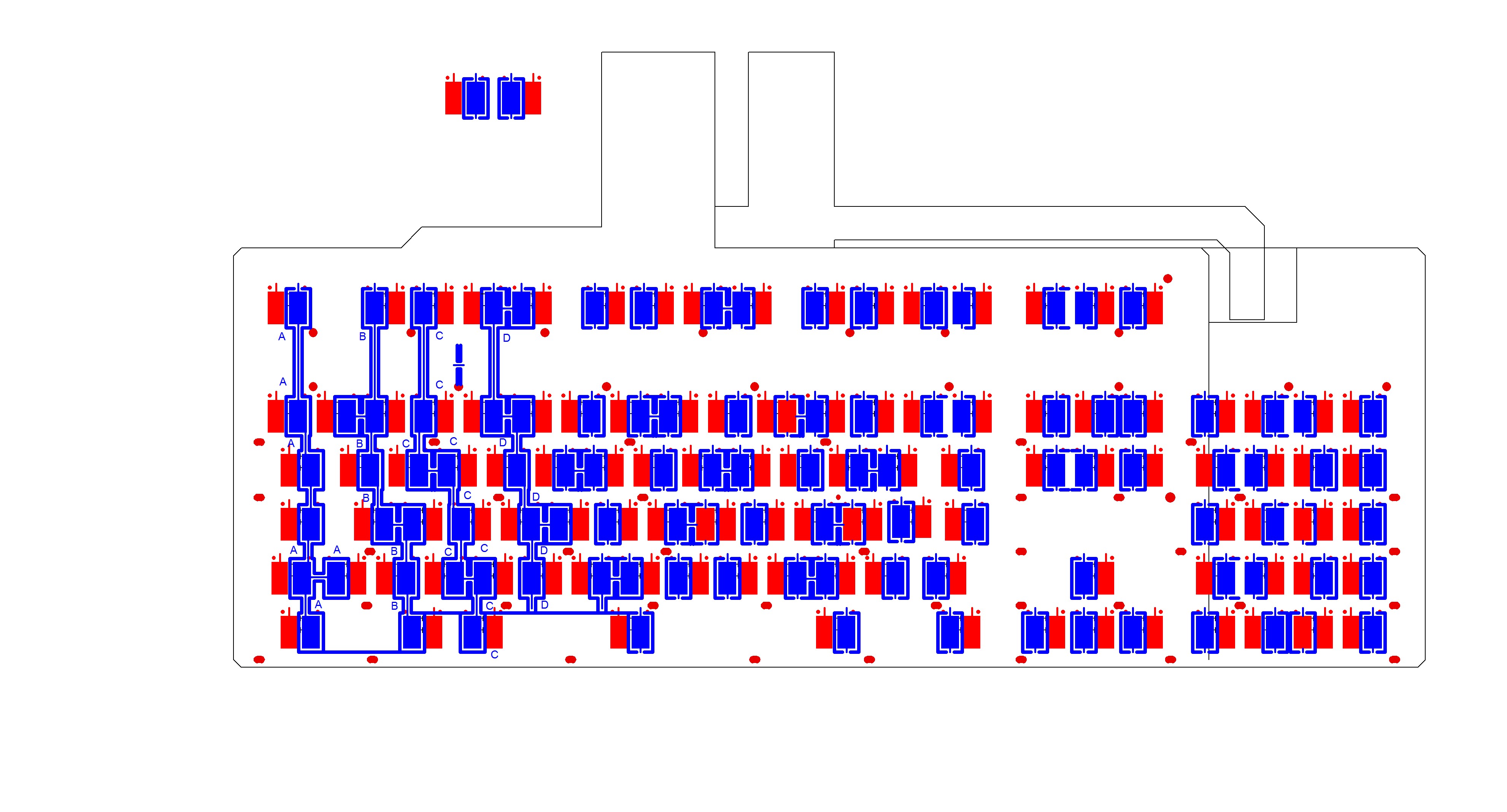

idollar
i$
21 Dec 2015, 16:50
And here is the version 3, with the bottom layer complete for the Extended M and the holes
FSSK v0.3.jpg (532.86 KiB) Viewed 6713 times
Next the top layer (just for reference, in the case that some one wants to use these files)
idollar
i$
21 Dec 2015, 19:45
And here is the top layer: Version 0.5
FSSK v0.5.jpg (476.15 KiB) Viewed 6692 times
Next the PCB, which was the goal, actually :-)
idollar
i$
21 Dec 2015, 20:49
Here both layers together.
FSSK v0.5b.jpg (728.33 KiB) Viewed 6657 times

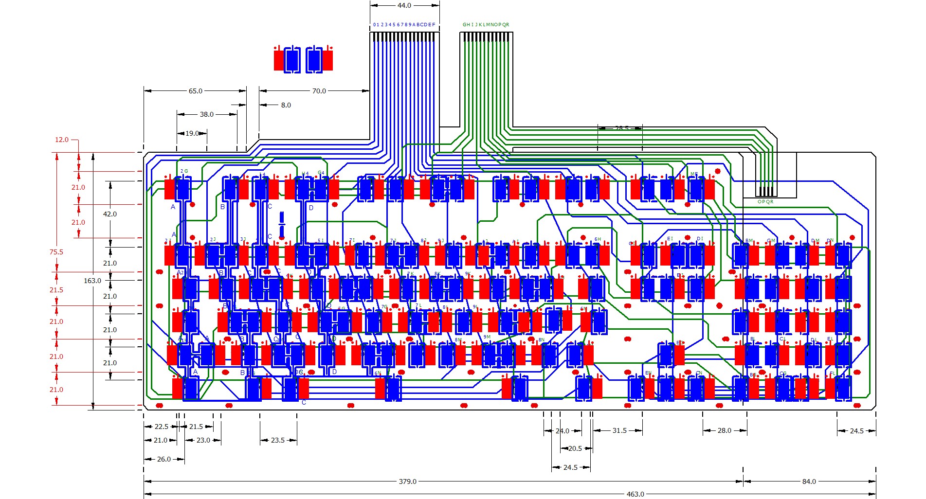

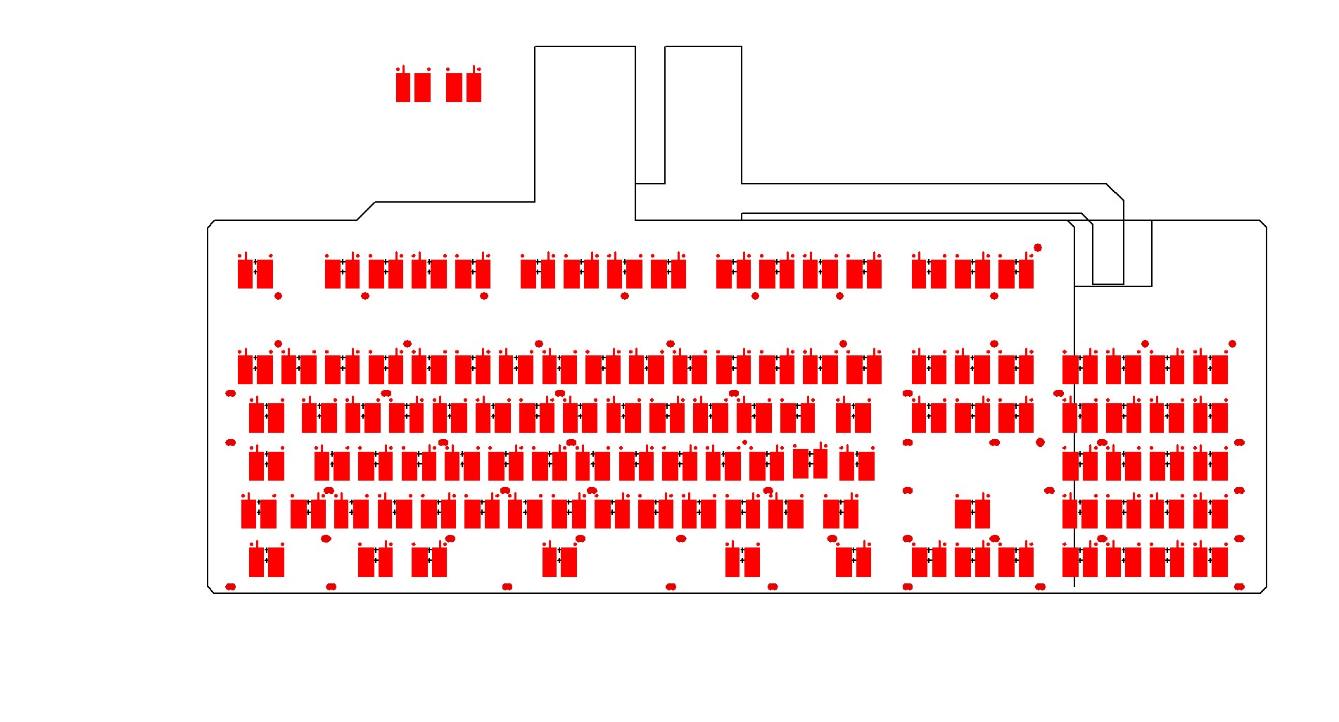

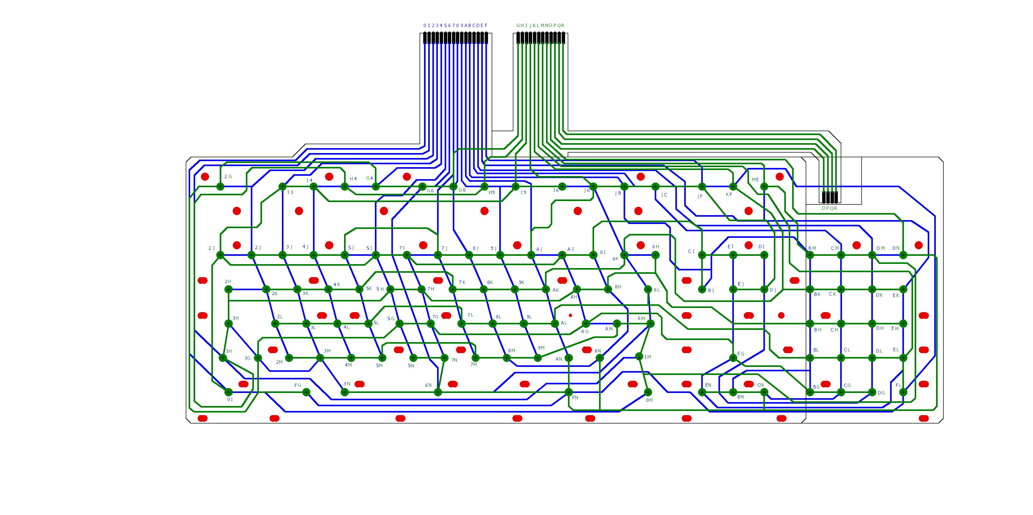

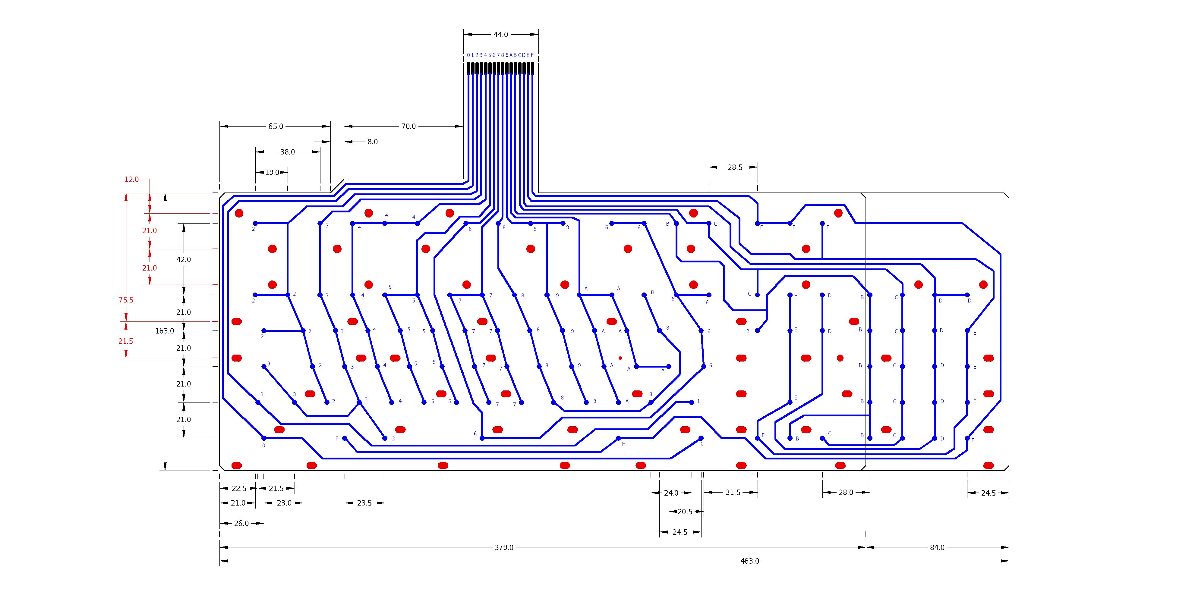

wcass
22 Dec 2015, 02:34
This is to be an FSSK, right? So all the traces will all be changed. The M needs traces to be disorganized to minimize ghosting; the F will not have that problem. It's pads will be MUCH larger (so much less room to route traces) and traces will need to be organized to avoid crossing.
The only thing you need from the membrane is the outline (minus the tails), the rivet hole size and positions, and the contact point of each switch. You also need to know the relative difference between the M contact point and the F pad placement.
idollar
i$
22 Dec 2015, 16:43
wcass wrote: This is to be an FSSK, right? So all the traces will all be changed. The M needs traces to be disorganized to minimize ghosting; the F will not have that problem. It's pads will be MUCH larger (so much less room to route traces) and traces will need to be organized to avoid crossing.
Hello,
You are right. I only modeled the traced on the original membrane for documentation purposes. I thought that having a single file with all the contours, the membrane layers, the holes and the PCBs of the FSSK would be useful.
Here is where I am now with the modeling (work in progress as you can see):
The top layer (incomplete work):
FSSK v0.9 - top.jpg (219.26 KiB) Viewed 6624 times
The bottom layer (incomplete work):
FSSK v0.9 - bottom.jpg (218.39 KiB) Viewed 6624 times
Both layers of the PCB (incomplete work):
FSSK v0.9.jpg (700.97 KiB) Viewed 6624 times
All the layers in the file together :-)
FSSK v0.9 - all.jpg (488.46 KiB) Viewed 6624 times
I am using your work a lot. Without your help this would have been much more complicated. THANKS !!!!

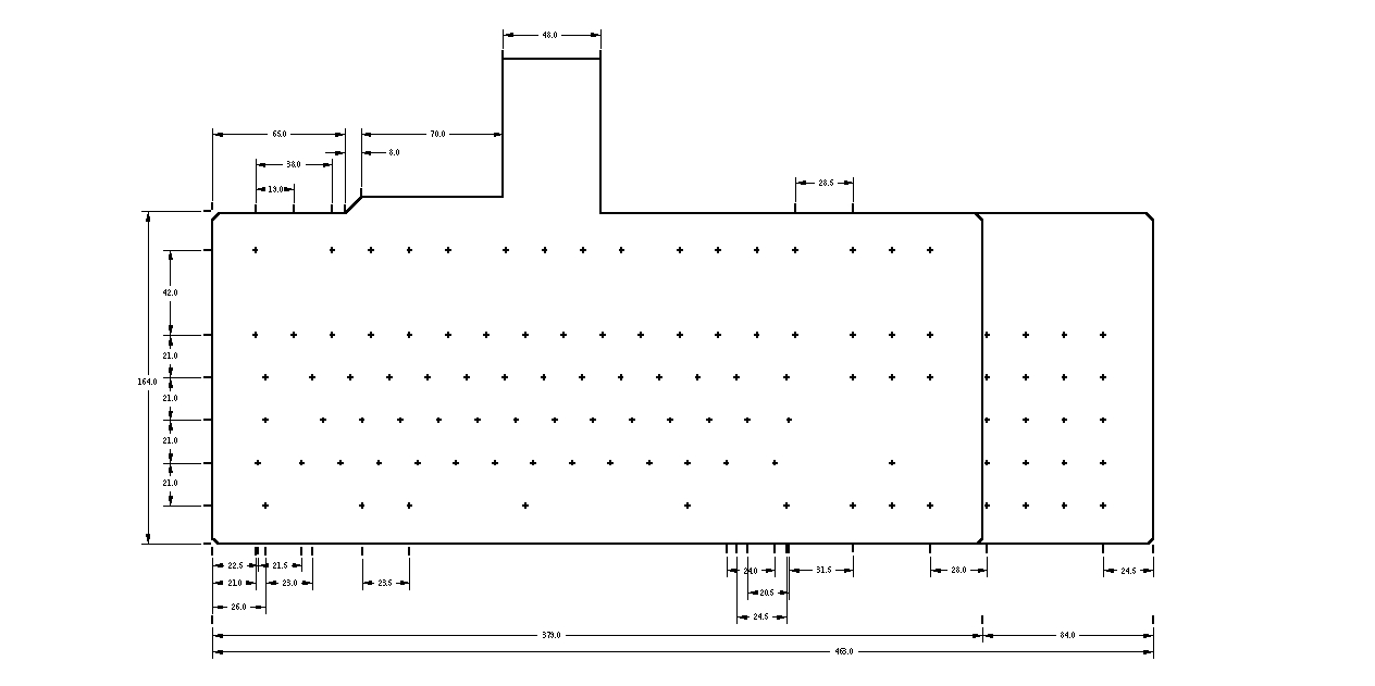

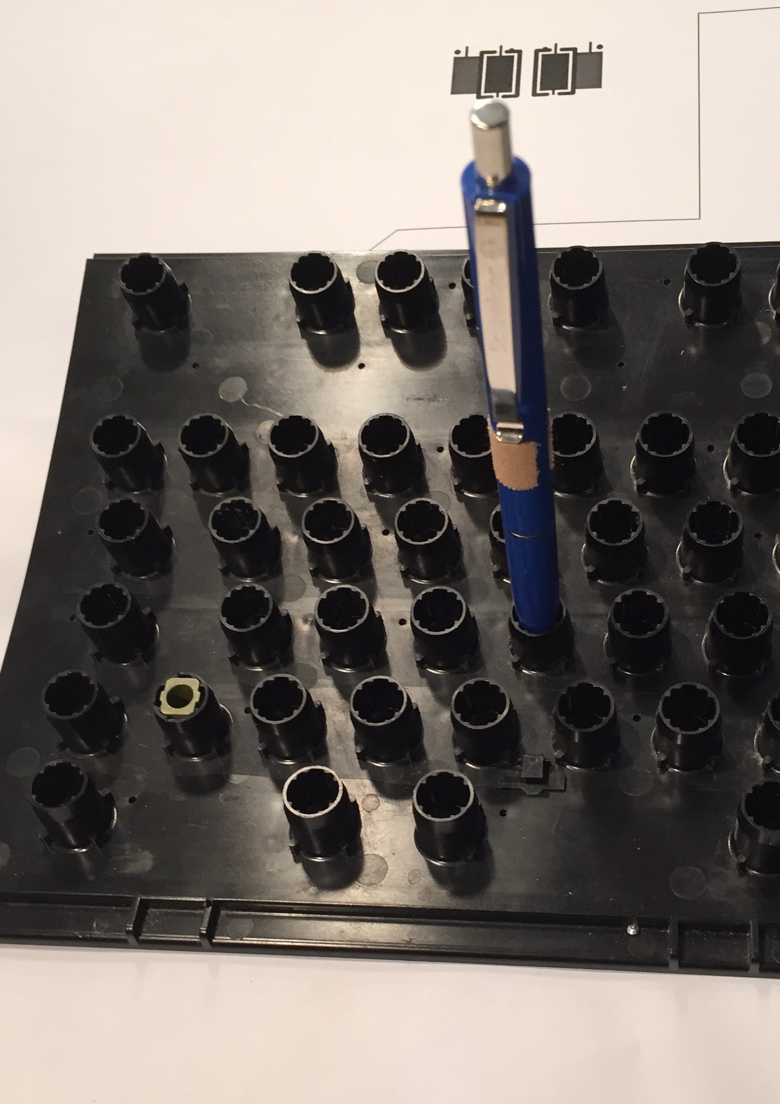

The Challenge will be the holes.
I have printed the CAD drawing, with a calibration line at 10cms that has shown that the printer scale is correct.
It seems that the holes layer has some problems that I shall correct. A drawing with the challenges and hand painted solutions follows:
Note that the holes are very exaggerated (big) in the membrane that I have been used.
The pencil traces are from the holes on this membrane.
If the same exercise is done with the little holes on the plastic foam of the keyboard it looks better.

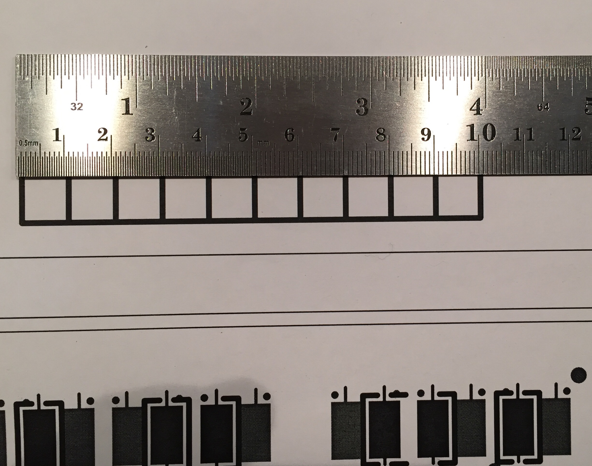

Have you tried printing on dimensionally stable transparency film? Plain paper can change in size quite a bit when printing, and on a 40cm long print it adds up.
idollar
i$
22 Dec 2015, 19:27
Hello,
I do not think that it is the printing scale. I have made a test rule in the paper of 10cm. It looks fine.
(apology for the picture. It is made with the telephone)
Photo 22-12-15 19 23 53.jpg (871.7 KiB) Viewed 6613 times
I will check the printout anyhow against the file.

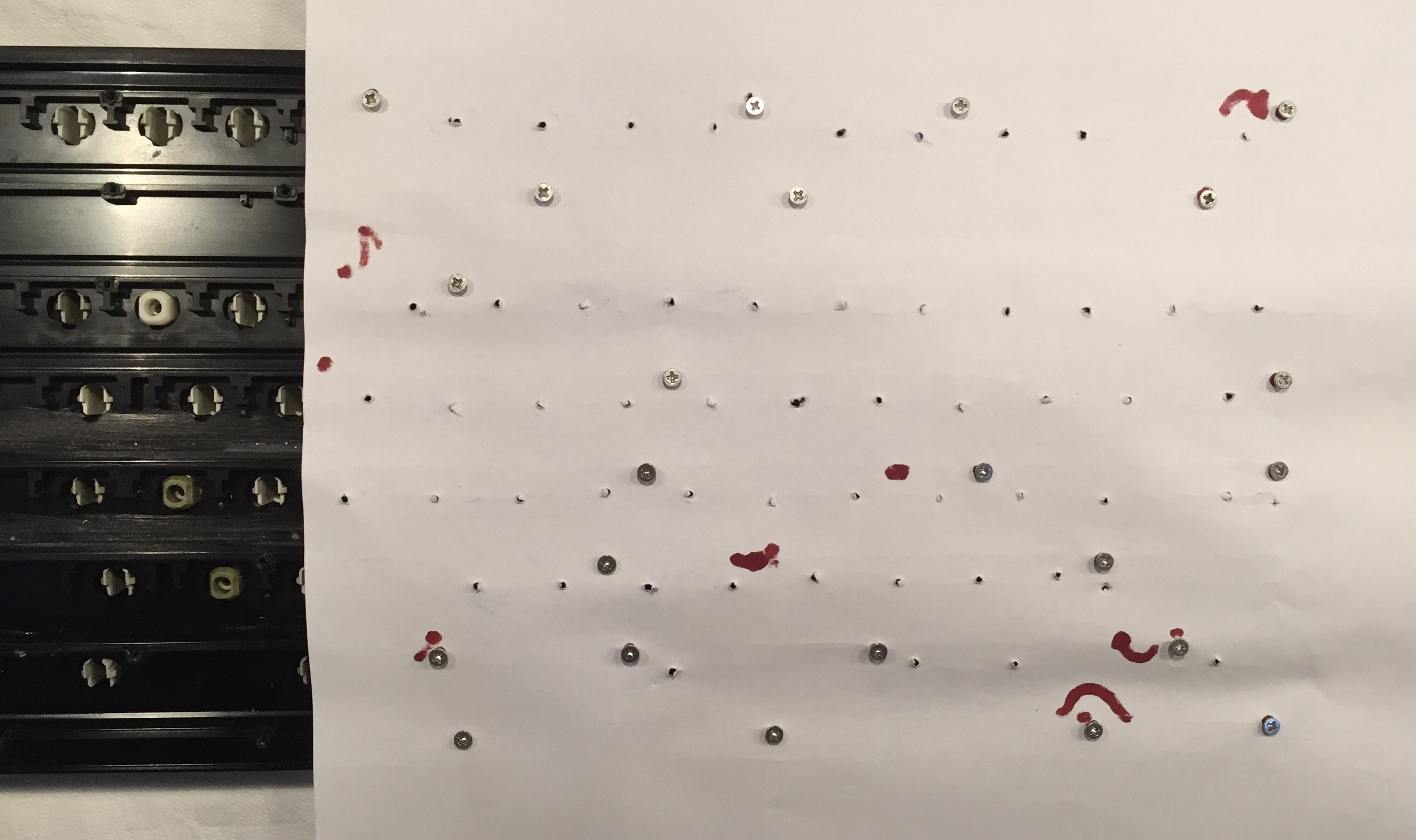

Here my next quality check:
I have screwed the printout to the SSK and using a bollpen push the centre of the barrels.
I could also check the alignment of the flippers.
Once more, telephone-quality pictures
Photo 22-12-15 20 02 09.jpg (632.32 KiB) Viewed 6610 times
Photo 22-12-15 20 02 23.jpg (510.04 KiB) Viewed 6610 times

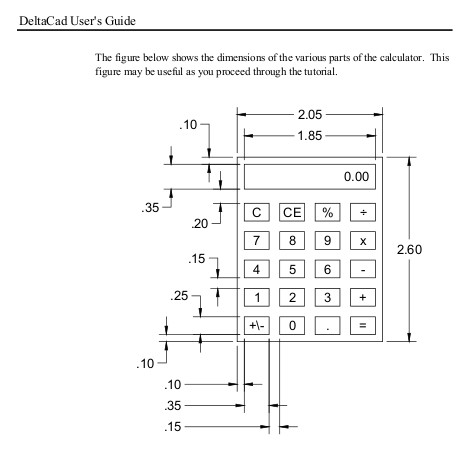

idollar out of curiosity what CAD software are you using for this project? KiCad? Something else?
idollar
i$
23 Dec 2015, 06:46
XMIT wrote: idollar out of curiosity what CAD software are you using for this project? KiCad? Something else?
wcass recommended to use DeltaCad, and as I said before, I normally listen to people with experience ;-)
It runs on windows or Mac natively. I execute it on top of wine on a debian box.
This is the DeltaCad home page
The software is VERY easy to use. It comes with a manual that shows, in few pages who to draw a calculator:
On top, I have found a summary with shortcut keys which resulted to be very useful
DeltaCad costs some 40 dollars. For the time being I use a demo version, that should expire in some days.
I have to repeat that the research and recommendation merits shall go to wcass
