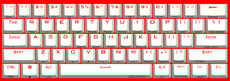

Is there a post up-thread that describes the layout of the 60% version and what the FN+key combinations are? For instance, arrow-key navigation, volume control, etc.?
[ XMIT ]
11 Oct 2016, 19:01
No, not yet, for a few reasons:
1. This was *just added* with a major hardware and firmware change;
2. I haven't had a chance to test it yet;
3. I was going to re-draw this diagram for my documentation.
The photo shows the current state of things. I'll leave this here as is for now until I test some more.

That layout looks pretty reasonable right out of the box to me.
Any chance of DIP switches for moving the FN key around? I like to configure the Caps Lock key to be FN. I've done this on my Pok3rs and my KBP V60 mini, and CapsLock+IJKL (or CapsLock+PL;') is now embedded in muscle memory for arrow key navigation.

zslane wrote: Any chance of DIP switches for moving the FN key around? I like to configure the Caps Lock key to be FN. I've done this on my Pok3rs and my KBP V60 mini, and CapsLock+IJKL (or CapsLock+PL;') is now embedded in muscle memory for arrow key navigation.
I don't ever foresee hardware DIP switches for waterproofing reasons.
As for other remaps: it's possible that the supposed, promised, remapping software will let you remap Fn to whatever you want using a static program. My preference is for a fully open board firmware with full customization of course. As a vi/vim user myself I wish hjkl were mapped to arrows on more boards. I've learned to live with wasd since that's pretty common (but the HHKB doesn't have this). I /think/ we now have a wasd lock to keep those keys as arrows?
Maybe as a stop gap workaround you can use some software remapping in your OS of choice but I agree doing this in the board is ideal!
