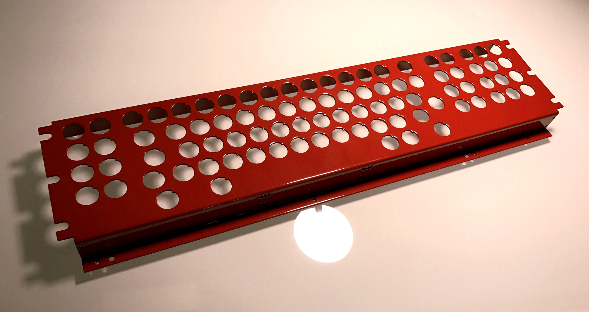

My powder coating friends called, and I ran down to grab the sample I gave them. This is from a rusted beamspring (NOT our MF), but gives me a really good idea of cutout tolerance changes and consistency of application. They did a nice job. I have updated our plans for the full-size to account for cutout changes, and will get to them this week. Might take a week or two to get back. They know our timeline, and I have asked they just work into their typical production line when the timing is appropriate. Thought you might enjoy seeing our red though. Forgive the lighting, it is still dark here and taken from my desk. The desk is white for reference.
For the final full-size prototype, I will likely do the blue to validate it matches the requested swatch (or very close), and will have the backplate hot dipped in yellow zinc (Chromate). That is up the road a bit, but I want to visit them again anyway before hand. I want to know if raw comes out as I expect, or it I should hit the plates with my sandblaster to get a more consistent (but satin) finish.
EDIT: corrected spelling (I suck lately :))

HNNNNNNNGGGGGGGG that will look so good with the Lexmark logo.
