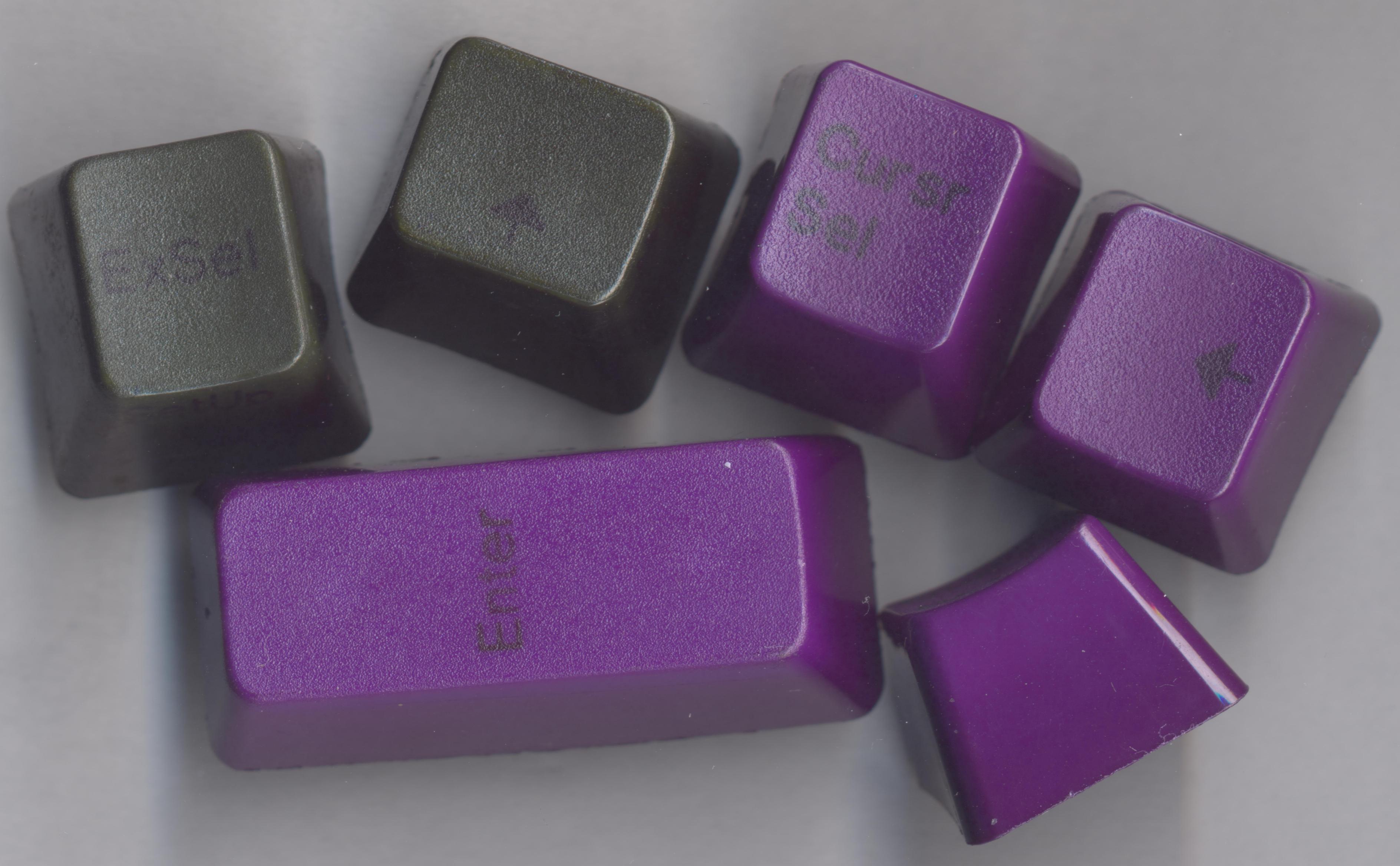

I have had very good results with iDye Polly. I was thinking about dying a bunch of keys black and laser etching legends. Does anyone in our group have access to a laser?

Hypersphere wrote: If you start with a Pebble-colored keycap that has a black legend and you dye the cap black, does the legend become completely invisible, or does it end up looking like the black on dark gray caps on "black" versions of RF or HH keyboards?
My experience, with old-style RIT dye, is that the keys became completely black and the legends disappeared. But I have never gotten out a high-power magnifying glass and bright light to really intensely investigate below the "naked eye" level.
With old IBM PBT, you can boil them for half an hour in the dye bath without hurting them.

This image is from a flatbed scanner, so high light and magnification. In normal light, i don't see any legend on the black caps (purple is slightly legible). I dyed these a while back but IIRC they were in the bath for only about 5 minutes. My red set were done with Rit many years ago and those were boiling for about 45 minutes to an hour.
I use a "pasta pot" to dye so that the caps never sit on the bottom. Doing a full set at a time makes for uniform saturation. The built in strainer makes it easy to check color and agitate the bath.

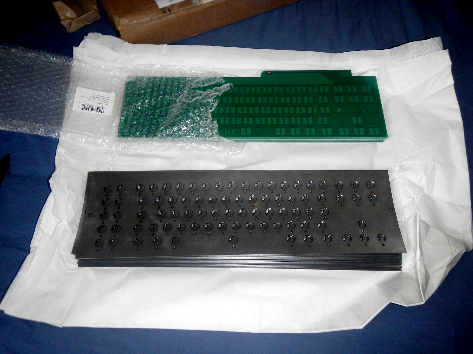

Fresh, tasty XTant plates
My board will come alive! (In December when I'm there again.) Thanks Viva!

QUESTION: Do the Xtant plates require painting or do they come already painted?
0100010
11 Sep 2015, 02:00
Those look like bare unfinished plates. Would imagine they need to be dehorned, sanded, degreased and finished.

Hey there. The plates in the photo are from me. I posted that photo in the XTant plate thread on GH.
The XTant plates are bare steel. You could throw them into the keyboard without any finishing, but I recommend that you finish them.
My plan is to smooth them out with some steel wool, and then just throw some clear coat spray paint on there, either gloss or satin. Might go with gloss to add just a tiny bit of flash to the XTant underneath all that IBM classic blandness.

@vivalarevolución: The 2 plates and extra PCB arrived today. Thanks! I initially panicked, because I had forgotten that I had received the first PCB from wcass quite some time ago. I eventually found the box among my stash of boxed-up IBM keyboards awaiting restoration. Things at work are very busy now, but I hope to get to the Xtant project in mid-October or so. In the meantime, I may order some caps from Unicomp.
I got mine today. It seemed to have a light oily film which is probably necessary for machining, so I washed it well with hot soapy water in the sink.
I stood it up on my work bench to dry, and now, 4 hours later, I see a tiny wisp of rust bloom at every water droplet location. So I get the distinct feeling that these need to be coated properly or you will be sorry.
Rustoleum for the win!

Yea, I would definitely add a finish to them. The steel is cold rolled steel, not stainless, and it probably will rust without a finish. Maybe I can go with stainless if there is another run.
