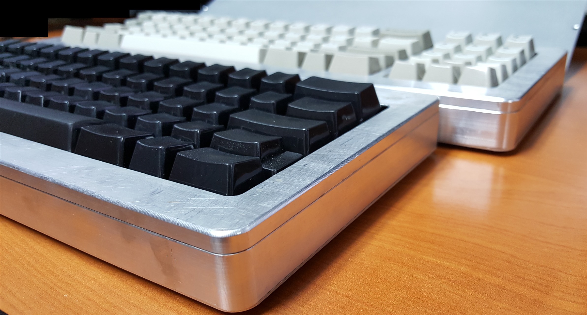

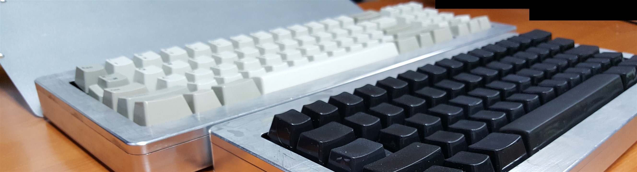

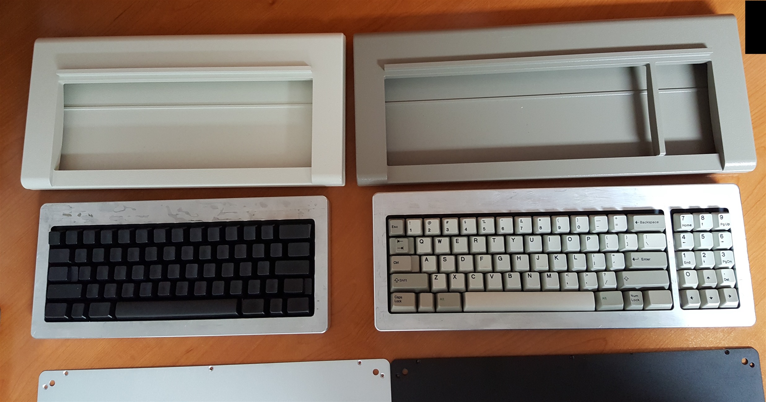

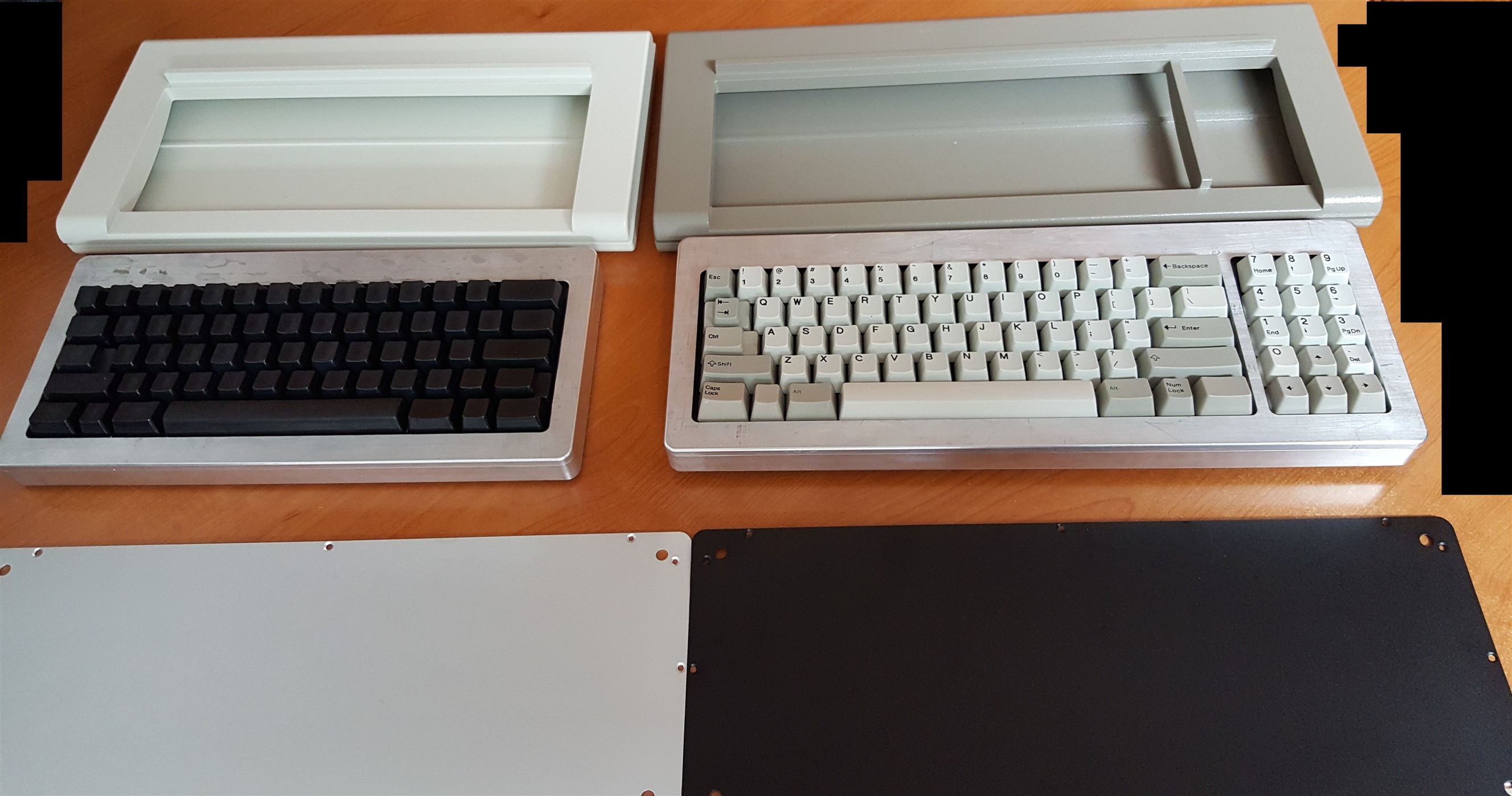

The working Compact Case F62 and F77 keyboard first-runs pass inspection!
The video at the bottom shows the unboxing, teardown, and typing test where I reached 100 WPM on the compact F62 and 90+ on the second test with the compact F77.
The keyboards will not look like the photos below! The cases are just the raw aluminum and do not have the hard anodized finishing. The keys are Unicomp - the new key molds are not yet ready. Please see the two metal bottom case sheets that are what the regular gray and black hard anodized options will look like. The factory did a great job on the hard anodizing - very high end looking!

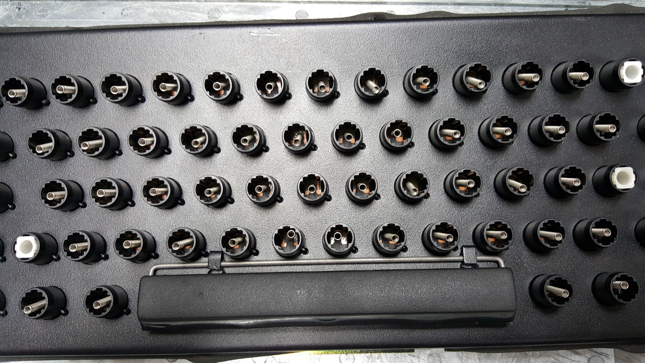

The first-runs are an important part of the manufacturing process even though they add some time to the process. I have two pages of feedback for the factory so far on small improvements. You can see some of the areas that need improvement:
-Adding more holes to the compact cases to ensure a near-gapless fit between the case parts
-The top inner assembly holes for the barrels were about 0.2mm too large
-The boxes need to be a little bigger to fit the extra parts (keys, etc.)
-The boxes should have dark blue text, not black
-The bezel has too much space above the top row of keys compared to the bottom row
-The factory did not send the most recent update of the top inner assembly incorporating some small adjustments
-Flat top screws countersunk into the case should have been used everywhere
-Need better QC on the springs to match the specifications

The compact F77 sample is 4.03lbs and the compact F62 is 3.34 lbs.
Yes twvOneFive you can order a spare compact case and you would be able to switch between the original style and ultra compact cases.

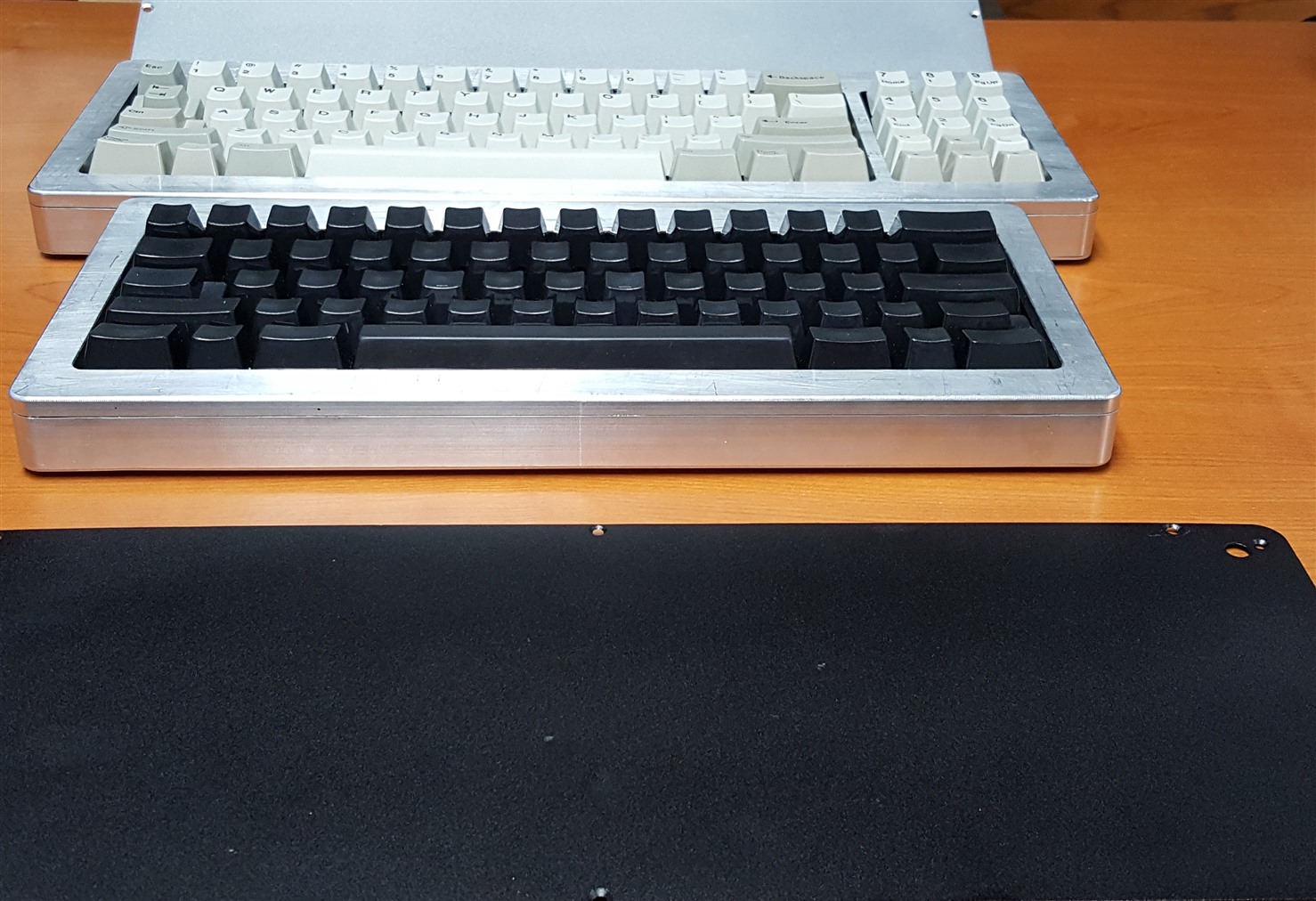

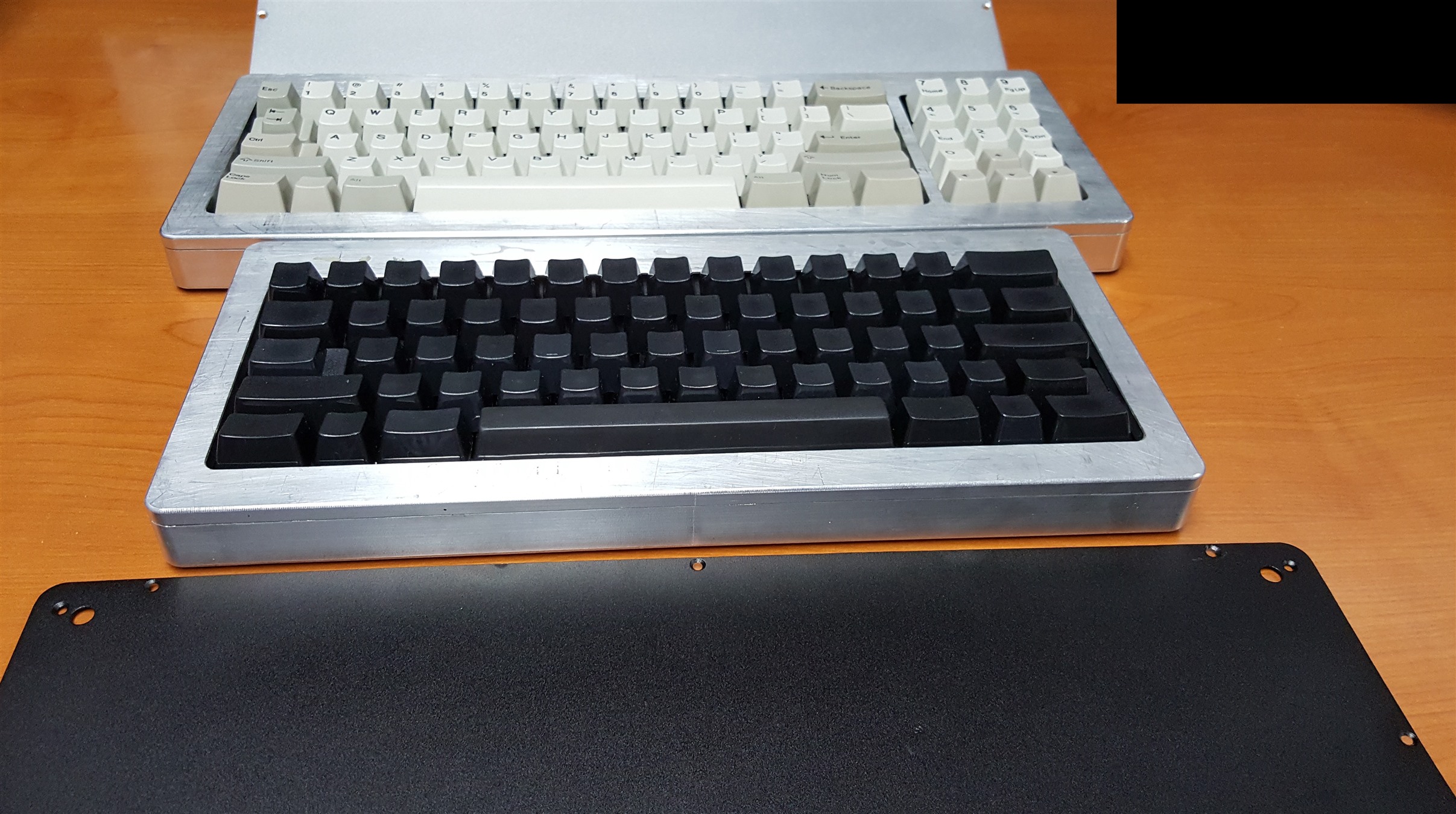

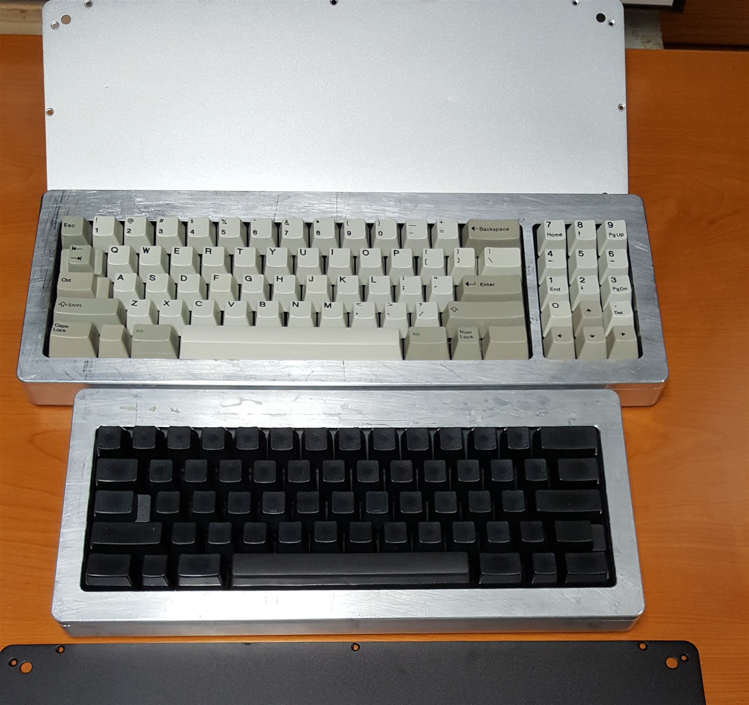

Can we get a gallery shot of both the original-style and compact-style cases for the F62 and F77 together?

Photo comparisons are below XMIT. There is almost no empty space inside each compact case.
