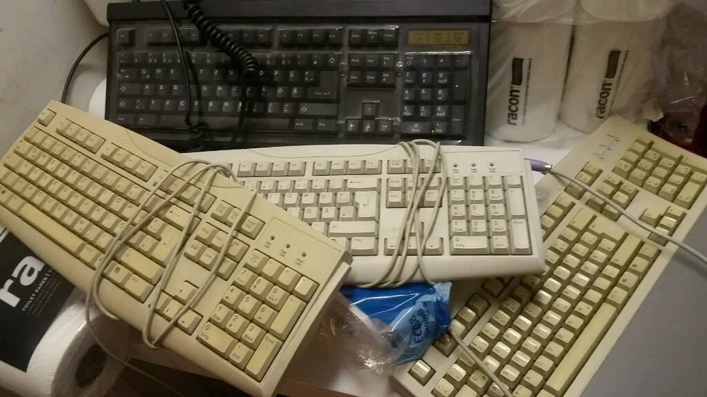

Can anyone tell me anything about that black keyboard in the background? (I sure hope all that toilet paper next to it is still unused!)
It seems to have a coiled black DIN cable, has no Windows keys, a huge spacebar, big-ass enter etc. All good signs, but that case with the high ridge at the top end doesn't seem familiar at all. The keycaps look somewhat Cherry-ish, but with that layout...?

Seller sent a photo of the label, turns out it's a Qtronix QX-201. Usually poor quality, I gather. Might still get it as black case vintage boards are rare and it could have interesting switches if it's not MX blues...

QX-201's can come in blue alps.

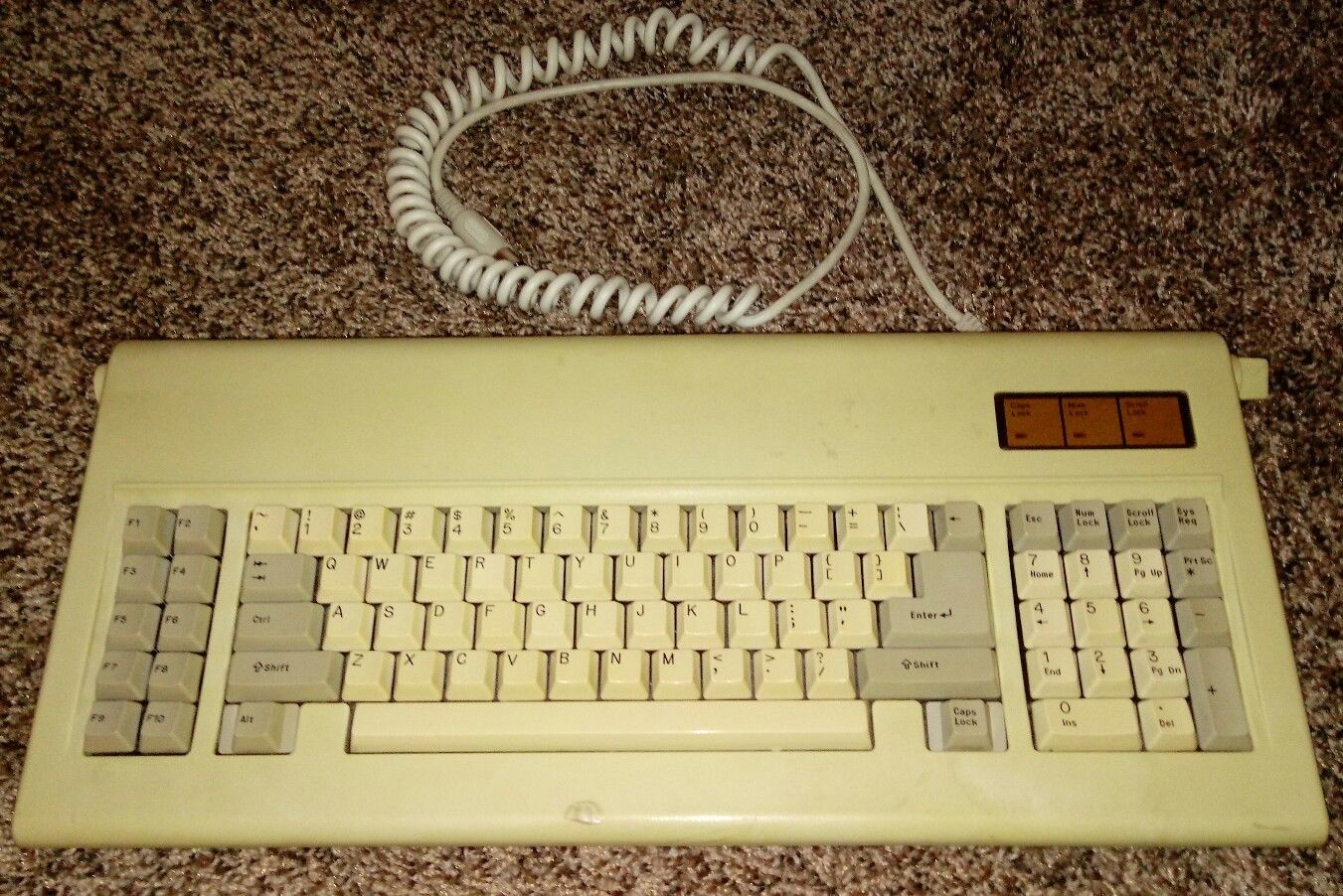

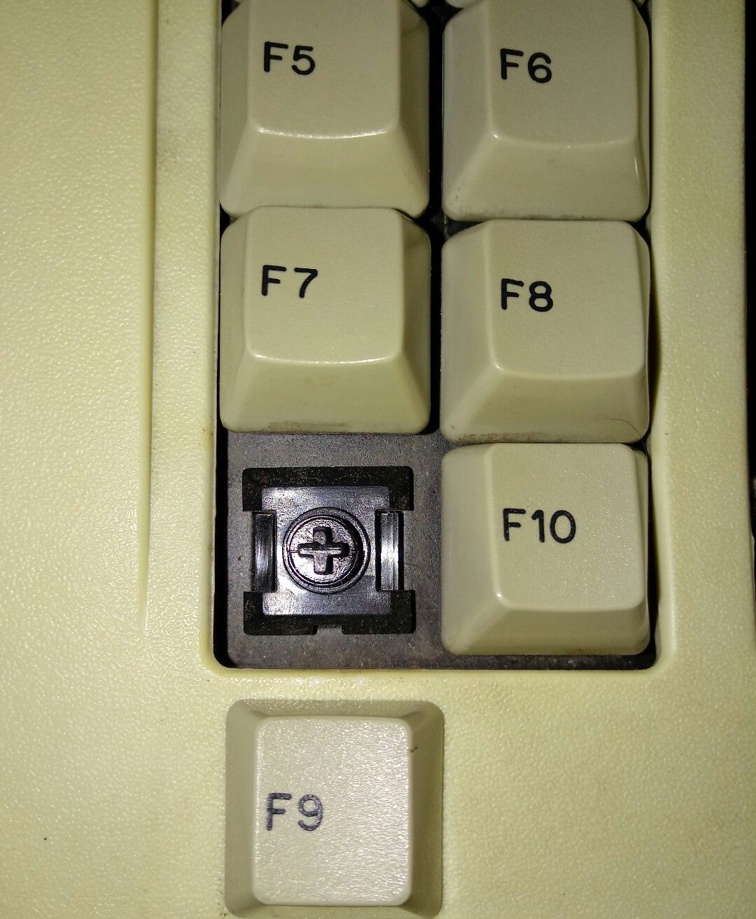

I am looking at a keyboard that looks interesting. I have researched it, but I am still not sure what kind of switch it is using.
Here is a pic: The keyboard is a NTC 5060. I found a brochure with the keyboard listed here, but it claims the keyboard has 'NTC Mechanical Keyswitches', which doesn't even exist. Any ideas what is in here? I know it isn't alps, because they would have said so, so would it be sporting omron switches or would it just be some alps clone switch?
Edit: Update, I found an additional picture, but still unsure what it is, but I am sure someone can identify it now: Is it Monogram SMK derivative?

I would say it's probably a rebranded DataComp keyboard with Futaba MA "clicky switch" with MX-compatible mount.

Definitely not Futaba MA clicky.

You would have to desolder a switch to be sure. I guess we can rule out Hottek as there are no mould numbers on the top, but to be sure you have to check what's written on the bottom of the switch.rich1051414 wrote: Is it Monogram SMK derivative?

Minus the metal bars, they look very close to the SMK(?) switches I found in some old TI-99/4A keyboards. The design is fairly ubiquitous as both Alps and SMK had similar switches around that time period. It's been awhile since I've looked through my switches though, so I'd have to check.Daniel Beardsmore wrote:You would have to desolder a switch to be sure. I guess we can rule out Hottek as there are no mould numbers on the top, but to be sure you have to check what's written on the bottom of the switch.rich1051414 wrote: Is it Monogram SMK derivative?

I am not going to buy it as I am not a fan of linear, and 99% sure the switch is of linear variety as theres only one variety in that style that has tactile leafs, and chances are, this isn't one of them.Blaise170 wrote:Minus the metal bars, they look very close to the SMK(?) switches I found in some old TI-99/4A keyboards. The design is fairly ubiquitous as both Alps and SMK had similar switches around that time period. It's been awhile since I've looked through my switches though, so I'd have to check.Daniel Beardsmore wrote:You would have to desolder a switch to be sure. I guess we can rule out Hottek as there are no mould numbers on the top, but to be sure you have to check what's written on the bottom of the switch.rich1051414 wrote: Is it Monogram SMK derivative?
