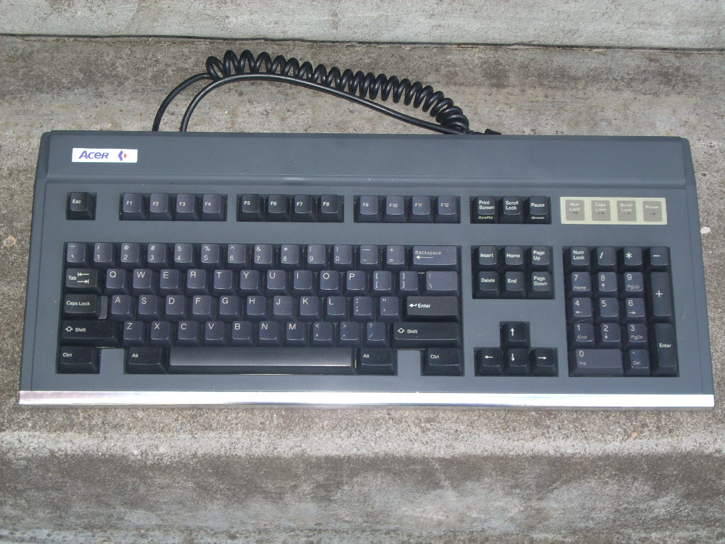

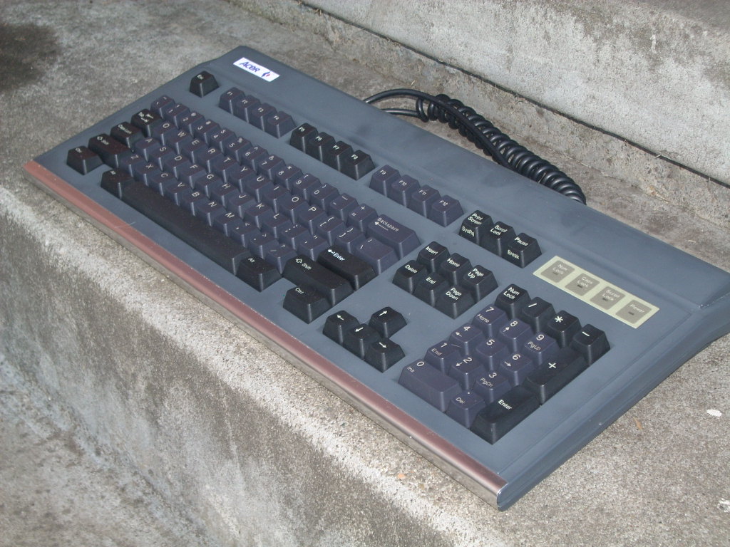

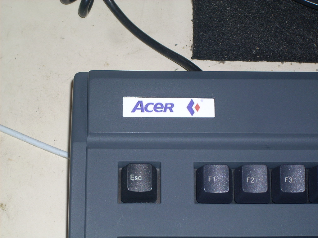

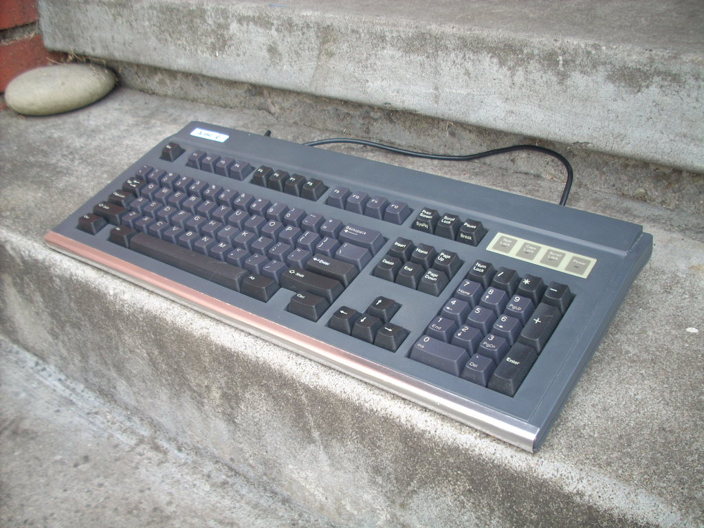

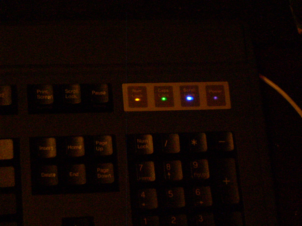

Had a few minutes to move forward on the KB-101A I was talked into saving, rather than using as a blue Alps donor, in my first post here. New LEDs (hard to photograph!), "chrome" edge to cover up the cracked tab locks, and new Acer logo. This is really a Multitech (pre-Acer) model, but the Acer matches the ancient case my main PC lives in. I'm going to redo the logo in "chrome" but that's another day's project. I still need to finalize the dark gray paint (shiny blemishes look worse in the photos than in person) but otherwise it looks and types like a dream. It's tied with the blue Alps Laser (Monterey K101) as my favorite driver.

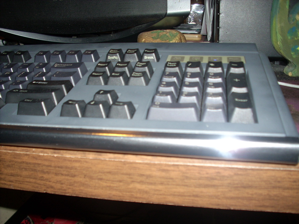

Thanks, that's exactly what I used, based on your earlier posts. It worked well, except for one shiny spot at the top, but that and the fingerprints from my greasy paws tell me I need to do something different. I'm thinking of trying a coat of car wax unless someone has a better suggestion. (...and not touching it is not an option!)

Part of any paint job is: "surface must be completely clean of all oil and grease"
I generally wash all the plastic parts in the kitchen sink with a sponge, and rinse thoroughly. I actually prefer laundry detergent to dish soap (Charlie's Natural).
- Polecat
I suspect that's exactly what happened, although I scrubbed the case pretty thoroughly with Comet before painting.Part of any paint job is: "surface must be completely clean of all oil and grease"
I was going to try some Turtle Wax, but that had dried out sitting on the shelf. The forty year old tin of Johnson's Paste Wax was still good however, so I gave it a quick treatment with that. Pure magic. But I don't recommend waxing with the PC board in place; the dust can't be good for the switches.
Thank you, I'm very pleased with the results, and I appreciate all the help and advice. This is now one of my two favorite keyboards.That was a good call! Very nice custom Alps build.

That's very nice, I'm glad you've kept the Acer. It's a fantastic chassis for bringing out the fullness of the sound of blue Alps.
What keycaps did you stick on them?
- Polecat
Thank you, it feels as good as it sounds. It was very badly yellowed, but spotless inside, stored in my back closet for over twenty years. Blue Alps are like new.
I played with the keycaps quite a bit. The blue-black ones are from a Dell AT101W. Most of the blacks are from a Datacomp/Ancer DFK-191. ANSI enter is left over from a Dolch set I used on a Focus FK-2001. I think that's all of them.

How did you get the AT101W keycaps to be that colour?
Shouldn't backspace be black too?

Nothing "black" is really black, otherwise you'd not be able to cast shadows on it. However, I didn't think the AT101W was quite that far off.
- Chyros
- Location: The Netherlands
I accidentally synthesised a nearly fully black material once, actually. It was so black that you couldn't observe textures and height differences in a little pile of it.
The AT101 is more of a dark greyish blue, though. A bit like some of those weird Alps top shells.
- Polecat
The $3 camera and bright light exaggerate the color difference. But you're correct, nothing is truly "black". I learned that decades ago painting cars. I tried several different keycap arrangements before arriving at the current set. One of the first attempts was to use Datacomp caps, which were a two-tone, very dark green and black, with red legends on the top row. I didn't care for those, and I had a near-new black Dell AT-101W with switches so bad they practically squeaked, so that became the donor for the blue-black caps. I had a black backspace on it at first (Datacomp) and a black backslash (Micro Connectors Mac board) but the black on the backslash didn't match, and I used the backspace elsewhere.
