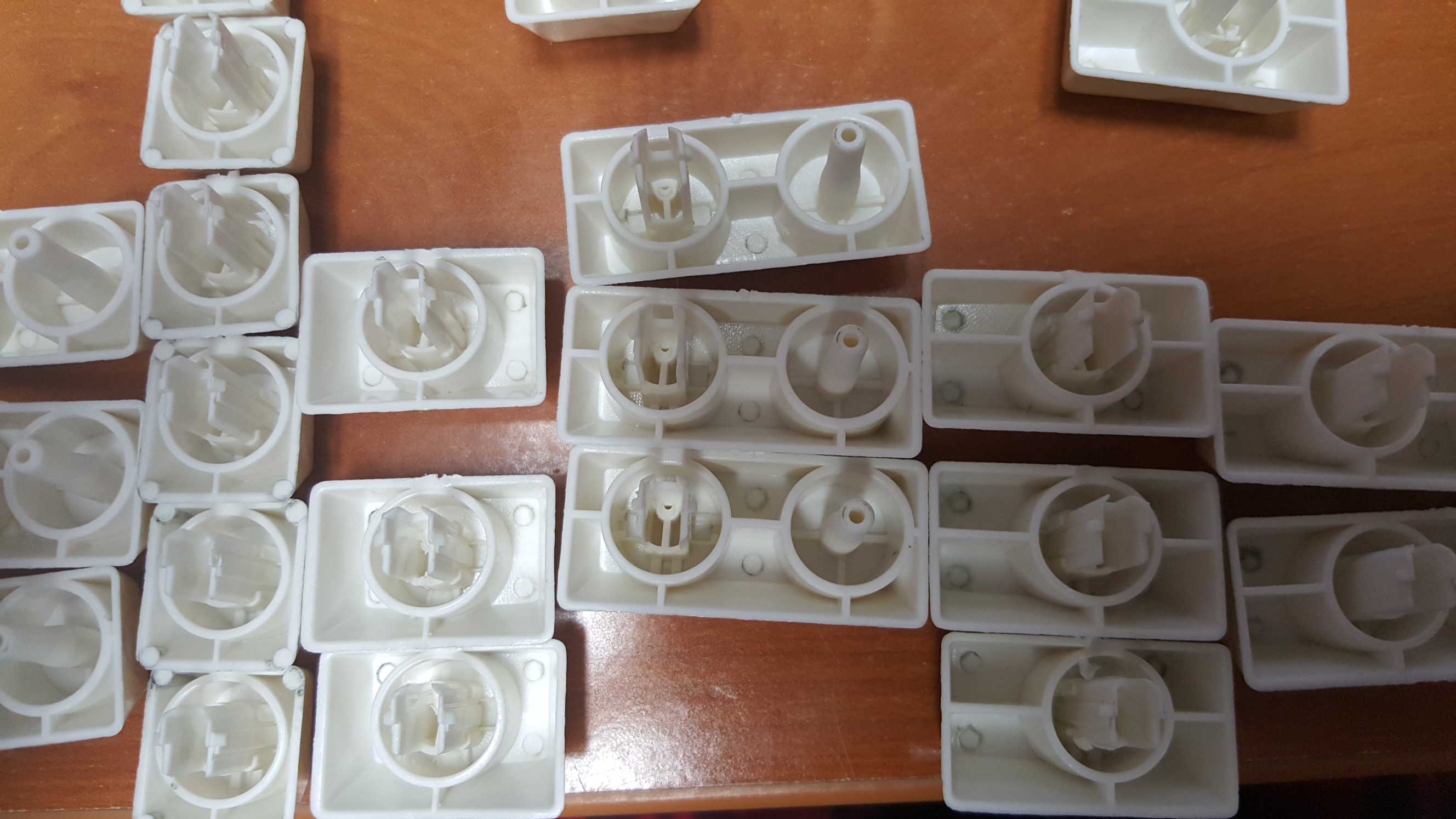

Today I tested the very first sample keys from the brand new molds but they are not accurate enough to my CAD files, so they have all been rejected. The factory will adjust the molds and send updated samples in the coming weeks.

Any pictures of the sample keys etc.? Just curious how far off you consider not good enough ;)

The measurements were off on some of the key dimensions by up to 0.5mm which is too much. Please disregard the color of the PBT as well as the flash (excess plastic) as they will not be so on the production keys.
You can also see the very first 1.75U non-stepped injection molded key samples in this photo.

Regarding the samples, whenever I receive samples I compare the CAD file measurements against the samples using my micrometer/digital caliper. I only approve samples that match the CAD files, allowing for a small amount of agreed upon tolerance such as +/- 0.2mm for critical dimensions.
I'm not sure why they didn't remove the flash but it wouldn't pass muster on the production units.
