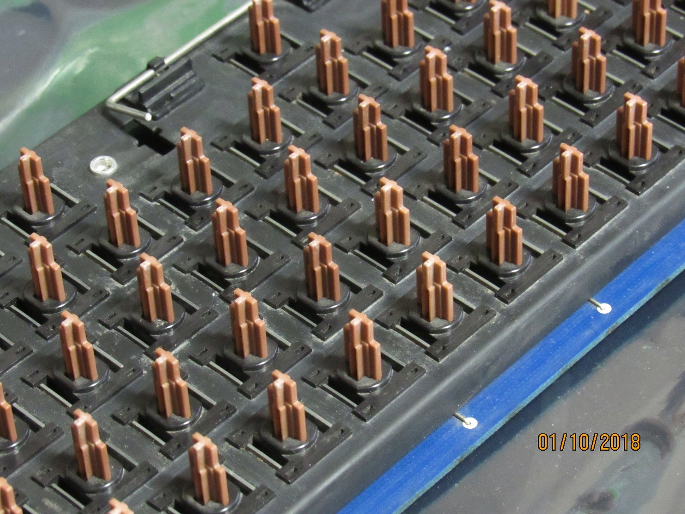

So, I ultrasoniced the Alps Browns and like I said before felt exactly the same as before but I tried out a very small amount of dry teflon lube in the place were Alps would have put their dry lube on Blue sliders and turned out very well. Quite a bit snappier, a bit smoother and a little quieter. More testing needed. I can made a sound clip if anyone is interested between the two.
Scarpia
10 Jan 2018, 22:14
codemonkeymike wrote: So, I ultrasoniced the Alps Browns and like I said before felt exactly the same as before but I tried out a very small amount of dry teflon lube in the place were Alps would have put their dry lube on Blue sliders and turned out very well. Quite a bit snappier, a bit smoother and a little quieter. More testing needed. I can made a sound clip if anyone is interested between the two.
Very interested in sound, feel, type of lube, method of application, etc. Details, please!

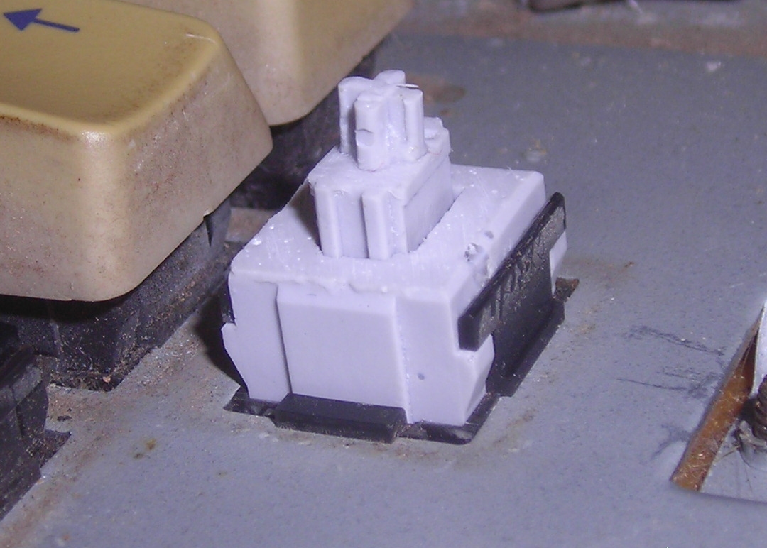

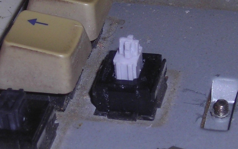

10 Jan 2018, 22:46
Is there a specific reason it has to be made out of ABS? Urethane comes in all sorts of grades and hardness's. With ABS you need steel moulds, and they can get very expensive. With urethane you can use rubber moulds. FWIW, here is something I knocked up this evening:
And the casing:
I don't have access to a vacuum pump right now so there are a few voids, and this is just a proof of concept. For example the cherry mount isn't even on straight! Second the top of the outer casing is just rough sanded, I had to make the mould like that to get it to fill. Usually you would have a fill hole. It does work surprisingly well actually, all things considered. This keyboard is filthy, the switches are the later black type, and this is plastic that's not even the right type for this application.

mR_Slug wrote: Is there a specific reason it has to be made out of ABS? Urethane comes in all sorts of grades and hardness's. With ABS you need steel moulds, and they can get very expensive. With urethane you can use rubber moulds. FWIW, here is something I knocked up this evening:
And the casing:
The sliders I am making out of POM, And I haven't decided on the top housing material, may go with POM as well or maybe something else, not sure yet.

Ah POM, I missed the link to the other site. I'm not sure how much the tooling is going to cost you but I think you can do the slider in a 2-part mould. For people not familiar with moulding, POM is a thermoplastic (hot) requiring (usually) steel moulds which are (obviously) rigid.
The top housing, has those tabs that hold it down onto the clips. This is an undercut. It may be possible to make this in a 2-part mould, I'll have to look at it closer. If not, it may need a 3-part mould, which increases costs. A thermosetting polymer (cool) may work out cheaper. Particularly if it's a small run.
BlindAssassin111
11 Jan 2018, 01:49
mR_Slug wrote: Ah POM, I missed the link to the other site. I'm not sure how much the tooling is going to cost you but I think you can do the slider in a 2-part mould. For people not familiar with moulding, POM is a thermoplastic (hot) requiring (usually) steel moulds which are (obviously) rigid.
The slider is being made with 2 parts and an insert for the spring guide and recess. I am a mechanical engineer so I am familiar with injection molding, but it is info that others may find interesting if they aren't familiar with how it is done.
Tooling is about $3000 and then the rest of the cost is setup, material and shipping them to me. Only making enough profit to buy some myself.
I think the housing may be able to be done in 2 parts with between 1 to 3 inserts depending on what there CNC capabilities are. So cost will be higher that I would like but it will be worth it for those who don't want to modify genuine alps housings.
