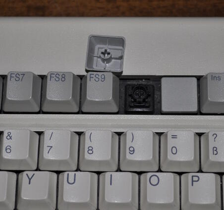

quantalume wrote:
That's an interesting item. What type of switch would this be?
Weird, that's what. The inner spring looks about the same diameter as a space invader's, while the outer one looks more like a Topre's space bar.
Bad news though: the keyboard has some old computer glommed under it:

Could that be the cryptic spring-over-dome-under-slider-inside-spring-under-cap switch???
On a serious note, it seems to have a terminal embedded!
24 Sep 2014, 20:43
a terminal ( am am making the jump that its a serial terminal), built into a keyboard that is very very cool.

quantalume wrote: That's an interesting item. What type of switch would this be?]
Quite a few switches applied pressure to the membrane using a coil spring, including at least one Alps design. A couple of examples:
[wiki]Oriental Tech spring-over-membrane[/wiki]
[wiki]Alps spring over membrane[/wiki] (better pictures on [wiki]Oriental Tech OK-100 series[/wiki])
Acer semi-mechanical switches have a little plastic arm in between the spring and the membrane, but often the membrane pressure spring is bare like that. In the linear designs, you have a small inner spring that presses on the membrane, and an outer spring that pushes the key back up.
I don't know what that specific switch is. The black part just seems to be a slider shaft that snaps into some sort of plate. I can't make out the out-of-focus part.

Does anybody know what switch is this after all?
26 Sep 2014, 00:39
Laser wrote: Somebody just won the Philips keyboard (Prah Commander) ebay action ...
Preh, not Prah.
It's similar to this one, which is a rubber dome:
http://deskthority.net/f-o-r-s-a-l-e-f5 ... t6039.html
Some rubber dome keyboards (including Topre) have discrete slider guide shafts that snap into a plate (metal or plastic), but unlike microswitches, they're open at the bottom just as with Acer switches. That's what these appear to be. Topre do it because they have a metal plate; most keyboards simply mould the guide shafts directly into the lid of the keyboard itself — harder to mould, but far less assembly effort.

Jacobolus & Daniel, thanks for information/correction.
So Preh, not Prah, not Alps, and certainly not ... To-preh :P
They seem to me to have discrete slider guide shafts, not moulded.
