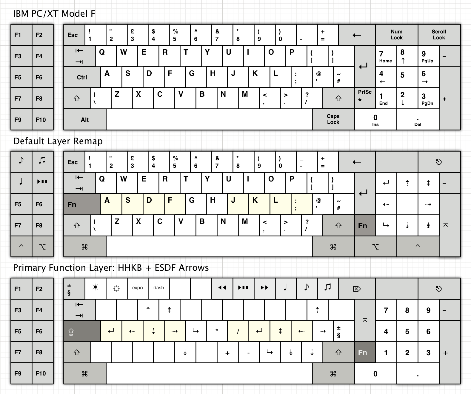

07 Jul 2013, 03:20
No layer lock yet, but I've designed a fairly good layout, for my purposes, which looks like this:
IBM PC XT Model F.png (310.76 KiB) Viewed 13324 times
It took a while, but I realised the XT has plenty of room for modifier keys if you think outside the box a bit. Its bottom row has 8 keys including the (huh-yuge) spacebar, which is the same number as my 60% design. So I transplanted a bunch of ideas. First of all: if it's on row 1, it's a mod! Function keys are overrated anyways.
Power key at top right is pretty handy. HHKB style function layer key and arrow bindings are neat too. And several macros are in effect to achieve a close match to the Model F's own keys in the default layer. Num Lock is where I'd put the layer lock key, if I had figured out such things yet. So for now it's reserved.
Code now includes comments:

Here's a zip of my Soarer's Converter config file and my OmniGraffle file for the layout chart above for anyone looking for either as a template.

So chuffed to be using this awesome old keyboard. Thanks again Soarer!
Soarer
07 Jul 2013, 15:27
Very nice!
The last macro, since a gui key is already pressed, does it need the set_meta etc? Perhaps just...
# Command + Escape = Command + Section break (for app window cycling)
macro ESC gui -ctrl -alt
press EUROPE_2
endmacro
Minor point... with two keys remapped to FN1 it won't work as expected if you press both of them, then release one, then press another key - you'll get the base layer rather than layer 1. Using two FN codes avoids that...
# define that FN1 and FN2 both access layer 1
layerblock
   FN1  1
   FN2  1
   FN1 FN2  1
endblock
In fact, the same thing affects any duplicated codes, like the two sets of cursors you've mapped, but there's no way round that (and it's an even more minor issue when it's on final keys rather than modifiers or fn keys). Technically I could add code to track such things, but it doesn't seem worth the code, or the memory it would use up :ugeek:
07 Jul 2013, 15:39
Good catch, Soarer. I added the second function key (the XT's single Control) late on in my tinkering. I'd already mapped Fn + Control to Caps Lock, which still works regardless! You can tell I've not quite mastered this stuff yet.
Once I've added a physical PS/2 port to my converter, the next step will be to put all of this into a separate file and include it with a single ifset set1 command so my XT's wackiness doesn't drive every other keyboard nuts and I can work on a clean set for them.
Here's a feature request, if you're interested: the Teensy has a lot more pins than the four that conversion requires, plus the usual optional status LEDs. I'd quite like layer indicators! One LED for layer 1, a second for layer 2 and so on. Would that be much overhead to keep track of?
The place they'd really come in handy is in a custom controller, one LED behind each corresponding number key! But that's another project…
Soarer
07 Jul 2013, 16:04
The idea is that the config gives low-level pieces that can be put together... so even I don't know all of what might be possible with different combinations of settings!
People posting their configs is great - it gives me as chance to nit-pick, and see where extra comments might be useful in the docs. How to do a nice beginner level explanation of macros still eludes me, but I'll have to tackle that when I add even more stuff to macros or it will just be too much to take in in one go!
