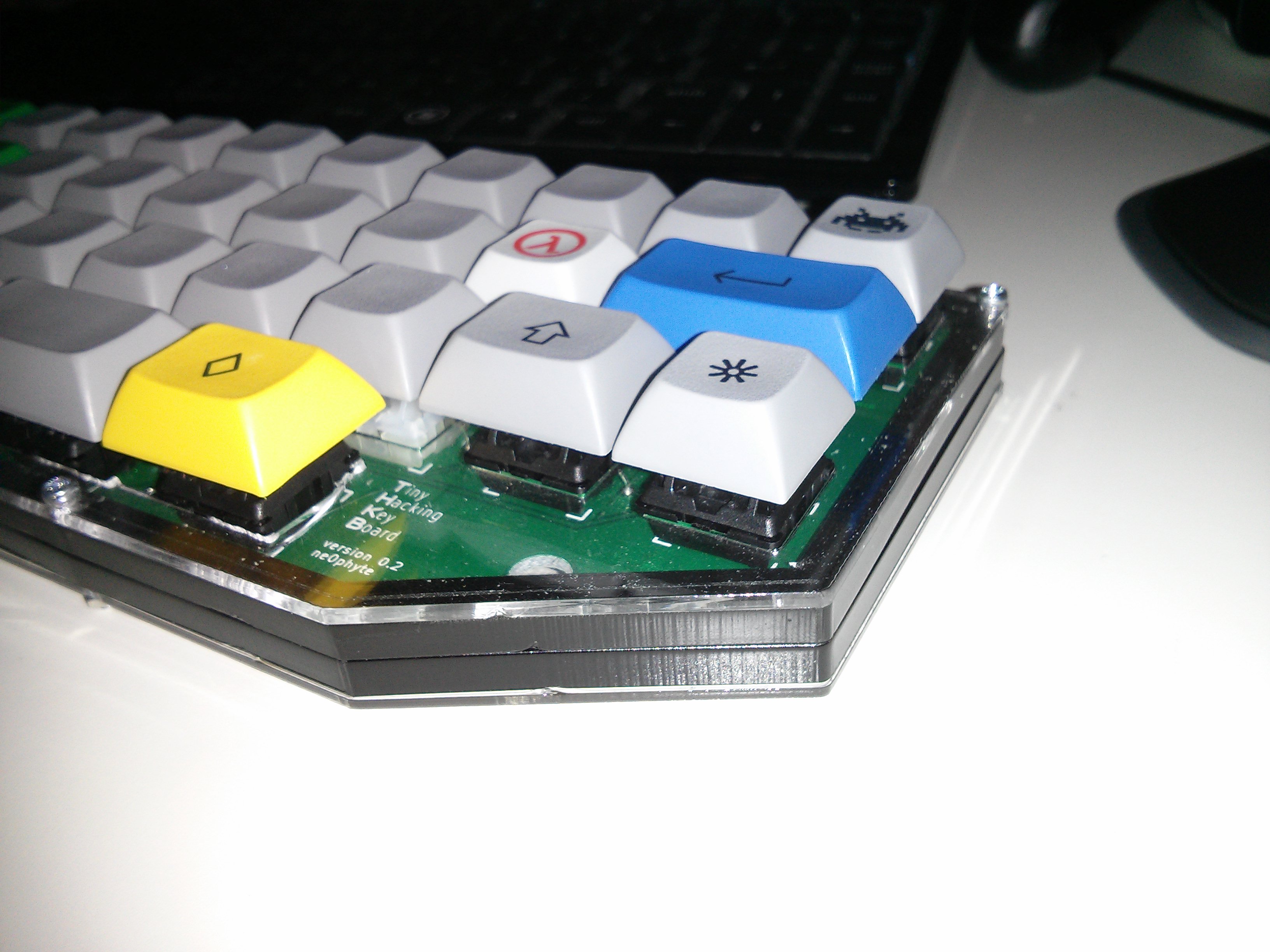

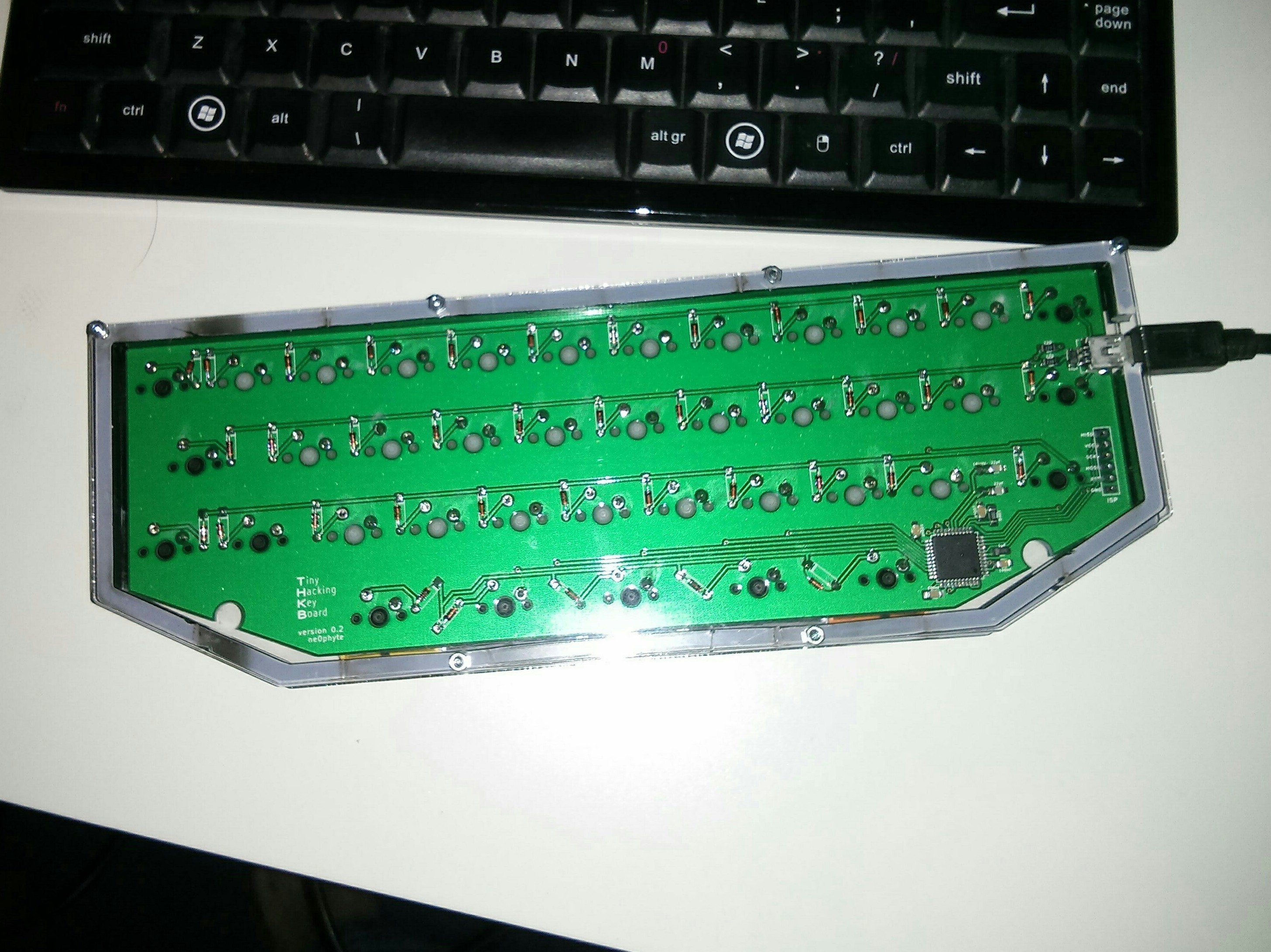

Finally got her built! I can provide the files I used for the case if anyone wants, but there are some issues with them which I'll try to fix if anyone wants them!
The case is built from black and clear acrylic (so you can see the pcb through the top and bottom) and I've used a mix of Gateron brown switches (for the alphas) and Cherry blues (or the mods). The keycaps are kind of whatever I had lying around.
Thanks to ne0phyte for all the work he's put in on this great little project and for the help he gave me with programming it!

Thanks! There are definitely some issues with it but overall I'm very pleased with the effect. Still getting used to typing on blanks (and it's not even fully blank!) and finding my punctuation on different layers!

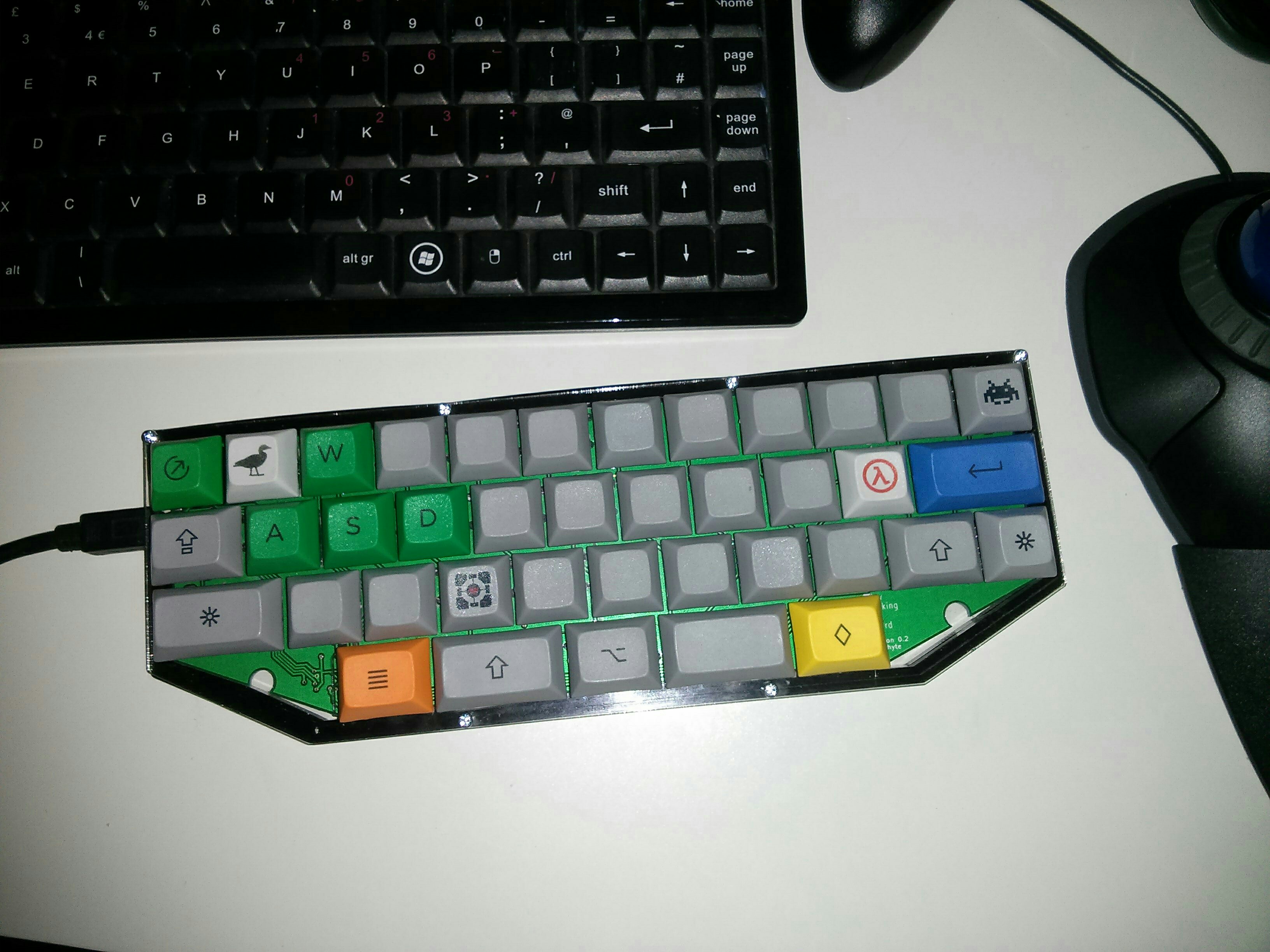

Hi folks, here's mine (without a case, I'm not good with materials...)
A couple of caps have a wrong profile of course, most notably the R2 control.
However, I found out I can't get used to the bottom row layout, the middle 1.25u key confuses the hell out of me. So if anyone's interested, I can pass on the PCB (with everything soldered except the switches) to someone else in Europe for £20 shipped ('s what I paid for it). Here's a pic of the soldering. EDIT: ... aaand it's taken.

Those are SA Retro. The SA profile caps are made (these days) by Signature Plastics, and they're more-less available only through group buys or second-hand.
