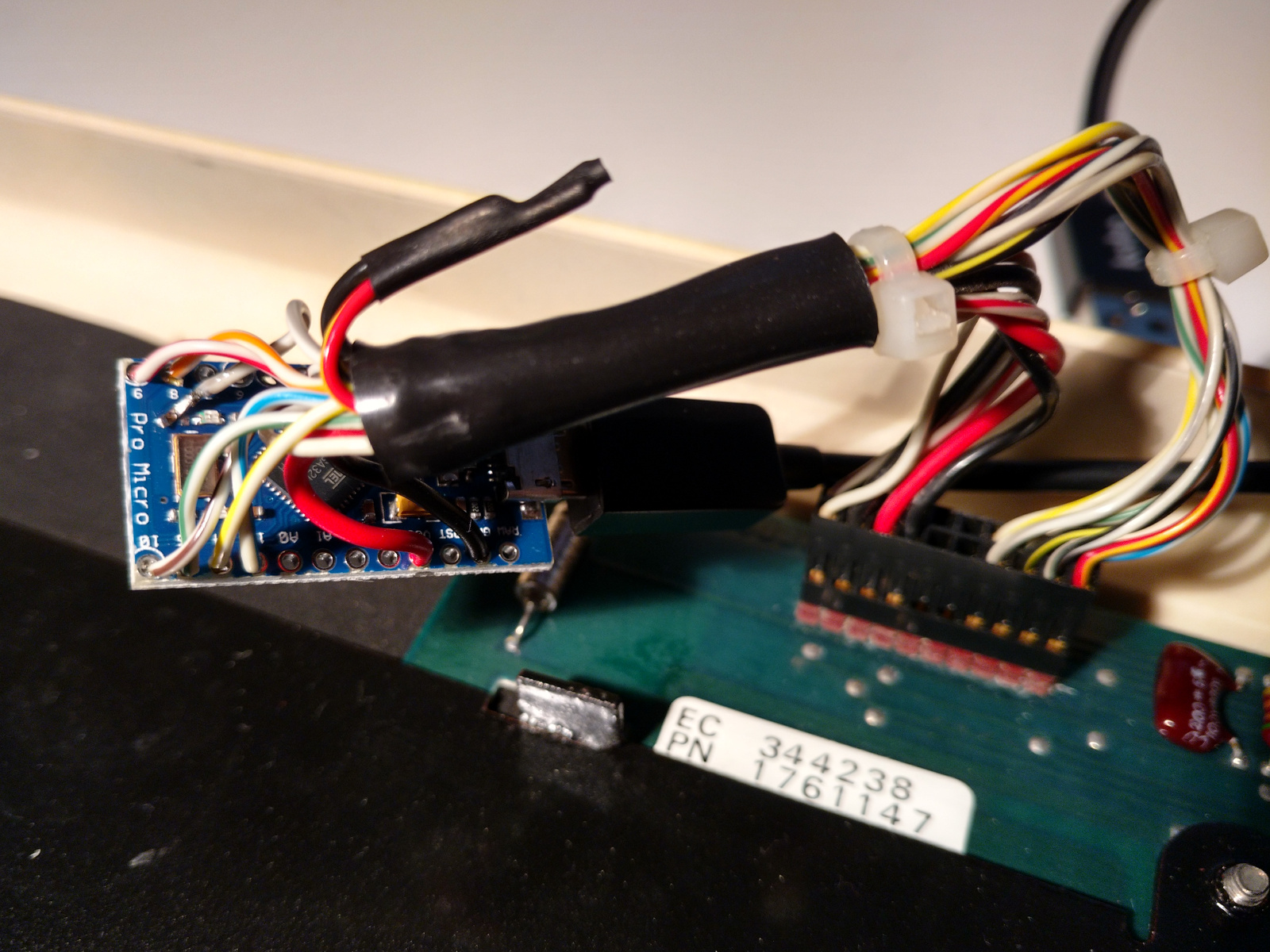

I recently used a Pro Micro as a controller (not converter) for my Model F "Bigfoot" keyboard running Soarer's firmware.
I was told that the Pro Micro didn't have enough pins and, since the controller needed access to PB6-PB0, it seemed that I
would be one pin short (PB0) see http://i.imgur.com/wMNx2u6.png. However, by removing the R4 resistor (current limiter for the yellow TX LED, which wouldn't be seen anyway since the Pro Micro is mounted inside the Bigfoot case) and soldering to the pad vacated by R4, I was able to gain access to PB0 and thus successfully make the Pro Micro work as my controller.

jim121049 wrote: I recently used a Pro Micro as a controller (not converter) for my Model F "Bigfoot" keyboard running Soarer's firmware.
Oh wow amazing job. I always wondered if that was possible but had enought Teensies left to take one instead ;)
Come on take some pics
The R4 resistor is in the lower left corner of the Pro Micro. It is immediately below the yellow LED, between the hole labeled "8" and the 16MHz crystal. The lower of the two pads vacated when R4 is removed connects to pin 8 of the ATmega32U4 which is PB0.
Wodan
ISO Advocate
27 Dec 2016, 10:52
You're a real champ! Nice to have you on DT :)

Just a couple of additional points which may save some grief for anyone contemplating using a Pro Micro with a Bigfoot...
1. Connect "Frame Ground" on the Bigfoot's circuit board to "GND" on the Pro Micro. My setup wouldn't work correctly without this connection.
2. I changed "debounce 1" to "debounce 5" in the "bigfoot.sc" configuration file to solve key bounce problems with some keys. The documentation found in Soarer_Controller_v1.20_beta4.zip states that 5 is the default value.

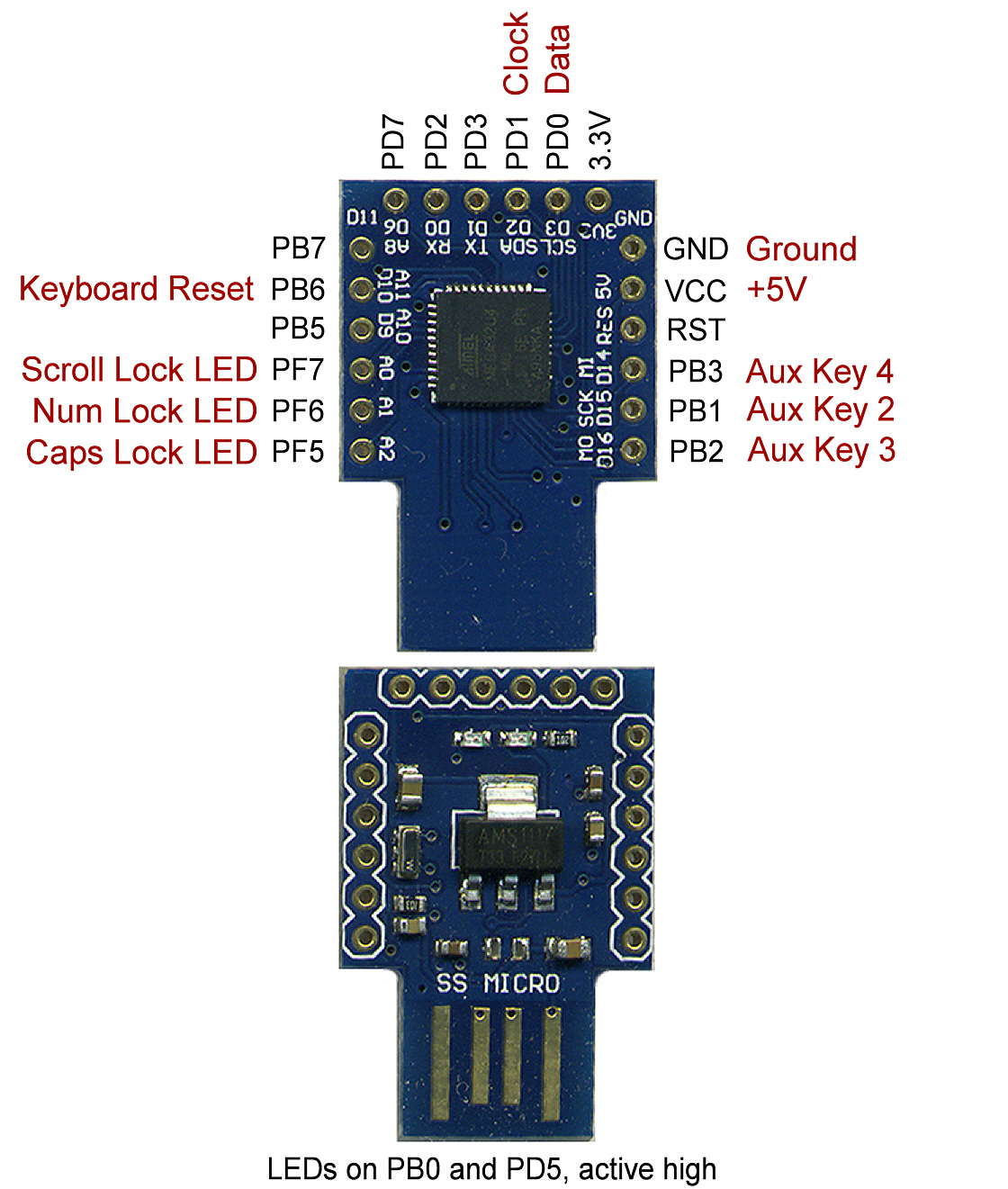

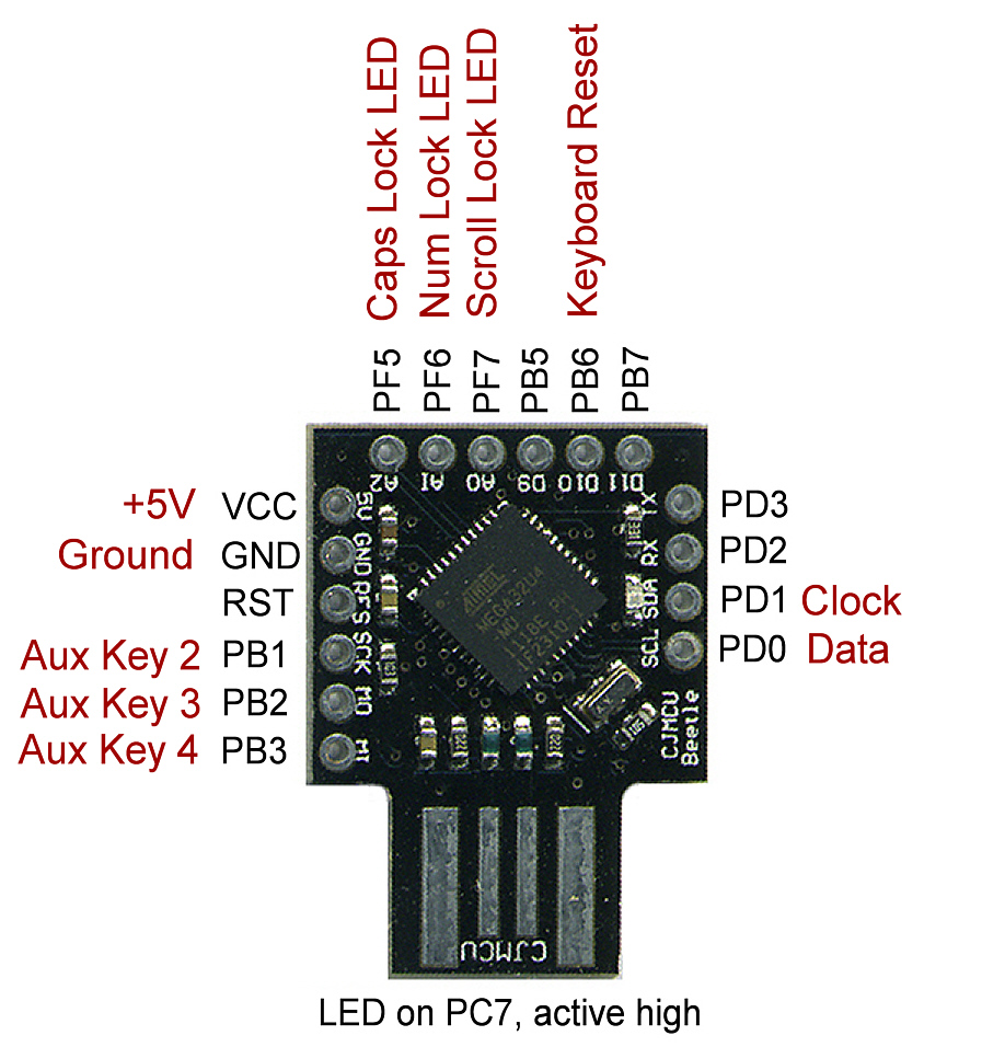

Arakula
25 Nov 2017, 13:26
I've recently acquired two other little Arduino-compatible boards which can be used for Soarers Converter. The first one is called:
SS Micro
This is a close relative of the Pro Micro; the main difference is that its LEDs, while connected to the same ATmega32U4 pins, are active high instead of the active low LEDs on the Pro Micro. That means you can use my patched Soarer Converter firmware (somewhere on page 2 of this thread, AFAIR), but the LEDs will be constantly lit and only be turned off when an error happens. While this little fellow has far less pins available, it's just about right for Soarer and/or Hasu's Converter. Here's an image of the thing, its connectors and where to attach what for Soarer's Converter:
SS Pro Micro Soarer AT Converter.jpg (546.42 KiB) Viewed 21052 times
As you can see, the SS Micro has a double-sided layout. Well, who needs to see the microcontroller ... the LEDs are more important.
The other one is called
CJMCU Beetle
Seems to be a DFROBOT Beetle clone; it exposes the same pins and the same LED connection as that one in a slightly larger, but also more usable package. Works for Soarer Converter, too, but the LED is at a totally different port/pin, so neither Soarer's original firmware nor my patched one use it at the moment. Well, that's a very minor problem, and maybe I'll create a patched version. Here's an image of the thing, its connectors and where to attach what for Soarer's Converter:
CJMCU Beetle Soarer AT Converter.jpg (345.97 KiB) Viewed 21052 times
Both are cheap and can be used for Soarers Converter. One little problem is the thickness of their PCBs; both are a bit too thick to fit comfortably in a USB A socket (they do, but just about). Soldering a cable to the USB pins would probably be a good idea.

25 Nov 2017, 16:50
Oooh, cool. They look great, thanks for sharing, especially with the annotated pinouts! They'd be great for a very small in-line converter. I might grab one to try out.
The only CJMCU beetles I could find on AliExpress didn't have an atmega32u4, but an attiny85. It had a different pinout too. Anyone looking at these, be sure to get the right version. :)
Arakula
25 Nov 2017, 17:40
Searching for "beetle atmega32u4" or "beetle leonardo" turns up quite some on AliExpress and eBay.
25 Nov 2017, 18:51
Arakula wrote: Searching for "beetle atmega32u4" or "beetle leonardo" turns up quite some on AliExpress and eBay.
Ah yeah, thanks! That works.
