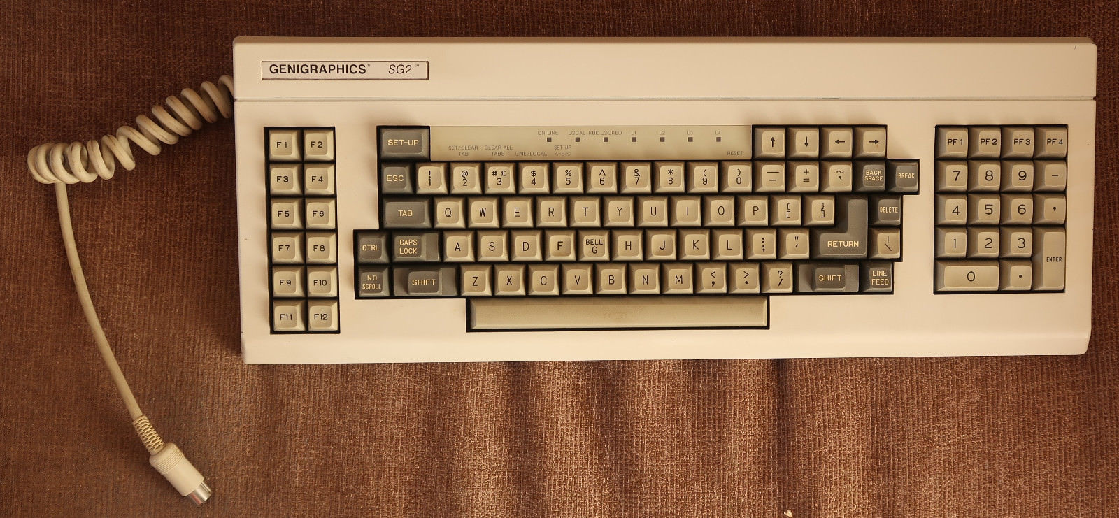

Noobmaen
02 Apr 2018, 14:39
Is this Genigraphics SG2 keyboard some sort of SKCC like this similar looking Bondwell?
