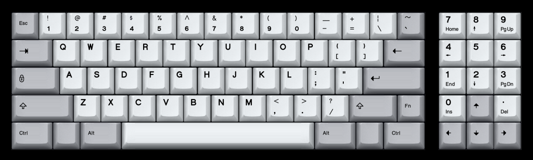

@consolation and @NathanA Great discussion guys! I know the thought process I used to come up with the #3 option but it is great to see how other people approach things and what their priorities are. I can't speak for Ellipse wanting to add the Cooler Master secondary legends but it is an interesting option. He did include a number pad without any secondary legends in the scan he sent me to work from so perhaps he has that in mind as an option. It wouldn't be perfect for every desired layout, but at least it wouldn't have the 'wrong' legends if you want to create something out of the ordinary.
Here is the current state of the XT repro legends. Looking a bit more like a complete keyboard at least but the small text on the mods and number pad sub-legends is just a modified Helvetica stand-in at this point. I would really like to run some printing tests with Ellipse before committing to drawing an entire new alphabet. I think it will take some tweaking to account for the bleed inherent in dye sub printing. It becomes a substantial part of the letter stroke at such small sizes.
F XT Legends 3.png (211.52 KiB) Viewed 11844 times

Zed sent me the SVG of the XT font and the legends are near perfect! I printed them out 100% on my laser printer and did some digital micrometer spot checks.
These are going to look great on all our F62 and F77 keyboards!

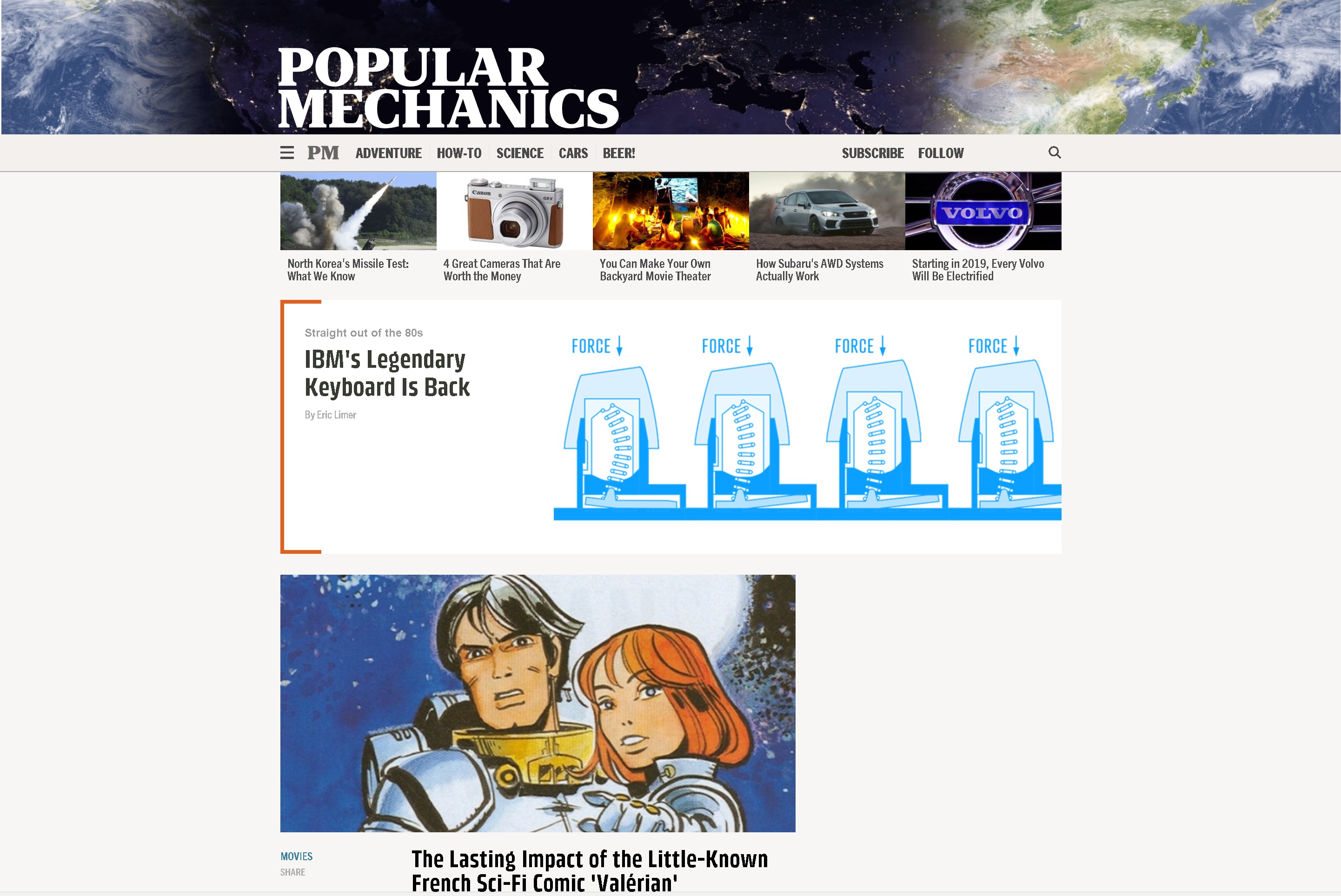

The project writeup in Popular Mechanics is great! Congrats, Ellipse. I'll be curious to hear if you get an uptick of interest from their readers.

Techno Trousers wrote: The project writeup in Popular Mechanics is great! Congrats, Ellipse. I'll be curious to hear if you get an uptick of interest from their readers.
Kinda odd that the article doesn't even once mention the how the switches actually work. The word "Capacitance" isn't used even a single time so the article isn't too insightful :(
Techno Trousers
100,000,000 actuations
05 Jul 2017, 19:53
It does say that the paddle striking the PCB completes the switch contact, and that's probably about as much detail as a "normal" person would care about. :P
The other thing was how they repeatedly implied that all Model Fs are similar to each other in design and construction; specifically, that they all have metal casing vs. "plasticky" Model Ms. I understand that they probably didn't want to dive into minutiae such as obscure versions made for banking systems, but come on! The vast majority of Model Fs that the world is familiar with -- those that shipped with the PC, PC/XT, and PC/AT -- all have plastic outer casing.

For those who didn't see already, today the project is featured on the home page of http://www.PopularMechanics.com - a comprehensive look at the project and on the Model F keyboard. A great honor for the Model F!
http://www.popularmechanics.com/technol ... -keyboard/
popular mechanics home page with Model F article.jpg (669.11 KiB) Viewed 11002 times

Zed wrote: He did include a number pad without any secondary legends in the scan he sent me to work from so perhaps he has that in mind as an option. It wouldn't be perfect for every desired layout, but at least it wouldn't have the 'wrong' legends if you want to create something out of the ordinary.
First of all, looks awesome, amazing work; excuse me being nit picky in the following paragraph:. If you look at this layout you can see that the cursor legends are unnecessarily duplicated which looks bit weird. Since we have the cursor pad below, is there anyway we could order CM style legends that duplicate a normal nav cluster in the function layer - even if it's extra and made as a run after the main order? I really think that it would be a more sensible layout.
I bodged together a rough mockup -
CM STYLE NAV
CM STYLE NAV
F XT Legends 2.png (249.74 KiB) Viewed 10863 times
Print, Scroll Lock and Pause - could be added to num pad 1,2,3 respectively; giving you a full, easily accessible nav cluster that's laid out where you expect it to be. eg Delete is just to the right of back space.
CM Style + top bar and tab
F XT Legends 2.png (250.94 KiB) Viewed 10797 times
Of course, it would look much better if the pad legends were replaced with symbols, I was just doing a 5 minute hack job...
The whole cluster is easily accessible with one finger on split R shift FN key - or you could put that fn key in toggle mode so it works like a traditional numlock with the pad. I really DO think this is a far better layout, if you can grab a CoolerMaster TK board to try it out, I'd strongly encourage you to do so...

OMG I want this now - can't believe noone has thought to do this before?!!!! GIMME!!!!!!!

They did, that's (almost) how CM do their TK boards, it actually works really well, much more usable.
