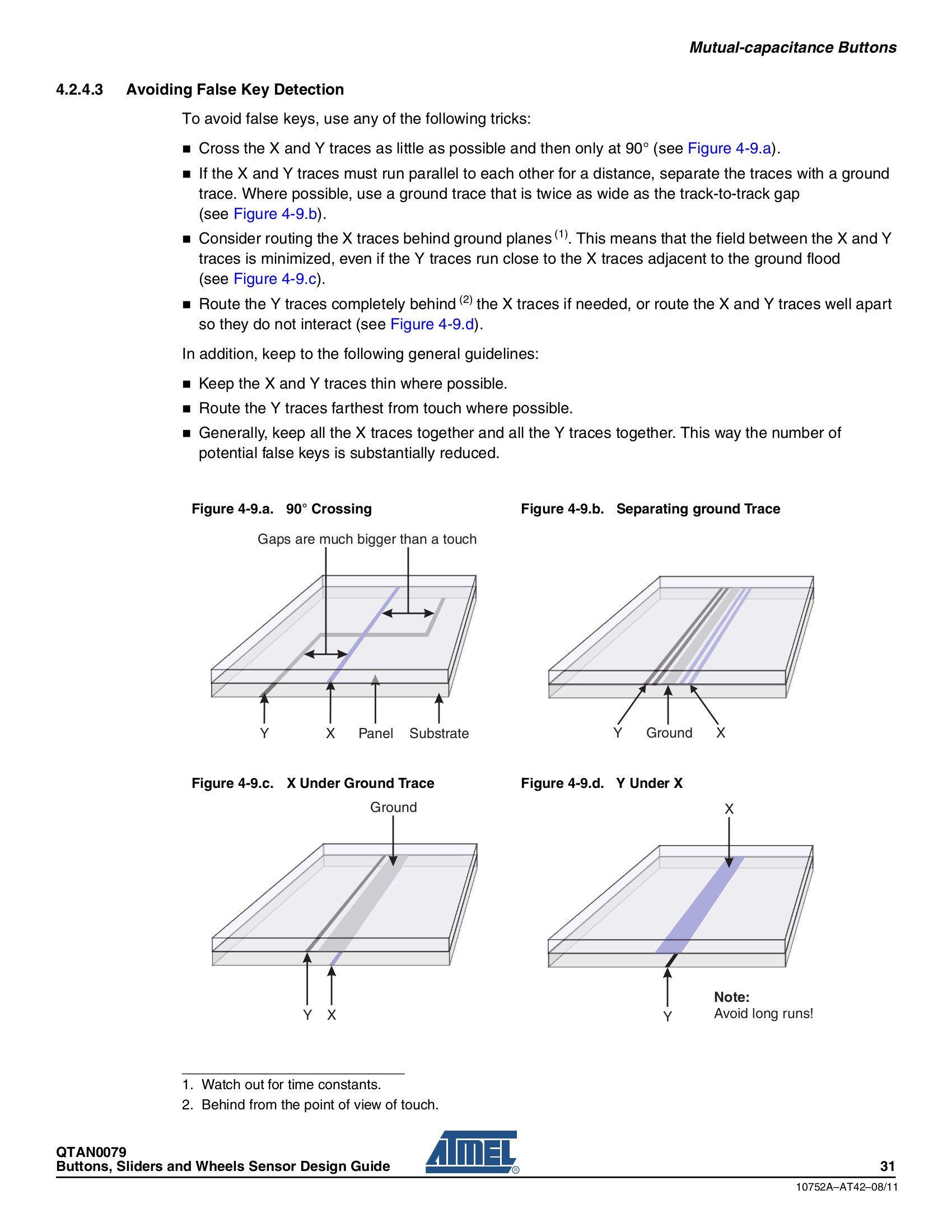

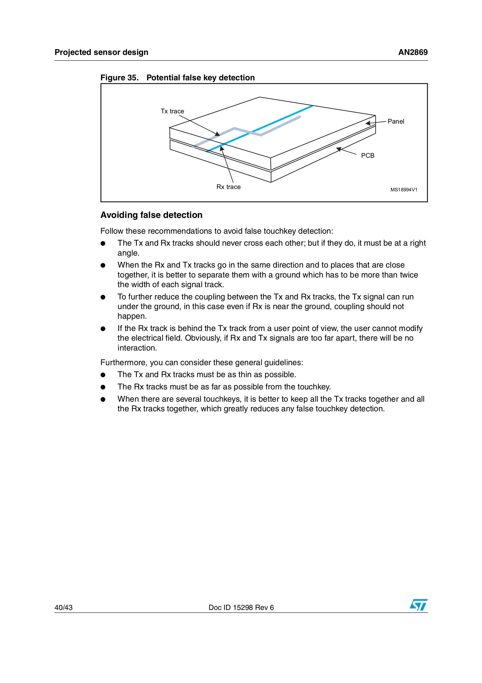

wcass wrote: One thing i noticed is that the bottom row (pin 3) does not cross any columns. All of IBM's designs have every row crossing every column exactly one time and I made sure i did that with the XTant, but I'm not sure how much difference this makes or what it does. My best guess is that it is an attempt to make all of the rows/columns as uniform as possible vis-a-vis Cx and Cp.
This was done in purpose. I have taken a look at the documents and it does not state that the crossing must be coherent across rows and columns. I could avoid the crossing on the last row only.
But I will take your advice and route it in a way that it crosses one time each column also.
I think you see what i was talking about earlier; this being difficult to do with IBM's original capacitive pad design due to the number and location of the model M rivets. You might look at some of the other capacitive pad designs that i suggested earlier in this thread that allow the rows to pass through the center of the switch rather than forcing them to always go around. At worse you will have one trace competing with a hole in the space between rows rather than two.
You mean this -> http://deskthority.net/styles/deskthori ... target.gif
Yes, I read it. Very good documents. Lots of information.
The problem that I see with the alternative design is that we do not want to replace the top plate and it is not made out of metal. This means that the keyboard may be affected by noise. I am actually afraid of the 50 Hz (60 in the USA). This is why I tried to use the IBM design. Also because you have demonstrated already that can be done.
We could attach a long flat connector to the xwhatsit controller and design three PCBs (my feeling is that the triangles will work well). It will be more expensive that's the drawback.
I am thinking also to reduce the width of the X and Y traces. It will reduce the noise also.
I will create a new version with these two changes: (1) last row crossings (2) reduced width of X and Y traces
I post the two pages of the documents that you pointed that talk about routing:

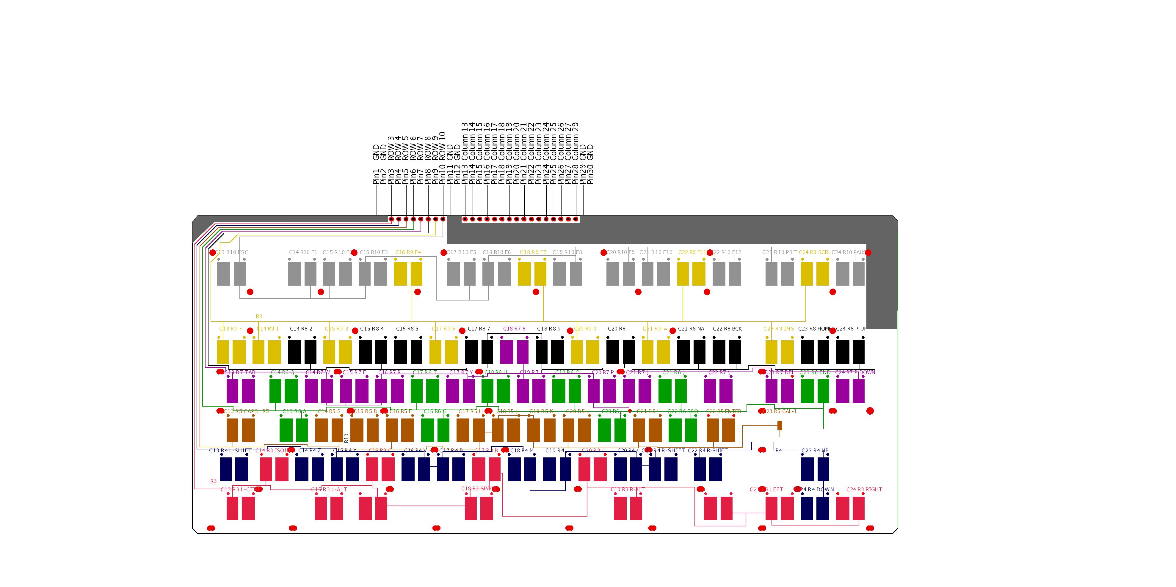

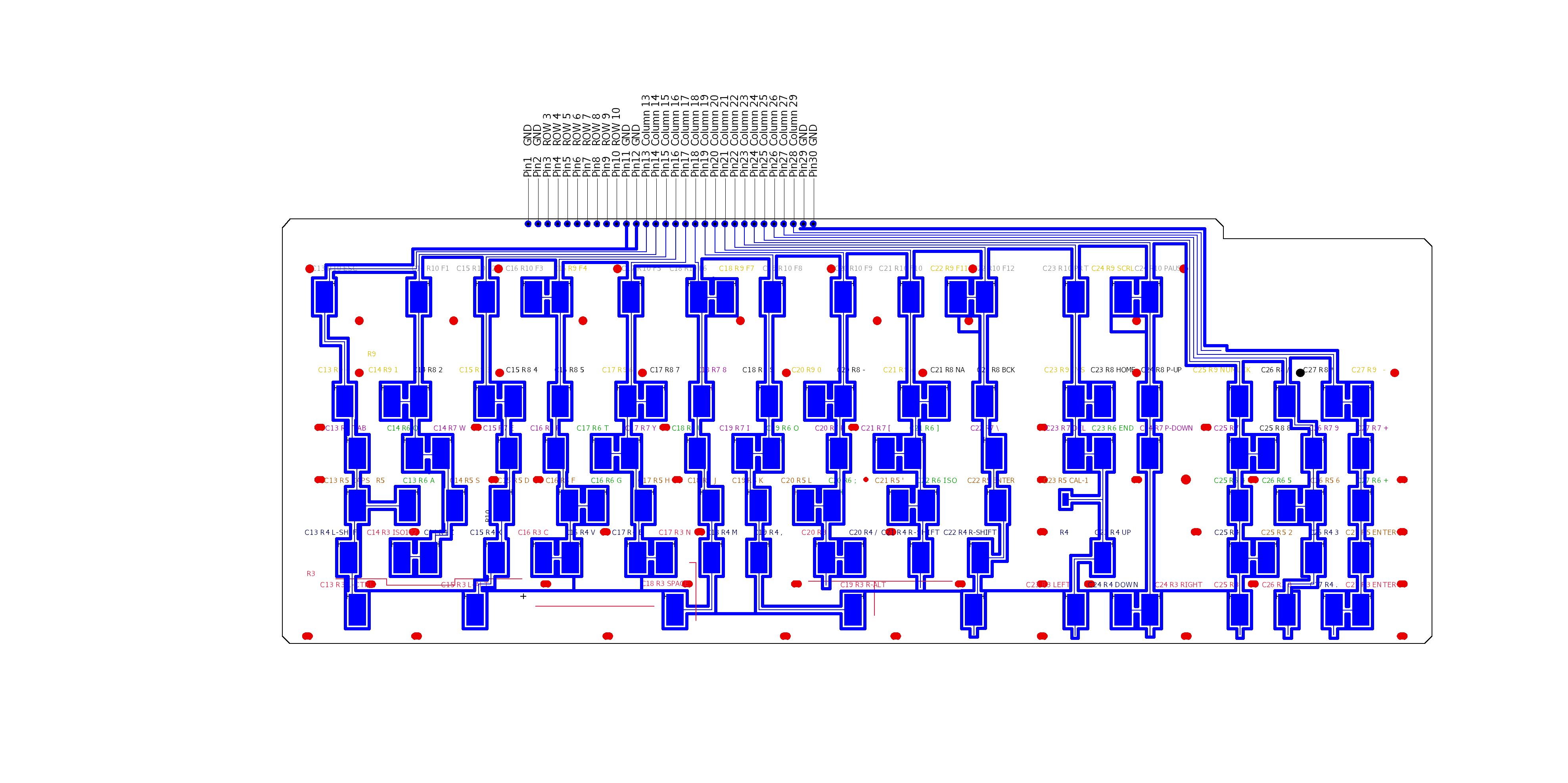

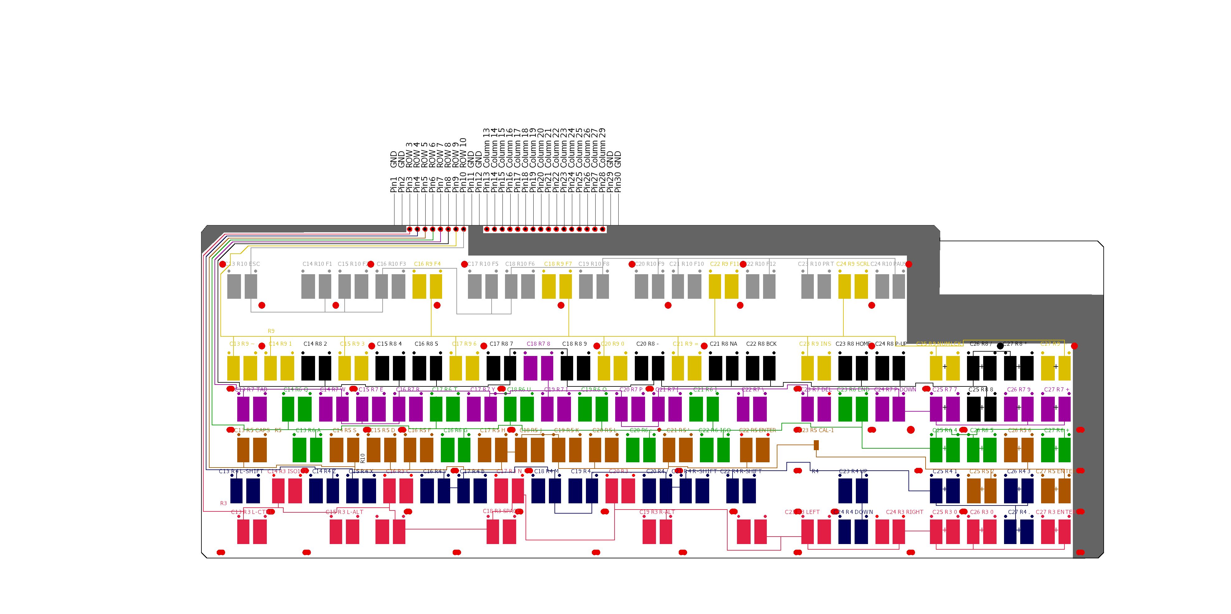

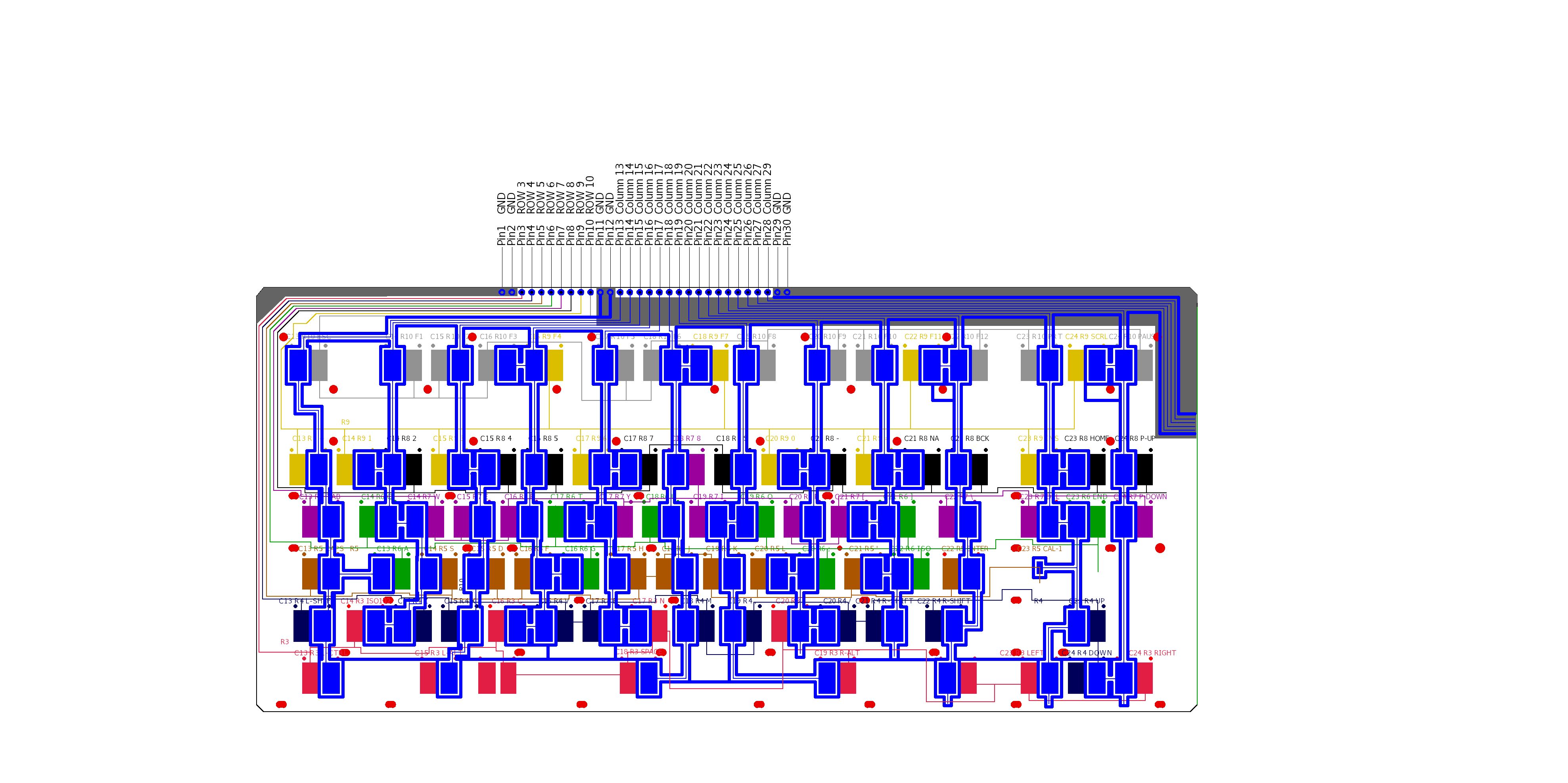

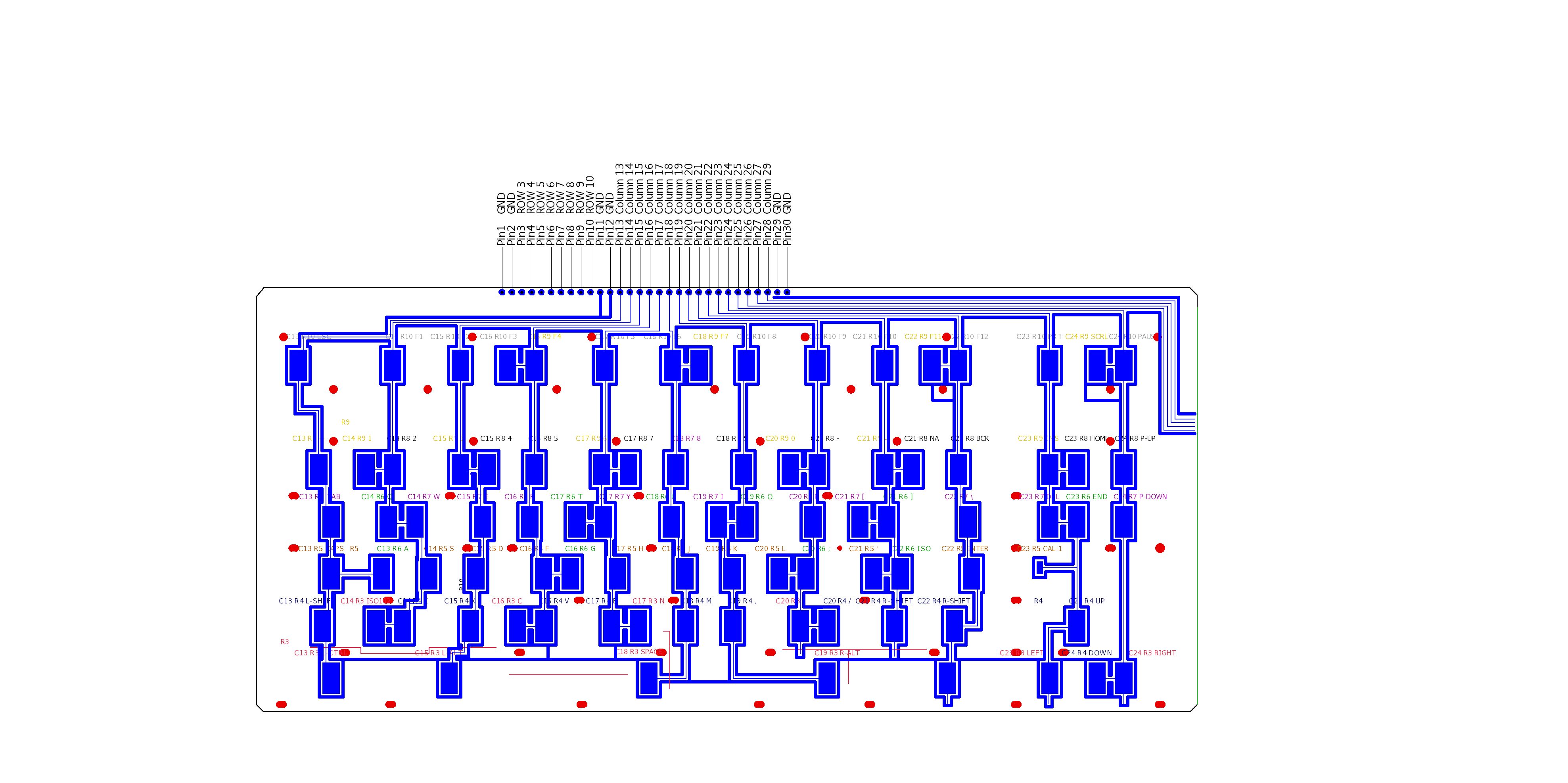

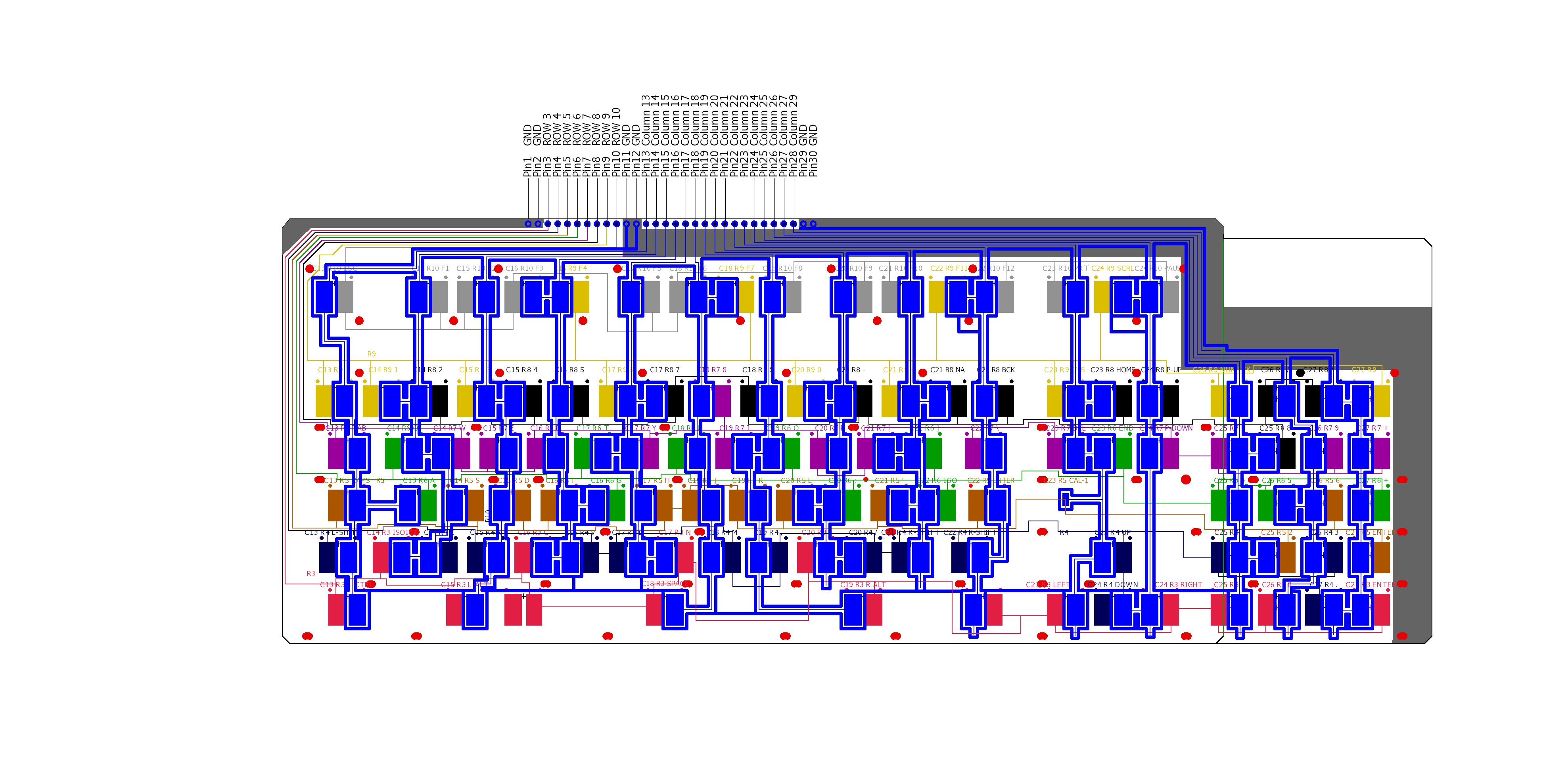

Attached the updated version (0.32) including of the wcass comments.
The design table does not change.
FSSK
FSSK 0.32 - both.jpg (665.65 KiB) Viewed 8929 times
FSSK 0.32 - bottom.jpg (565.71 KiB) Viewed 8929 times
FSSK 0.32 - top.jpg (500.83 KiB) Viewed 8929 times
FEXM
Extended 0.32 - both.jpg (771.18 KiB) Viewed 8929 times
Extended 0.32 - bottom B.jpg (646.51 KiB) Viewed 8929 times
Extended 0.32 - top.jpg (565.23 KiB) Viewed 8929 times

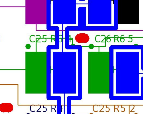

Correction
These two tracks were running parallel. I have corrected it as follows:
Extended 0.33 - error correction.jpg (50.02 KiB) Viewed 8924 times

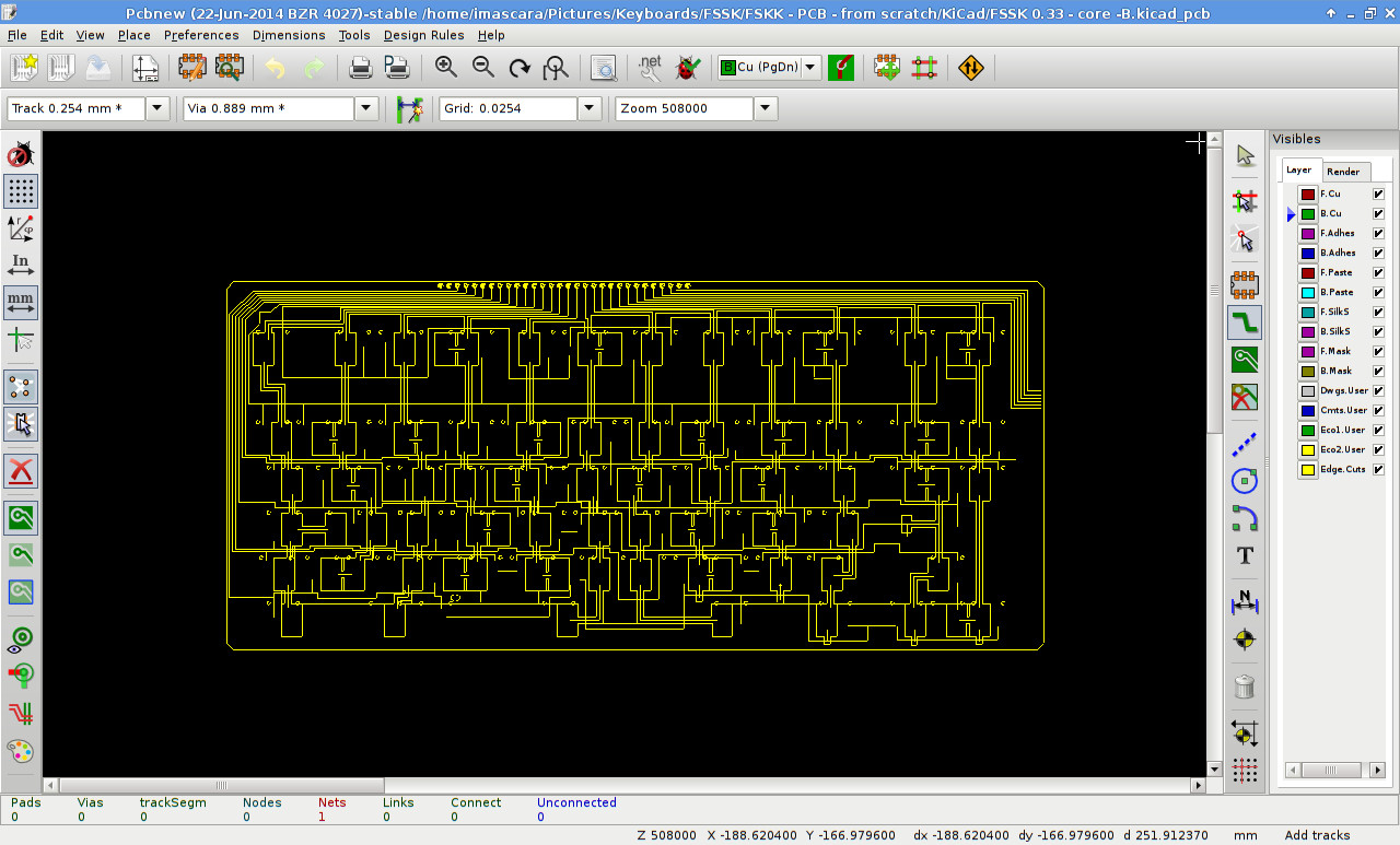

The next step is to create a real gerber in a PCB cad. I would like to do it with Kicad for varous reasons:
1) xwhatsit is available in kicad
2) It is GNU
3) it runs in my debian ;)
I have exported the design from the "famous" deltacad into a a "DXF" file and using dxf2svg2kicad converted it into kidcad PCB.
(reference http://mondalaci.github.io/dxf2svg2kicad/) .... but the capacitor PADs are missing.
Does anyone knows a better way of doing this ?

chzel
31 Dec 2015, 00:15
Haven't used KiCad, but I can recommend gerbv to visually validate the gerbers.
A google search does return various tutorials on how to export gerbers from Kicad.
Sorry I can't be of more help.

chzel wrote: Haven't used KiCad, but I can recommend gerbv to visually validate the gerbers.
Thanks. But is only a viewer. It does not read any of the possible DeltaCAD output
Any idea/help is always well come.

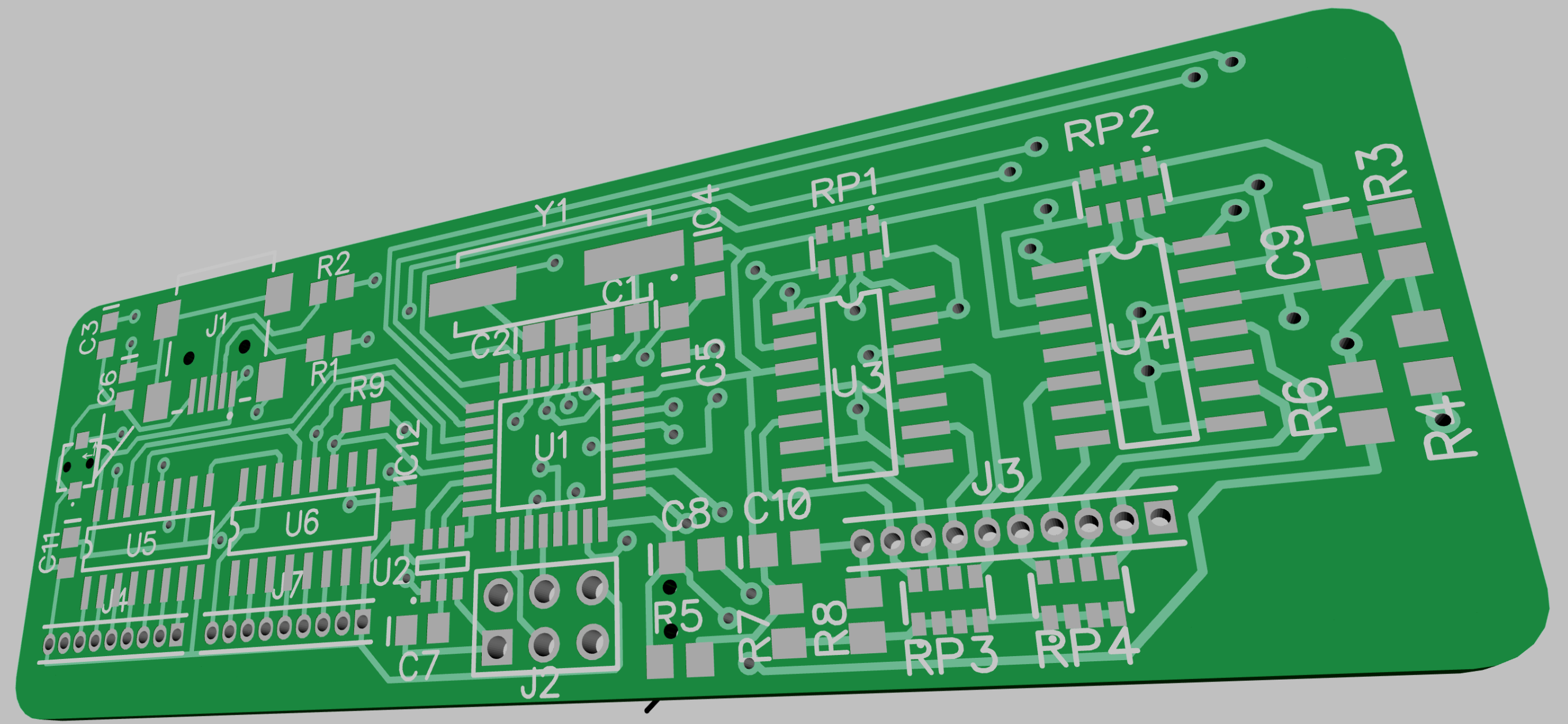

I'm curious as to your aversion to diptrace. It does run on Linux after all.
fwiw, I have a completed schematic for the xwhatsit controller and I will tell you that validating that by hand between kicad and diptrace was hell. I'm about a quarter of the way through routing it on a smaller board swapping out the qfn for soic.
I'm happy to share the files with the disclaimer to assume they're junk until I get my prototype back and tested as working.

01 Jan 2016, 22:19
__red__ wrote: I'm happy to share the files with the disclaimer to assume they're junk until I get my prototype back and tested as working.
1.05" x 2.9".
Now I just need mounting holes of an unknown size...
The next question will be:
"If I want to add that to my PCB then how do I route my rows and columns since you have those resistor packs in the way?
Answer - the back of the PCB is clear all the way up. Enjoy.

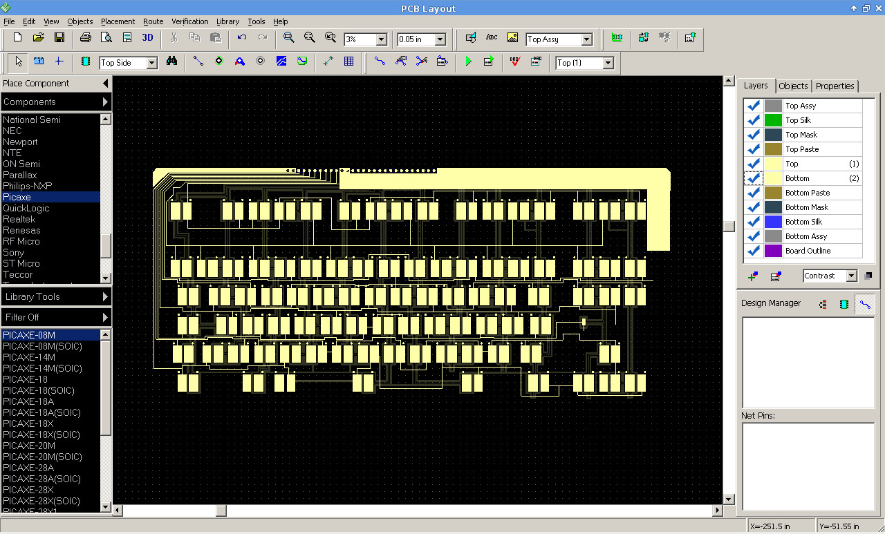

And also ... it managed to import the design into Diptrace :-)
We are getting there.

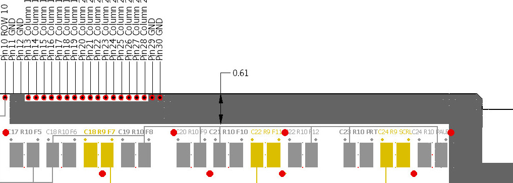

__red__
03 Jan 2016, 02:32
idollar wrote:And also ... it managed to import the design into Diptrace :-)
Are you wanting to put the design in 0.62"? Remember, you don't want your circuitry inside the metal sandwich.
Mainly because the solder joints won't survive being curved.
idollar
i$
03 Jan 2016, 04:39
The area that I was pointing is mainly flat, but you are correct. I will check if I am correct.
Thanks for the comment !

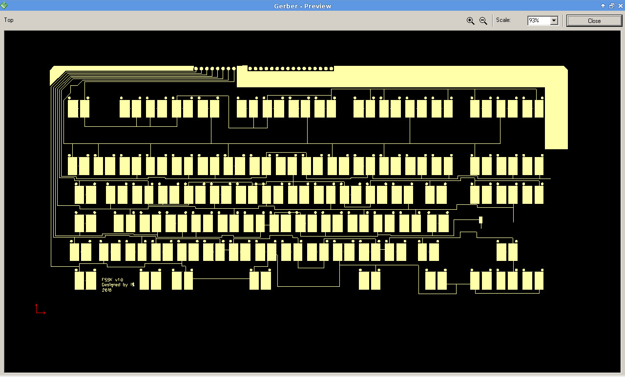

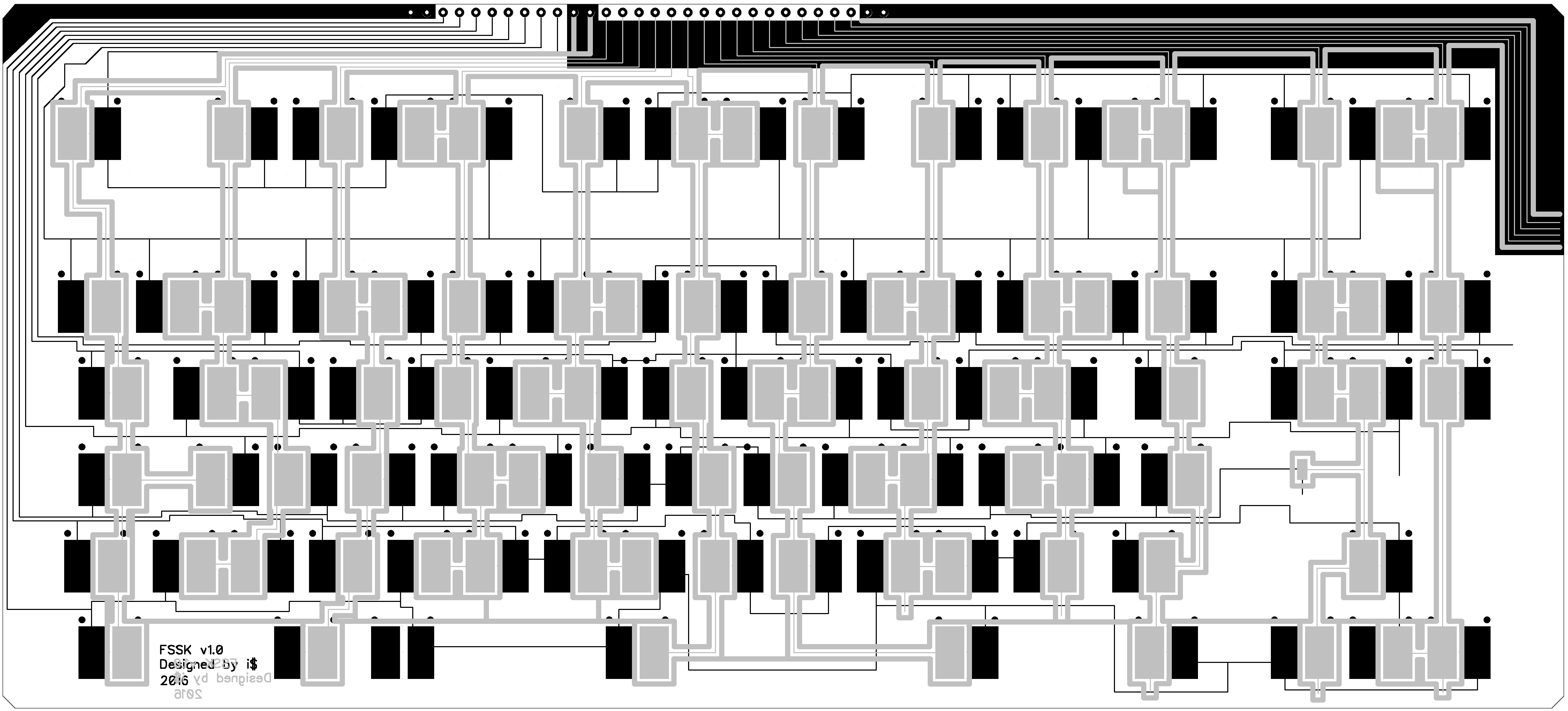

idollar
i$
03 Jan 2016, 18:58

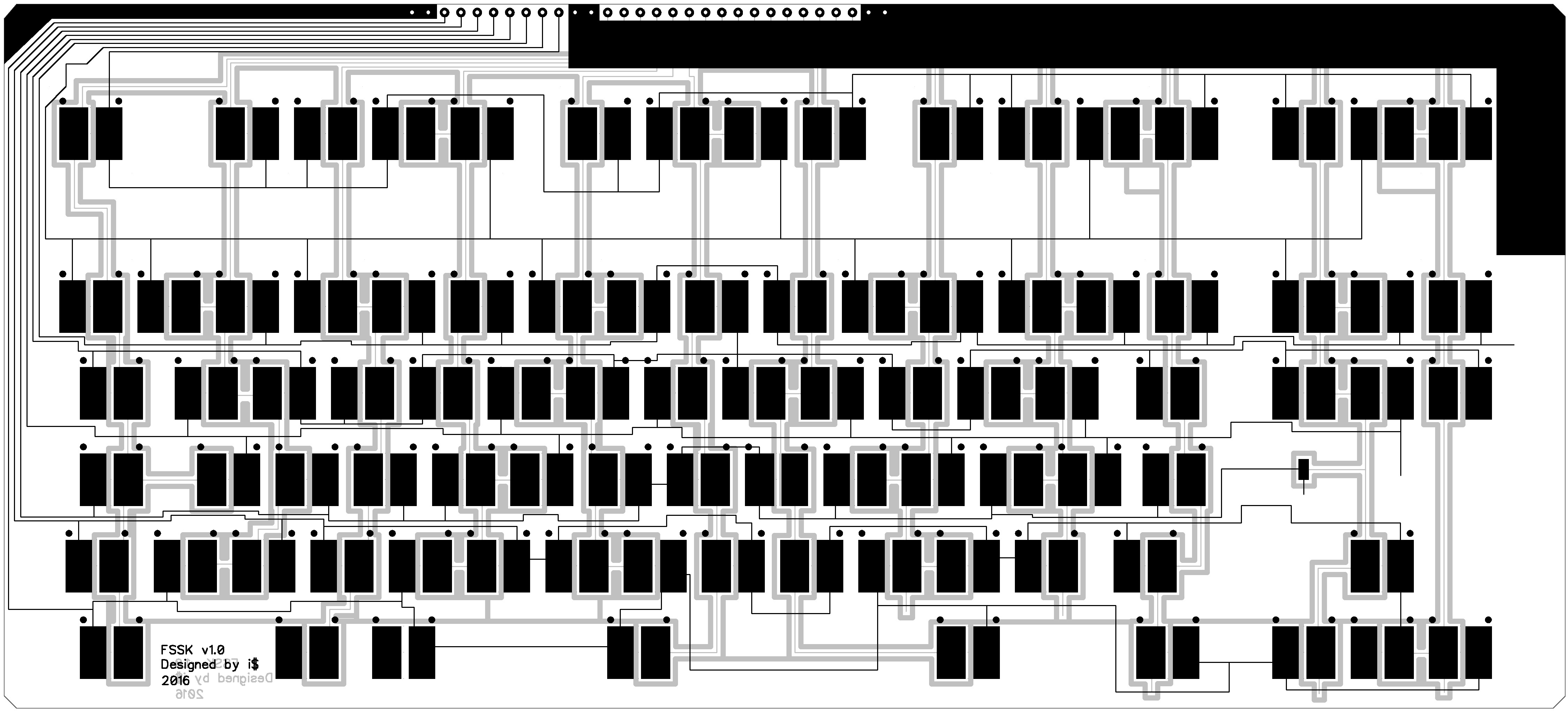

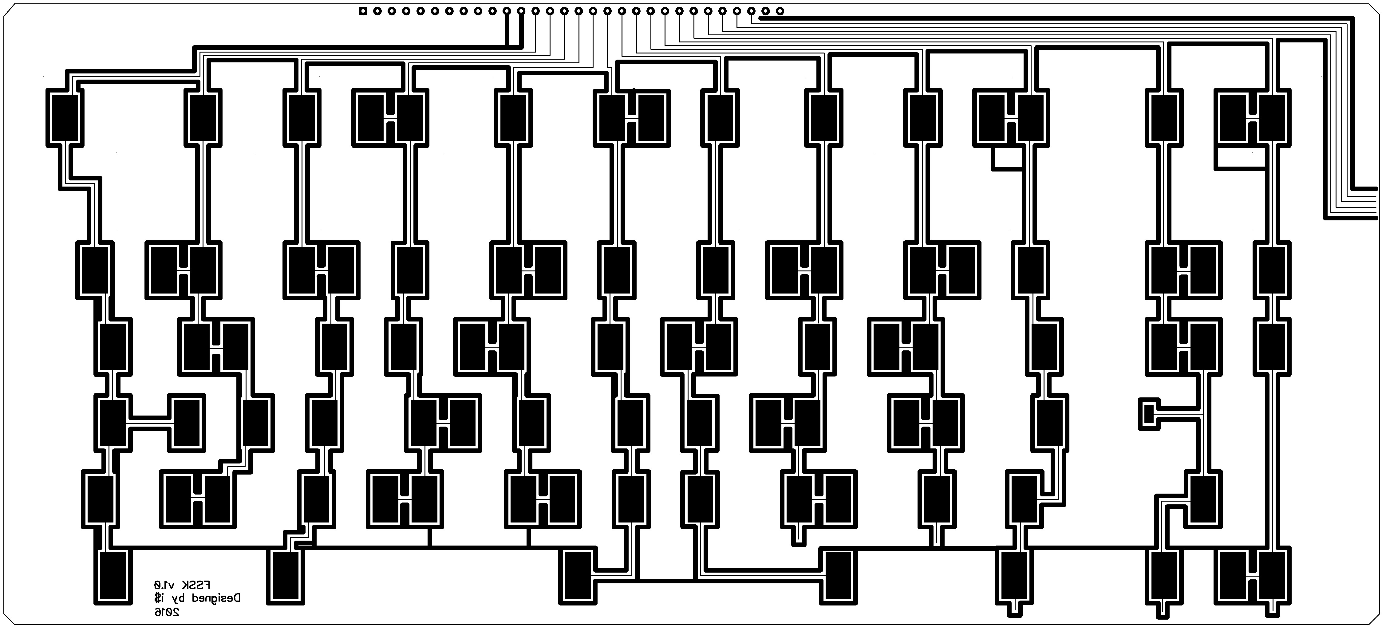

Attached the latest version of the PCB in JPG from Diptrace, ready for production
TOP
FSSK - Diptrace v01a - top.jpg (673.66 KiB) Viewed 8670 times
BOTTOM
FSSK - Diptrace v01a - bottom.jpg (771.73 KiB) Viewed 8670 times
BOTH with to-layer on top
FSSK - Diptrace v01a - both.jpg (913.32 KiB) Viewed 8670 times
BOTH with bottom-layer on top
FSSK - Diptrace v01a - both - bottom on top.jpg (951.51 KiB) Viewed 8670 times

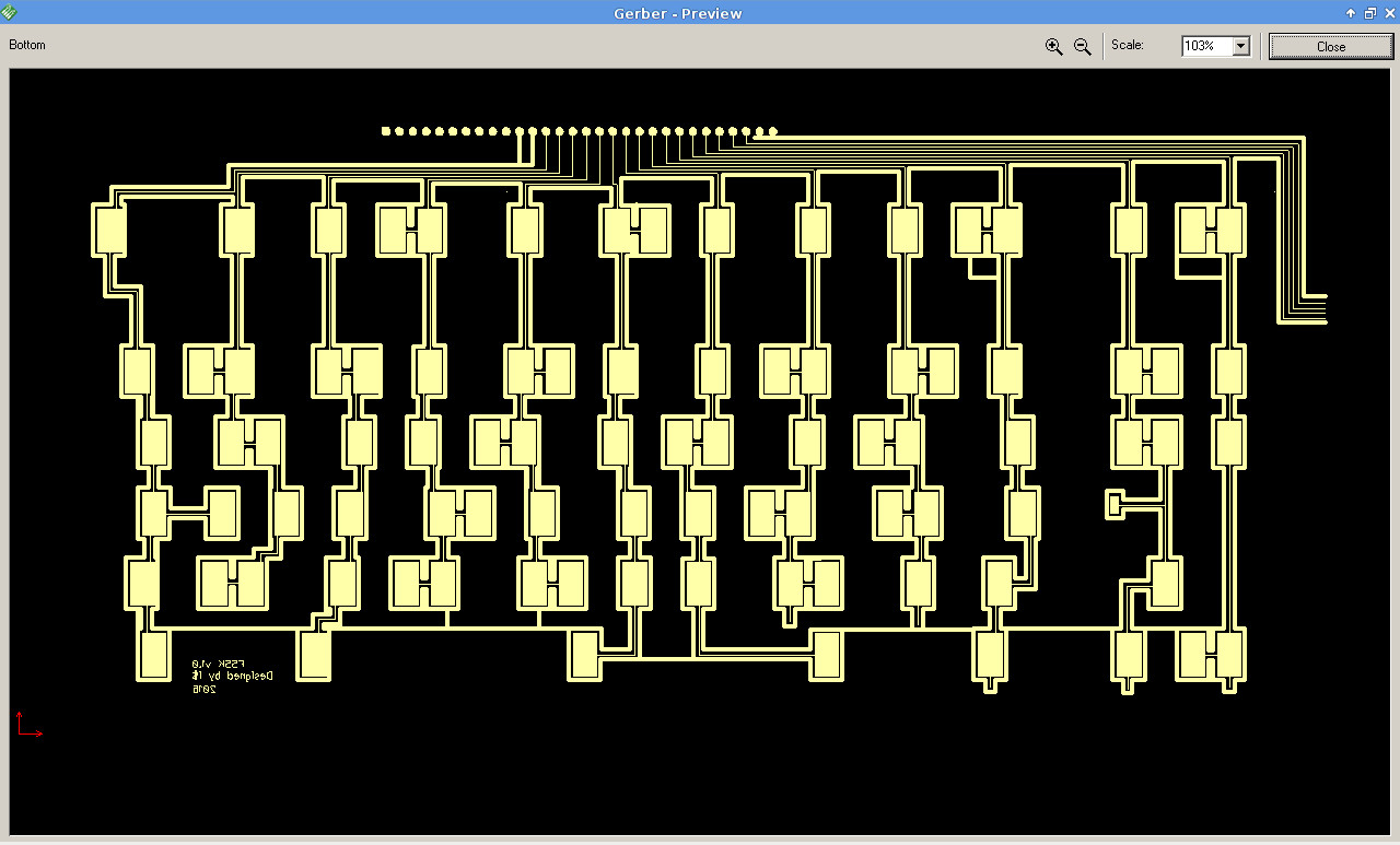

Gerber preview screen dump - TOP
FSSK - Diptrace v01a - Gerber preview - top.jpg (168.78 KiB) Viewed 8670 times
Gerber preview screen dump - BOTTOM
FSSK - Diptrace v01a - Gerber preview - bottom.jpg (168.61 KiB) Viewed 8670 times
Gerber Files
Diptrace_Gerber-v01a.tgz
(154.58 KiB) Downloaded 247 times
idollar
i$
03 Jan 2016, 19:01

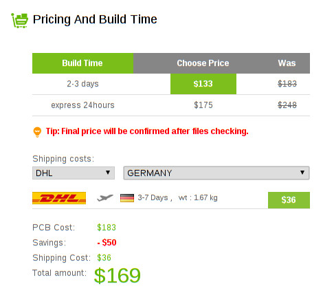

I will check my files with the recommended manufacturers, I should have the referenced recorded somewhere.
If anyone would like to recommend a site, please do not hesitate :-)
Once I have a quote for the FSSK PCBs, I will contact the people in the "interest list".
Hurry up and register if interested ;)

idollar
i$
03 Jan 2016, 19:20
chzel wrote: Great job i$!
I know it's a bit late for the prototype, but in a next revision maybe you could use thermals on the ground pads. It's a large plane, and might make soldering hard for inexperienced builders with "lightweight" irons.
Any comment is welcome. It is not late.
It is my first DipTrace project. I just need to know how to do it.
Thanks
BTW are the third pair on the bottom row the calibration pads?
The calibration pad is above the arrows. A little one.
idollar
i$
03 Jan 2016, 19:32
http://www.pcbway.com/
379mm x 171mm
10 units
1 oz Cu
Tenting vias
21$ (I have subtracted my 2 prototypes, I hope that everyone would consider it fair) shipped to Europe.
Additional, the shipping from my location to the final, once I test the prototypes to limit the risk.
The above is just the PCB. Nothing more.
chzel
03 Jan 2016, 19:41
So what is that pair doing there? If it's for the extra barrel under the spacebar shouldn't it have the third on the bottom layer? Or I'm misunderstanding something, which is rather common!
You are going to run the FSSK prototypes before the FEXM ones right?
Maybe the other way round is less risky? Since the FEXM is a superset of the FSSK?

Please forgive my ignorance, I see $169 and 21$ in the post above, may I ask which is the final per pcb cost? If it is $21 then I will be sure to add my name to the spreadsheet as soon as I can get a proper computer and not my phone.
Thank you,
neverused
chzel
03 Jan 2016, 20:21
$169 is the cost of 10 PCBs, add to that shipping and expenses, and you get $21 per PCB.
