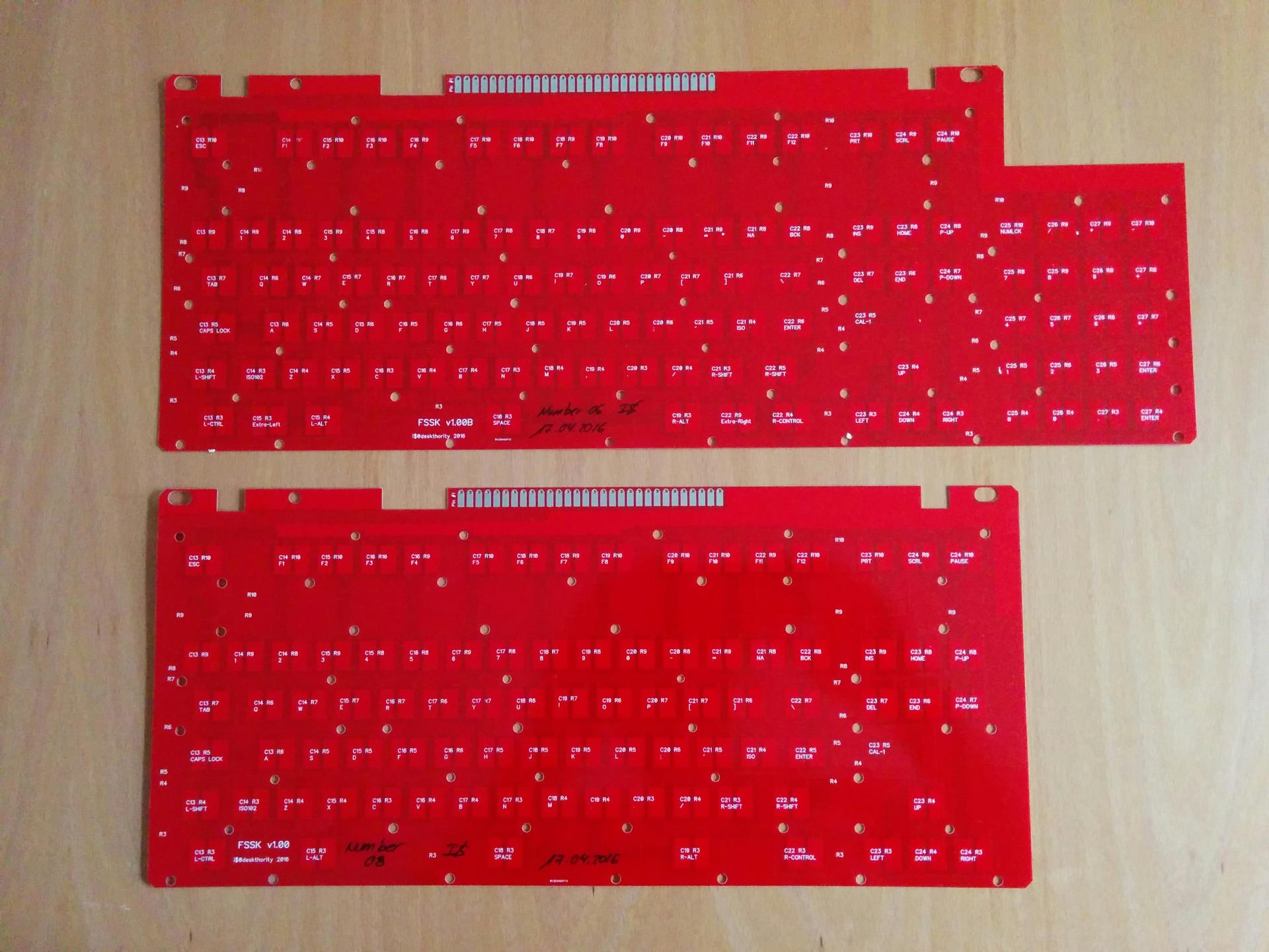

Now I will have to run against Halvar to create the first FEXT :-)
For those interested, notice the extra keys (XMIT) in the bottom row.
idollar
i$
13 May 2016, 09:15
idollar wrote: Now I will have to run against Halvar to create the first FEXT :-)
And looking at the picture above, you know now that there are 6 of these prototype FEXTs :lol:
One is with Halvar and one with me ...
Halvar
13 May 2016, 12:22
Which bears the question where the other four are ... :-)
