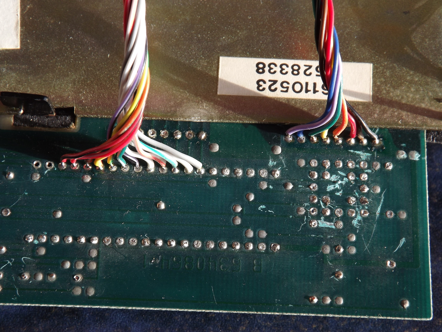

Hi, I've wired the PSoC to the XT at long last. But the signals are very faint on the matrix monitor. Some of the rows look quite dead, stuck at zero. Others appear to be sensing some low-level noise. Only one column registers a few key presses, and even so, these don't go high, about 6 or 7.
The PCB was suspect to start with, quite a few areas of the board have black copper oxide under the solder resist layer. It could be that some traces are corroded to the point it is no longer conducting electricity at all. I must do a continuity check.
I have a second XT which looks in good shape, no corrosion, but I don't have a way to test it first before modifying it, to check it's a known-good specimen,

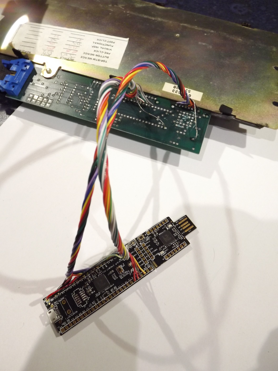

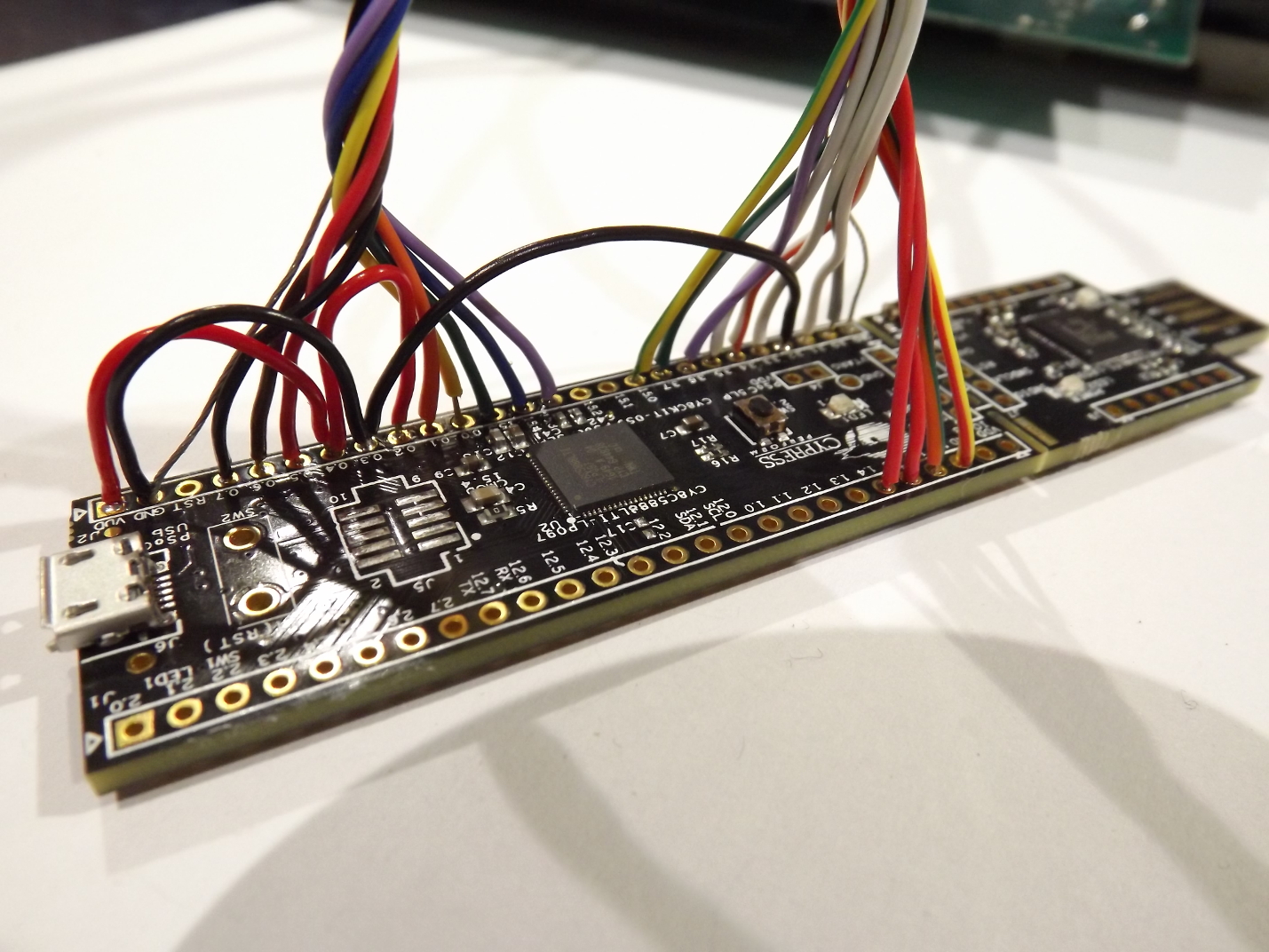

wire connections to the PSoC
wire connections to the XT keyboard logic board
Wire looms between keyboard logic pcb and the PSoC pcb

When I said "I tested it with 2 ft wires and it worked" I didn't mean it to be a recommendation. It should work though.
You don't have a scope, I presume?
obvious things:
1) check that you don't use pins with capacitors. They're marked * on the picture with kit pin descriptions.
2) check there's no shorts. Between PCB and the metal cage, too.
Once this is taken care of -
open the assembly, get access to the PCB. Leave the PCB on the back plate. run matrix monitor. Grasp the row wire you see responses from, press your other hands' finger against contact plates on the PCB, observe. You should see pretty strong signal.
If that doesn't work - touch column wires with the same fingers you used in previous step. Don't short row to column - you won't fry anything but the results may surprise you as I only read lower 8 bits from the ADC and god only knows what you'll see.
Or you may swap last 2 steps - or even desolder the controller from the board and just touch the pin pads to make sure the controller is OK.

DMA wrote: obvious things:
Point 1) Oops. I can already see I made a mistake. Does this rule apply to sensing lines on rows only, or in general just to be sure? I have to avoid P15_4 and P15_3 for the rows, and P15_2 for the columns.
This begs the question, how to remap the pins? RTFM no doubt, regarding PSoC Creator IDE, but a recipe how-to describing pin remapping would be a big help, please.
Point 2) Continuity and short probing is on my to-do list, definitely.

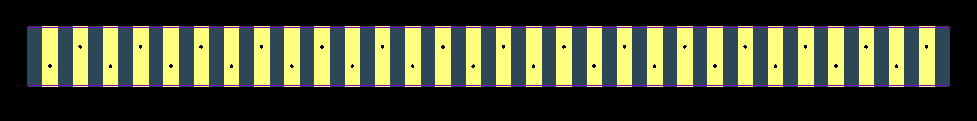

Another idea that doesn't require soldering ... add a shim.
The original PCB is 0.8 mm and the connector wants 1.6 mm, so just add another 0.8 mm shim and stack it.
something like this:
You can get 3 of these from OshPark for $7.25 delivered. Select the option for "2 oz copper, 0.8mm thickness"
Gerber file is attached below.
Shim.zip
(2.75 KiB) Downloaded 237 times
