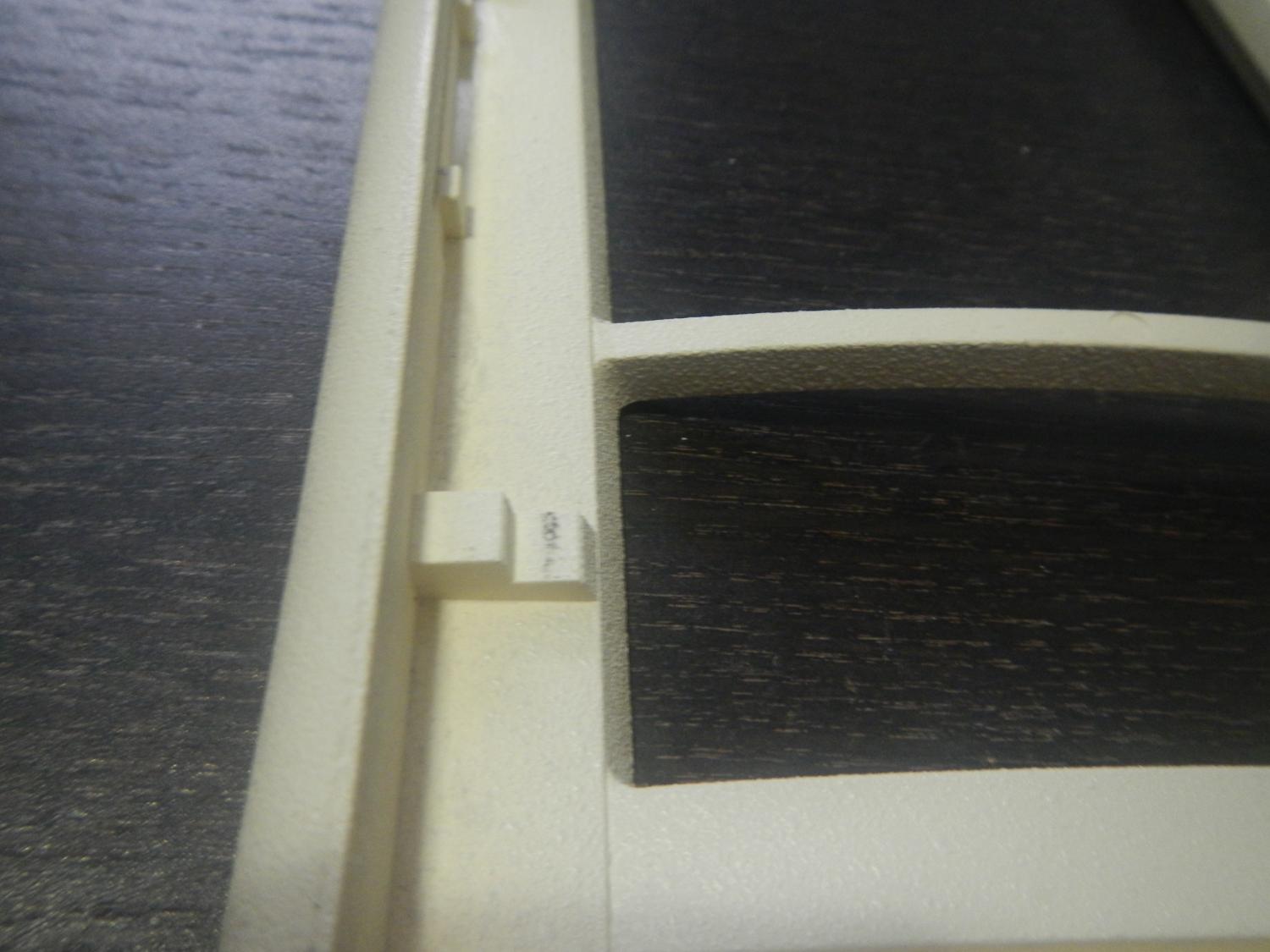

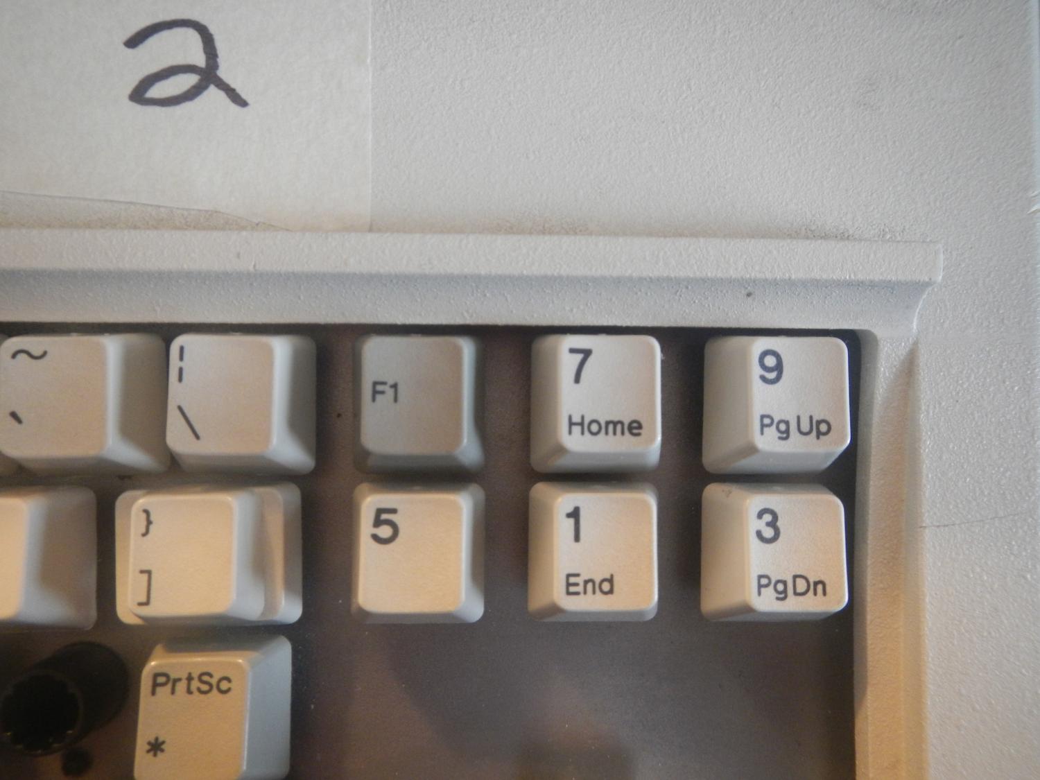

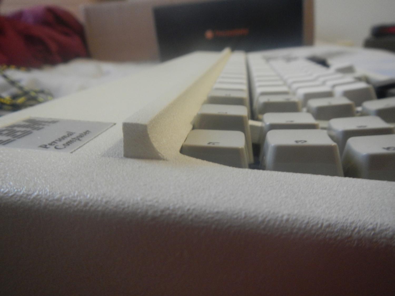

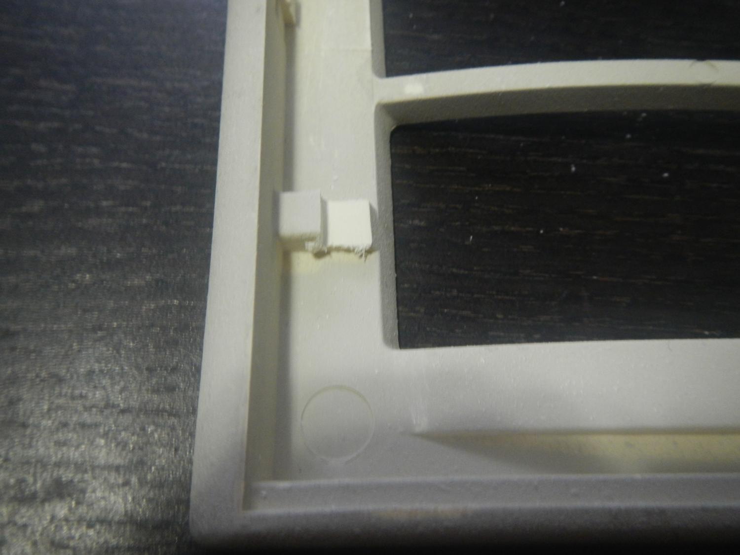

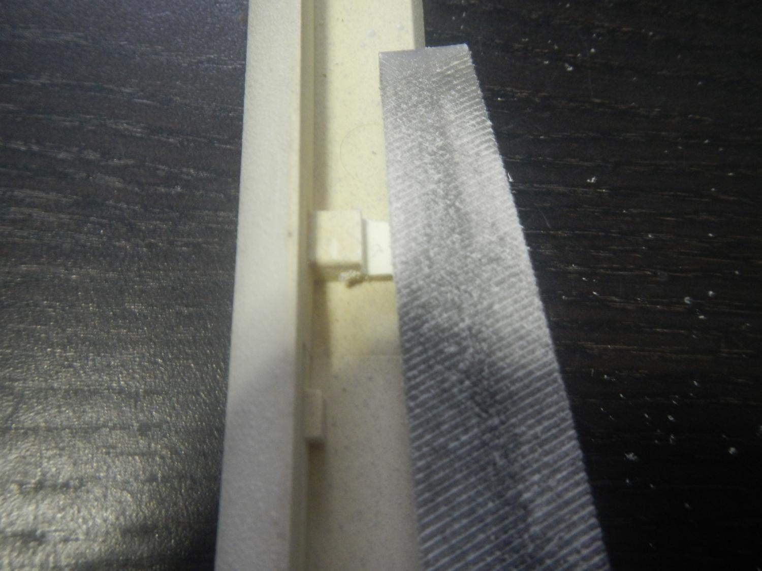

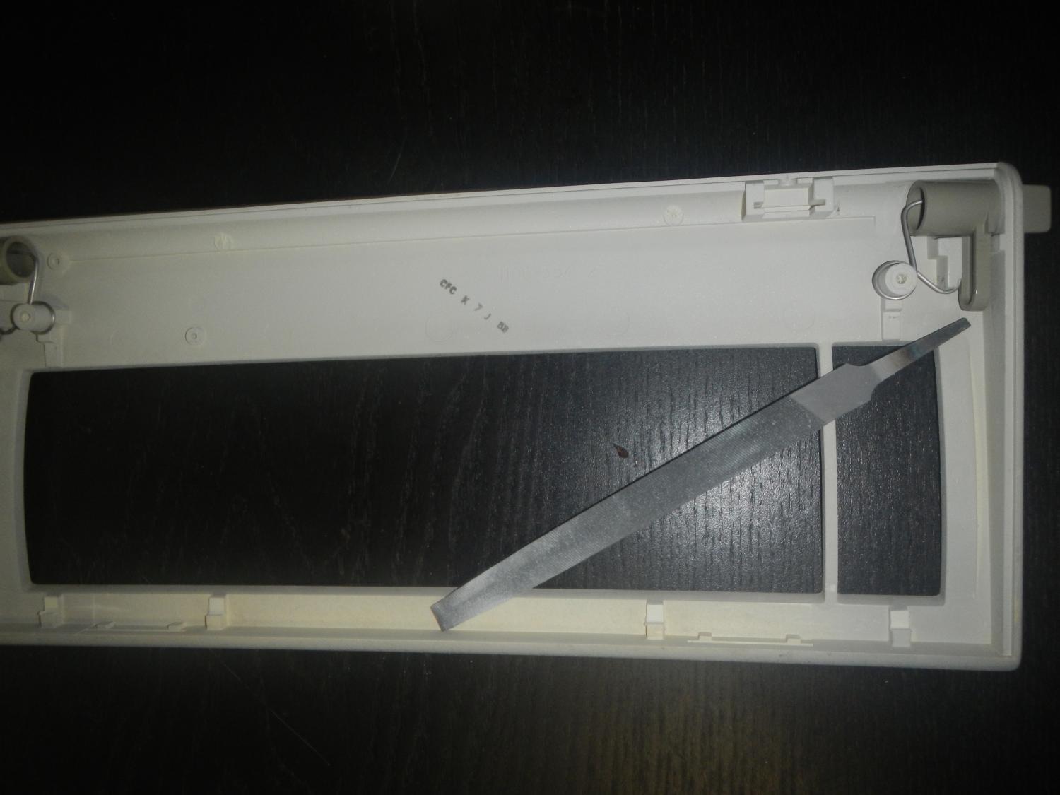

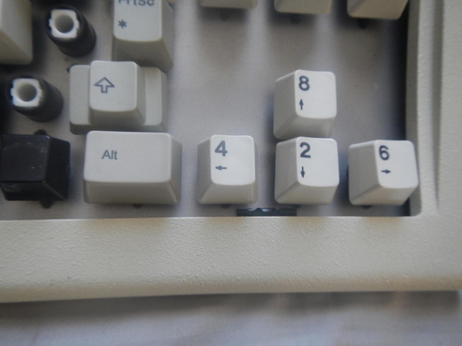

Okay guys, life has slowed down a little bit and I finally had some time for my lingering XTant builds. I mentioned earlier in the thread about some issues I had with the assembled internal sandwich (plates, PCB, switches, and springs) fitting well inside the case. When assembled, the top row of keycaps would rub against the edge of the case. On the bottom row of keycaps, there was plenty of clearance between the keycaps and the case.
Wcass and I have discussed this issue through messages, and he did change the specifications of the barrel plate file to allow proper clearance to prevent any keycaps from rubbing against the case. So if there are future runs of the XTant barrel plates and PCB, the problem I am describing should not occur. However, if you received a plate from me, you may have the keycaps-rubbing-against-the-case problem.
In the meantime, I still had the original barrel plates from our tiny group buy and did not want to pay for new ones, so I decided to work with what I had. I tried a couple different methods to give the top row more clearance (adjusting screws of the internal assembly, crudely forcing the internal assembly to sit lower), and while this worked with one or two keyboards, it did not work for all. I needed a more universal solution.
My somewhat labor intensive solution was to file down the standoffs on the bottom edge of the case where the internal plates rest against the case. All I needed to do the job was a somewhat coarse mill bastard file. So I killed some time while watching the NFL playoffs and starting filling away.
Medium story short, it worked and all of my XTants now have enough clearance on the top and bottom of rows of keys without any keys getting stuck. So I finally have my XTant working properly, which is nice.
