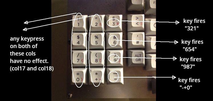

this thread has helped a ton getting things setup here, but I think I'm hitting a wall & not sure if it's a simple thing I'm overlooking or more complicated.
I'm working on using a Teensy 2.0 w/ Hasu's firmware to convert a Toshiba T3100e keyboard to USB,
it has a 22 pin ribbon cable off the keyboard, according to the T3100e manual it looks to have 11 columns and 8 rows (& 3 common grounds). It also has the column pins are marked as OUT and rows are IN. (im assuming SC is column and RTN is row)
I checked continuity for all the keys with the 22 pins and determined the key layout in rows/columns in a spreadsheet, i need to finish marking the keys K** to match up with my code...
When I first tested the keyboard using 11 columns and 8 rows, I got no keys working, and also no voltage drops at a row's pin, when a row is trigged by pressing the relevant key.
So because of that I assumed the diodes are facing the opposite way..
so then swapped around the rows and columns in code, so it has 11 rows and 8 columns:
this is the current keymap_common.h
#define KEYMAP( \
	K00,  K01,  K02,  K03,  K04,  K05,  K06,  K07,  K08,  K09,  K0A,  K0B,  K0C,  K0D,  K0E, \
    K10,  K11,  K12,  K13,  K14,  K15,  K16,  K17,  K18,  K19,  K1A,  K1B,  K1C,        K1D, \
    K20,  K21,  K22,  K23,  K24,  K25,  K26,  K27,  K28,  K29,  K2A,  K2B,  K2C,  K2D,  K2E, \
    K30,  K31,  K32,  K33,  K34,  K35,  K36,  K37,  K38,  K39,  K3A,  K3B,  K3C,        K3D, \
    K40,  K41,  K42,  K43,  K44,  K45,  K46,  K47,  K48,  K49,  K4A,  K4B,        K4C,  K4D, \
    K50,  K51,  K52,  K53,                                K54,  K55,  K56,  K57,  K58,  K59  \
{ KC_##K01, KC_##K0B, KC_##K03, KC_##K3D,  KC_##K05,  KC_##K07,  KC_##K09,  KC_##K4D },\
{ KC_##K02, KC_##K0C, KC_##K04, KC_##K2E,  KC_##K06,  KC_##K08,  KC_##K0A,  KC_##K50 },\
{ KC_##K00, KC_##K10, KC_##K20, KC_##K21,  KC_##K31,  KC_##K30,  KC_##K40,  KC_##K2D },\
{ KC_##K11, KC_##K12, KC_##K22, KC_##K23,  KC_##K32,  KC_##K33,  KC_##K41,  KC_##K42 },\
{ KC_##K13, KC_##K14, KC_##K24, KC_##K25,  KC_##K34,  KC_##K35,  KC_##K44,  KC_##K43 },\
{ KC_##K15, KC_##K16, KC_##K26, KC_##K27,  KC_##K36,  KC_##K45,  KC_##K46,  KC_##K53 },\
{ KC_##K17, KC_##K18, KC_##K28, KC_##K29,  KC_##K37,  KC_##K38,  KC_##K48,  KC_##K47 },\
{ KC_##K19, KC_##K1A, KC_##K2A, KC_##K57,  KC_##K39,  KC_##K3A,  KC_##K49,  KC_##K56 },\
{ KC_##K1B, KC_##K4C, KC_##K2B, KC_##K2C,  KC_##K59,  KC_##K3B,  KC_##K4A,  KC_##K51 },\
{ KC_##K1C, KC_##K58, KC_NO,    KC_##K3C,  KC_##K54,  KC_##K4B,  KC_##K0D,  KC_##K55 },\
{ KC_##K0E, KC_##K52, KC_##K1D, KC_NO,     KC_NO,     KC_NO,     KC_NO,     KC_NO    } \
Now with that change, some keys do things, but none of them are correct, and the only unique character/codes i can get are the following (I tested all keys), they don't seem to relate to any sort of pattern in the rows/columns either...
3 f d n e b 4 a g , END 5 F6
(I also highlighted them blue in the spreadsheet above)
When I check the voltage on the row pins, it is dropping correctly when a row is activated- so for example I can press any key of a specific row, and that row's pin on the Teensy pcb will drop in voltage, which I believe means my wiring is correct/
But as far as where to go from here, I'm feeling stuck, I've been doing changes in code, like reversing the ordering of rows or columns but having no luck so far..
I've also tried disabling NKRO and enabling matrix_has_ghost and playing around with other config options
any suggestions are extremely appreciated!!

Ray
30 Jul 2015, 12:36
XRA wrote:Now with that change, some keys do things, but none of them are correct, and the only unique character/codes i can get are the following (I tested all keys), they don't seem to relate to any sort of pattern in the rows/columns either...
well, that's strange. If it is on software or on hardware, either way, it would be related to rows/columns…
Can you check that the pins in matrix.c are the actual ones connected to the ribbon cable?
keymap_common.h looks good enough, as does keymap.c
as long as it compiles, your problem doesn't sit there.
to sum it up:
you got a keyboard matrix where you tested every switch for continuity at the ribbon cables. You double checked the rows/colums while doing so.
you got a KEYMAP that fits that.
only 13 keys register something.
at that point I would double check my wireing and soldering.
and check if my changes in code are actually compiled.
XRA
30 Jul 2015, 20:02
Ray wrote: well, that's strange. If it is on software or on hardware, either way, it would be related to rows/columns…
to sum it up:
thanks for the suggestions! I started making sure it was compiling my changes, I ended up clearing some unused files, (all the keymap c's i wasnt using since i started with the gh60), as a result I modified the makefile to point to just the specific keymap.c

Can someone help me with this configuration problem:
My guess would be, that it has to do with hexadecimal counting, because col17 and col18 don't work anymore. All the other keys on the keyboard work. It is a software problem, no hardware problem, because the same hardware worked flawlessly before with Soarer's firmware. Here my configuration files.
hasu
09 Aug 2015, 09:05
Probably this code are handled 16bit integer and col16 and col17 bit are ignored.
https://github.com/tmk/tmk_keyboard/wik ... -beyond-16

Eszett
09 Aug 2015, 12:36
Hi hasu. That was it, it works now! I changed to "1UL<<...". Cheers! :)

I have no clue what is wrong, and I've looked over my code so many times. Slowly I am learning :(
Thanks for any and all help!

Boywonder
17 Aug 2015, 19:53
I'm using f0 f1 f4 f5 f6, the row pin config was from the software that i downloaded, but its greened out (annotation)
Halvar
17 Aug 2015, 21:01
OK, then check the select_row() function. You're setting F0 F1 F2 F3 F5 there at the moment. :-)
Boywonder
17 Aug 2015, 22:12
Halvar wrote: OK, then check the select_row() function. You're setting F0 F1 F2 F3 F5 there at the moment. :-)
Ahh success..... almost. so now almost everything works, except row 3 is firing 1qaz(alt), b doesn't work, and when i press g it also triggers a
Where could these problems originate from?
flabbergast
17 Aug 2015, 22:28
@Boywonder: I'm not sure this will solve your problem (which might be a diode backwards?), but you should also initialise the C7 pin you're using for column 15:
    DDRC  &= ~(1<<7);
    PORTC |=  (1<<7);
in the init_cols function.
EDIT: (What I wrote before in the edit was completely wrong.)
Boywonder
17 Aug 2015, 23:26
flabbergast wrote: @Boywonder: I'm not sure this will solve your problem (which might be a diode backwards?), but you should also initialise the C7 pin you're using for column 15:
    DDRC  &= ~(1<<7);
    PORTC |=  (1<<7);
Thank you very much! I'm typing on it right now!!!!!!!!!!!!!!!!!!!!!!!!!!!!!!!!!!!!!!!!!!!!!!!!!!! woooooooooo except my B key doesn't work might e a ad switch
flabbergast
17 Aug 2015, 23:41
Boywonder wrote: Thank you very much! I'm typing on it right now!!!!!!!!!!!!!!!!!!!!!!!!!!!!!!!!!!!!!!!!!!!!!!!!!!! woooooooooo except my B key doesn't work might e a ad switch
No worries. Glad it helped!
For the 'B': check the diode, and the switch by itself with a multimeter.
