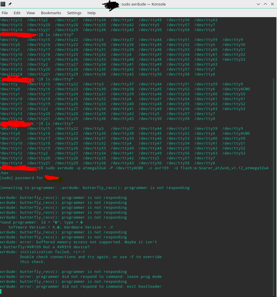

Hello! I assembled my converter, and even after double checking my USB ports, it still gives me this error :( . I'm so unlucky today.
30 Aug 2018, 17:30
I said the same on Telegram, but can say it again here - your device is not in the bootloader by the time you run that command. Maybe try to run it in a loop while you short the pins. You have seconds between the device appearing and disappearing.
while true; do sudo avrdude blah blah; sleep 2; done
Then short the pins again.

hm. kinda lost... still having some issues.
So here's my understanding of the possible way of flashing it is:
1st: Check /dev/tty/
2nd: while true; do sudo avrdude -p atmega32u4 -P /dev/ttyACM0 -c avr109 -U flash:w:Soarer_at2usb_v1.12_atmega32u4.hex; sleep 2; done
(2a: while shorting RST and GND)
3rd: profit?

I usually just hit Enter on the already prepared command "sudo avrdude ..." *right after* (i.e. ~1s) removing the short between RST and GND. I.e. in one hand have some metal wire that hooks on those pins, remove it, and quickly hit Enter with the other hand. You have to remove the short, otherwise the Pro Micro won't enter the bootloader mode (where/when it can be flashed).

How to get a pro micro into bootloader mode:
  1. Get a piece of wire
  2. plug in the pro micro
  3. Throw the piece of wire away
  4. Say a prayer
  5. Cough three times
  6. Backflip
  7. Fly around the world
  8. Pick up the pro micro
  9. ...
:lol:
No but really:
  2. Get your avrdude command typed out so all you have to do is hit enter
  3. Plug in the pro micro
  4. Short Gnd to Rst twice quickly
  5. Send your command and hope that it flashes
The last three steps have to be done pretty quickly

Laser wrote: I usually just hit Enter on the already prepared command "sudo avrdude ..." *right after* (i.e. ~1s) removing the short between RST and GND. I.e. in one hand have some metal wire that hooks on those pins, remove it, and quickly hit Enter with the other hand. You have to remove the short, otherwise the Pro Micro won't enter the bootloader mode (where/when it can be flashed).
This.
In windows though, sometimes the com # changes so usually I have an open device manager. But nowadays I use QMK toolbox to flash my hex.

So.. I tried trying to flash it within 1sec, and even with the help of my dad (who plugged in the promicro into the usb as fast as he could), then I tried to short the pins (the two pin extenders I found always fell out, never could do it fast) and then press enter. But again, never worked. Also, i could never short it two times that fast. (my usb cable is 10cm long) :(
I will keep trying, but I will never buy a promicro for a controller ever again, if I need to do this for flashing.

You don't need to plug it "fast" to USB (just keep it plugged), and try to keep it shorted before flashing - press Enter *after* un-shorting it.
