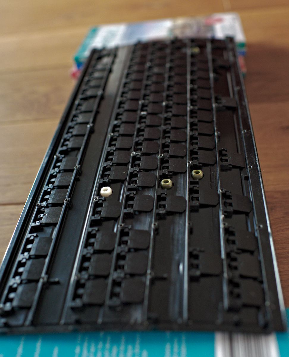

So, I've been thinking. Looking at this picture in particular:
The blocked flippers are for the CV and ,. keys. Those are, sure enough, where the spacebar stabiliser clips are mounted on the top of a Model M barrel frame. Those rectangles that are in the way here are, I strongly suspect, the undersides of the stab clips. They look pretty heavy duty. I wouldn't want to try drilling them out of the way. Better to first try cutting flippers instead.
Another thing is that Model M frames have a lot of plastic ridges on the underside that hold the membranes in place via those infamous plastic rivets. Each row of flippers is actually boxed in by those ridges. But Model Fs have no such thing:
What you see here is discrete switch housings instead. What are the relative sizes I wonder? Model F was designed for a capsense PCB while Model M was obviously not. In Model F, the PCB is held fairly tight against these switch housings. Do the Model M ridges force us further away from the flippers or what?

All,
Let me report that the first problem is resolved: my second SSK can hold all the F flippers:
You will notice that I had to file the epoxy that I added to the channels. The board was not cracked but it was very week. This is why I added the epoxy.

Muirium wrote: ...
Iti s resolved. Check the post above.
In my opinion it is due to a limitation in the tools that could be used in the model F. They couldn't probably create the big plastic piece with all the barrels. What you observed it is just a side effect.
The model M is nothing that a cheaper way to sense a bunking spring. As I guessed before, it could well be that they could not manufacture something. The membrane for instance. Making a PCB allowed to reuse known techniques.
25 May 2015, 20:44
Nice!
That low angle shot makes me feel a bit better about the ridges, too. They don't seem as deep as I remember them. Good news, probably…

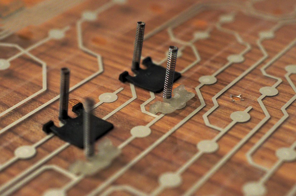

idollar wrote:
Muirium wrote: Just out of interest: does this thing work if you put the Model M membranes back on top and plug in a controller?
I will test it, but another day. I have screw in an out three SSKs already. Enough for today ;)
OK, I will NOT test it as it will NOT work:
The membrane has marks at the flippers pivoting points. If one places the different type of flippers on them, one can see that the M hits where the contacts are. Instead, the F will hit further down. Actually the contact is place under the F-flipper angled section. It will not create any contact in the membrane.
The question has been answered without undoing the screws :-)

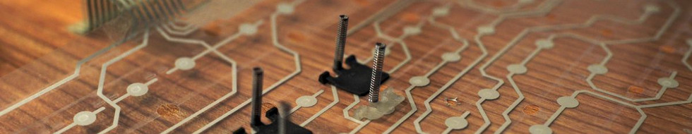

25 May 2015, 21:25
Point proved! Another nice photo there i$. I might try cropping it for a header sometime. (Whoops: too blurry! I shouldn't make decisions when browsing at 3.5 inches.)
And I look forward to trying these newly made spares of yours, rsbseb
idollar
i$
25 May 2015, 21:35
I have created a new version that would fit better the header ...
I have posted it also in the correct thread :-)
