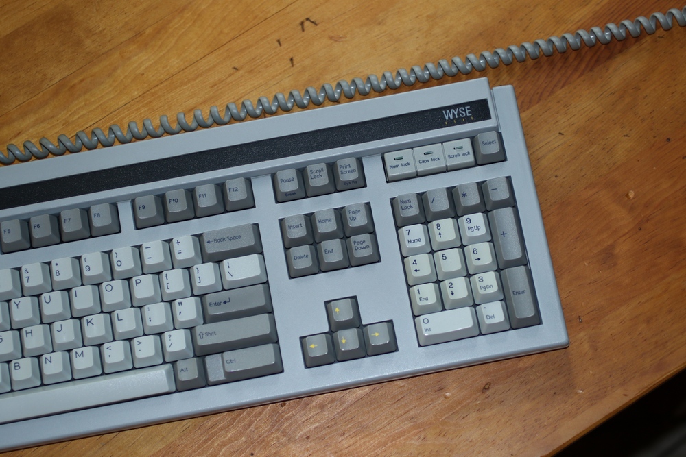

05 Jun 2015, 12:32
The bottom row will be especially interesting to try. SA profile does them flat, usually, which is perfectly useable if a little bland looking. You went with (concave) row 4 on SA Retro, didn't you? Probably an improvement. Though I could even see convex curvature down there feeling good. All needs to be experimented.
I've tried a few combinations with arrow keys before. My favourite is SP rows 2 & 4 for a concave curve down there, which feels like a microcosm of the overall board. Furthest to the right in this diagram:
Here it is in practice:
Note the flat bottom row beside it (all ducks!) which is okay but not especially good looking. The shape I mean, not the ducks, which are beyond fault!
